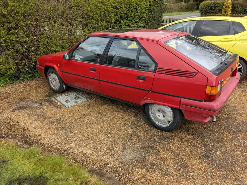

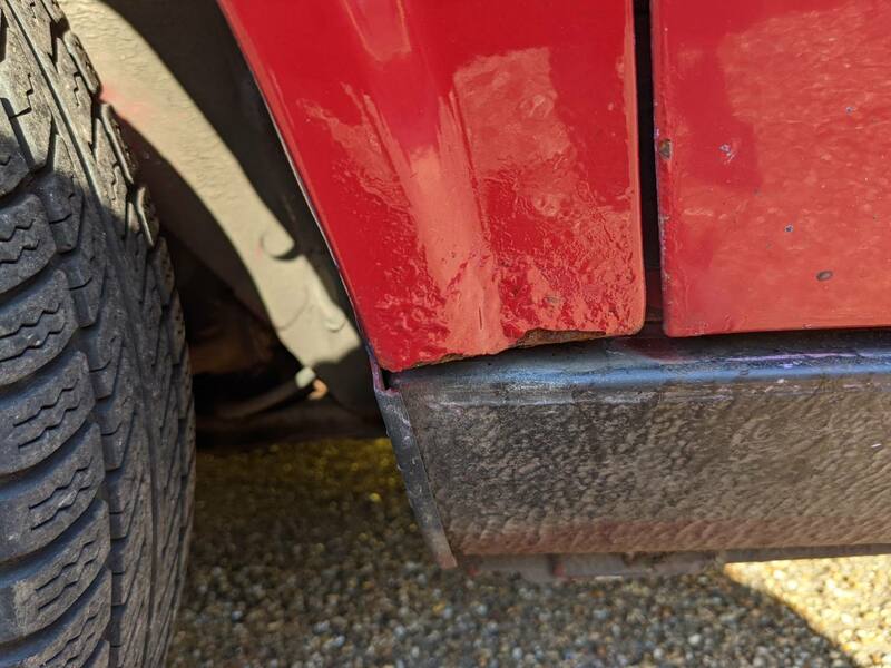

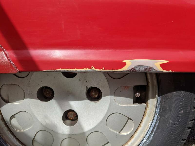

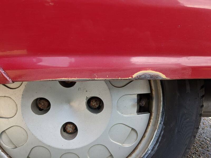

In the meantime, I had a look at the bodywork. Very minimal rust, just scabbyness.
PXL_20210404_172917184.thumb.jpg.90fc2e8ec386319152b853fbc9ff2078.jpgPXL_20210404_172553033.thumb.jpg.3ec822fd4ec16f1c328fd33bc7c84696.jpgPXL_20210404_172557495.thumb.jpg.8b5e1db3f4d7e6a017f1f5252cce62e5.jpg
It seems the nearside wing has been in a bit of a prang at some point of its life and has had a cosmetic repair, judging by all the filler I was sanding away to get to the end of the corroded metal. There's also evidence of a respray on both wings, with a hefty drip on the offside. I've applied some rust converter which I'll overcoat with primer and some totally incorrect red enamel. The wings will need to be off as a matter of course for when I do repairs to the inner wings and the subsequent rustproofing. This'll help slow the process down a little bit.
I think I also found one of the reasons why the car is still with us, someone's bunged loads of waxoyl or something in the frame. A massive confidence booster that someone, at some point, was giving the car a nice amount of TLC.

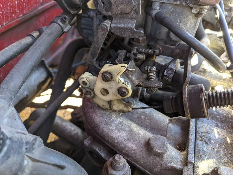

Also, what are these mystery connectors for? The one hanging on the wire is just floating around in the engine bay.

Yep, pretty sure the mystery dangling wire is something to do with engine servicing and actually shouldn't be connected to anything

After looking at it again, I'm fairly sure it's a tachometer hookup for carburettor adjustment.

First though make sure that the solenoid on the carb is still connected (it's easy to snag the wire when working in the area).
Isn’t this just the fuel stop solenoid that cuts fuel on either the over-run or when ignition off?
I think so. Some Solexes had an idle solenoid as well, but mine doesn't.

This accident damage repair hasn't fared all that well. The other side is fine. Good job I need this wing off at some point anyway.

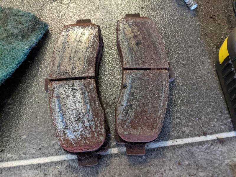

After 1 week of commuting ~50 miles each way the NSF caliper had had enough and seized in place, causing much burnage of the brake pads
As one can see, they're a bit glazed over. Not really worn much but they weren't doing their job. Lucas pads which suggests they're original to the car.
The disc itself has a few rust pits in it and a fairly sizeable lip on the inside. May replace in future.
NAPA. Oh yes. I polished the offending caliper piston and cleaned up the anti vibration slider thingies on the caliper bracket. Greased everything that needed greasing and fitted everything back together. The brakes feel a lot better with new pads and greased sliders and stuff. A lot stiffer and less spongey. I haven't driven it enough to see if the problem was fixed as it's now parked up at the unit, having only had a small test drive to bed in the brakes.

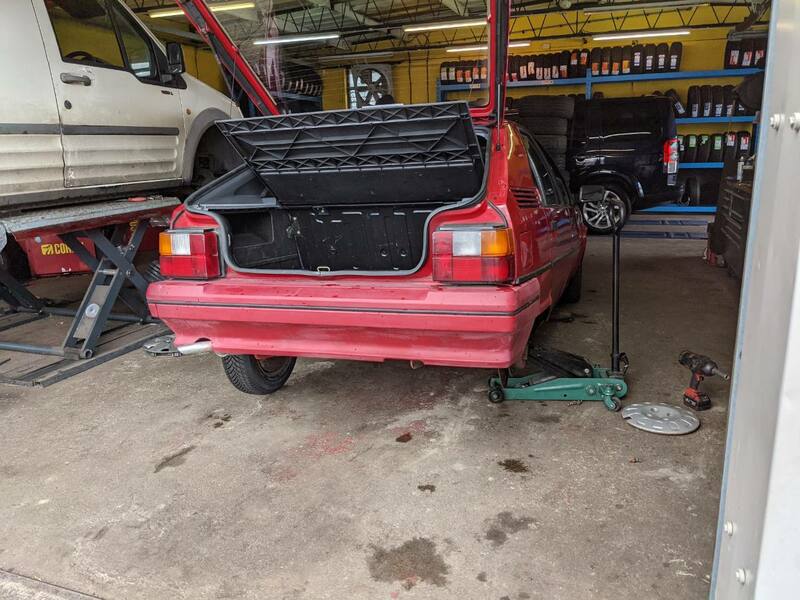

Despite the snow, I got the car started and idling to warm up and get to the tyre fitters.
Then it wouldn't idle as I pulled in.
Had to abandon in the carpark. "No probs!" the fitters said. They're a lovely bunch over there. SE Tyres in Uckfield are always brilliant with their customers. I highly recommend.
While they were being fitted, I found a dog
Wheels balanced perfectly and they're rather clean inside and out too. New valvestems and everything. All good here.
Except the fucker won't idle when hot. I've obviously fixed too much on it and it's not happy. The gear selector at the 'box is weeping too. Despite this, it's like riding in a comfy chair- road roar has virtually disappeared. It's such fun chucking round bends.

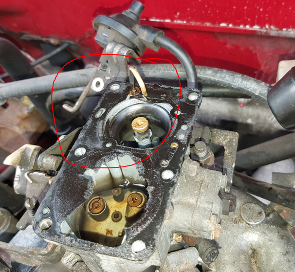

Some investigation points to a vacuum leak here:
This is a picture from the previous owner, not myself. I'll tighten the screws and see if anything improves. Going by the state of the gasket, I may have to get one myself and replace. The rest are fine, including the intake manifold.
While the engine warmed up I fixed the OSR door. Child lock was engaged. Small victories.
Tightening the bolts did help a bit, but it won't respond to mixture adjustment. I have a feeling both the idle jet and gasket are causing it to not work at all.
I'm slightly grumpy and will set to buying a sheet of gasket paper on the offchance that fixes it.

Whipped the top of the carburettor off-
Much crud was cleaned. Accelerator pump valve (removed in last picture) was clear, as was the main jet.
Q tips were deployed to clean the bowl. All of them I used turned out black. I doubt it was ever cleaned at all.
Then I managed to locate the idle jet, which was blocked. I cleaned it out and flushed it through with cleaner. I refitted it and it runs slightly better. I have a hunch the rubber O ring has crushed meaning it's getting wound in too far into the carburettor. If paper shims don't help, I can order a new jet, but I suspect there are deeper issues. I may yet replace it in its entirety but I'm holding off as soon as possible. I wonder if ignition time may be of issue as well.

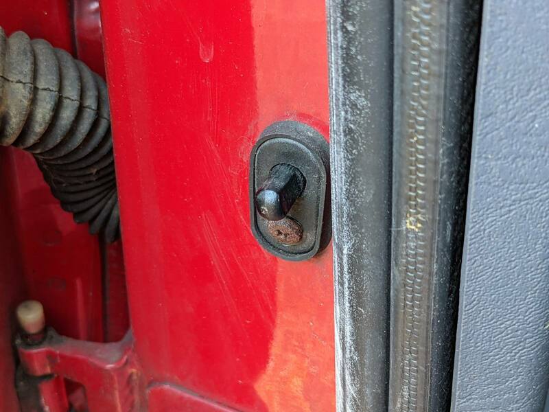

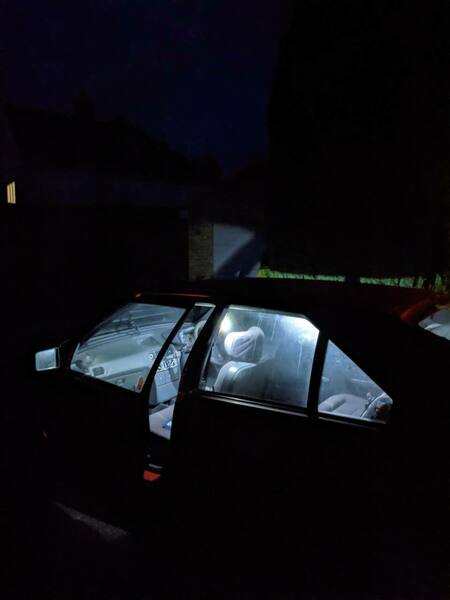

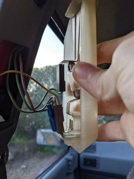

Then, I got bored and decided to fix some stuff, namely the passenger side interior light which was bugging me. The switch fell out before I bought the car so it wouldn't turn on. Observe:
PXL_20210415_164533332.thumb.jpg.19908bd80ea7053dd7a2121300304304.jpgPXL_20210415_164632983.thumb.jpg.7926a0a963d58b0531fba01c5c388218.jpg
No switch contact on the left                                                                                  Switch contact on the right.
Some probing found that the spade terminal with the blue connectors on it are the door switch operated contacts, so I warmed up the soldering iron and did a bodge
Which worked until it didn't
Oops. I can get a direct replacement, but if I can get an LED tomorrow I'll bung that in. I was doing this on the rear passenger seat because it's easier. The door has't been open that much in 20 or so years so the switch decided it'd not come out to play.
I levered it out with the key
It's a bit stiff to operate so I might, one day, take it out and clean it up... if I can be bothered to. It's not like it's an essential function of the car.

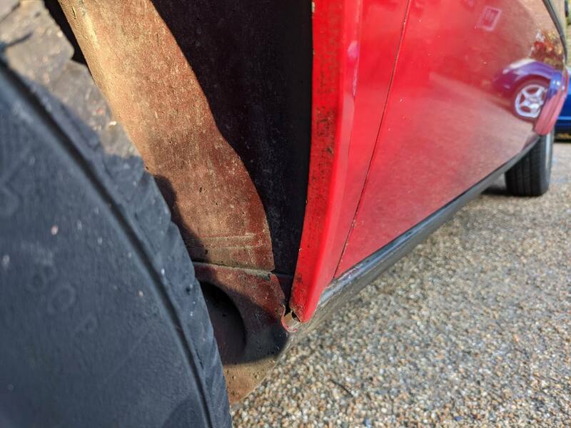

Gave it a wash, replaced the interior bulb and I looked underneath. I am genuinely astounded at how good it looks under there
PXL_20210416_103040415.thumb.jpg.b6ed8eef1610f5f6a2526a3596e7e38f.jpgPXL_20210416_103034882.thumb.jpg.95a3e0acbb7281c35061a27c71d99bd1.jpg

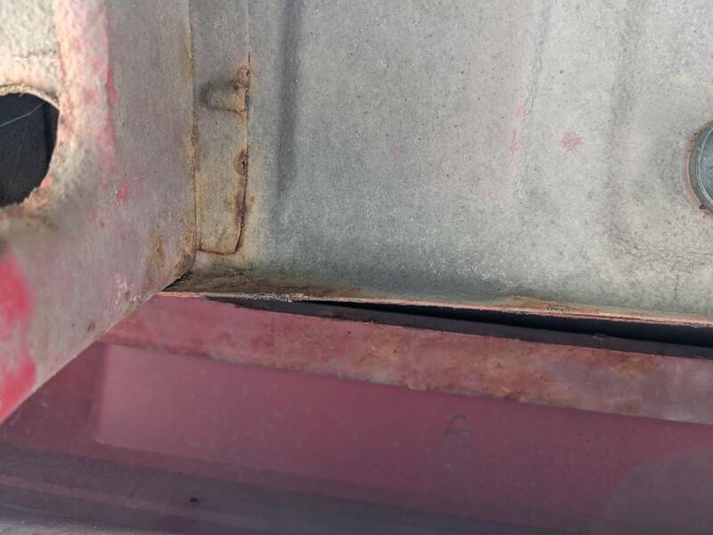

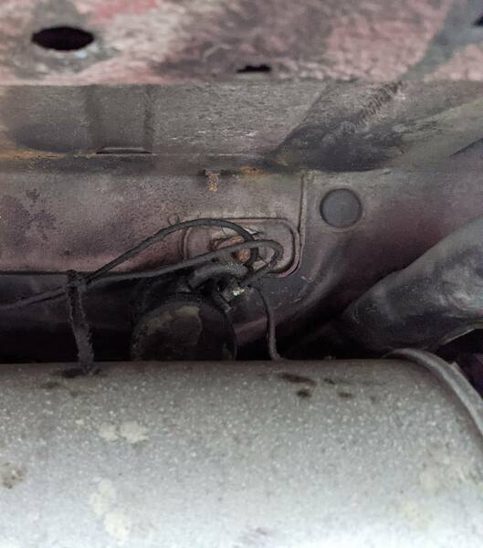

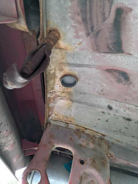

I've got some stuff that I can easily fix over the weekend. How it hasn't corroded through, I have no idea. I do need to make a spare wheel carrier, though, It'll be a fun little project with some steel rod and some measurements. I have two spare wheels to measure off of too.
It's bottomed out once in its life so that I'll fix at the same time. I suspect this is from when it was dragged out of wherever it lived when the engine was seized.
What's more important is this:
Not only has absolutely everywhere been waxoyled at some point (which has probably helped it live this long), the height corrector and pipes don't look all that bad. Helps ease the mind a bit. Now, while I do have a spare height corrector and pipes are obtainable, I'd rather not have the headache of one of these going anytime soon. Their condition alone makes me happier. Looking at the front of the car, a line from the accumulator has been renewed, as has another going to the brakes. One pipe from the octopus has been done as well. Where it goes to, however, I have yet to find out.

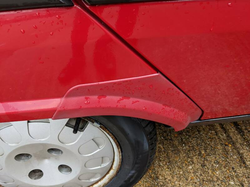

There's evidence of a respray, too. Basically, the bottom half of the car has been redone some point in its life.
PXL_20210416_103606949.thumb.jpg.c9b5853c5ff4b8b4c6e768ddfa137123.jpgPXL_20210416_103611155.thumb.jpg.fb2728a7769b976743e3baf023f000dc.jpgPXL_20210416_123602648.thumb.jpg.b47f410da089991892617cd47623924e.jpg
The new paint is peeling off the old, the top half has faded a lot more, and they never took out the side repeaters fully when doing the job. The front bumper was originally black by the looks of things. I suspect it was a replacement that was sprayed (rather poorly) when it was put on the car. She's a good 10-footer.

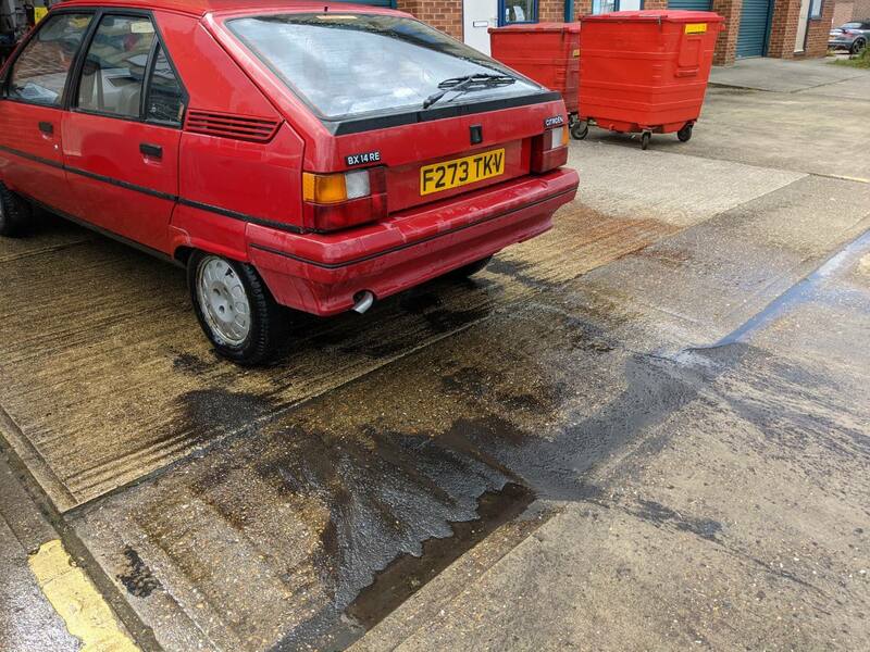

Then I pointed a hosepipe underneath the rear arches. It started off as normal...
...and then, 45 minutes later, the ground looked like a river bed
I wonder if the arches were washed that much, if at all over the past decade or so.
I set to washing. Used just one (!) bucket with black, gritty water in it. Shoot me. The main aim was to strip all the Turtlewax and other shit off the car and the plastics. The wing trims went from a pasty pink to this:

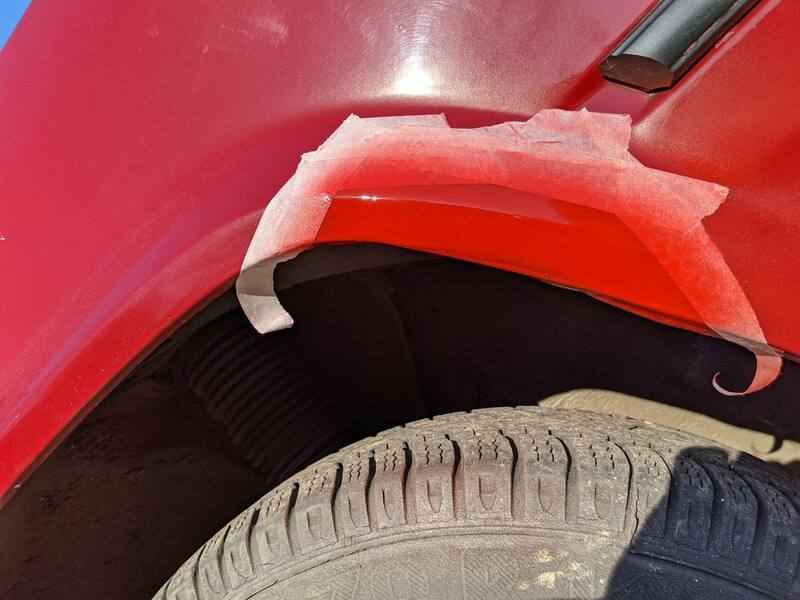

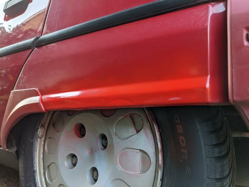

I also polished off the overspray and hard edges on the wing paint patch thingie I did in the completely wrong shade of red.
I used some old Autoglym paint renovator stuff, which is basically a cutting compound, followed by some Super Resin Polish. It is now the shiniest part of the car by a country mile.

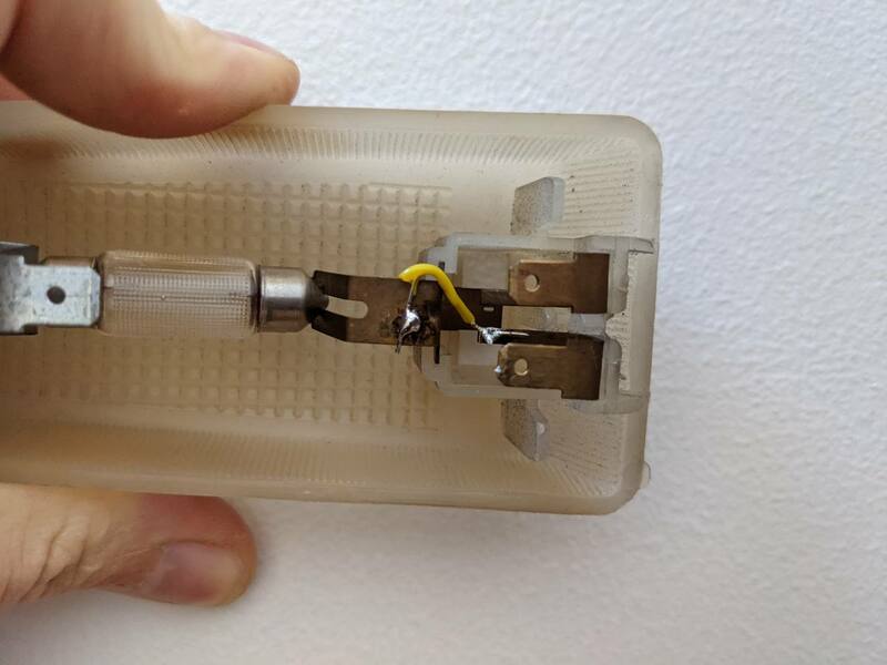

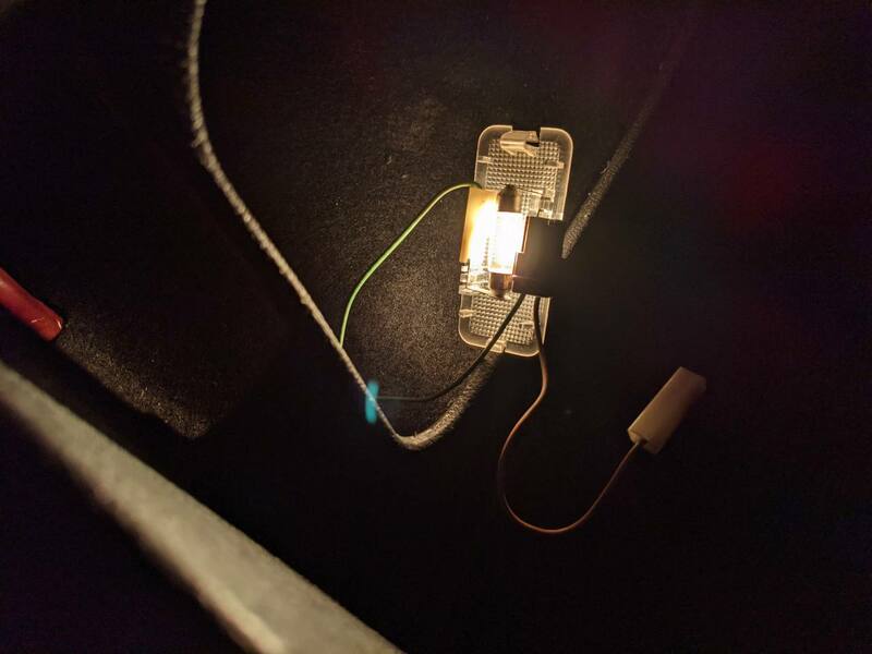

Two insignificant and pointless items crossed off the list- the latter being a rather spontaneous one after fitting the two super duper bright AF LEDs into the overhead lights in the cabin. The boot switch on the BX can be completely disassembled and reconditioned.

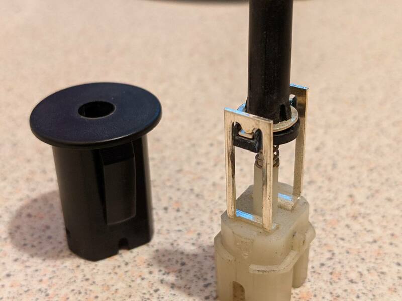

Thanks to the BX's judicious use of spade connectors everywhere, it was really easy to bypass the switch and verify everything's working
So off we go with the switch!
PXL_20210430_202434795.thumb.jpg.ba7c973f6176d1d59434864274393657.jpgPXL_20210430_202443927.thumb.jpg.622d52983c0302d99d098183ed4644d5.jpg
It's a really simple and effective design: The spring pushes up on the plunger, which has a brass tab on it. This tab bridges the two brass tangs on either side, which both serve as runners and as the spade connections for the light wiring.
PXL_20210430_202603484.thumb.jpg.b826701f8140906a2a325f5c8dfc1878.jpgPXL_20210430_203147819.thumb.jpg.618f43543455ee1cc7ceda942372f12c.jpg
After disassembly and some emery cloth, all the corrosion on the brass is removed. Incidentally, I flipped the brass washer thing over as the reverse side had lots of pitting from the boot being repeatedly opened and closed.
PXL_20210430_203358626.thumb.jpg.b38d851be8a24e1258b1847cd65317ed.jpgPXL_20210430_204120093.thumb.jpg.4453022a3c7c2cac9442d5d82c41d16f.jpg
Reassembled and we have light again. Don't let the picture fool you, it's not bright at all. There's so much light being shot behind it's more suited to an LED panel than the cabin lights are! I shall order a slightly smaller collapsed sun to go there instead while I'm at college.
In the meantime, I'd say the cabin is Well Illuminated.
PXL_20210430_203713935.thumb.jpg.2fe9aaef9d80d0edb8b8c40abd12fd7b.jpgPXL_20210430_203826199.thumb.jpg.0150c0d1544b041adb2490b26d5e15d4.jpg
It now lights up the walls of the house. Nicesch.

Picture dump. This stuff is 2 weeks old and involves shoddy bodywork. I advise you to close your browser immediately.
PXL_20210418_115310341.thumb.jpg.d3e4c415ad2100c95179bfa4ee18046c.jpgPXL_20210418_130334705.thumb.jpg.1589038e3c9101ac9890190d51c6b9c1.jpgPXL_20210418_180525101.thumb.jpg.a969e2d588d99bfa3fea29d5e3058c81.jpg
I've since polished it and burned straight into the primer. I am a bodyshop god. There's heaps of filler in this spot too. Try to ignore the overspray onto my ONCE LOVELY NEW TYRES and wheeltrims. One of my tutors ran a bodyshop for 20 years and worked on these cars. The front bumper on thio is smooth and grey, indicating it was a replacement bumper. Citroen sold the texturing kit separately which hasn't been done very well on this car.
To me, the bodywork done on this side looks like a very shit insurance repair. Comforting, really, as any interference I do looks as good if not worse than what's already there!
  • Fumbler changed the title to Fumbler's Crocks- Cocking Up Cack Bodywork
Replaced one bodge and made another.
PXL_20210501_145202122_MP.thumb.jpg.15c3a0971224656d3ca0efed562bcb31.jpgPXL_20210501_151133276.thumb.jpg.b770b4076f0cd260c27d84de0ba51ad5.jpg
ECP doesn't sell the correct filters for these, and with the BANK70 promo code it cost me mere tuppence so I thought "why not" and bought a Bosch filter to replace the old (but genuine) Purflux filter in it. For the mitigation of doubt I added zipties to make sure the fuel lines wouldn't randomly fall off and cause death and destruction. I'm not all that comfortable with that so I'll fetch some jubilee clips at some point. The old fit did do its job though, the paper was a lot darker than it should have been. The other reason for doing this was the fact that the idle jet on the carburettor had blocked again. I made a shim for it but I need to fit a few more to get the jet's position correct.
PXL_20210501_145112516.thumb.jpg.e2a5c18ea873b455af831d4dfb56bcc6.jpgPXL_20210501_145116663.thumb.jpg.b678aad0a0f9a1b6cf09160971c4a480.jpg
Replaced this masterpiece of late 20th Century bodging with the intake. It was absolutely useless at filtering anything because bottom of the filter never touched the bottom of the airbox, and the filter iself wasn't sealed at the bottom so it was just letting air in without actually cleaning it. Also, being so old, the foam was turning to dust so the engine was sucking that in too.
Crosland filter replaced it, something actually made for the intake assembly.
None of this made any actual improvement, but it's something that needed doing regardless of any performance increase.
Also checked if the alternator was charging, and it is. Main engine earth lead replacement due tomorrow.
I love cars like this, as I don't feel like it's as bad that I'm messing up originality when I fix things up. My current 416 is such an example, it has a lacquered wing when it shouldn't as the factory paint is solid colour. I'll have no qualms sanding it back and doing up the lacquer...
My old Civic was another example, it was super clean but had been crashed into front and back and was supposedly Cat C but had a clean V5. The repairs to it were good, but a section of rotten wheelarch that had been cut out and replaced (with what?) was in the spare wheel well, it'd been repaired very well but I didn't want to open Pandora's box so I just ignored it and had my fun with the car.
Bugger hasn't seen the road since I sold it, hope it's OK.
