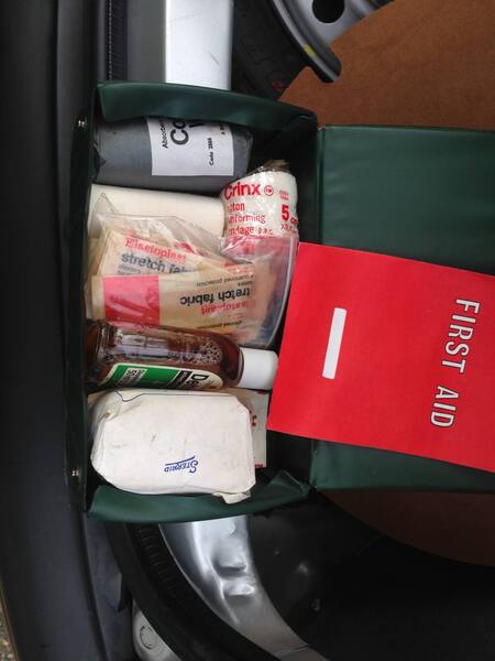

Fumbler Posted June 20, 2019 Author Share Posted June 20, 2019 Collected car today. Still very nice and spritely. Here are some pics to drool over! As you can see it is very clean. Got progressively dirtier as the centre console airvents spat out old leaves and bits of its own vent filter foam. Unused spare, but the roadside repair kit was used at some point. Found this relic in the boot as well! As you can see, one faint section of the LCD can be seen so this is a display failure. Given how old the vehicle is the carbon ribbon that gives the black characters should have detached from a copper ribbon, instead of becoming detached from its bonding agent like in later models. This should mean it's less of a headache to repair. If all fails, getting a radio (with code) from another pre-1998 model will work just fine. Later models have the radio linkes with the immobiliser ID and will not work in another car. Grot spot #1, the only bubbly rust on the top side of the car. Here's the real problem, this 5p sized bit. Will need to cut out, then pour some old ATF down into the void, and then reseal with some new metal. Will ask an-man-with-an-welder to do that because I cannot weld yet. THe jacking points on this side have been used as the other sill isn't rusty like this one. The factory sprayed underseal is doing very well. Just needs some care at the seams and everywhere the paint gun couldn't get to. Fortunately, it's quite clean under here! On the passenger side it's quite the opposite story. Instead, the suspension mounts are in good shape thanks to the oil from the old shocks and other oily things (they were replaced because of this). This sill has a few creases like this, and I can't figure out why! I thought it might be a manufacture defect, but now I'm not so sure. And here's the engine bay. All is very, very clean and shiny. Even the plated steel is still plated and golden! Unfortunately, the Jenolite I had on order was refused because Grandmother hadn't updated her card details. SHould be here by tomorrow though so I can begin to clean and derust where its needed most. I can see why the rear suspension mounts rot away really quickly; they just weren't painted very well from the get-go on my car, and perhaps many others. Will need mats and some door armrest-y handle things. They've completely degraded. Lord Sterling, Shep Shepherd, Lacquer Peel and 2 others 5 Link to comment Share on other sites More sharing options...

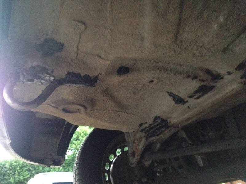

Fumbler Posted June 22, 2019 Author Share Posted June 22, 2019 (edited) I'll be putting it on ramps at some point. Right now I'm crawling under the rear and applying Jenolite again because suspension mounts. The stuff actually worked, just 9 hours after the expected drying time, and in low temperatures so it just doesn't evaporate off. It seems doing it in the evenings is the best time to do it. After doing some research about crossmember problems I'm just hoping mine's not too bad. It did sit for a while so I'll be smearing some Dynax UB all over that at the earliest opportunity. Since my car has no PAS, it shouldn't be an MoT failure, however some places are stricter than others. As the MOT station the lady always went to was strict as anything and this hasn't come up, I'm feeling hopeful that my problem's wont result in me having to spend ages drilling out spot welds and worrying. Edited June 22, 2019 by Fumbler "Spearing" is definitely not the same as "smearing" Link to comment Share on other sites More sharing options...

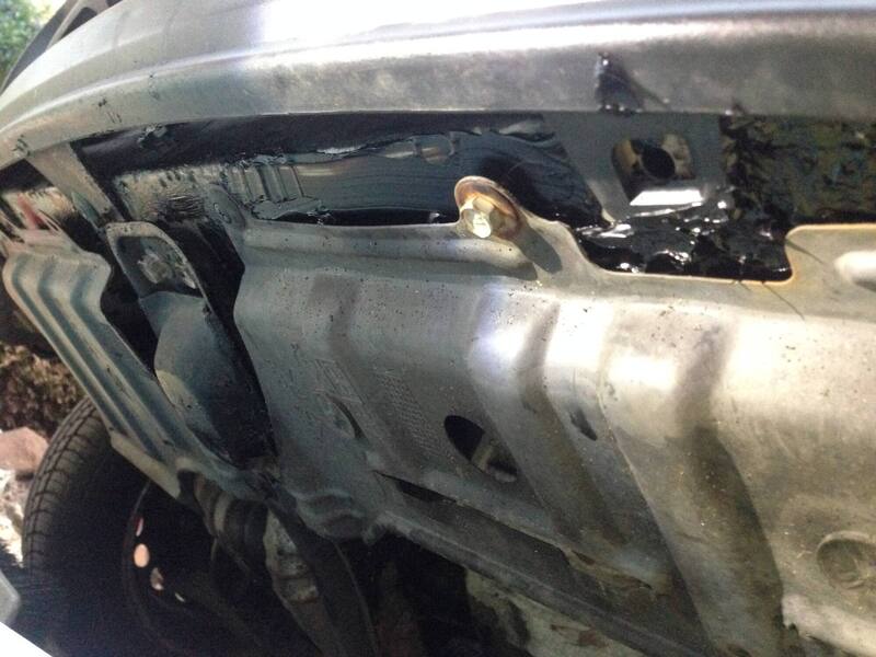

Fumbler Posted June 23, 2019 Author Share Posted June 23, 2019 Had a peek at the front crossmember yesterday. Not too bad at all. Only two 2mm wide holes on the bottom. It's had some repairs done to it in the past, but it's still solid as anything. The seams and everything look as good as the car, which is a nice sign. I couldn't cram Dynax into the seams because it's a bumper removal job and that would have had me working until 10:00PM just to get the bleeding thing off. With all things considered, the bad parts were in easy reach. This is after the undertrays were fitted. The entire bottom section has been slathered to within an inch of its life with underseal, after copious amounts of rust converter. This will be a good test to see if the situation is stopped dead. The underseal has some pretty strong anti-corrosion stuff in it too so it'll arrest what was left behind by the Jenolite. The sills weren't spared either. The final third of the sills on a Micra go and go badly so this should stop it. Fortunately, my sills aren't in bad shape. Here's the rear well with the blowing seams sealed and neutralised. Once I get an aerosol version I'll go over the suspension mounts. This stuff is thick as filler, and so a filler knife and stirring stick was used to apply the stuff. When I put this on ramps and when I have the aerosol I'll be able to get into all the nooks and crannies which a brush cannot get to. It also means I can spray into all of the voids and make them good too. This is really the only work that is needed on this car and I hope this will put that at bay for a decent amount of time. Up next will be a brake inspection and a gearbox oil change if I'm feeling rich. LightBulbFun, Shep Shepherd, The Moog and 2 others 5 Link to comment Share on other sites More sharing options...

Fumbler Posted June 24, 2019 Author Share Posted June 24, 2019 With the help from Micra forums and eBay, I might just as well get another (and more fully featured) K11 headunit. The other can then go to recycling. As I turned the car around last night, I can now look at the other side. All is well with the strangely creased sill, and the suspension mount and box sections are looking as good as the other side; some peeling underseal and the usual corrosion in the unpainted areas. I've given it the same rust converter treatment, although it's not really necessary because of what Bilt-Hamber puts in their undercoatings, but it gives me peace of mind. I also labelled the oil filter with the date of replacement. That'll help me schedule when I need to do it again. It also enabelled me to look at the rear of the front crossmember which is in perfect condition. Once my Dynax S-50 arrives it'll be getting some of that. Got invited to lunch at a friend's so the Micra will be my car of choice for travel! LightBulbFun 1 Link to comment Share on other sites More sharing options...
ETCHY Posted June 24, 2019 Share Posted June 24, 2019 That cross member looks good. Nice little Micra you've got there. Change the oil regularly & keep on top of any rust & it'll just run & run. Great little cars. Fumbler 1 Link to comment Share on other sites More sharing options...
