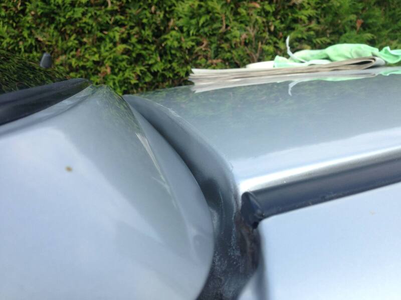

Fumbler Posted July 8, 2019 Author Share Posted July 8, 2019 After some sanding down of the loose paint and most of the rust, I attack roof with primer. A damp sand and some replica paint later I come to this. The masking has left a thick lip between the old and new paint surfaces, so next I need to use thinners on the lip to smooth it up to the original paint and then laquer a couple mm forward of the lip in the picture. Then I have to wait for 2 weeks for the stuff to harden before I buff the section of the roof smooth again. LightBulbFun and Shep Shepherd 2 Link to comment Share on other sites More sharing options...

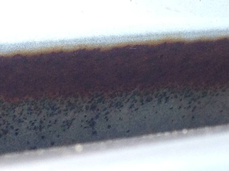

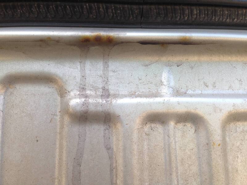

Fumbler Posted July 28, 2019 Author Share Posted July 28, 2019 Today I removed the rear bumper... With the mission to eradicate this... ...and a whole bunch of other bubbliness. I originally set out to only respray the rear slam bar but that in itself is a semi-permanent fixture in the rear bumper as seen here: The nuts at the top were the ones outside the car and so were very, very, very hard to undo. I will find new ones eventually, but as they're nuts with incorporated washers I might have to settle for a more conventional setup. All finished. I ran out of primer, which is the perfect excuse to buy some zinc-rich stuff instead! This car needs a good run, mainly because I'm using it to pass my driving test and so it's been doing piddly little runs meaning the engine is not warm and so it running rich etc. etc. LightBulbFun, BL Bloke, Shirley Knott and 4 others 7 Link to comment Share on other sites More sharing options...

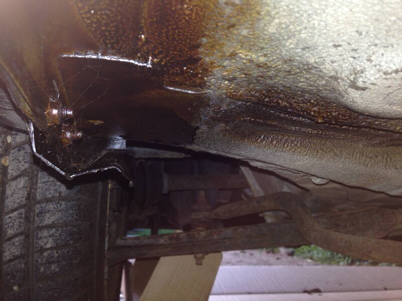

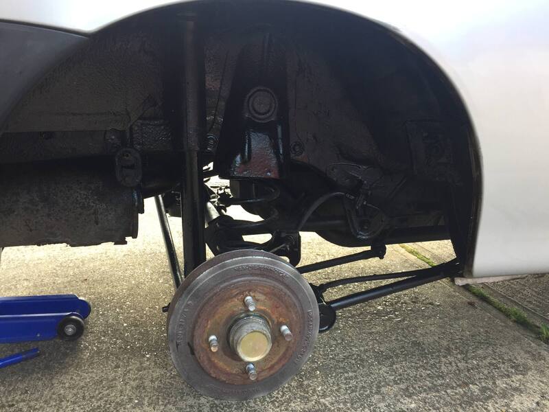

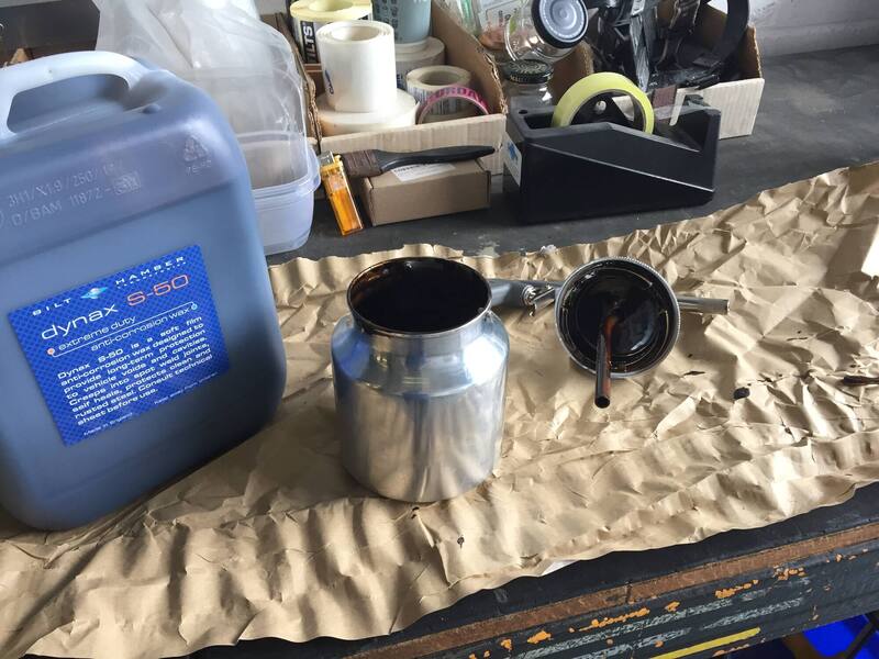

Fumbler Posted August 19, 2019 Author Share Posted August 19, 2019 How time flies! I decided to break in our new compressor by testing this Dynax S-50 stuff. And here's the results!. I probably should have taken the wheel off, and I will next time, but the finish is very good. In light of the report I posted in the grin thread, I am confident I'm doing the right thing to my car. Here's the undercoating gun I used. It is very good for what it does! This particular one is made by Silverline and it pretty hard to find on eBay, but for £15 I'm not complaining. It isn't clogging and has an adjustable spray as well, which is a feature all of the front page undercoating guns don't have. I filled up the can to about 1 inch. The can the gun fits to is 660ml, however, Silverline does provide a full litre can as well for a good price. Most of the 1 inch of jollop went in the wheelarch and the rest went on my rear axle and box sections. I'd say this part is good for now! Also messy. Next entry will be the entrance of the Land Cruiser. I've been told I'm doing the oil change! Shirley Knott, theshadow, LightBulbFun and 3 others 6 Link to comment Share on other sites More sharing options...
Fumbler Posted August 20, 2019 Author Share Posted August 20, 2019 But wait, there's more! Nearside wheel arch. Did this one with runnified Dynax UB. We'll see which product wears off first! Because I took the wheels off this time I could also hit parts the gun missed. That's nearly all of the rear done. Will need to have it on a lift just to get the final few places, but, for the most part, the rear is done. jumpingjehovahs, LightBulbFun, theshadow and 5 others 8 Link to comment Share on other sites More sharing options...

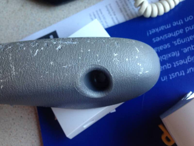

Fumbler Posted August 27, 2019 Author Share Posted August 27, 2019 Just a quick question for today, as I'm pretty sure other pre-facelift K11 owners will have had/have this problem: This is what my driver's door armrest looks like. On the right I've scraped away the material and on the left the stuff is crumbling away in my hands. It's a foam blank that is then covered with plastic in a mould. I have found some Plasti-dip that is the same colour as the underside which isn't faded, but if that fails (for example, if it tarnishes really quickly or rubs off because that is a feature), is there another approach to making these good again? Link to comment Share on other sites More sharing options...

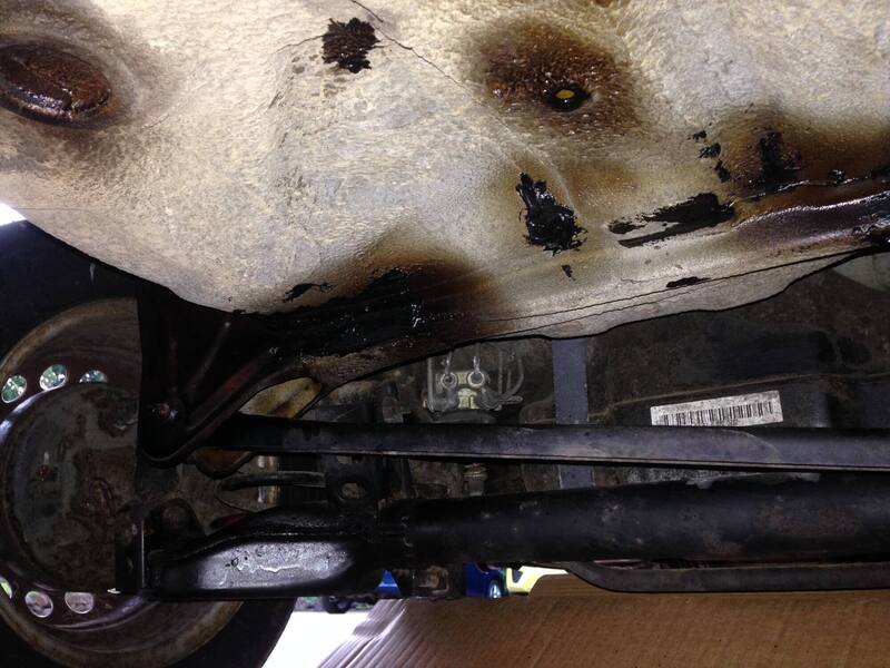

Fumbler Posted September 11, 2019 Author Share Posted September 11, 2019 So before the magnificent passing of its MoT we did some preparation to make sure it went a little more smoothly. This happened. As usual, drips everywhere and is a right bugger to clean. Which is good as it needs to stay on for a long time. Then, on the N/S, I uncovered this. The chassis has already been painted by something before that is glossy and black. Methinks Hammerite was used because farm, and it was only sprayed on this face. Undercoated it anyway because requirement. We'll try to forget its there. Luckily, the wheel obscures it. Replacements found. Fitters? Not so much. Dealership it is then! Oh, and there's this. It's right where the wheelarch and the rear wing meet and are welded. Obviously needs more welding or leaving alone because lazy. Did spray stuff in there so it should help. Rear brake pads need replacing as well as rustproofing the front. Apart from that, all is well. Dan302 and theshadow 2 Link to comment Share on other sites More sharing options...

Zelandeth Posted September 11, 2019 Share Posted September 11, 2019 On 8/27/2019 at 2:28 PM, Fumbler said: Just a quick question for today, as I'm pretty sure other pre-facelift K11 owners will have had/have this problem: This is what my driver's door armrest looks like. On the right I've scraped away the material and on the left the stuff is crumbling away in my hands. It's a foam blank that is then covered with plastic in a mould. I have found some Plasti-dip that is the same colour as the underside which isn't faded, but if that fails (for example, if it tarnishes really quickly or rubs off because that is a feature), is there another approach to making these good again? Bit of a kill or cure...but I'd maybe try going over it very carefully with a hot air gun...it might melt the plastic on the surface enough to smooth it back out and stop it flaking off. Or it might make it twenty times worse. Find a scrap one to experiment on. Link to comment Share on other sites More sharing options...
Fumbler Posted September 12, 2019 Author Share Posted September 12, 2019 18 hours ago, Zelandeth said: Bit of a kill or cure...but I'd maybe try going over it very carefully with a hot air gun...it might melt the plastic on the surface enough to smooth it back out and stop it flaking off. Or it might make it twenty times worse. Find a scrap one to experiment on. Would definitely be a kill because the plastic itself has degraded into something that isn't a plastic. Luckily however: Some sanding and grey Plasti Dip (the real stuff!) has made the handle come up really good. It's also lovely and non-slip too! I'll be adding another coat to this as well as doing the passenger door pull. This time I'll document every step in the process in case it helps anyone else. 18 hours ago, brownnova said: That Micra looks like a nice little thing! The early ones are getting rarer! They are indeed. Finding spares for this car is a bit of a headache. It'll need an exhaust soon as it appears to be straight piping itself! My Computer Science teacher had a Micra Vibe from the same year up until June when it failed its MoT for heavy suspension corrosion, sunroof generated corrosion, and no sills. Shame really because I wanted his wings and door pulls! rainagain and Lord Sterling 2 Link to comment Share on other sites More sharing options...

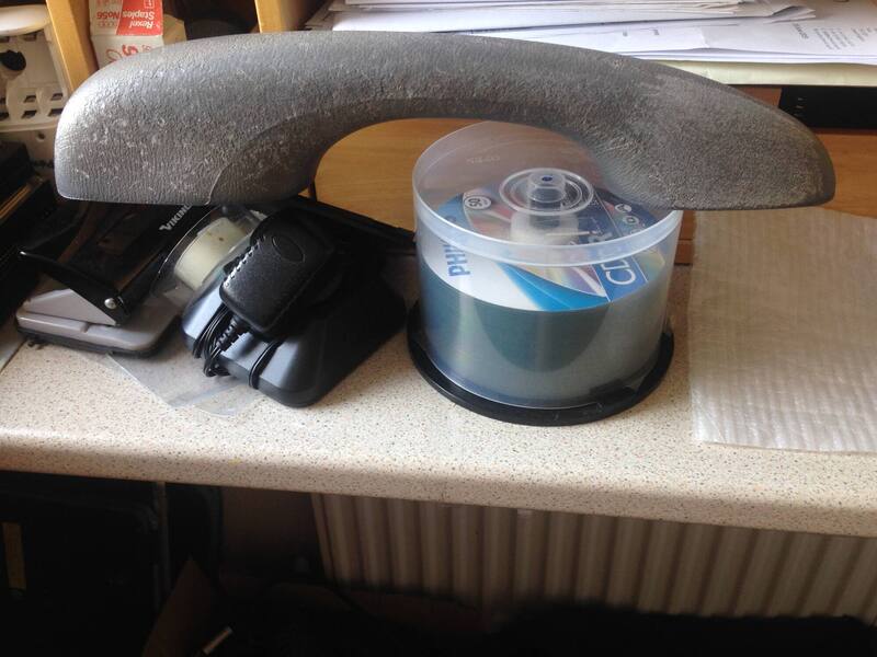

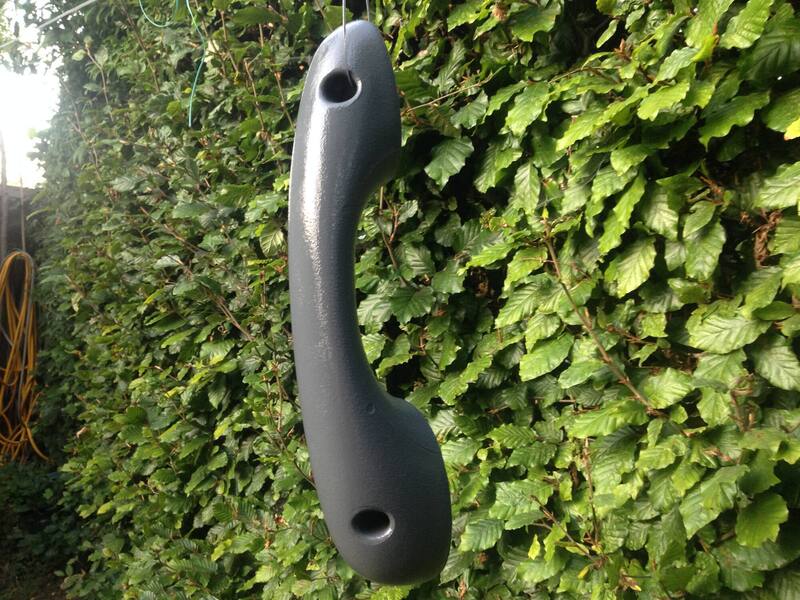

Fumbler Posted September 15, 2019 Author Share Posted September 15, 2019 Now that my door handles are complete, I hereby present The Guide to Restoring Your Door Handle/Pull Things! Are your Micra's door handle/pull things looking tired and worn out? Are you tearing your hair out at the prospect of no fix? Then carry on looking! No, but seriously, this is how I did it and it worked out quite well. Firstly, remove the handle from the door. The screw size isn't Phillips or Pozi-drive, it's a cross between the two. Be prepared to have small metal shavings come out. They are screwed on pretty tightly. Use the largest PZ screwdriver you can find; they fit the best in the slot. Next, use 80-grit and 120-grit sandpaper. Choose finer after this if you want a smoother finish. If I had more choice, I would have gone higher. When looking straight at the centre of the handle, you will see a tanline. The plastic colour will go from a light, yellowish grey to a dark grey. The dark grey plastic is still good and won't come off. It looks like this: Where the plastic colour goes back to grey is where you sand to. This is because the stuff that's still good hasn't degraded into a loose powder and it won't sand off. It is illustrated much better in this picture. The plastic will literally crumble away and come right off, whereas the good stuff resists abrasion and scratches very well. Use the 80-grit paper to remove the bulk of the material. It will go down to the foam underneath. Make sure you don't focus on one area as the foam is fairly brittle and flat spots will appear. Once the bulk of the material has been removed, switch to the 120-grit so smooth out all of those scratches. Use higher grit counts to remove them entirely. When you think you're done with the sanding, wipe down the handle with methylated spirit or some other alcohol product. I wouldn't recommend white spirit and acetone as they'll most likely dissolve the foam entirely. In the picture above the you can see where I missed a few places and so I went back at it with the 120-grit until a finish I wanted was reached. Repeat this step until desired finish is reached. Wipe down again and leave for the amount of time to have some coffee and attack again. I did this in the morning as the coating takes a long time to dry. The next job is painting the handle. Preparation is the key so I didn't do any. However, it is recommended that you prime the handle/pull with a thick primer, preferably the stuff that is sold by the Performix company. It'll need a good fe coats of primer to seal up the foam to make sure it doesn't soak up the coating. This is the first coat of Plasti Dip. The instructions say to lay it on thick so an even, wet consistency is reached. I used the Gunmetal Grey Plasti Dip, which can be found on Amazon for around £13.50. Surprisingly enough, it's a very near perfect match for the original colour! This is the real Plasti Dip made by the company that invented it, so it is imported from America. This can mean stocks may go out for long periods of time however. Hang the piece in somewhere that is open and has space around it, because this stuff is THICK! The main reason why you need primer becomes evident here. The foam soaked up the coating in no time. After leaving it to cure outside for an hour, take inside so it can fully cure overnight. Coat no.2 went on a lot better and less stuff was soaked in this time. I had to spend around 10 minutes outside spraying the exposed foam areas to keep up with the rate of the stuff being soaked in. Luckily however, the more coats you do, the less obvious any scratches appear! Yesterday morning I put a third coat on which went on even better and gave better results. It's probably best more should be added. Add more coats until satisfied with the finish. Leave for a day to harden up. The finished look should be like this: Now you can see some scratches and foam, however it's a bit more like the original textured finish the handle should've had. And here's the finished article! Looking back to what it did look like, I can say this is a definite 150% improvement over what it originally was. It also shows how bleached the other plastics are, however they aren't in bad shape so there's no point, right now, to go and fix them. Now, there are some differences in what this was like and what it is now. The handle was a foam with plastic outside handle. The plastic had a textured finish. Unfortunately, I couldn't make the same finish on my handle. If I had a remanufactured one, then perhaps I could make a silicone mould, but part of me wonders if it would be worth the effort. Secondly,this Plasti Dip is a non-slip, matt finish. This means it could be classed as sticky to the touch or unpleasant to hold, however, this does go away a fair bit once the stuff has fully cured. It is also a matt coating. A separate Performix glossifier coating can be bought but I have no experience of it and no knowledge if it is sold here. Apart from that, I'm very happy with how this turned out and I hope this helps someone somewhere! chodweaver, Dan302, adw1977 and 3 others 6 Link to comment Share on other sites More sharing options...
Dan302 Posted September 15, 2019 Share Posted September 15, 2019 That looks a tidy job, looks loads neater Link to comment Share on other sites More sharing options...

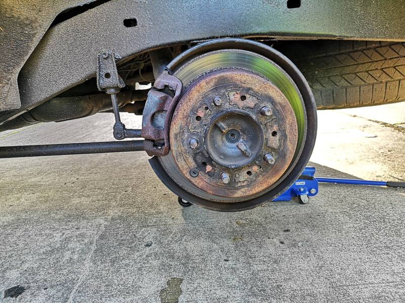

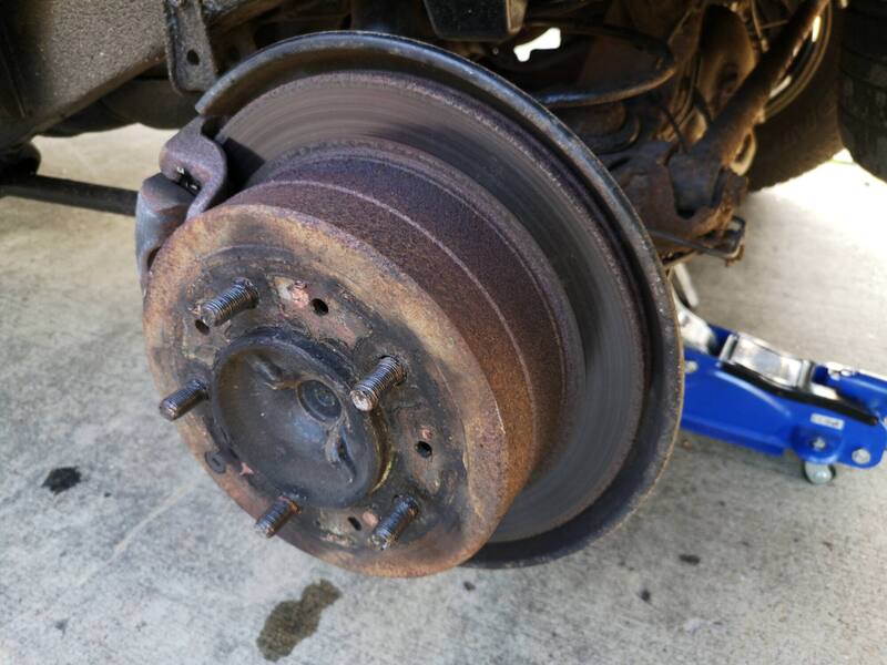

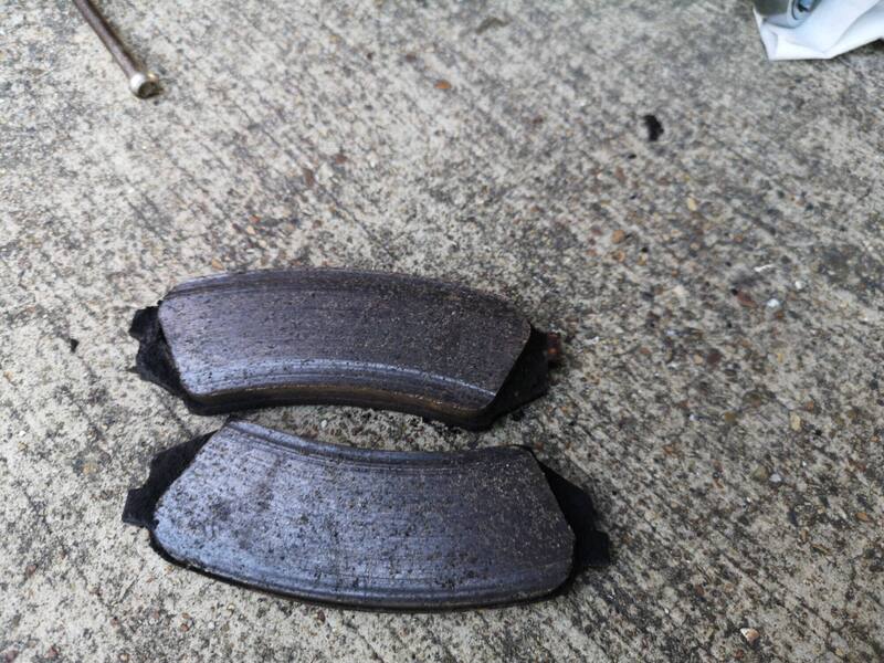

Fumbler Posted October 6, 2019 Author Share Posted October 6, 2019 My brother's other half is visiting for 6 months come Tuesday, so some Land Cruiser preparations were done today. Rear brakes were highlighted as thin when the handbrake was redone, and considering it'll be doing a trip around Scotland in the coming weeks, we thought this would be a good idea to do. Before: After! Brakes reportedly felt juddery after replacement. Upon closer inspection it was the pads wearing down all the corrosion on there. The original pads weren't too thin, but were wearing unevenly. Interestingly enough, the side that still had a black chassis had its caliper come off just fine. The other didn't. That was fun! Also sustained this after installing a water deflector to protect the offside front foglamp. This is because the arch liner is completely missing! Wooo! Painful! No news on Micra apart from the fact it will go on our ramps soon so I can jollop the front. Still delivering mega MPG though! Shirley Knott 1 Link to comment Share on other sites More sharing options...

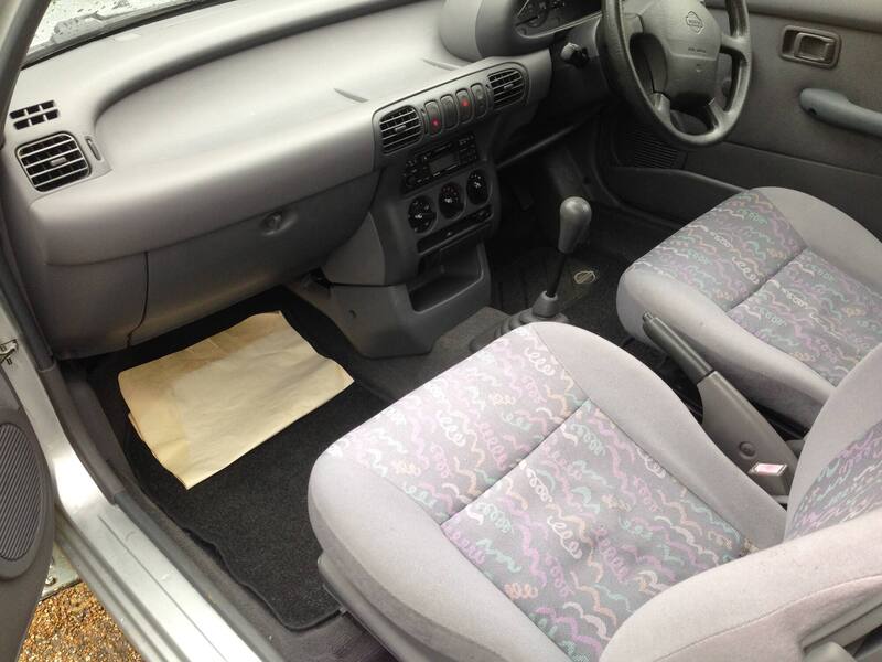

Fumbler Posted October 13, 2019 Author Share Posted October 13, 2019 So I was looking for some Nissan mats for the Micra, so I didn't mess up the carpet underneath. Well, @Lord Sterling had some and sent them to me. So it's a big thanks from me, to him, and after a quick wash in the machine they look great! These are brilliant and fit wonderfully in the car. A big thanks to His Lordship and these should last for a long time. chodweaver, jumpingjehovahs, Lord Sterling and 1 other 3 1 Link to comment Share on other sites More sharing options...
brownnova Posted October 13, 2019 Share Posted October 13, 2019 Looking great! Keep up the good work! Fumbler 1 Link to comment Share on other sites More sharing options...
Lord Sterling Posted October 13, 2019 Share Posted October 13, 2019 Great stuff. They fit better than I thought they would. Fumbler and w00dy 2 Link to comment Share on other sites More sharing options...
Fumbler Posted October 13, 2019 Author Share Posted October 13, 2019 43 minutes ago, Lord Sterling said: Great stuff. They fit better than I thought they would. They fit very well, plus the securing clip does a good job so it doesn't move. Job jobbed! Lord Sterling 1 Link to comment Share on other sites More sharing options...
