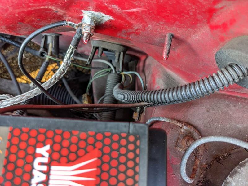

Fumbler Posted May 21, 2021 Author Share Posted May 21, 2021 So while I still umm and ahh over wheel and trim colours, I thought it prudent to begin diagnosing once and for all the issue with my starter motor not cranking the engine. Replacing the main earth helped, because it turns over faster than it did before, but the battery is too small. A very affordable Yuasa 096 size battery for BX diesels has since been ordered. The kindly folks on the BX forum pointed me in the direction of how to investigate things, namely whether the starter circuit had a relay added into it at some point. Disconnect the red spade connector and see if a relay clicks. I disconnected it and there's no click, so no relay retrofit. So, looking at the motor solenoid, we have 3 external cables connecting to it. The large lug at the top connects directly with the battery. I have no idea about where the crimped cable behind is going or what it's doing. Regardless, it's connected to the positive of the solenoid so it must be doing something somewhere... This is what a new unit looks like for comparison: EDIT: After reconnecting the spade connector, I checked to make sure the car still cranks over, but there a delay of half a second before anything happens. I wonder if the switch or solenoid is giving out. What does the hive mind think? I'll get out the multimeter tomorrow to see if it's still connected elsewhere. I have a suspicion that the cable in conduit is a replacement as it's newer than the rest of the wiring present, however that may be incorrect. Access is a bitch so fumbling around with a socket set and sandpaper while being pinned in place with the intake manifold might be entertaining. Link to comment Share on other sites More sharing options...

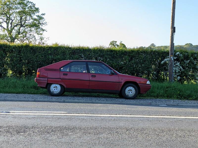

Fumbler Posted May 29, 2021 Author Share Posted May 29, 2021 At long bloody last. Write-up tomoz. jamescarruthers, mercedade and Crackers 3 Link to comment Share on other sites More sharing options...
Fumbler Posted May 29, 2021 Author Share Posted May 29, 2021 Tested the new wheel colour on a piece of spare steel I had. I rather like it. mercedade 1 Link to comment Share on other sites More sharing options...

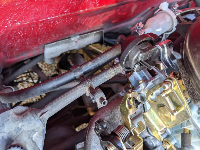

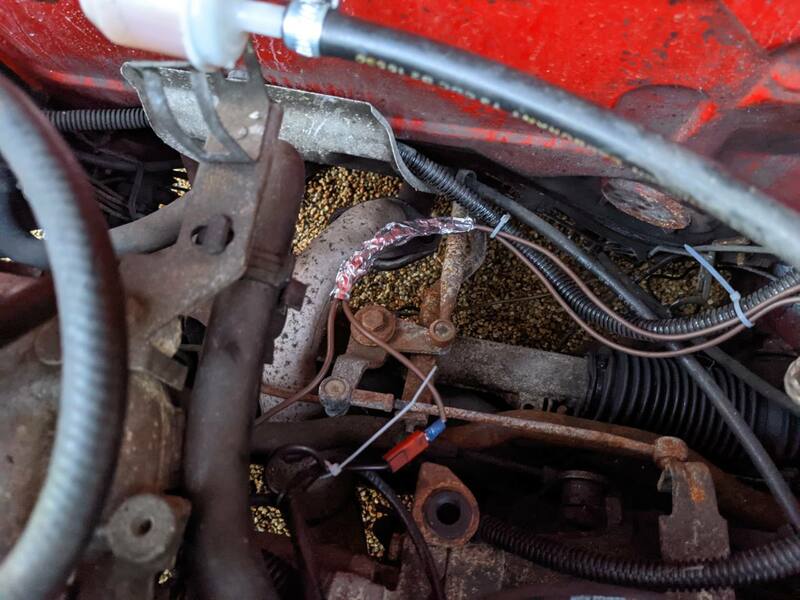

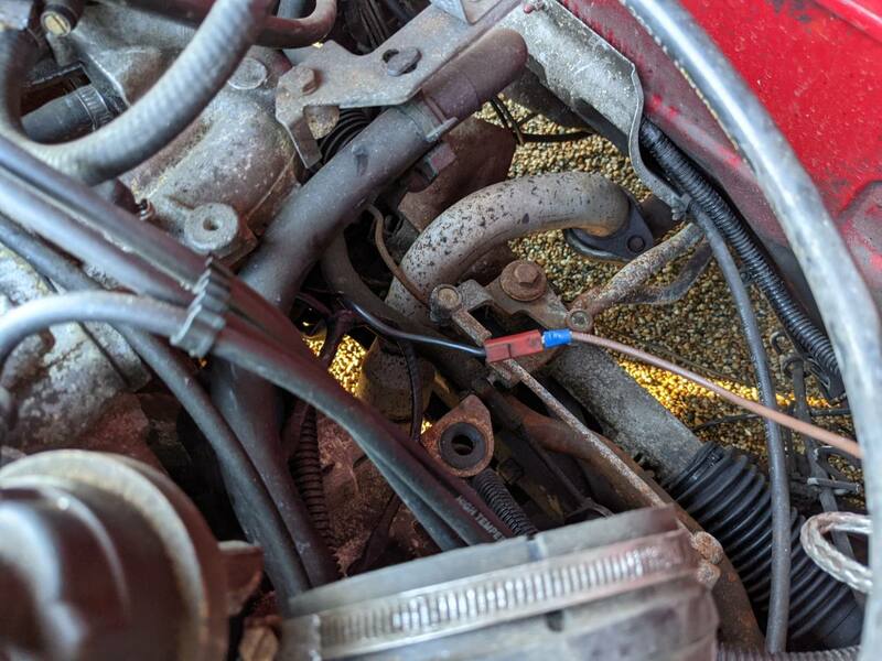

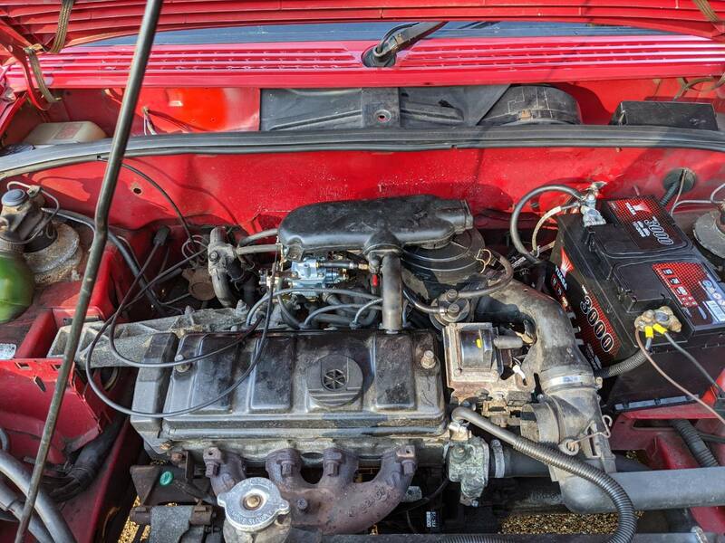

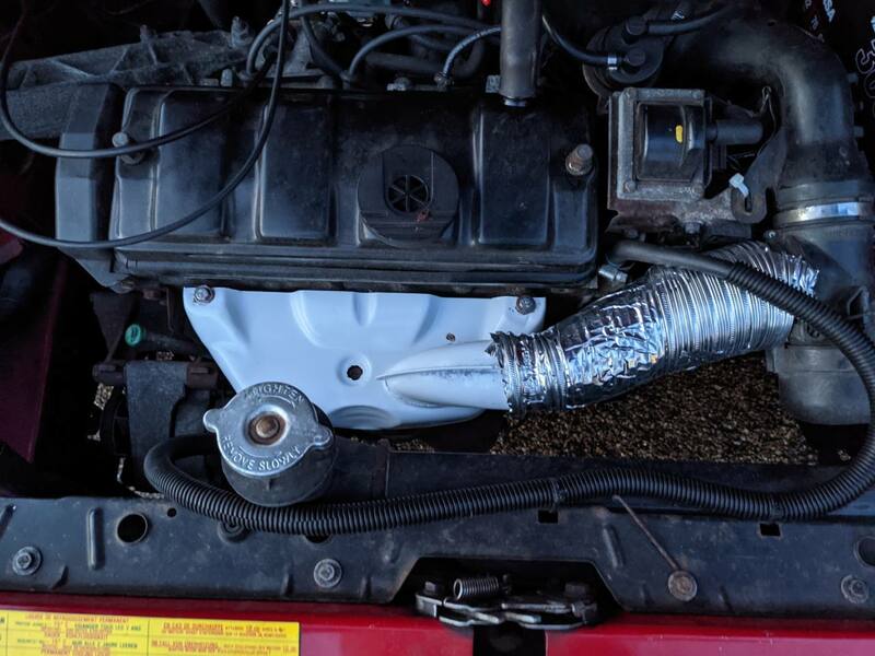

Fumbler Posted May 30, 2021 Author Share Posted May 30, 2021 OK, let's start with the previous day's efforts. I install a transparent relay on the bulkhead relay bar. That blue wire you see is the coil negative. That's attached to the relay fixing via a crimped lug. The black relay next to it is the coil relay. It's nice having it so accessible. I then run my wires through the flexible conduit running through the bulkhead and down to where the main loom is. I'm using standard UK/EU colour 2.5mm cable as it's very easy and affordable to get. You'll notice I also crimped a lug onto the original auxilliary earth, so that's now sorted. The solenoid switch connection is removed from the solenoid and attached to one of the brown wires I ran down the conduit. In doing this, the current from the ignition switch is diverted to powering the relay's coil, which is a much less strenuous load. Look at all this free space I have! Some aluminium tape is used for some heat shielding. The cable is ziptied to the brake wear sensor conduit and enough clearance for the airbox and other things is made. No tangles or snags here. Green means good. The circuit works. After testing, I wired in my permanent feed to the solenoid to the battery. This consisted of running a brown wire from the positive battery clamp to the common terminal of the relay. The wire going to the starter motor was then connected to the Normally Open terminal, meaning the engine will turn over once the relay is energised. By doing this, the load on the keyswitch is significantly reduced. Floatylight, LightBulbFun, The Moog and 3 others 6 Link to comment Share on other sites More sharing options...

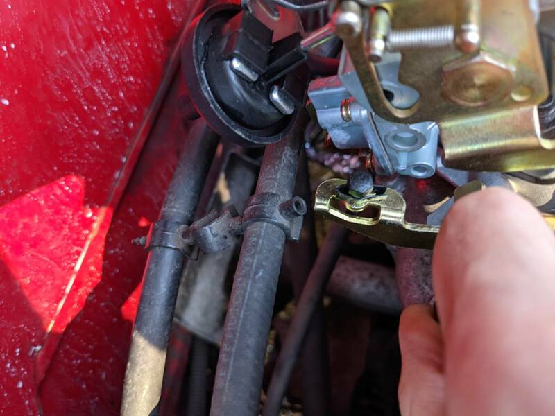

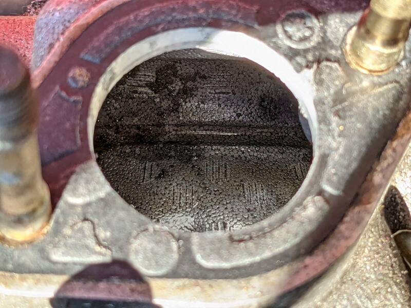

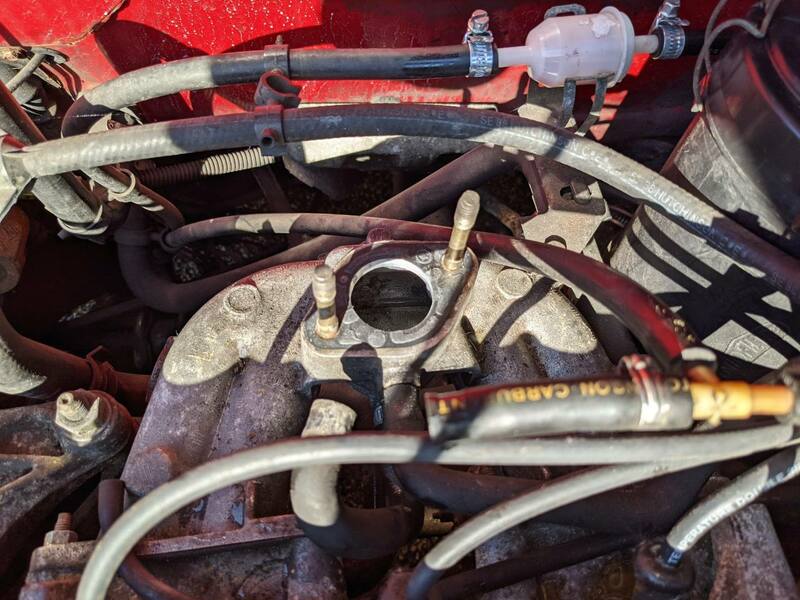

Fumbler Posted May 30, 2021 Author Share Posted May 30, 2021 PART TWO! And a picture heavy one, so be warned. The old one And it's gone. The gasket was new and wasn't torn, the new carb's base is the exact same as the old one so it plopped on with no trouble. Interesting to see the manifold was cast using polystyrene. I thought they'd use die-casting considering how many engines used this manifold. These are the coolant channels at the carburettor base. They were plugged up tae buggereh with aluminium corrosion and other shite. Basically they were useless. Plonked the new one on and began plumbing it in. Modification The First was reusing the old choke cable mount as the new one doesn't have tapped holes. The thread is something like an M4 or 5 which I can tap and get a replacement bolt for tomorrow. Throttle cable installed and tensioned along with the choke cable. Air intake modified and installed. We're done here. Once the engine was running and up to temp the heater matrix was bled and carburettor was tuned. The mixture and idle speed were adjusted and I'll read the spark plugs later on when I put more miles on it. The carb was originally set incredibly rich, making the engine backfire through the neck.. So I went on a test drive. And noticed the throttle was sticking. It was hitting this spacer clip. I relocated it. Also ziptied the wrongly-sized fuel filter to its bracket and added jubilee clips to make everything safe. I still need two more for the fuel pump outlet and the input to the carb. One thrash later, it's parked up in the layby. I'll upload a mini test video at some point. Sufficed to say, it definitely feels different to drive. More responsive and zippier. Up next, WELDING! That can wait until the end of the week. I'm knackered. (and some more engine work like fitting the heater cowel etc.) mercedade, The Moog, LightBulbFun and 8 others 11 Link to comment Share on other sites More sharing options...
Fumbler Posted May 31, 2021 Author Share Posted May 31, 2021 Paint Fit Looks slightly less gash. We'll see how this holds up. The car won't start when warm if you let it sit for 10 or so minutes. The ignition module wasn't at fault, could the float level in the carb be the problem? Also topped up the oil. It was never fully filled when I bought the car. The Moog, Coprolalia, mercedade and 1 other 4 Link to comment Share on other sites More sharing options...
Fumbler Posted June 1, 2021 Author Share Posted June 1, 2021 Bloody cars. I ask ye. So, the symptoms today include: Lots of cranking when cold to get the car coughing and then eventually firing Lots of cranking around 30 minutes after parking up, to get the car coughing and then eventually firing. Given it puts up exactly the same fight when starting in these situations, what may be the cause? I have, so far, replaced the ignition module as those do have problems. However, I can't decifer whether this is fuelling or electrical related. Could the float level in the fuel bowl be part of/the problem? TIA. Because of its poor performance today, the Micra will be taking me to work for the rest of the week. Sodding thing. Link to comment Share on other sites More sharing options...

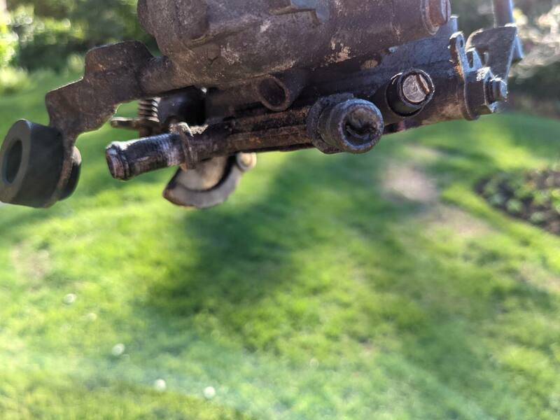

Fumbler Posted June 2, 2021 Author Share Posted June 2, 2021 This evening, I are have mostly split both carburettors in half to see what's different. The good news is that not much actually is on top: I swapped over the floats and needle valves. The old carburettor's needle valve appears to admit a larger volume of fuel and this was reflected by the engine being easier to start. This is the valve that was on the new carburettor. It's weird and funky. The way it acts when coupled with the float makes it rather restrictive. However, on the bottom (and not pictured helpfully), the main jet on the new carb is slanted upwards towards the bulkhead. The only way to access it is via a huge nut in between the coolant connections at the base. This also means I need to remove the carburettor to change the main jet if I wanted to. So, in the meantime, I examined the jets in the venturi: One from the old on the left, the new carb's on the right. I didn't swap these, as I suspect I'll need to change over the main jets at the same time. Fearing I'll fuck something up and ruin the idle circuit, I left the idle jet well alone. I can imagine that too is different. After getting everything buttoned back up, I made sure the engine got to running temperature and shut it off. I'll return to it tomorrow evening and see if it's any easier to start. Coprolalia, The Moog, LightBulbFun and 1 other 4 Link to comment Share on other sites More sharing options...
Talbot Posted June 2, 2021 Share Posted June 2, 2021 Those, if I'm looking at what I think I'm looking at, are emulsion tubes, which admit a little bit of air back into the fuel under certain conditions and are often used to prevent the fuelling from going over-rich at high speed. The fact that the new unit has smaller drillings in the tube would suggest that it might run a little richer under some running conditions. Exactly what is hard to say, but it shouldn't make any difference to the starting. Fumbler 1 Link to comment Share on other sites More sharing options...
Fumbler Posted June 2, 2021 Author Share Posted June 2, 2021 7 minutes ago, Talbot said: Those, if I'm looking at what I think I'm looking at, are emulsion tubes, which admit a little bit of air back into the fuel under certain conditions and are often used to prevent the fuelling from going over-rich at high speed. The fact that the new unit has smaller drillings in the tube would suggest that it might run a little richer under some running conditions. Exactly what is hard to say, but it shouldn't make any difference to the starting. It was more out of curiousity as I had a feeling these were more to do with running as opposed to starting, as I was wondering how much different the componentry between the two was like, and how that might affect the engine's performance. As it's improved performance (and probably economy too), this is more of a "let's see what this is like!" experiment, considering the valve assemblies and jet positioning in the float bowls are different between the two. Link to comment Share on other sites More sharing options...
