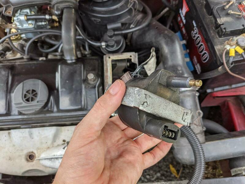

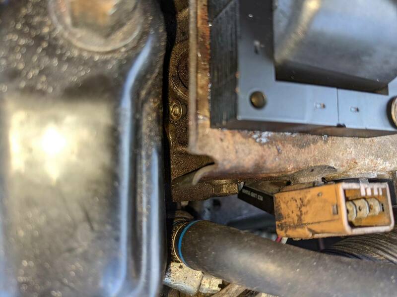

Fumbler Posted September 25, 2021 Author Share Posted September 25, 2021 All 3 Jobs done. I did the boot strut in the morning and didn't take any protos because, well, it's a boot strut. Not particularly interesting. Firstly, the coil: Remove old. Inspect hole, then coat the new coil and bracket with approved* grease- Trust me, it's designed for it! Then I lost a nut down the hole. I suspect what PSA wants you to actually do is dismantle the whole bracket and then replace the coil. Fortunately I had the magnetic stick to save the day. It doesn't help they're using 7mm nuts and bolts for this. Oh well... French. Even Lancia thought this was a bad idea. Using the same coil, they installed it vertically meaning you only needed 2 bolts to fasten it down. More automotive* grease applied to the threads and the heads of the bolts. Interestingly enough, if you flip the tub lid, it turns into dielectric grease, so that was smothered all over the terminals. OK, so with that out of the way and the car sounding beautiful, I moved onto flipping the carburettor lids. Yup, more fun to be had. I decided to do this because I was getting fed up with having to shim and pack out the intake to get it to fit on this fine* piece of Chinese workmanship. Frankly, I don't know why I'm bothering. I've bought a twin choke manifold now so I can call this done once and for all with a genuine carb that fits and has good parts support. Still, at least it looks clean in there. The Chinese workmanship on the choke is just excellent. I imagine they copied the design using loosely-done drawings. The indentations that allow the choke flap to slightly open under acceleration just don't exist. Not only that, but there is a ton of axial play in the choke lever, as if the bolt they used is too long. I did swap the springs over as the new one was springier. I'm sure it helps. Swapping floats and needle valves got us to here: I present to you the Frankencarb. It would be all roses and lovely if it went on without problems. Ha lolnope. The Chinese carb mating surface isn't flat at all. There's a high spot in the middle meaning the lid would rock about and not sit flat. What it needs is a thicker gasket on there which I'll fit if I can get one. But instead I did the right thing and just torqued the opposite ends down and started rounding out the screws. She's tight. Buttoned up, taken for a test drive and everyone's happy. It starts better when hot which helps. If anyone has a Solex 32/34, 34/34 or anything like that and wants to sell it, plz let me know thankz. wesacosa, mk2_craig, Dyslexic Viking and 1 other 4 Link to comment Share on other sites More sharing options...

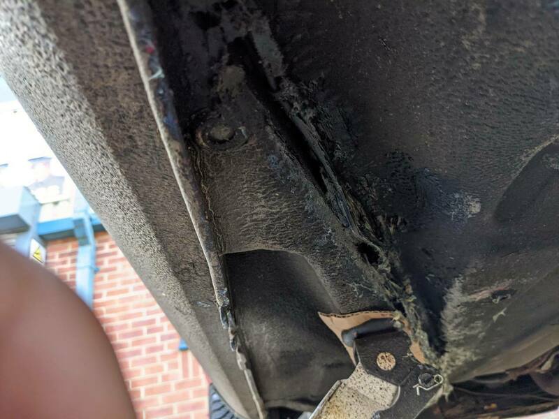

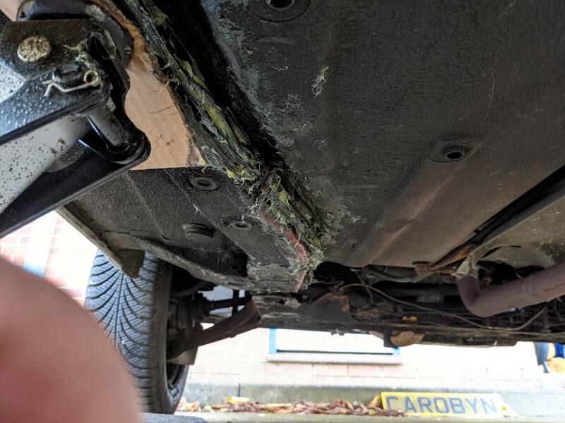

Fumbler Posted October 31, 2021 Author Share Posted October 31, 2021 PICTURE HEAVY- I have a bit to work through. Firstly: I had the ride height changed by Triple A. While it was on the lift, I had a look underneath. Here is what I found: Not a drop of rust. I'm impressed. Every suspension pipe has a shit ton of grease covering it and, subsequently, they've still got the black paint on them. I did my part and applied more today-# Over the winter I'll jack up all 4 corners and undercoat it with super thick oil, like it has had before. I'll cavity wax the chassis rails, sills, subframe and doors as well. I bought cans of the stuff months ago. Now onto what I went to Triple A for- I wanted to see why the front was sitting lower than the back. We adjusted the heights and prodded the linkages a bit in the hope that it'd fix itself. Nope. It's not fixed. There is still something wrong with the linkages as the suspension height selector sometimes jams and won't go to full height, then sometimes it'll clunk back into poisition and work sort of fine. The car is driveable, which is good, but not correct. Selecting between normal and intermediate height only makes the front go up, but not down again. The rear stays where it is. We verified both height correctors work, so what's the deal? I think the next course of action is to send it up to Chevronics or somebody and get the height selector system refreshed. Something has fallen apart and is stopping the system from working correctly. The front end linkages are worn out and sloppy, but that doesn't explain why the manually selecting the height won't work and the ride is subsequently strange. It definitely isn't how it was. To distract me from this dilemma, I fitted new plates. This is what I was contending with: This is what I've got now Lovely stuff. Oh, the Jazz has been replaced by a Honda E. Jazz was sold back to Honda for a profit, despite us buying it 2 years ago. So there we go, it's now tucked up for the winter. I disconnected the tank from the fuel pump, ran the carburettor float bowl out of fuel and then connected up a bottle of Redex. This filled up the float bowl and pumped some down the return line. I dumped the rest down the filler neck. I'll continue working on it closer to Christmas, but the Micra will be commuter machine for the next 4 months. One parting shot- Coprolalia, LightBulbFun, Mrs6C and 8 others 11 Link to comment Share on other sites More sharing options...

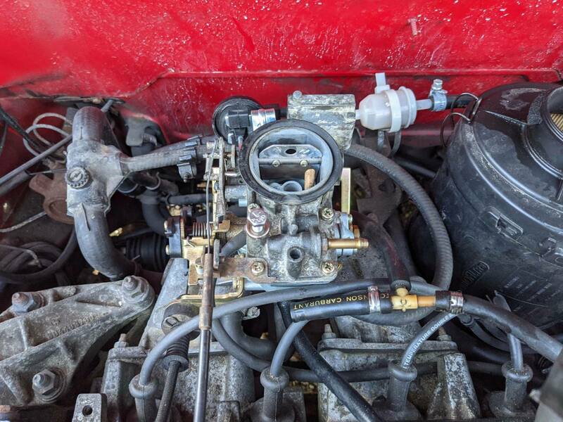

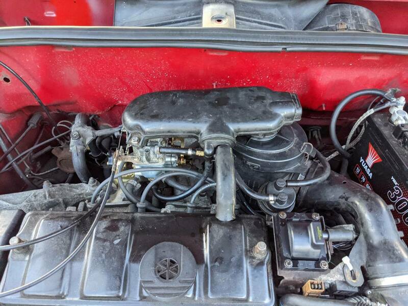

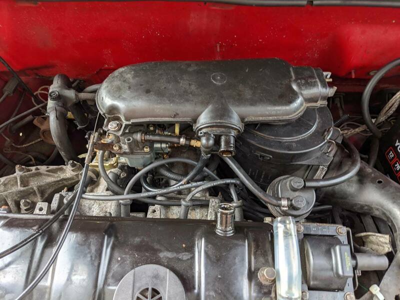

Fumbler Posted November 14, 2021 Author Share Posted November 14, 2021 In 2 hours of work I went from this: To this! I didn't take many photos, but here's what I've got. Goodbye New manifold and gaskets A quick test fit Finally installed Completed it m8 A few things were altered during install- firstly the anti-flood vacuum reservoir was removed as I needed a few more vacuum lines which I didn't have. I'm not too fussed about it. The choke is stiff and some WD-40 has helped with that. It could be better though. I've done a rough tune and it sounds lovely. Bled the coolant system and refilled with water. The car flies now. I rather like it. And now it's taking me to college. Again. Damnit 😆 Yeah the Micra's brake caliper isn't getting any better and is now stuck on permanently. I also just filled it up with petrol 🤦♂️ Mrs6C, GMcD, LightBulbFun and 7 others 10 Link to comment Share on other sites More sharing options...

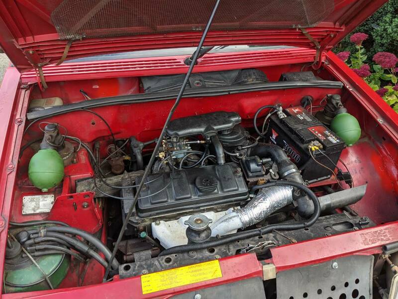

Fumbler Posted November 14, 2021 Author Share Posted November 14, 2021 As if by magic, the bloody thing has redeemed itself and wafted me to college. It stepped in after the Micra cooked it's nearside front brake and boy it's nice to drive in comfort again. The new carb has given so much power on tap, but it does need a new lid gasket as it's smelling of petrol a bit and is damp. Shite Ron, GrumpiusMaximus, Dyslexic Viking and 3 others 6 Link to comment Share on other sites More sharing options...
