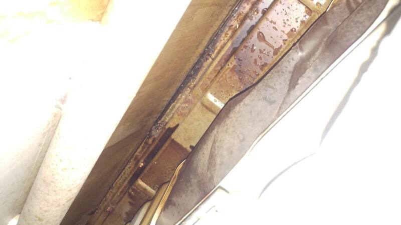

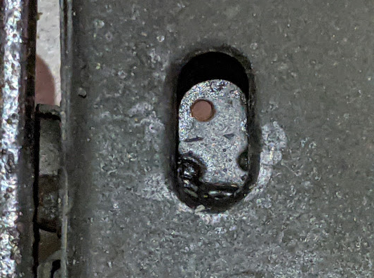

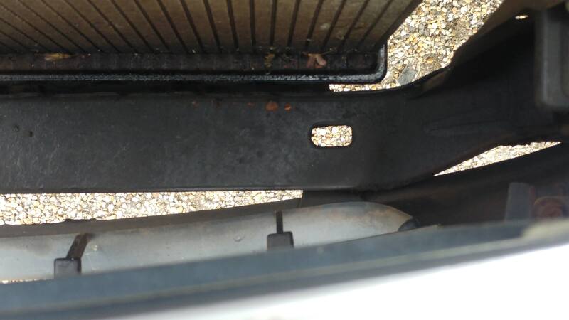

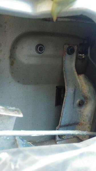

Fumbler Posted August 27, 2020 Author Share Posted August 27, 2020 Decided now was the best* time to fix the crossmember. It went well* After some hard whacking with a long toffee hammer I opened up another hole (left) and made the one I discovered over half a year ago a but bigger. What's weird is that in this spot there's no direct spot for noisture to enter and the main structural steel inside is fine: The thinner outer skin has corroded away. The only way I can think of it rotting out like that is through waterpooling up and seeping in the open seam where the holes are. Weird. Some cutting turned this... Into this! This newly formed drain hole was cut square and will serve a useful purpose later on. Some wirewheeling and Cardboard Aided Design had us make some repair sections which overlap the cleaned steel. Time to break out the welder. Tacked into place, shaped and then fully welded. Looks horrible, I know. Had to cut bits of bumper out to get access but it turned out good enough, plus I gave both patches a damn good thrashing with the panel hammer and they didn't budge or cave in. Happy times. Some zinc primer And a colour to blend it in really well with the rest of the metal! I'll go back tomorrow to close off the square hole with some metal and self tappers as it's really good for a wax injection lance to reach in and spray far and wide. Tomorrow morning I'll brush on some warm and runny wax undercoat which should conceal everything from view, while protecting it. Things learned: Accessibility: bastard Definitely a bumper-off job next time I do it which'll be soon-ish Welding upside down is the worst thing ever Next time, do welded repairs before undercoating as it gets everywhere when the metal gets hot. BL Bloke, BlankFrank, Shirley Knott and 4 others 7 Link to comment Share on other sites More sharing options...
theshadow Posted August 28, 2020 Share Posted August 28, 2020 posh zinc primer.... Link to comment Share on other sites More sharing options...
Fumbler Posted August 28, 2020 Author Share Posted August 28, 2020 8 hours ago, theshadow said: posh zinc primer.... Only primer I have at the moment. Thought I might as well give it a fighting chance! Link to comment Share on other sites More sharing options...

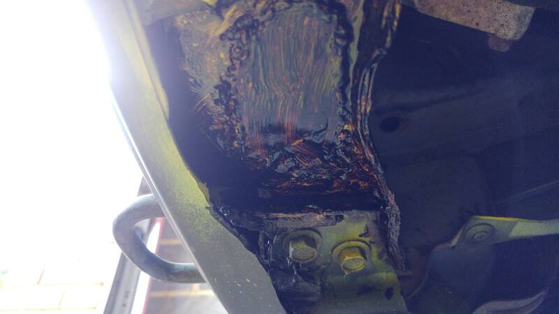

Fumbler Posted August 28, 2020 Author Share Posted August 28, 2020 Today was MoT day! First order of business: finish the work I left off last night. This involved, firstly, some Jamie Oliver style cooking: Followed by adding too much thinner and having to wait for the Dynax UB wax to harden up a bit more. Two coats applied, 15 minutes apart, while warm, which should help it seep into the (many) welding pores. Paint had dried nicely in the warm garage which was a plus. I'll overcoat again tomorrow as per instruction. Then it was time to put it in for its MoT, which it duly passed Although it seems I'll need to take apart the NSR drum apart to give it a clean. Tester blames it on the lack of use it's had meaning it's probably seized or binding up. For reference, the OSR drum gave 100KG effort, the NSR gave 60-75KG which was apparently "just passable." For those wondering about my welds of dubious integrity, be rest assured that they are only temporary until I can find an indoor area where I can take the bumper off, jack the car up, and have all the required access for a grinder and all those necessary items. Full-on replacement of the crossmember is on the cards but this'll hopefully slow the eventuality of that happening too soon. BlankFrank, BL Bloke, juular and 2 others 5 Link to comment Share on other sites More sharing options...

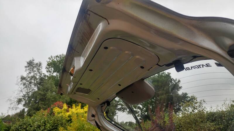

Fumbler Posted September 3, 2020 Author Share Posted September 3, 2020 Apprenticeship date is coming quickly so I pressed on with a few bits. Firstly, finished the crossmsmber for now by screwing on the drain access panel I made by welding some broken Meccano together fabricated. Looks utter shit but, fortunately, the area it's on is fairly non-structural- Coated in grease inside and out juuuuust in case tinworm tries sets in. I don't want to cover it in undercoat because I want it to remain visible enough that I know where to look should I need to go in the crossmember ever again. Then looked at the NSR brake assembly. Looks rather clean after a scrub with cleaner! MoT said the effort it produces was sub par so some stamping on the brakes by Father Fumbler and observation by me revealed that the cylinder is seized on one side. A quick look on Carparts4Less gives me a new one for just over £11.00 so that's been bought. Also got some new tyres fitted. Went with these lovely Nokian all-season tyres and they're lovely to drive on. If @HarmonicCheeseburger is still on the lookout for tyres, these were £42 a corner on Openio. Have a picture or 3: Nice deep treads. The difference is phenominal- no more wheel wobble (bad balancing and a flat spot or two), road noise has gone down, the ride is tons more comfortable and it's definitely a lot grippier. Manages potholes with ease now! Really happy with this Swedish rubber. Attached the NSR wheel to the drum while it was still in the air after some adjustment. It's alright, but the stop time for this side is something like 4 seconds, whereas the OSR is 1.5, both going the same speed. It'll do for now until the new parts arrive tomorrow... hopefully! juular, Shirley Knott, rainagain and 2 others 5 Link to comment Share on other sites More sharing options...

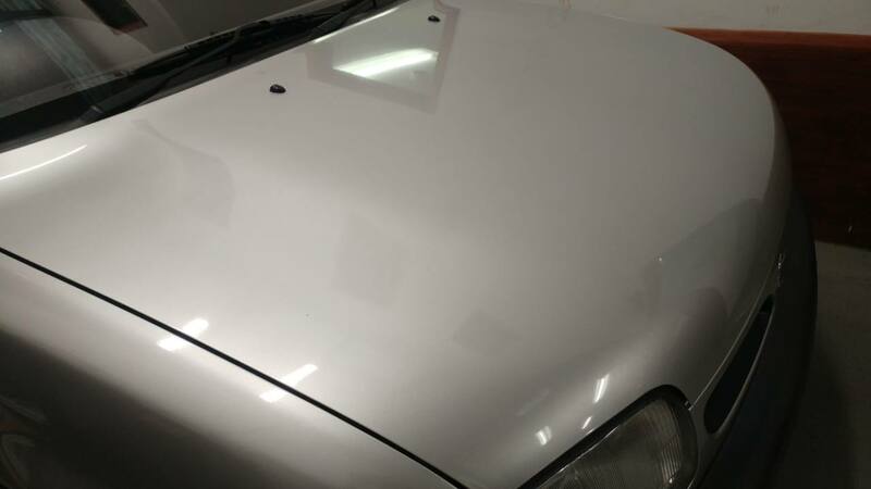

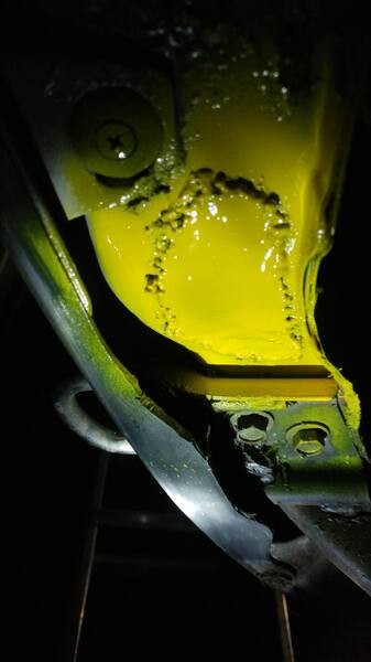

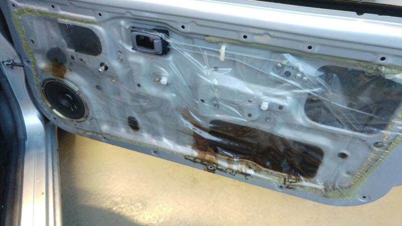

Fumbler Posted September 3, 2020 Author Share Posted September 3, 2020 Kind of an impulse thing, but some Bilt Hamber aerosol arrived in the post earlier this afternoon so I had at it and filled up every cavity and void I could think of with copious amounts of runny, sticky, greasy wax. As a direct result, the car has marked its territory! When I shut the boot, wax pissed everywhere: So I've left it open till sundown. That should* do the trick. The main aim was to get the crossmember flooded with the stuff so that was duly done. Went all the way up, down, across, sideways, diagonally and as far as possible with the improved injection wand. It's still dripping now and the areas I had repaired were filled up a good inch of the runny stuff. It's seeped into every seam, crack and cavity now, unlike last time. Also proves how open the seams in the crossmember are. Every gap was dripping by the time I had emptied the can. There's going to be a rather conspicuous outline when I drive again tomorrow. I hope the parents don't mind too much... I can imagine the same will happen on a hot day too. juular, Shirley Knott, Stanky and 2 others 4 1 Link to comment Share on other sites More sharing options...

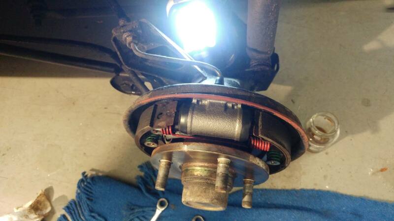

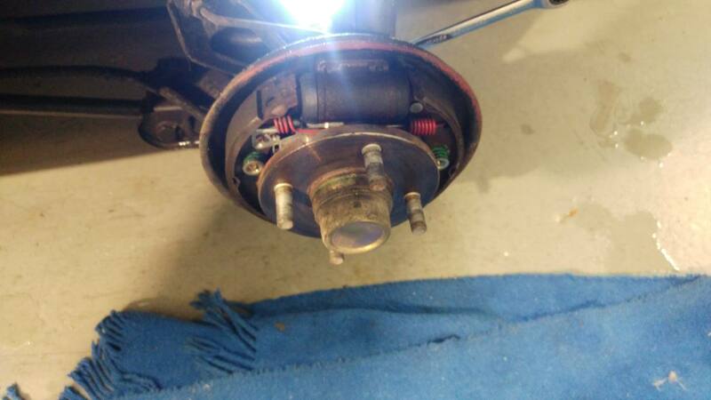

Fumbler Posted October 29, 2020 Author Share Posted October 29, 2020 Brake job. Took but an hour or two all in all. One ugga dugga later and the wheel was off revealing crustiness. Mmm... shiny new tools. Old one out. Quite crusty. New one in. Nice and clean. Brakes bled, no more skidding and the wheels stop well now. Job jobbed. Christine, LightBulbFun, Stanky and 6 others 9 Link to comment Share on other sites More sharing options...

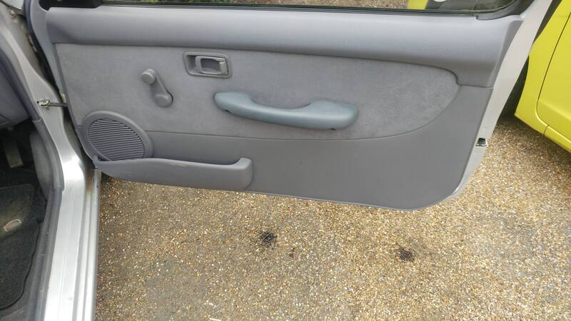

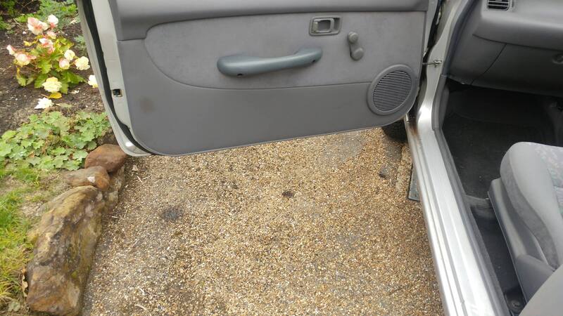

Fumbler Posted December 13, 2020 Author Share Posted December 13, 2020 On my final journey before returning home on Friday, this happened:- That makes 4001 miles done in my ownership. Wonderful little car! just under 800 miles to go and it'll receive a waterpump belt and fuel filter. In other news, I fixed the doorhandle that was broken off 6 weeks ago:- Prise off doorcard, Admire all the wax that's coated everything, peel back the polythene sheet and you have two 10mm bolts staring at you The rod to the right was one hateful bastard to refit. Much swearing and finger twiddling was made to get it to fit. All it does is rest on this stamped plate which opens the door when the handle is pulled up. Simple enough. Bonus wax footage of the inside. I need to flood whis one a bit more with the spraygun I think. Most of it has filled the seams though so it is doing the job. Next up will be welding in a patch on the sill and washing the underside. Generally giving it some love, as well as correcting the damage done to it by drunk numbskulls. The Moog and LightBulbFun 2 Link to comment Share on other sites More sharing options...

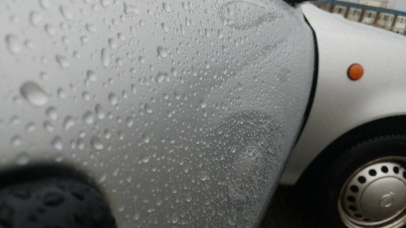

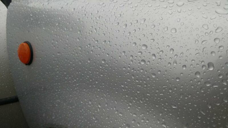

Fumbler Posted December 18, 2020 Author Share Posted December 18, 2020 Decided today I wouldn't weld the sill. The grotty circle there has got bigger and more oval though... Autoglym super resin polish isn't enough. Have some certified Shine Juice (Derek Approval pending): It's a weird runny liquid ceramic-like coating. Apply after going over your car with SRP and it makes it look very glossy... even if it's shit silver paint! Observe: Much glass very shine Just got these 3 deep scratches to touch up. Once these are gone, all visible evidence that someone walked on the thing is gone, which is good. Washer nozzles are also very glossy! In other news, the welded repairs are still intact That "access panel/drain thing" made up of welded Meccano and screwed into place looks very neat* but this Dynax S50 stuff has seeped literally everywhere, completely filling the gaps between the plate and the crossmember. Seen inside it's doing the job thus far which makes me happy I'll get some more time before I have to chop the thing out and replace it entirely. Typically, the heavens opened on the way home. Ho hum. Nice water beading though. Coprolalia and juular 2 Link to comment Share on other sites More sharing options...
