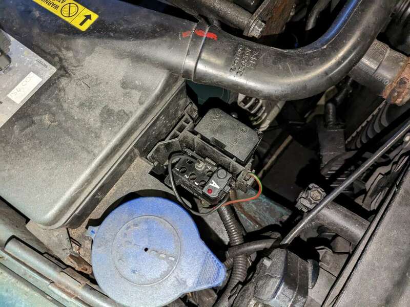

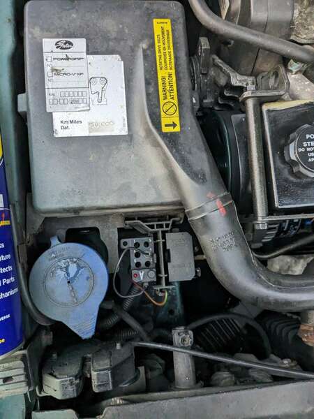

Fumbler Posted December 16, 2022 Author Share Posted December 16, 2022 @rob88hYou , sir, were right all along! I was just looking in the wrong place. It turns out it does have the blinky LED- it's just mounted to the front of the ECU box, next to the screenwash fill. TELL ME YOUR SECRETS Gave out code 121 on pin A2, which is the MAF faulty code. Cleared it and the EML is off. While test running the engine to see if all was well, I took some video. This is what happens whatever the engine temperature. It randomly hangs at certain speeds before going back to tickover. Off camera it all of a sudden started wavering between 2500RPM and 1500RPM without me touching anything. Odd. This is what the tachometer shows on tickover. The mic won't probably pick it up but you can hear the idle RPM slightly rise and fall along with the needle rising and falling. It's never once steady. Ghosty and rob88h 2 Link to comment Share on other sites More sharing options...

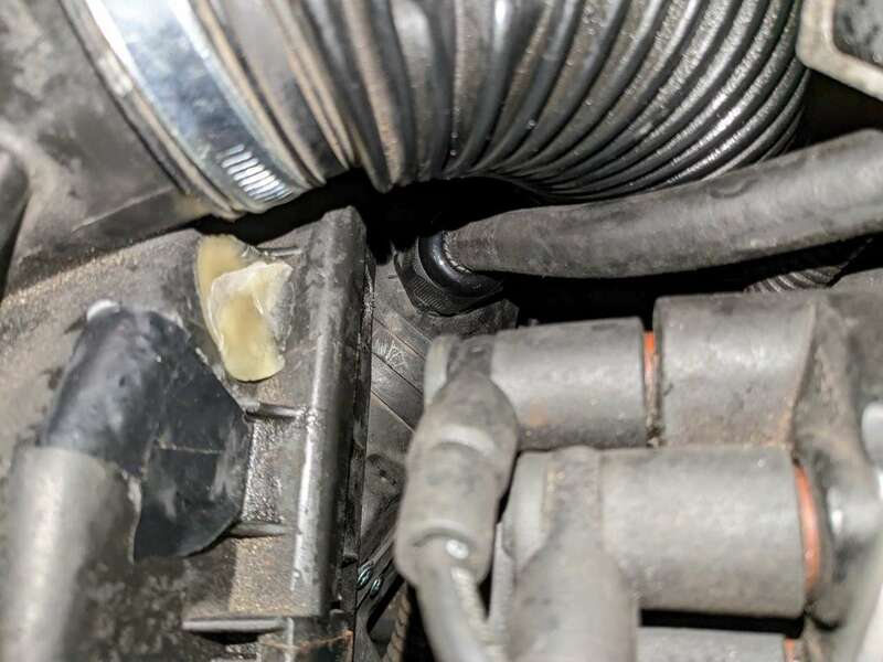

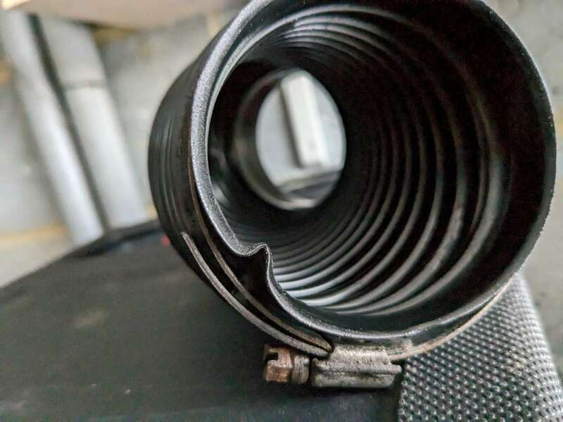

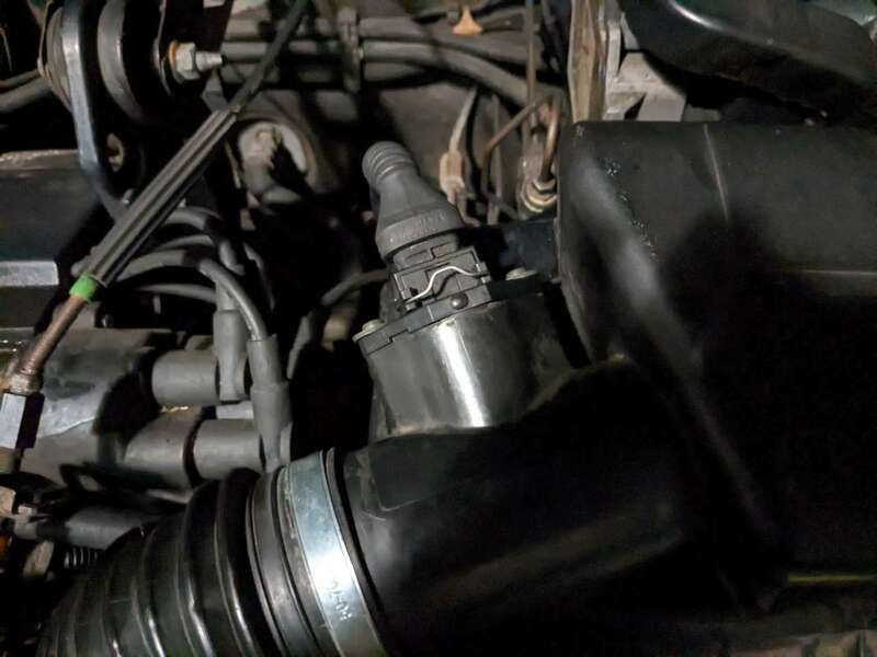

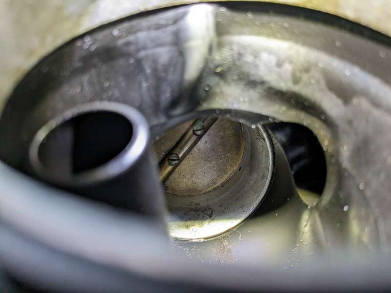

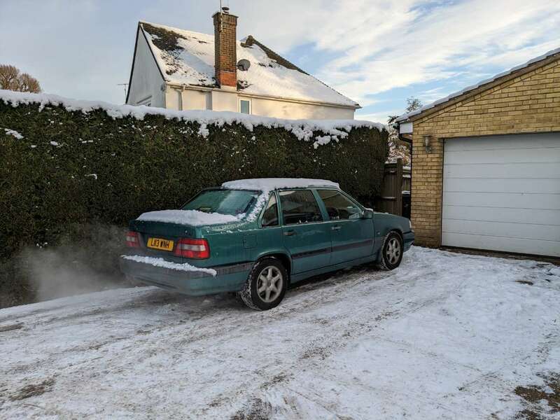

Fumbler Posted December 17, 2022 Author Share Posted December 17, 2022 Hobbled the car into the drive. The temperature here is still only going just above freezing. Hopefully that'll change tomorrow with the rain. SNOWY SLAB Before I got too cold I had a look at the intake hose, IAC and throttle plate. Squeaky clean. No problems here... Or here damn it. I found one crease which I straightened out and a really small tear near the airbox side. I then tried running the car without any MAF input again. Fell flat on its face. Hmmm, that can't be right! TELL ME ALL YOUR SECRETS! So with the MAF sensor reconnected and the engine run, I read the computer's mind again. I found: A2 (fuel/emissions) 111. Good, nothing there. EML cleared. A3 (ABS) 313. Reading around suggests either a computer fault or wheel sensor fault. As the ABS light turns on and then off again when I start the car, I'm not bothered. A6 (ignition) 131. No crank speed sensor signal. Light research on the forums indicates this can cause rough idling, bogging down, stalling upon startup etc. Ah-ha! Now to find one that's affordable... Back_For_More, HarmonicCheeseburger, Rust Collector and 4 others 7 Link to comment Share on other sites More sharing options...

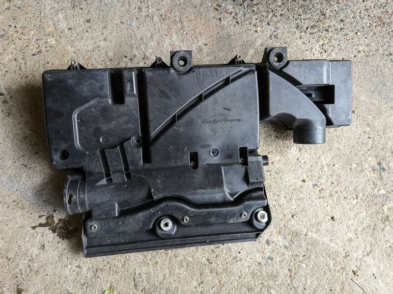

Fumbler Posted December 18, 2022 Author Share Posted December 18, 2022 I removed the air filter box to see how hard it is to get at the crank speed sensor. It's not very hard at all, which is nice. While it was out, I also did a modification to the preheater circuit on the intake. There's a waxstat on the bottom of the air box which moves a damper to either suck in hot air from around the exhaust or suck cold air in from just above the radiator. When the stats fail, they fail with the preheat side fully open and the cold air side fully closed- Bad for economy because the engine is sucking air through a smaller hose and bad for the MAF sensor because it's always receiving hot air. A solution to fix this is to remove the waxtat and spring an then secure the damper so the preheated intake is always blocked off- I used a couple of self-tappers. Helpfully* the foil hose for the preheated intake fell apart in my hands so that wasn't re-installed. I also relocated the cam cover breather hose, I put in, to the intake hose before the air filter box. With it installed where it was, I was crushing the air filter. I'll put a larger I/D hose in its place eventually, at least the glove test shows there's little to no pressure anymore. rob88h, HarmonicCheeseburger, Rust Collector and 2 others 5 Link to comment Share on other sites More sharing options...

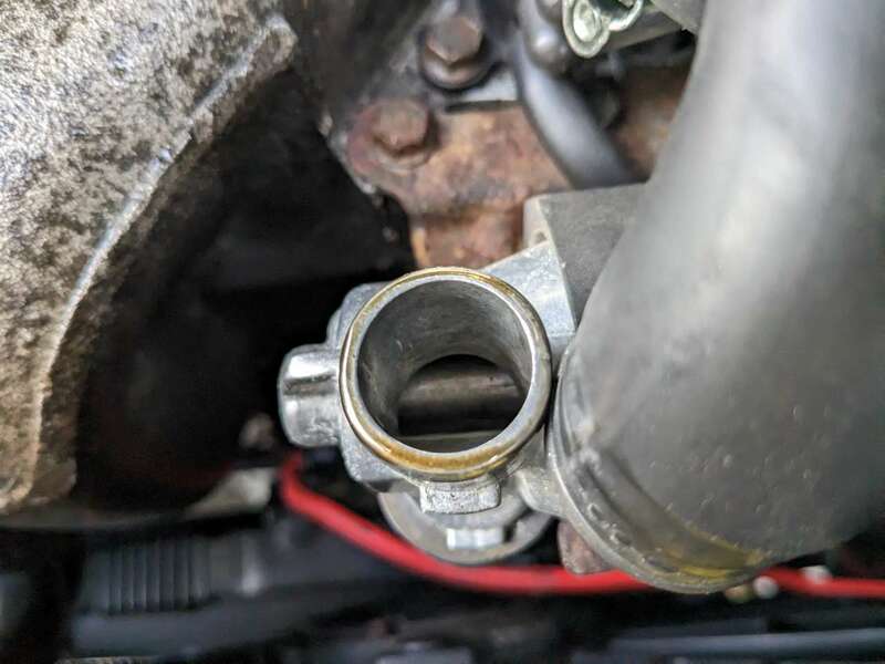

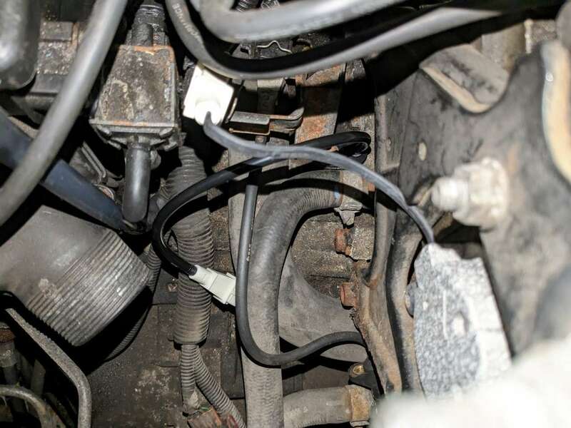

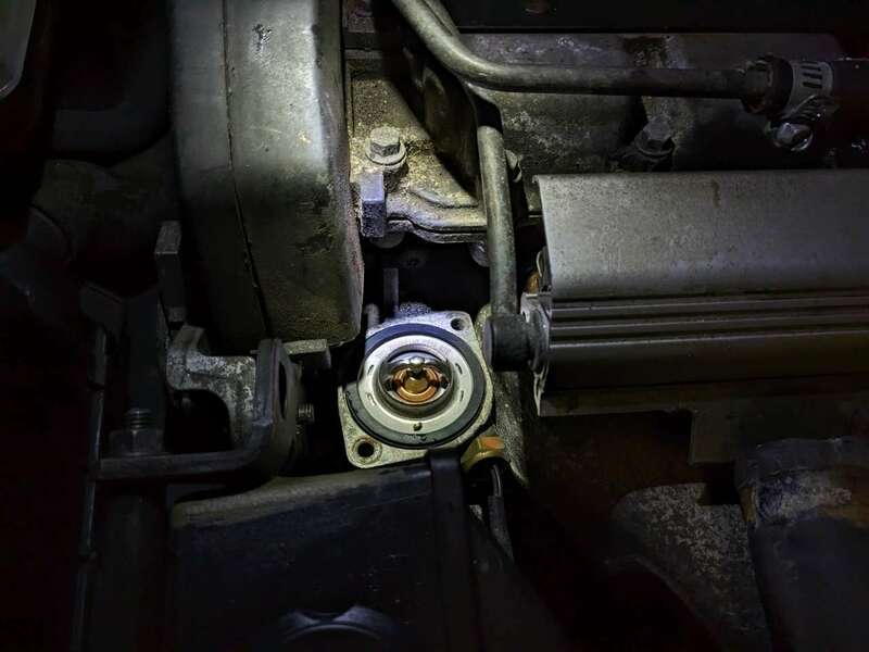

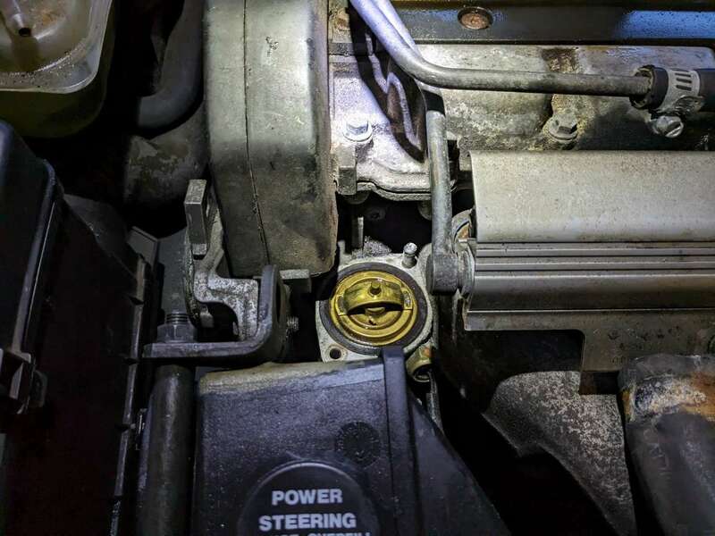

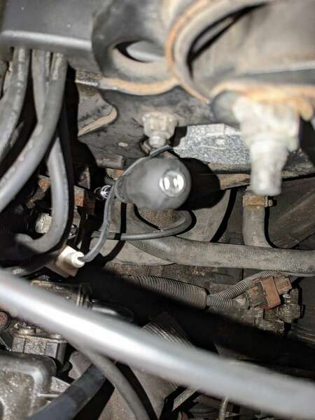

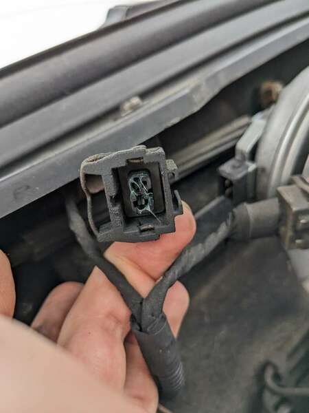

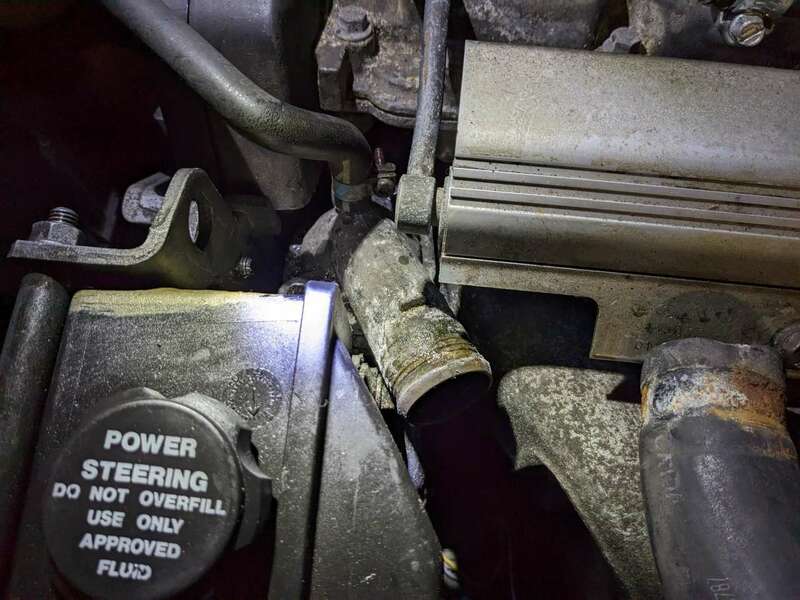

Fumbler Posted December 21, 2022 Author Share Posted December 21, 2022 On 19/12/2022 at 20:53, bear-in-the-air said: Excellent news! On a path to victory. Victree indeed. eBay's finest impulse sensor was delivered to my door this morning along with some thermostat bolts. Bonus Internet points if anyone can guess what the box is being propped up against. Access was easy- Helped by removing the exhaust preheater duct a few days prior. With the old sensor whizzed out I then whanged the new one in and connected it up. The old sensor wasn't an original one either. Seems aftermarket parts on these cars don't last too long. With the codes cleared on the ECU, it was time to test it OK, that's a bit better. RPM still a bit wobbly though. Computer's happy too. I then dug around @rml2345's bag of bits in the back and found another MAF sensor. This one looked promising because it had a Bosch logo (!!!!!) on it. I think I may need to buy a replacement air box cover, though. The screws aren't holding as good as they used to. Considering that, along with there being 3 MAF sensors in the car, I think this has been an issue for a while. Anyway, test time. Boo-YAH I'd call that good. In between doing all of this, I also had a look at the tensioner pulley I put on during the summer. Because it's not plastic, like the original one, I've found out it's not as wide and it wasn't positioning itself well when in contact with the belt- Tell you what this camera on the Pixel 6A is rather good. Way better than my old 4A. Anyway, it looks like it's just about covering all the belt, but I wasn't all that convinced, especially as the PAS pump pulley is slightly bent. I got the tensioner out. It's just two bolts, but good God it's a greaseball. My plan of action was find a washer to use as a spacer- You can see the pulley has already wiped away the layer of grease from it. It seemed to do the trick, so I bolted the pulley back on to the tensioner and then commensed a half-hour long struggle getting the bastard back in. I forgot how much of a pig it is to reinstall. I'm sure the HBOL says I need to dislodge the ECU box first etc. and I can see why, because the clips and lid dig into your hands while bolting it in. It may be just two bolts but getting it out is far better than putting it back in, especially when everything's an oily, greasy mess. My hands were Filthy As Fuck afterwards, so FAF that I didn't take further piccies. Soz. Sufficed to say the tensioner is nice and centred on the belt now. A test drive was performed. The car certainly feels happier, no more of this pesky RPM hanging when letting off the accelerator, no stalling on restart, no boggolizing when crawling in traffic. There definitely* wasn't a 0-60 pull involved (scientific purposes only!). For shits and giggles I did another glove test, now that the oil was nice and hot. I wish I hadn't because the glove inflated rather quickly😅. I have further plans and ideas I'll try. Anyway, happy car happy me. In other news, I also had a go polishing up my keyring I had to stop a few minutes after taking this picture because I found out it's nickel plated brass. Nice and shiny though! I even conditioned the REAL LEATHER parts too. It's looking rather good! My dad has a few of these which he got alongside his docs for the V70. Originally they'd have had the dealer's info on the back, but it's rubbed off on mine. Very faintly I could make out the logo for HR Owen, the London Volvo dealership that sold the car way back in 2000. rob88h, HarmonicCheeseburger, Remspoor and 3 others 6 Link to comment Share on other sites More sharing options...

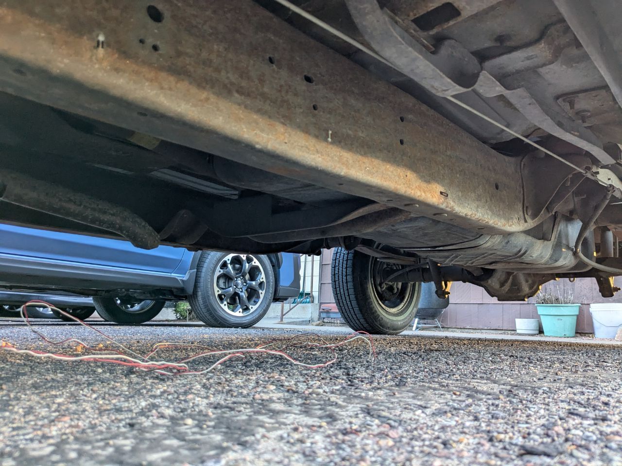

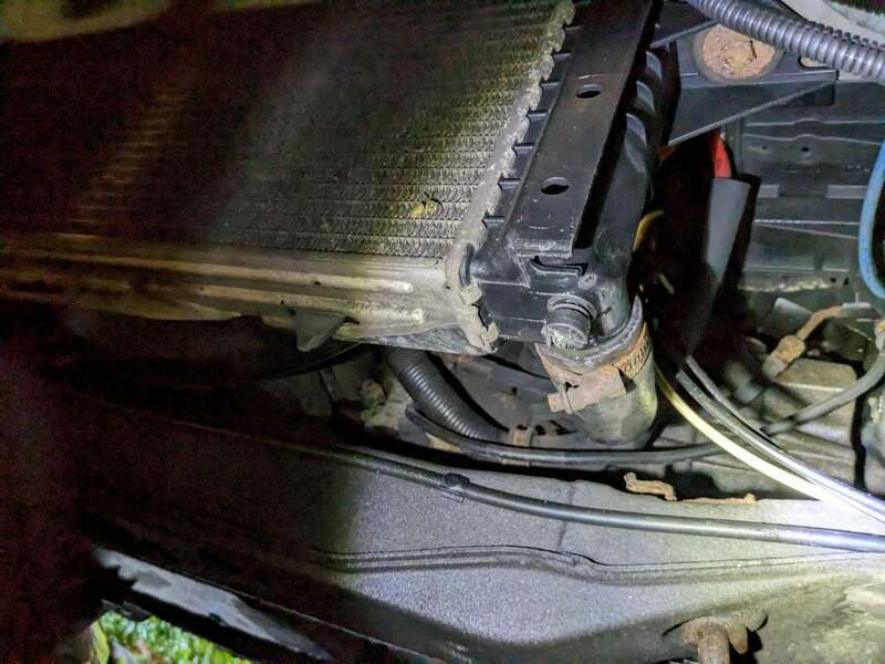

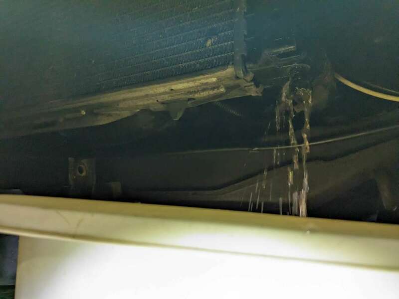

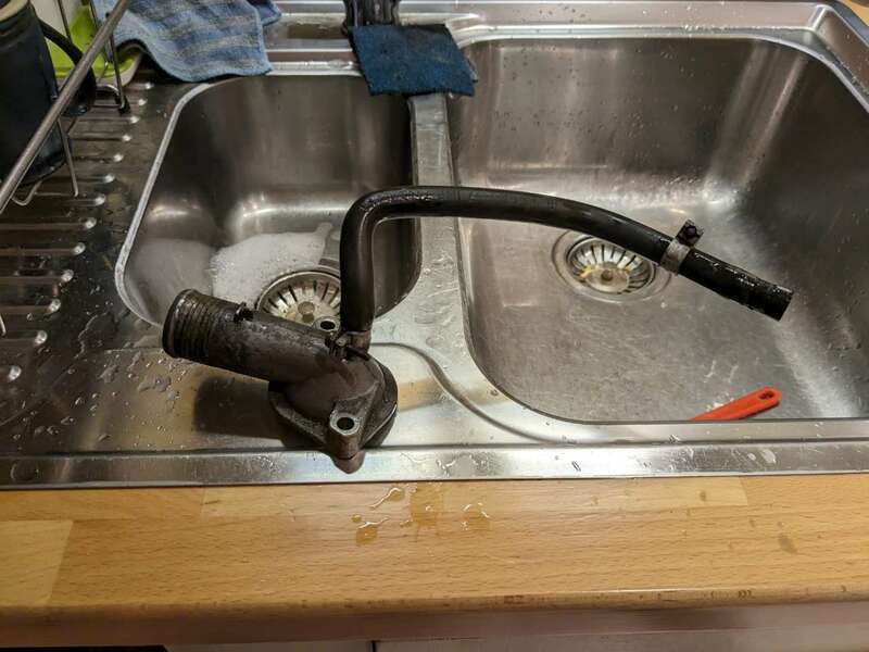

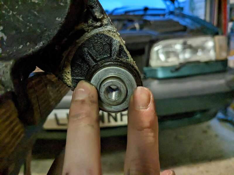

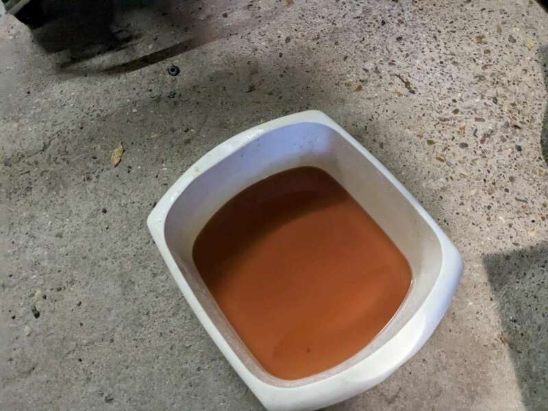

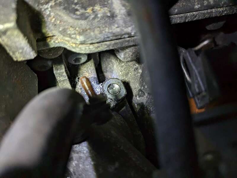

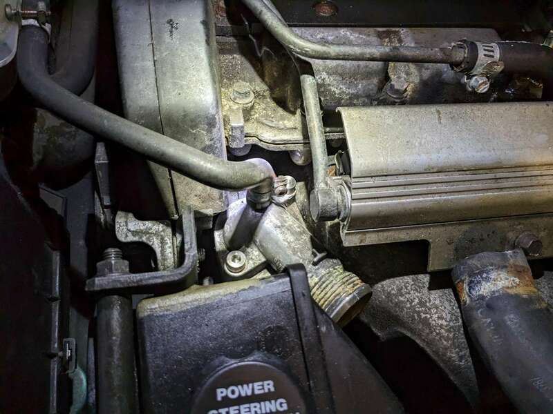

Fumbler Posted December 22, 2022 Author Share Posted December 22, 2022 Today's adventure takes us underneath the Swede Beast and to the radiator drain That looks a little chewed up. Actually before this I had to remove the undertray because the plug wouldn't unscrew. Subframe looks nice though, I wish the rest looked that nice! I have a sneaking suspicion this is a new rad as Volvo ones have a bleed nipple with a 13mm hex head on them. Got it in the end though. The coolant's even the right colour. Result! If you're wondering why I'm draining the coolant it's because I'm attacking this thing ...Just pretend there's a stripped Torx bolt head there for me, will you? Also pretend there aren't hoses attached to it... I dun goofed and left that for after the housing was loose. I followed the advice of Saint Robert DIY and used a 6 and 8mm HSS drill to drill the bolt heads off. It was a bit fiddly but with the drill turning slow and using a lot of patience I got there with minimal damage to the housing. The radiator hose was rather scary looking. I don't have a hose pick so I used a small Allen key to break the candyfloss bond between the hose and housing neck. It came off pretty easily which was a pleasant surprise. After I manoeuvred the housing out of the way I was greeted by a firmly stuck in Volvo thermostat. I decided to give everything a little clean before taking it out of its hole. This was the remains of the original bolts. Twiddling the bolt out of the farthest hole was nasty. I wanted to cut a slot in the top to accept a flat head screwdriver, but there was no room for my Dremel. I then gave the thermostat housing a bath in the "parts washer" so I could get rid of all the swarf and corrosion on the neck. It's now the cleanest item in the engine bay. Plop. Bleed pin positioned at the front like the old one. This 'stat is rated for 92 degrees as opposed to 90. The car doesn't seem to mind. And here is the housing all clean and bolted back in. I found some 316 stainless steel bolts which looked like they'd do the trick. I spun them in with copious amounts of copper grease so hopefully they don't seize in place again. Remspoor, Rust Collector, CaptainBoom and 3 others 6 Link to comment Share on other sites More sharing options...

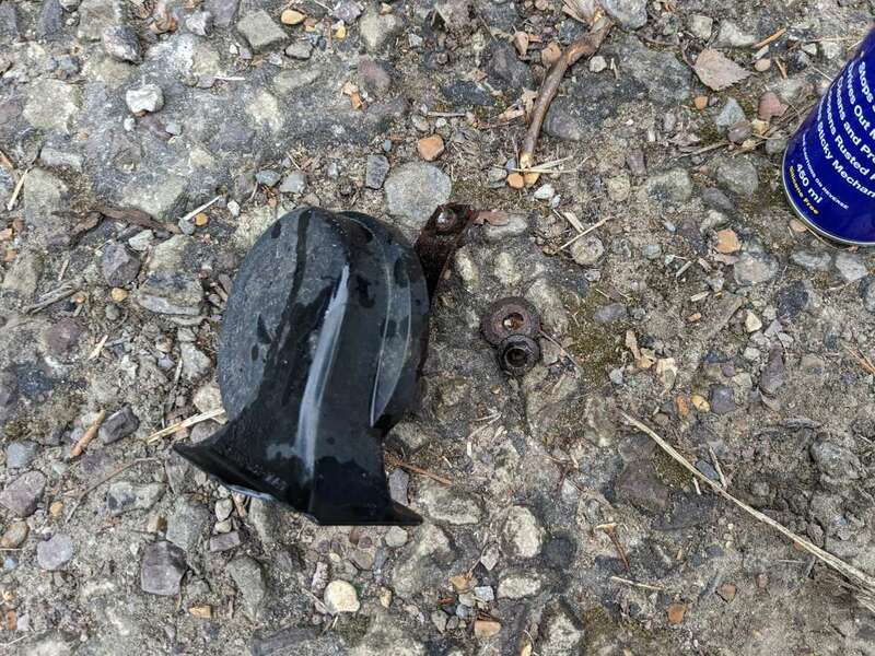

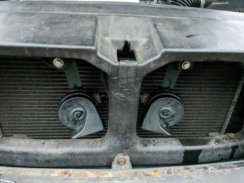

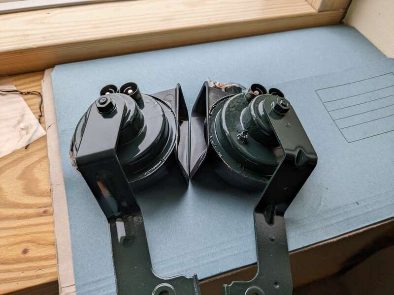

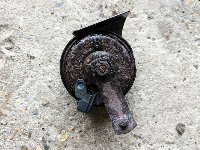

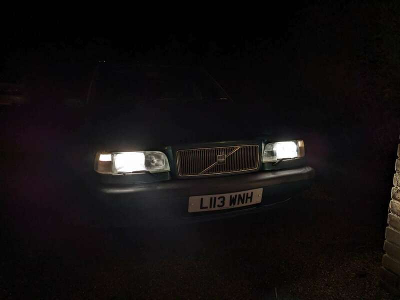

Fumbler Posted February 11, 2023 Author Share Posted February 11, 2023 I've been bodging in some new horns, because I discovered the car alarm does indeed work and I pinched its horn a few months ago. It turns out that getting a pair of front horns for an 850 is rather hard... well, if you don't want to be chopping plugs and stuff off, that is. So instead I decided to look at some newer models and found a pair from a 2003 S80 that looked like they'd work. "Good enough!" I thought, so I gave them a lick of paint- Drilled out the broken horn still on the car (I threw the other one away months ago)- Mmmm... crispy. I then attempted to plug the new horns in. Ah shit, they won't go. The bloody locator pin on this car's plugs is off-centre, whereas the plugs on the new horns are central! I don't know why, but the alarm loom has both types of plug. So, after a bit of a think, I filed the pin on the horns off and fitted them. Some bending and twisting later and they're in. It also looks like I need to jetwash the car. They make a pleasant noise too. LightBulbFun, AnnoyingPentium and rml2345 3 Link to comment Share on other sites More sharing options...

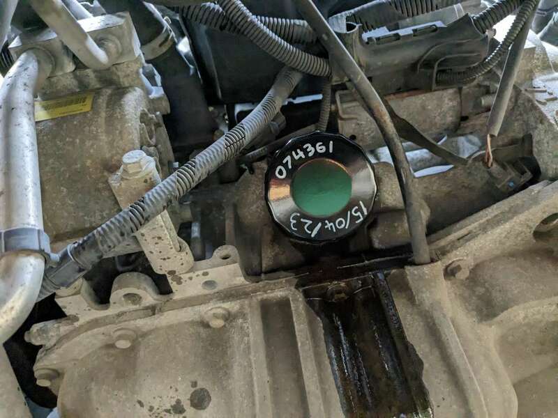

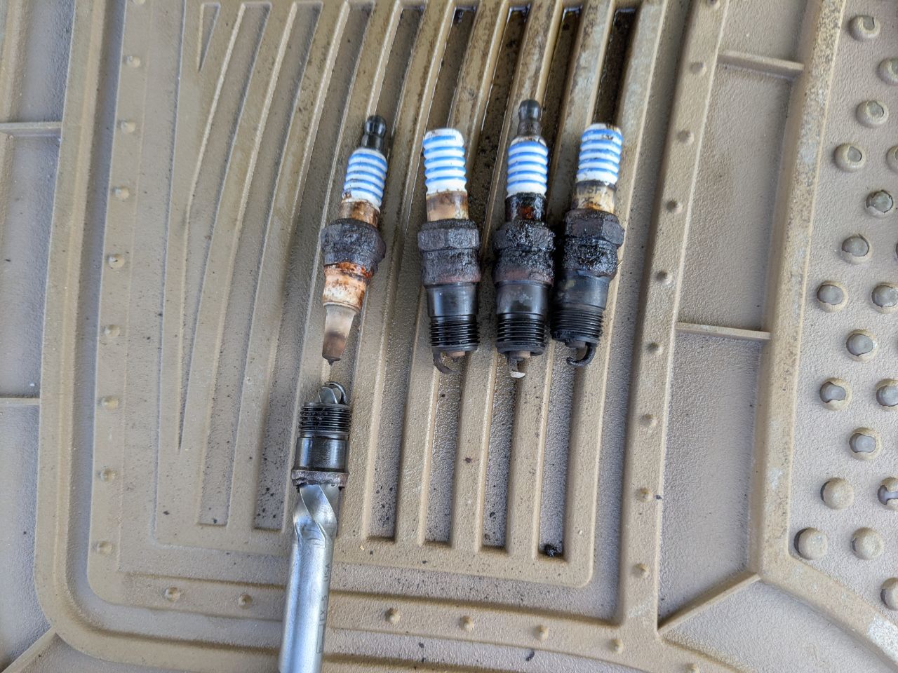

Fumbler Posted April 15, 2023 Author Share Posted April 15, 2023 I changed the oil in the Fiesta. Nothing too exciting really, except I discovered the sump plug needed the windy gun to get off (it uses a rubber O ring instead of a crush washer). I also caused a mini Piper Alpha on the driveway because the distance between the oil filter and the sump plug is juuuuust a bit more than the length of my catch can. I dumped in Napa's finest 10W40 semi synthetic oil in combination with a filter of theirs and took the car our for another drive. Date and mileage added for the next guy (me and my forgetful arse). The oil skidmark down the sump and block was from the old filter. I mopped it up before driving the car and nothing's come back, fortunately. I also had a peek at the air filter for the car, one of these "sealed for life" piles of junk they did back in the day: I didn't picture the insides -doh!- but the filter is definitely not original and is pretty well shoehorned in. Plus, there's a gap on one end so I can't see it filtering very well. Also, one of the screws was missing and another's stripped the threads in the plastic. I'd really like to replace the entire air box with something designed for servicing - did Ford make one for a 1.4 Duratec/Zetec that'd fit? Dyslexic Viking and Crackers 2 Link to comment Share on other sites More sharing options...
