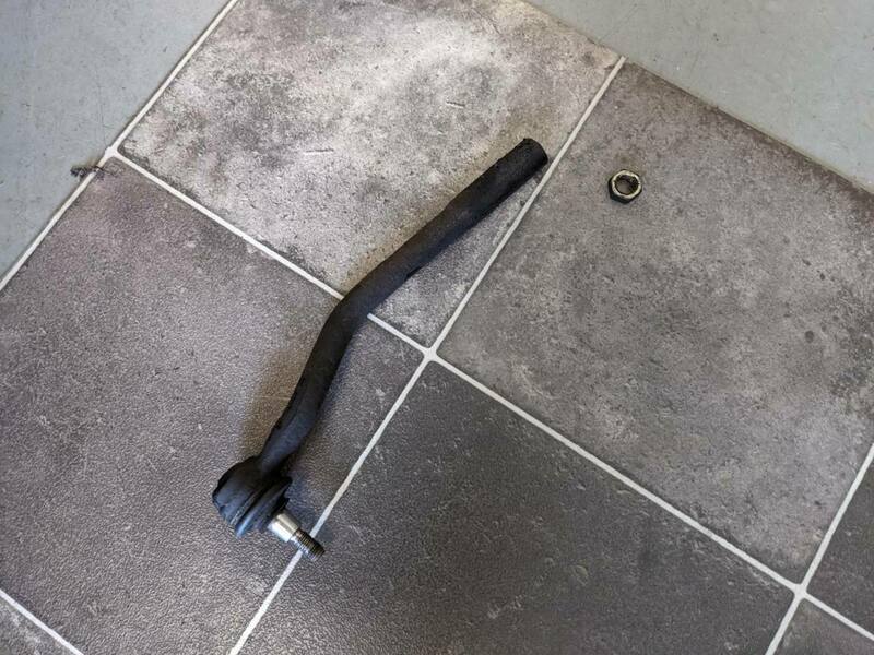

Fumbler Posted August 13, 2021 Author Share Posted August 13, 2021 Yay. I'll weld the Micra's sill in a couple weeks and once I get the MIG welder up and running. Anyway, the real reason for the post is that, at the same time of the MoT, I also replaced the broken steering rack gaiter on the BX. It was horrible. Very horrible. No, really. Here's a picture! I dread to think what changing one on larger engined models are like. I nearly had to break my wrists so they could fit in and perform the work. So, step 1 was to lift the vehicle to get the wheels off. Very stressy because I don't trust the sills and there's conflicting advice. I used the rear mounts for the front subframe in the end. The good news is that the body is rust-free, and I mean it. It's almost as good as the Micra which is 8 years younger and has 20% the mileage. That's a win in my book! We've got new front brake pads too. Eggshellent. After inspecting the area for how I'd go about working on it, I broke out the big guns. And set to work getting the track rod end off I then spent an hour getting the track rod end off. Barely any access to get a 12mm spanner on the rack balljoint to keep it from moving, and even less room for a 19mm spanner to free off the stop nut thing . I ended up wedging the 12mm spanner on the subrame which made life easier. The reason why it was a real ballache was because I did it completely wrong, as per usual! What I should have done was loosen the 19mm nut when the track rod end was still installed, then unbolt it and unscrew it from the rack balljoint. Other cars make this a lot easier by making the track rod end really tiny and the threaded shaft from the rack really long, but Citroen went with a long one instead for maximum confidence withdrawal. I got it off with my trousers becoming casualty to the oily filth that's everywhere. Great rustproofing, just not on my trousers, please! This is the old gaiter. The wheel side section was cracked and split open. Quite a bit of water poured out of it too, erps. No harm done, though, because everywhere is coated in grease. Phew! I repacked the balljoint and added some more grease to the rack gear before fannying around with the new gaiter. And what a fannyfest it was (not literally)! I took no pictures, but it required slipping the boot over the rack housing, which is larger than the gaiter. This means I need to stretch it over. Simple, yes? Of course not. It wouldn't be French otherwise. On the top you've got an engine on one side and the heater hoses in the other restricting your movement. On the underside, the subframe is in the way and the hard pipes for the front hydraulics conveniently use up all the other free space up there. There's no way I'm getting it over from underneath. BUT WAIT! IT GETS BETTER! OK, it's now installed, yes, but, see what's near the top of the picture? That's a guard plat for the steering wheel flex plate. Can I remove it? Sure I can, if I also disconnect a rod linkage that has a pivot and support ON THE GUARD ITSELF! MARVELLOUS! Oh how I laughed as I got cut up and bruised as I was fighting against the edges of the guard and strething the boot over. I managed to succeed when I decided to wedge an Allen key in between the rack housing and gaiter, so I could then twist the gaiter round and *POP* on it goes. Some zipties later and we're done. I got rather* grumpy at this point having spent around 3 hours on the bastard. I aligned the wheels best I could (I did mark where it was originally, but it was so caked in grease and muck, the paint just rubbed off when sliding the gaiter over), but I'll pay to get it done professionally. That should help make the steering wheel a bit more centred. It's never been right, but I haven't made the situation any better and I'd rather not have weird tyre wear. I removed the front wheeltrims as the wheelbolts hold them in. I'll get the rear ones off tomorrow with any luck. Rust Collector, Sunny Jim, juular and 2 others 5 Link to comment Share on other sites More sharing options...

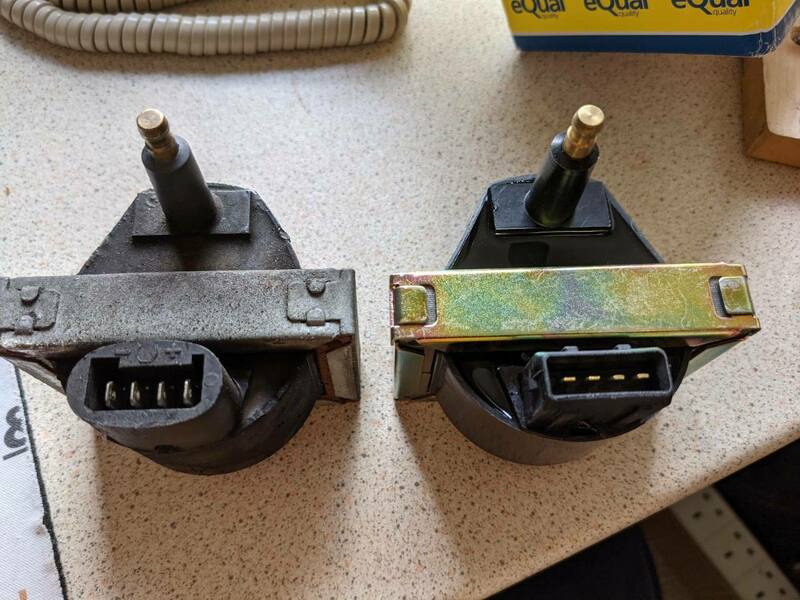

Fumbler Posted August 27, 2021 Author Share Posted August 27, 2021 Did this bodge on Tuesday evening. Apart from needing to reconnect the bodge after any type of journey, the weeing has stopped. Now I'm waiting on some Sugru to arrive so I can make the bodge less bodged. Meanwhile, adjusting the ignition timing currectly has FINALLY fixed the engine cold start problem. This probably means changing the jets and emulsion tube was a useless exercise but, you know, it's character building, isn't it? What this has presented, though, is an issue with starting hot. I suppose it's time to play a little game of "what component is fucking me over this time?"! Is it: The nasty looking coil, The new ignition module has already broken, Fuel evaporating from the bowl (which sounds unlikely as the car won't reestart after filling up with petrol)? Answers on a thruppeny bit please. Mrs6C 1 Link to comment Share on other sites More sharing options...
LightBulbFun Posted August 27, 2021 Share Posted August 27, 2021 31 minutes ago, Fumbler said: Is it: The nasty looking coil, The new ignition module has already broken, Fuel evaporating from the bowl (which sounds unlikely as the car won't reestart after filling up with petrol)? Answers on a thruppeny bit please. Crackers, Mrs6C and catsinthewelder 3 Link to comment Share on other sites More sharing options...

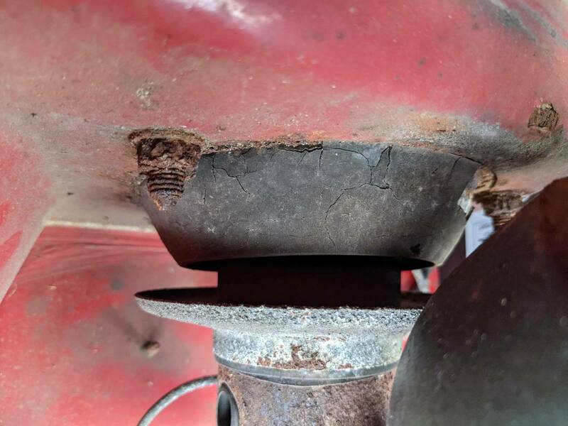

Fumbler Posted September 2, 2021 Author Share Posted September 2, 2021 I've thoroughly questioned my sanity and actually did a little test: So it appears the nearside strut is causing my issues. OK, that's part 1 of the problem solved, now to find the source of the creaking and general reluctance to go up and down within the strut. Something needs lubrication or somesuch in there. I photographed the strut as I parked it (it was parked on an uneven surface), in case that lends any useful info. The kind chap in the Xantia said something about there being a bearing in the strut top or something to that effect. I wonder if this is the issue? Rust Collector 1 Link to comment Share on other sites More sharing options...
