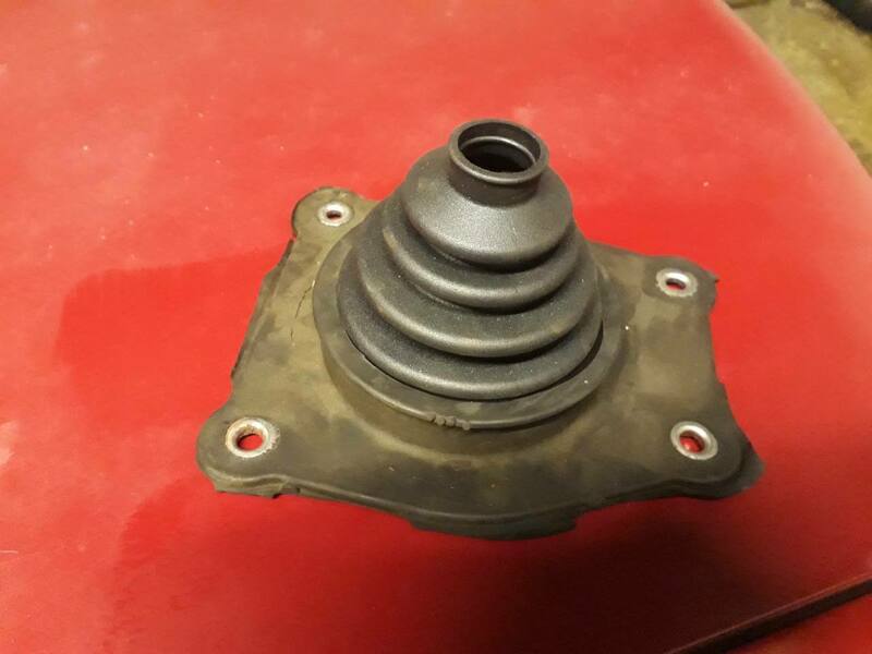

On the transmisson tunnel there is a big gaiter around the gearstick. Seem these perish and allow heat and smells in. Mine was toasted with a large amount missing, guess ill order a new one.
Nearly 37 quid,  which isnt exactly expensive but Thats over half what the clutch cost!
Too be fair its a large part and the little boots included, its also ment to help firm up a sloppy shifter with a little resistance in the lever. But im reluctant to spend that without trying a cheaper or free fix first.
Enter a stretcy cv boot.
A Perfect fit! Some super glue bonds it down and with it compressed down on the lever it works perfectly. Fresh oil in the selector mech housing on the gearbox and the shift its lovely and crisp now.
All back together and first test drive shows that the clutch is feather light and bites hard when you are "feeding it the onions"
Centre section Exhaust gasket didnt survive the re-use so theres a blow now but thats an easy fix. The whole euroflow exhaust fits like shite and need messing with. Its Cheap and Just Awful.
The exquisitely $h1te kwalitee leatherette shifter boot, on MrSavv, gave up the ghost after a few years....
I bought the biggest CV boot I could find on eBay (some Nissan...) and whacked it on 👍
Deffo big improvement.
