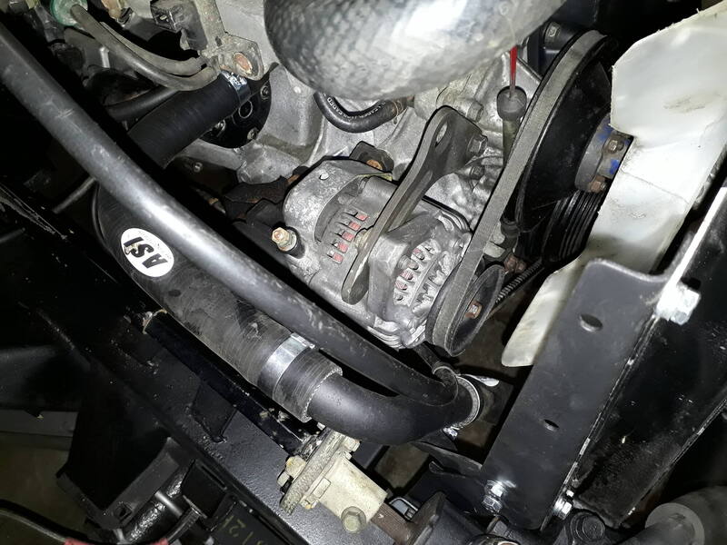

Next up, the alternator
But first it's getting nippy in workshop so time for a warming coffee.  I like my coffee strong, Don't want people thinking I'm a big softie.
The ALT seems to spin lovely but does appear to be covered in little corrosion so the pulley was whipped off, wire wheeled and given a quick coat of black and the ALT casing was wazzed over with the wire bush in the drill and blown out. Then a very light dusting of Matt lacquer to stop or slow the corosion from coming back too quickly
Found the correct size belt on another engine and shoved that on for now.
With the bits done that are more accessible with the rad out the way. The rad went in and I looked at buttoning up some of the pipework. The heater valve on the bulkhead needed mounting. As the body tub was a LHD and is now a RHD the holes weren't there and I'd completely forgot about it before fitting the engine so getting the drill in place was a bit of a fight. Add to that I drilled it in the wrong place the first time aswell!.

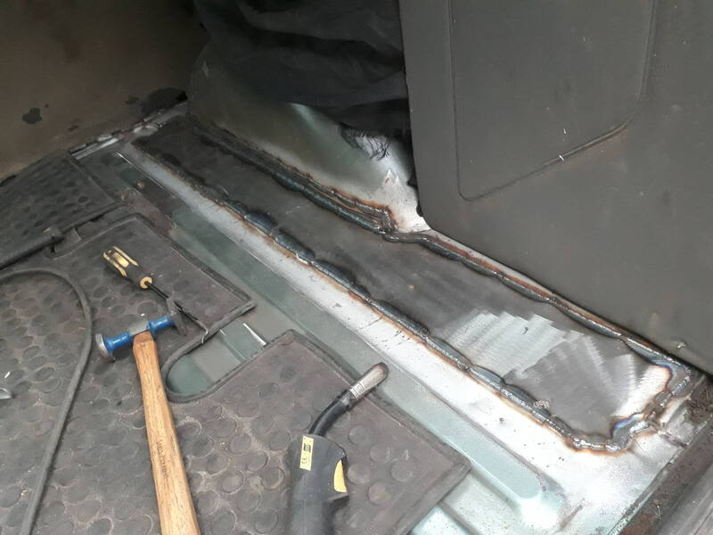

Disco is due it's MOT, the boot floor is pretty crusty. I had already done one side months ago. So a fast and dirty weld up was required. Chopped a great big hole, weld a bigger plate in. Then a slap over with some bed liner paint.

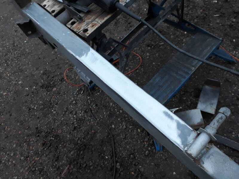

Lwb samurai again.

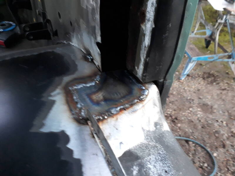

With the front end on loosely I decided to tackle the front bumper. The chassis had previously had the bumper mount tubes cut off to clear 31 inch tyres. I had a straight bumper to go on but the mounts had been previously repaired buy a Suzuki specialist concerningly.
This was irrelevant really as I'd have to make new mounts anyway. So I welded two top plates in that pick up on the front clip mounts and then two lower mounts that bolt up to two holes I drilled and tapped on the chassis.

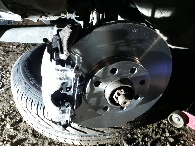

Using the Ecto4 today, whilst sitting in traffic I was greeted with sticky brakes. The car didn't seem to bog down at the rear so my suspicion was the front, maybe the N.S because that was the one that possibly got mighty hot the last time when a pad was wedged even tho it had appeared fine. I Pulled over and put my hand by the wheels and the heat was definitely more from the N.S,  knowing that the pads were new, and that everything had been cleaned and greased from the last time.
So I messaged a mate at my work and he confirmed we had new calipers in stock and at £25 each I decided Id stick a pair on.
Swapped the caliper over, brakes are so simple on these. Unfortunately upon stripping it down I was greeted with a pad with a crack down it, I don't think the pads got that hot so feel this is faulty part.
I may go for some better brand pads, or swap these under warranty as they seem to perform quite well.
Below you can see the witness mark of the crack from the pad.

Ecto4 got yet another set of Discs and pads! the brakefit cracked ones were swapped under warranty, so tonight I shoved them on and took the lanes back home to bed them in a bit.

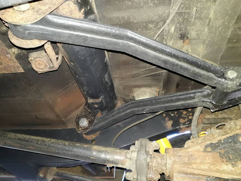

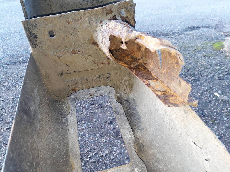

The disco however has been a month or more of this.  Rust, rusted bolts, rounded off bolts, rusted in bushes bolts, failing seam sealer, oil leaks and F**KING FLAKING SCHUTZ!
just don't put this stuff on a car, especially not spraying the whole underside and mechanicals like the person did on this disco. the amount  of rust that's built up behind dried out failed or cracked bits is just everywhere.  I've needle scaler /wire wheeled so much of this crap off.  The only bit that had done it's job is the bit soaked in oil that's leaked out the engine. If it was regularly cleaned up and coated in light oil or waxoil it was probably be fine but however many years down the line it dried out and does more harm than good.

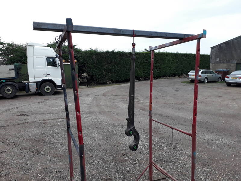

Happy radius arms, had to nab a replacement from a fellow landy botherer after the large retaining nut must have picked up in the thread as it chewed it's self up.
You can see on that the paint is scratched off. This was me testing the paint with my fingernail. 48hrs drying aswell.
The name of the paint?
Err yeah, not convinced m8.
Swivel housings absolutely shafted. They are bloody expensive new tho (around £150+ per pair)  and difficult to find decent used. So going to take them off, degrease them and as I have a tin of chemical metal kicking about and going to try smooth them out and see.

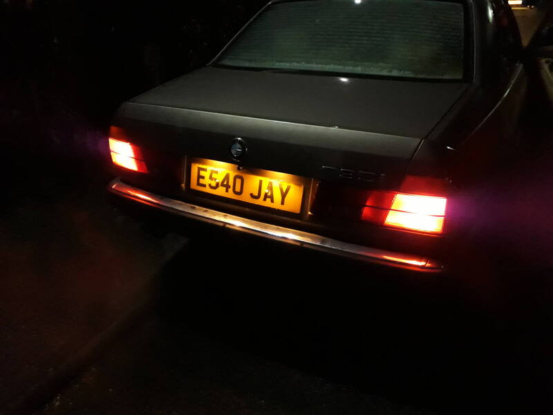

One rear light refused to work, then the other decided to join it, borrowed a more electrically minded friend and his volt meter, no power to the rear tailight. Then we had none, wiggled some bits and checked the fuses under the bonnet found nothing. The car decided to close it's Bootlid and bonnet on my mates head,
We Decided it was to dark and cold and we gave up. On my way home they both came on and have worked ever since?
At the same time we had checked the brake lights as the dash had told me of a brake bulb fault. It seems These had become intermittent but pumping the pedal a bit got the switch to function and it was put down as lack of use.
