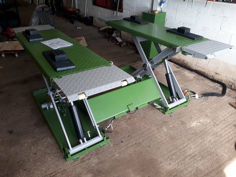

Andyrew Posted April 18, 2021 Author Share Posted April 18, 2021 Sometimes. . . Mentioned previously on here ive had the occasional back twinge issue. Last time it was simply washing the car and it just went. I also suffer a bit with my knees, a previous job i would be kneeling alot and i think it took its toll. With the workshop i have now having a nice flat floor i decided to stop laying on my back a get a lift. I weighed up the many options and decided to go for a mid rise scissor lift. The abilty to stand or sit on a stool should make life more pleasant. I went for a clifton lift from strongman tools. Plans were made and very kindly @Six-cylinder was able to trailer for me to save on the rather expensive postage. We collected the lift friday which involved loading and unloading, large tractors with digger buckets, straps and dollies and it was in the workshop. When chris returned from collecting the carlton head we hitched up the trailer and at that point my back went. Thats right my back went whilst getting to tool to help save my back. We returned to the FOD collected the wee mazda and i went home to rest up. Later that night i was in agony. I couldnt stand let alone walk. Slowsilver, beko1987, GMcD and 3 others 6 Link to comment Share on other sites More sharing options...
Andyrew Posted April 18, 2021 Author Share Posted April 18, 2021 After a day of rest im alot better, still walking with a bit of a hunch and shuffle. If it doesnt clear soon ill book in with a specialist. Today a friend was free to come and wire in the 16amp plug and check that the existing wiring was suitable (it was) With the Astra parked at the workshop i had the mazda to drive ohh ... yay. I lobbed the roof back and lowered myself in and headed to the workshop to meet my friend. I offered that i can make a drink and thats about as much use as id be today. So i shuffled around making tea. Mrs6C 1 Link to comment Share on other sites More sharing options...
Andyrew Posted April 18, 2021 Author Share Posted April 18, 2021 Another friend popped by to say hello and together they both decided to get the heavy bastard thing assembled. Whilst i felt like a right plum unable to help. But i guess thats friends for you, willing to help out even without being asked and for that i am very greatful. Still need to get it filled with hydraulic fluid that ive got at work, i didnt expect it put together today so i hadnt picked it up. LightBulbFun, loserone, Fumbler and 13 others 16 Link to comment Share on other sites More sharing options...

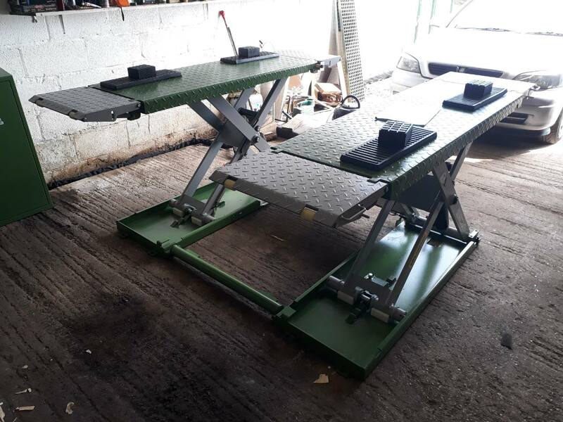

Andyrew Posted April 19, 2021 Author Share Posted April 19, 2021 Fly my pretty! Fly! Six-cylinder, LightBulbFun, Dan302 and 9 others 12 Link to comment Share on other sites More sharing options...

junkyarddog Posted April 19, 2021 Share Posted April 19, 2021 I like that lift. Any link to where it was purchased? Link to comment Share on other sites More sharing options...
mitsisigma01 Posted April 19, 2021 Share Posted April 19, 2021 On 4/18/2021 at 1:27 PM, Andyrew said: clifton lift from strongman tools junkyarddog 1 Link to comment Share on other sites More sharing options...
Bitzer Posted April 19, 2021 Share Posted April 19, 2021 2 hours ago, Andyrew said: Fly my pretty! Fly! Does it come complete with bricks or tinderblocks to be placed under the car body, metal pins to jam into the scissors or any other non-hydraulic saftey feechure? Link to comment Share on other sites More sharing options...
junkyarddog Posted April 19, 2021 Share Posted April 19, 2021 16 minutes ago, mitsisigma01 said: https://strongmanlifts.co.uk/product/clifton/ Looks a nice bit of kit. Link to comment Share on other sites More sharing options...
Andyrew Posted April 19, 2021 Author Share Posted April 19, 2021 5 hours ago, Bitzer said: Does it come complete with bricks or tinderblocks to be placed under the car body, metal pins to jam into the scissors or any other non-hydraulic saftey feechure? Yes, theres some teeth on the baseplate, as the lift goes up the pins ride over the teeth and drop in place. Theres two pins both side, you raise to the height you want then press the lock button and lift drops down to nearest lock point. So the rams are only really for lifting and would be a back up should all 4 pins happen to fail. To lower the lift the down button is depressed. This triggers to solenoida that lift up the lock mechanisms. The lift raises a bit then lowers down to the floor. You can adjust the pressure release to slow the lowering speed. somewhatfoolish, JeeExEll, Yoss and 5 others 8 Link to comment Share on other sites More sharing options...
Andyrew Posted April 19, 2021 Author Share Posted April 19, 2021 7 hours ago, junkyarddog said: https://strongmanlifts.co.uk/product/clifton/ Looks a nice bit of kit. Its fairly decent from what i can see, these things are all the same chinese made stuff and the seller just pics the colour and any other features. I liked this one as the strongman version had checker plated tops that are a tad thicker. And the large tie in plate between the scissor arms. This pulls the two inwards. Others hava a tube that ties in at the lower lever which i feel is marginally weaker but also hinders the abilty for a troller just or dolly to be wheeled underneath. So far the only dissapointment had been the packaging it came in, and the instructions are shit, poor chinglish shite. Also it was blooming expensive! Link to comment Share on other sites More sharing options...
