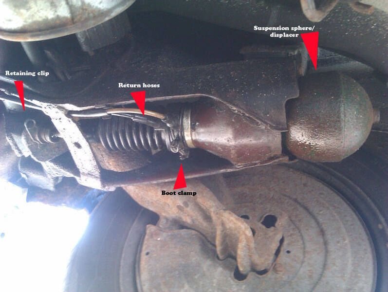

dean36014 Posted March 17, 2020 Share Posted March 17, 2020 I'm certain you don't need to remove the spheres. The ram connects to the rear suspension arm with a clip so you can disconnect it and then remove the boot and replace it. I might have missed out some steps there but certain I didn't remove the sphere when I replaced them on shonky. Worth investing in new clips for the sphere end of the boot as they seize up. vulgalour 1 Link to comment Share on other sites More sharing options...
vulgalour Posted March 17, 2020 Author Share Posted March 17, 2020 I didn't get new clips, just new clamps for the boots. Where would I get the clips from? Link to comment Share on other sites More sharing options...
dean36014 Posted March 17, 2020 Share Posted March 17, 2020 Ah sorry I meant clamps, although be careful removing the clips where the ram attaches to the suspension arm as they can ping off or snap rob88h 1 Link to comment Share on other sites More sharing options...
dean36014 Posted March 17, 2020 Share Posted March 17, 2020 Should also say and I'm sure you know this. Put bleriot in high and support the rear of car then drop into low and depressurise before doing this. Sorry if I'm teaching you to suck eggs! rob88h 1 Link to comment Share on other sites More sharing options...
vulgalour Posted March 17, 2020 Author Share Posted March 17, 2020 That was going to be the plan. Well here's hoping it's as easy a job as it seems it's going to be. I'm guessing getting the old stuff off is going to be more difficult than putting the new stuff on. I'll also have a look as much as I can at the subframe mounting point since while I'm sure it's perfectly okay, it doesn't hurt to make extra sure while I'm under there. How much are we betting it'll chuck it down on the weekend when I attempt it? Link to comment Share on other sites More sharing options...

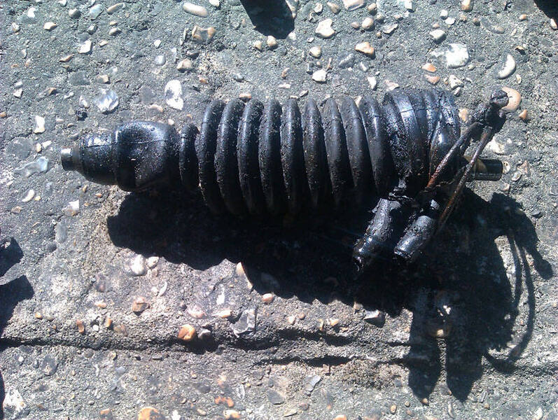

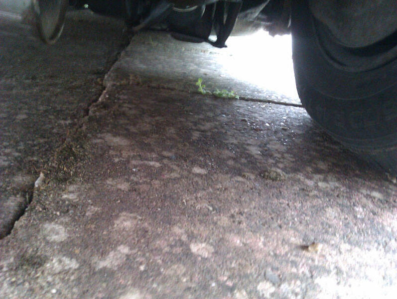

vulgalour Posted March 21, 2020 Author Share Posted March 21, 2020 Right then, let's have a look at sorting these boots out before I have to go to work. Up we go. Nice tall axle stands gave me loads of access to see what I was doing for this. I wanted to try and find out what exactly was leaking. All the solid pipes and unions are bone dry, the only LHM is on the rubber bits of the boot and the parts of the suspension arm that hang down. A bit of a squish of the boots revealed a lot of splits and cracks so I'm confident the leak on this side is just the fact that the boot has given up. It's otherwise pretty tidy under here, there's a bit of surface corrosion here and there and it would certainly benefit from a good degrease and a splosh of underseal to keep things nice, which I shall do at a future date. It had been suggested the boots can come off without removing the sphere. I'm jiggered if I can work out how you do that. Happily, the boot clamp on both sides unfastened with no resistance so at least I know they're not going to fight me when I do replace the boots. I don't have replacement spheres or new o-rings for the old spheres so I left the job at that for today. This is the side that's leaking occasionally, it's mostly getting past the outlets that go to the plastic lines, and the splits at the other end of the suspension unit to the displacer sphere, there's no wetness above the boot or displacer and there's no sign of any LHM being sprayed out at high pressure. Now I'm wondering if it might be worth just doing the spheres at the same time. The ride is perfectly fine, I've no reason to suspect the rear spheres need replacing, it just feels like it makes sense to do it while I'm in here. rob88h, chodweaver, LightBulbFun and 1 other 4 Link to comment Share on other sites More sharing options...
LightBulbFun Posted March 21, 2020 Share Posted March 21, 2020 4 minutes ago, vulgalour said: Right then, let's have a look at sorting these boots out before I have to go to work. Up we go. Bloody hell when I first glanced at the picture I thought something had gone seriously wrong with the hydropneumatic suspension or you found some hidden setting or something LOL been enjoying the thread very much keep up the good work vulgalour, BlankFrank and DarrenKC53 2 1 Link to comment Share on other sites More sharing options...
Cleon-Fonte Posted March 21, 2020 Share Posted March 21, 2020 5 hours ago, vulgalour said: It had been suggested the boots can come off without removing the sphere. I'm jiggered if I can work out how you do that. Pull clip holding suspension cylinder to suspension arm, cylinder separates from arm, remove and replace boot, then return clip to suspension cylinder. Job done. Even if you remove the sphere it looks like it'd be a nightmare to remove it the other way. Link to comment Share on other sites More sharing options...
mat_the_cat Posted March 21, 2020 Share Posted March 21, 2020 4 hours ago, Cleon-Fonte said: Pull clip holding suspension cylinder to suspension arm, cylinder separates from arm, remove and replace boot, then return clip to suspension cylinder. Job done. Even if you remove the sphere it looks like it'd be a nightmare to remove it the other way. This. You'd never get the small end of the boot over the cylinder anyway! The plastic pipe is only to return the small amount of LHM which passes the cylinder seal (for lubrication), so if this is excessive it could suggest either a damaged seal in the cylinder and/or a poor sealing surface on the piston. A supple new boot may well seal better, and cure the problem so wouldn't worry yet! It's not good practice, but I've replaced spheres without a new O ring before and had no leaks. The rear ones can be a bugger to get off though, and would say that you'll be lucky with just a chain wrench. I'd leave alone until needed... rob88h 1 Link to comment Share on other sites More sharing options...
vulgalour Posted March 22, 2020 Author Share Posted March 22, 2020 I must have missed where that clip is. I removed the only clip I could see when I was under the car which was at the end of the rod that sticks out of the displacer which, it appears, is supposed to hold the skinny end of the boot (it doesn't on either side of the car). That didn't help me at all. I'm assuming the clip is somewhere at the displacer end? I've probably looked right at it and just didn't recognise it as a clip. Link to comment Share on other sites More sharing options...
mat_the_cat Posted March 22, 2020 Share Posted March 22, 2020 8 hours ago, vulgalour said: I removed the only clip I could see when I was under the car which was at the end of the rod that sticks out of the displacer which, it appears, is supposed to hold the skinny end of the boot Sounds like you removed the right clip - kind of like an R clip going through the suspension arm, into the rod, then back through the suspension arm. The rod often seizes into the cup on the suspension arm, but usually a good waggle will free it. vulgalour and rob88h 2 Link to comment Share on other sites More sharing options...

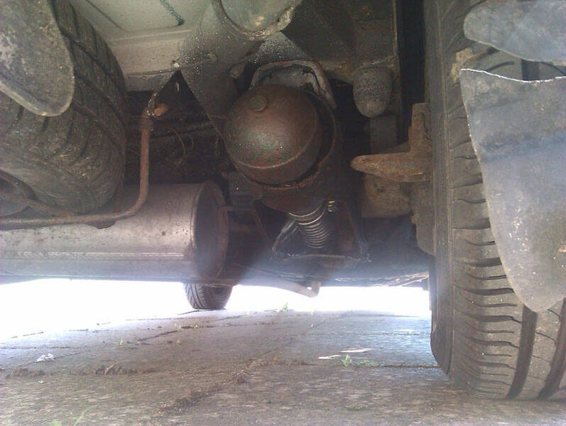

vulgalour Posted March 28, 2020 Author Share Posted March 28, 2020 Had a nosey underneath the BX after tidying away the gardening tools. Slightly disappointed to see LHM weeping from the displacer union, presumably where it screws in since that's where the LHM looks to be collecting. The boot itself is nice and LHM-tight and there's only the tiniest spot of LHM on the floor, this is after 5 days of the car being sat idle which is when it leaks the most. Previously, it was leaving a much more obvious puddle at rest. The issue was also intermittent previously, it seems to stop leaking when the suspension is under pressure, it only leaks when it's depressurised, so I assume whatever damage there is on the sealing surface is getting filled by the rubber o ring when the system is under pressure. Slightly disappointing that one. At best I will need to fit a new o-ring, at worst it's going to need a new one of the bits the displacer screws into and possible new displacers. At least I can now see the issue since replacing the boots. rob88h 1 Link to comment Share on other sites More sharing options...
Noel Tidybeard Posted March 28, 2020 Share Posted March 28, 2020 ?becos french! ? Link to comment Share on other sites More sharing options...
mat_the_cat Posted March 28, 2020 Share Posted March 28, 2020 6 hours ago, vulgalour said: it seems to stop leaking when the suspension is under pressure, it only leaks when it's depressurised, so I assume whatever damage there is on the sealing surface is getting filled by the rubber o ring when the system is under pressure. The O rings are on the inside of the aluminium cylinder on the left, sealing against the piston in the middle. If this is corroded at the point where the O ring sits whilst the car is in low, this could cause seepage. Assuming the sealing surface is good on the area used at normal height, the leak will disappear. rob88h 1 Link to comment Share on other sites More sharing options...
robinmasters Posted March 28, 2020 Share Posted March 28, 2020 If you do decide to replace the spheres, I've got a removal tool-happy to lend, hopefully we can rearrange the Kent meet when we're allowed out again. vulgalour and stuboy 2 Link to comment Share on other sites More sharing options...
vulgalour Posted March 29, 2020 Author Share Posted March 29, 2020 @mat_the_cat I'm going to have to get it apart to find out aren't I? I shall make use of @robinmasters offer of that removal tool once we're allowed out to play again. I bet the boot having failed is what's caused any corrosion too since it was definitely letting some moisture in and some LHM out, which isn't ideal. Link to comment Share on other sites More sharing options...
mat_the_cat Posted March 29, 2020 Share Posted March 29, 2020 Afraid so, although at least all the fixings will be free. I don't know if there is a source for new pistons, but if they do prove to be the problem then maybe Chevronics would be able to supply second hand. It's been more common at least in my experience, for the outer wall of the cylinder to corrode through - with hindsight I'd have retained the pistons as spares! Link to comment Share on other sites More sharing options...
