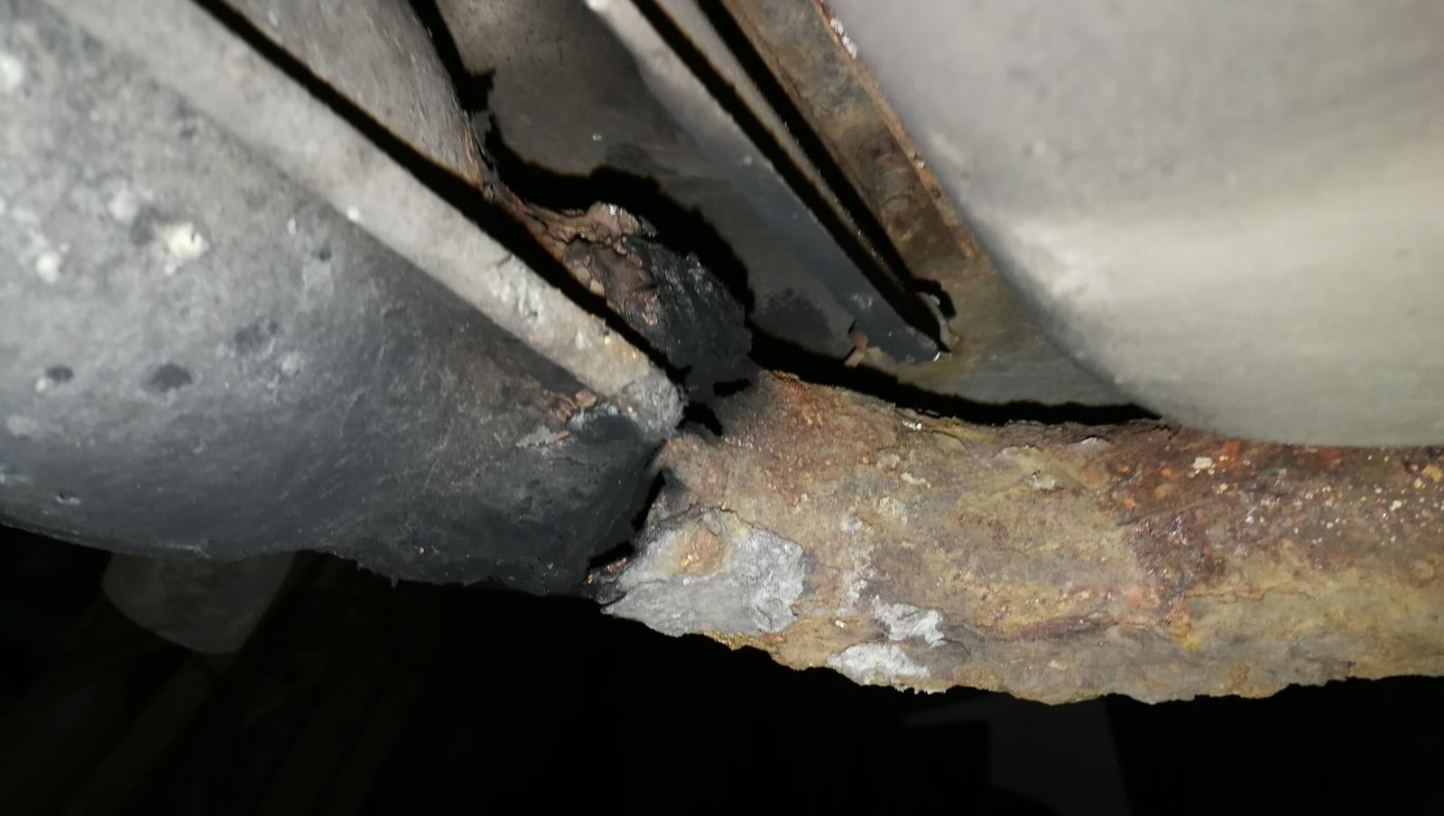

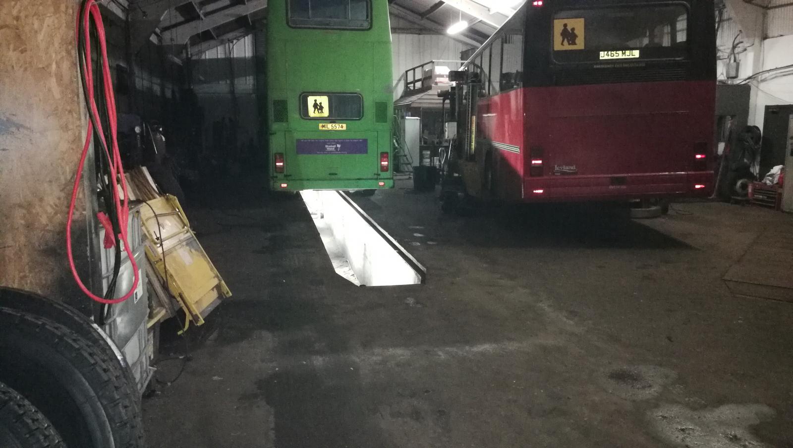

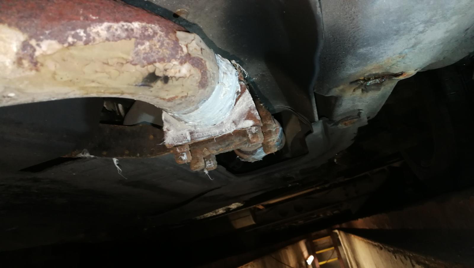

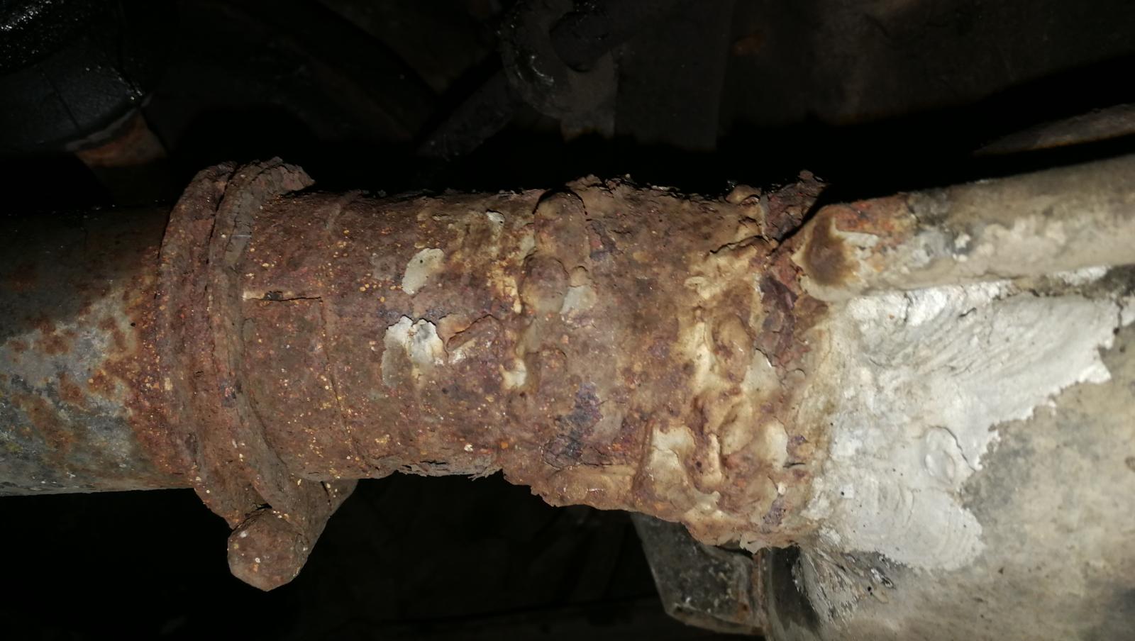

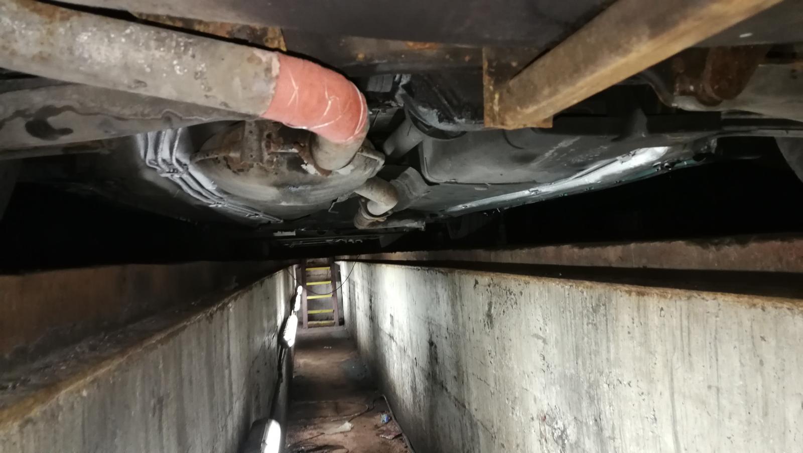

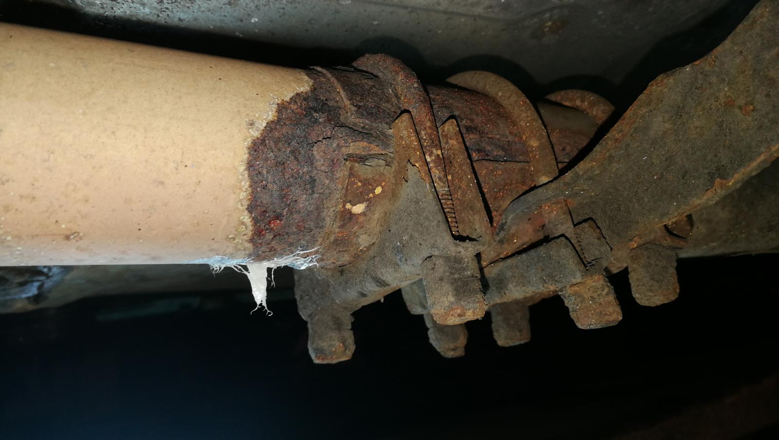

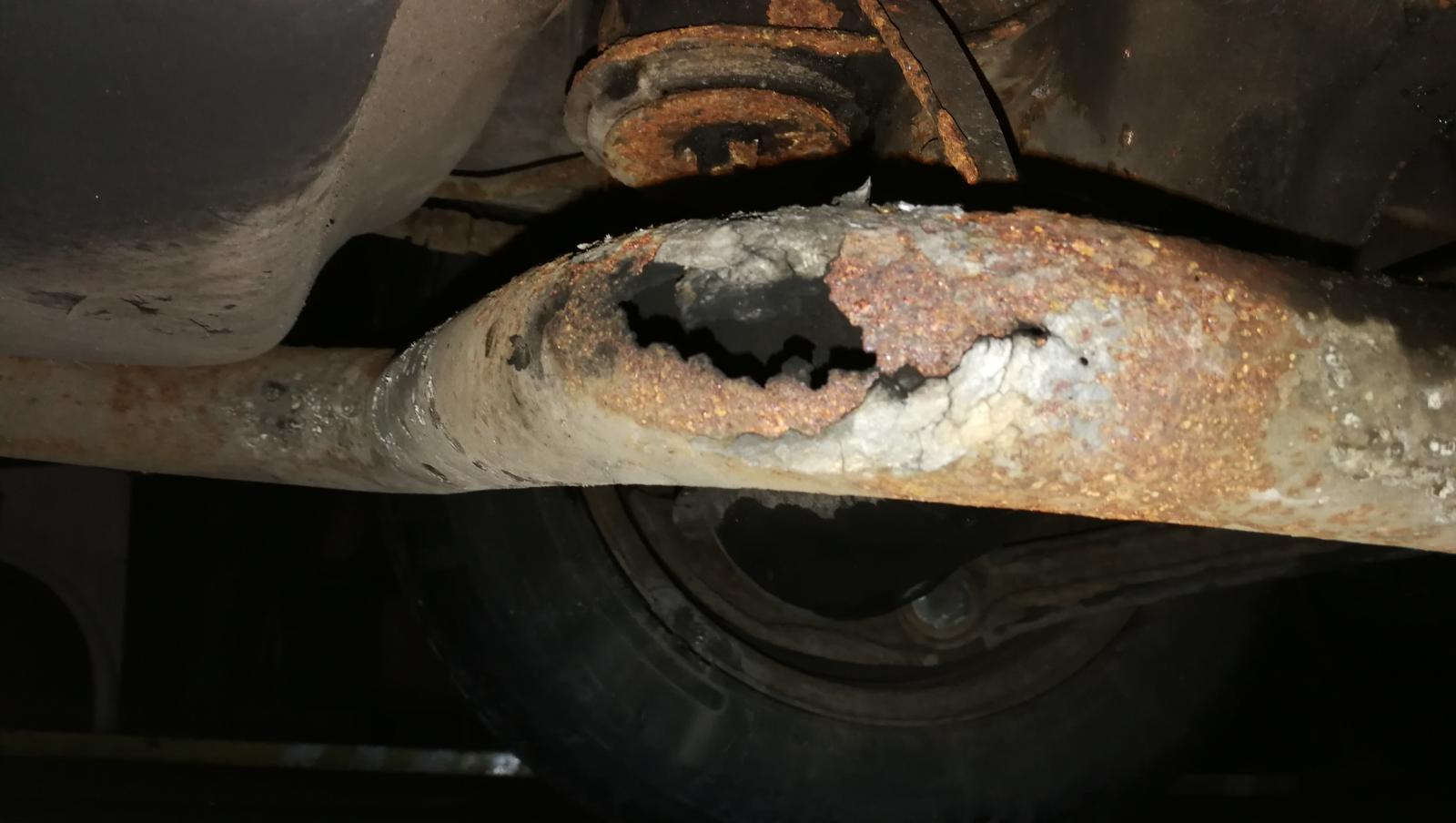

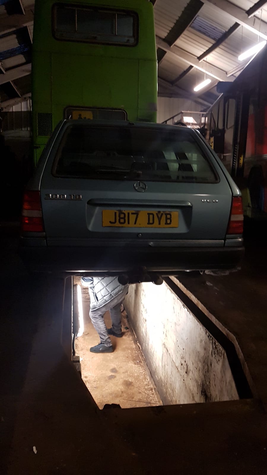

320touring Posted January 16, 2019 Author Share Posted January 16, 2019 Tonight, at an undisclosed location near Baurheid, the Merc met it's Nemesis.. THE PIT! The Merc fears the pit as it exposes all its weaknesses. The principal task was to stop the exhaust blowing as much. Under I went Andy (CMS206/Boaby Fae the clansman) asked what the exhaust was like.. The news, it was not guid. However, I had a plan.And it was a good plan.Gungum and Exhaust bandage to the rescue! A master* craftsman* at work The result?It's not shitting out veg fumes from all over the shop.This pic was taken with it running Exiled_Tat_Gatherer, dome, The Moog and 14 others 17 Link to comment Share on other sites More sharing options...
Inspector Morose Posted January 16, 2019 Share Posted January 16, 2019 Mrs FPB7 will be pleased. She felt the urge for fried food for days after riding in it. 320touring, dome, BorniteIdentity and 1 other 4 Link to comment Share on other sites More sharing options...
320touring Posted January 16, 2019 Author Share Posted January 16, 2019 Mrs FPB7 will be pleased. She felt the urge for fried food for days after riding in it.#monthechups Inspector Morose 1 Link to comment Share on other sites More sharing options...
lesapandre Posted January 16, 2019 Share Posted January 16, 2019 The Pit! 320touring and GrumpiusMaximus 2 Link to comment Share on other sites More sharing options...

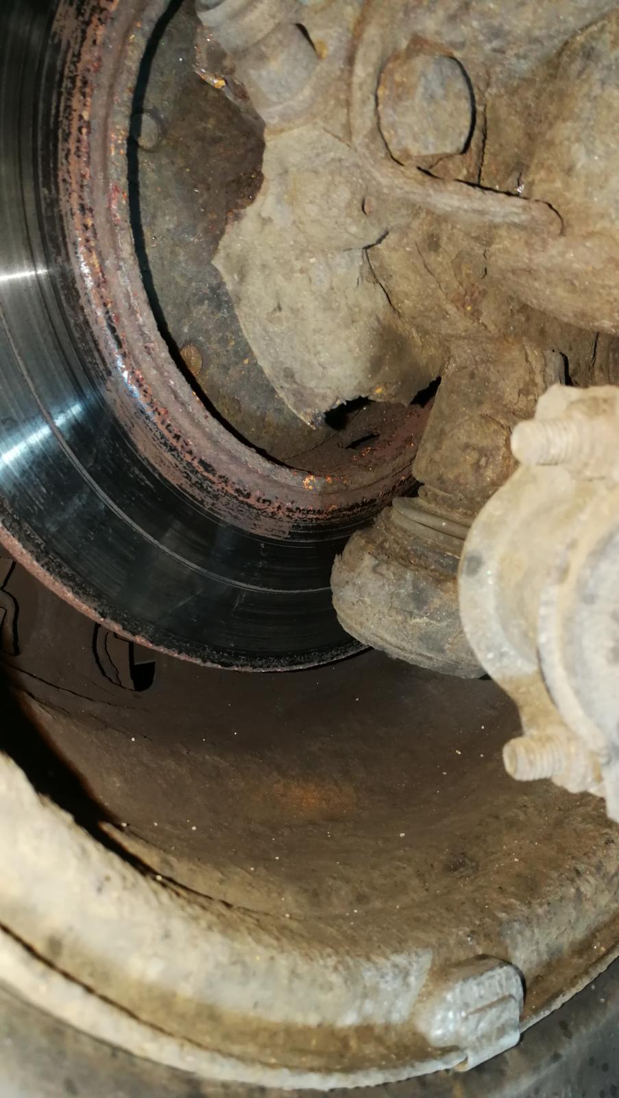

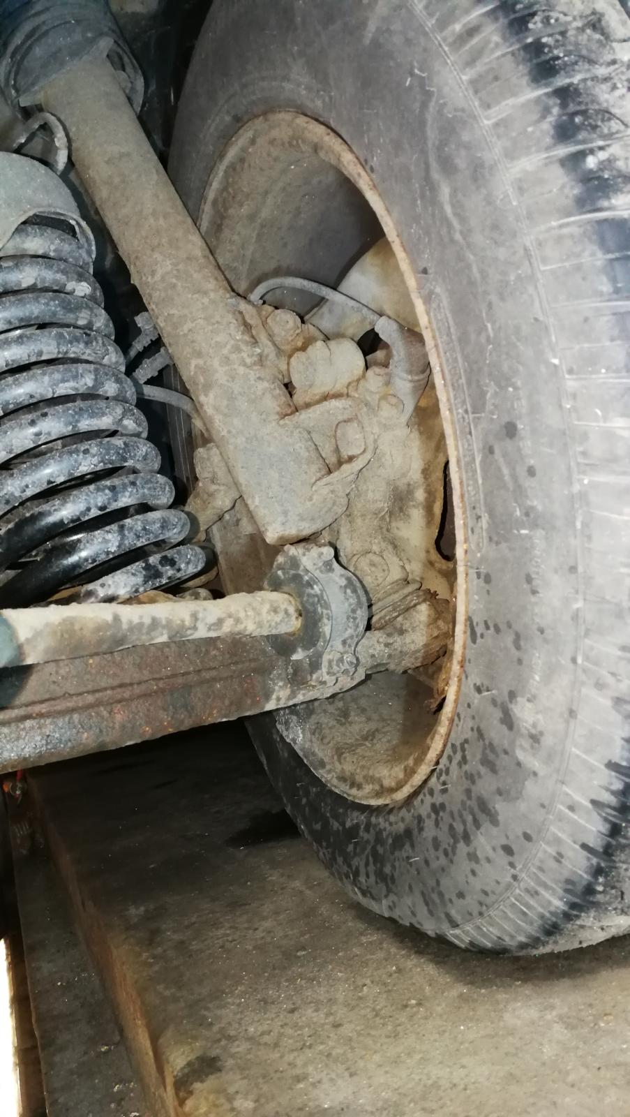

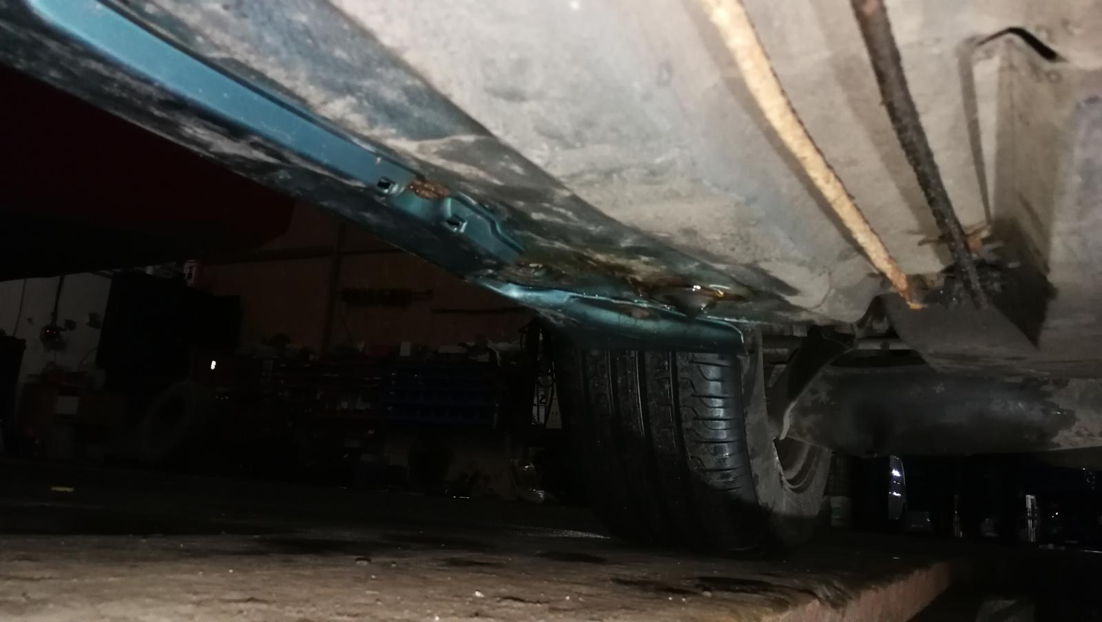

320touring Posted January 16, 2019 Author Share Posted January 16, 2019 And now for the juicy bit.. The undergarments. It even appeared to have sills after a fashion (as far as could be seen with the sill covers on) A swift inspection of the front wheels revealed not much of concern (and relatively new springs) However the brake discs look tired, so likely get a set plus pads. Jim Bell, RobT, GrumpiusMaximus and 6 others 9 Link to comment Share on other sites More sharing options...
320touring Posted January 16, 2019 Author Share Posted January 16, 2019 Having looked up discs and pads - are these fitted with solid front discs?! Link to comment Share on other sites More sharing options...
Shirley Knott Posted January 16, 2019 Share Posted January 16, 2019 Doesn't look too shabby at all under there. I served and apprenticeship with Leyland Daf back in the 90's, seeing lovely wide pits like that brings back some memories. 320touring 1 Link to comment Share on other sites More sharing options...

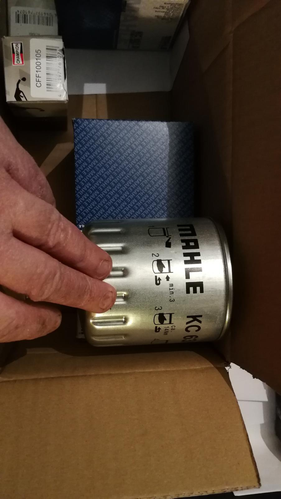

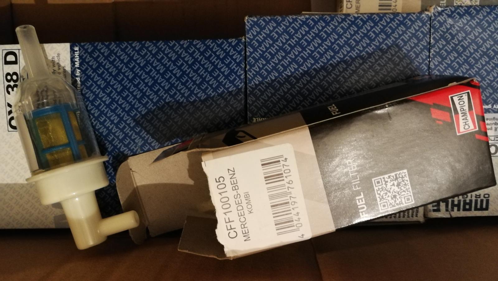

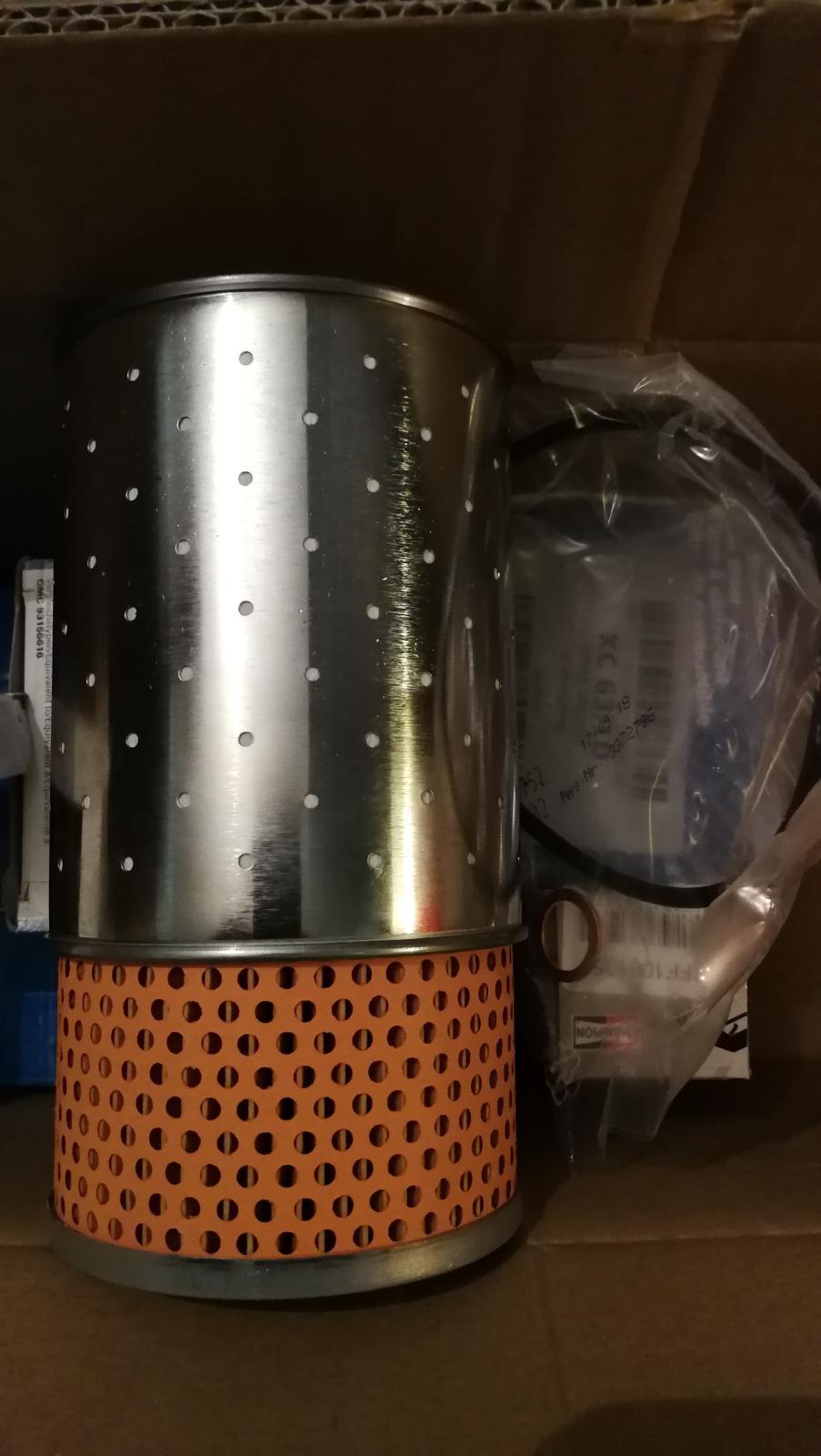

320touring Posted January 16, 2019 Author Share Posted January 16, 2019 Lastly, I got some service items. 2x fuel pre-filters 2x fuel filters And an oil filter Just Oil to buy now.. Shirley Knott, Skizzer, Jim Bell and 4 others 7 Link to comment Share on other sites More sharing options...
Exiled_Tat_Gatherer Posted January 17, 2019 Share Posted January 17, 2019 Looks tidy enough for the peanut price……… I'd guess an exhaust would be heavy on the wallet n'est-ce-pas?It does look - from the inner wheel photo - that it's solid disc. No signs of the telltale oblong apertures…….. Link to comment Share on other sites More sharing options...
320touring Posted January 17, 2019 Author Share Posted January 17, 2019 Looks tidy enough for the peanut price……… I'd guess an exhaust would be heavy on the wallet n'est-ce-pas?It does look - from the inner wheel photo - that it's solid disc. No signs of the telltale oblong apertures……..I wouldn't mind putting another exhaust on it should that be nearly all it needs for an MOT - the prices look reasonable. AYE, looking again at my pic, it does look solid for the money - much better than expected:) The disc does look like it's solid, time to price them up. Link to comment Share on other sites More sharing options...
DaveDorson Posted January 17, 2019 Share Posted January 17, 2019 I wouldn't mind putting another exhaust on it should that be nearly all it needs for an MOT - the prices look reasonable. AYE, looking again at my pic, it does look solid for the money - much better than expected:) The disc does look like it's solid, time to price them up. They're not expensive, I've got discs and pads for one of mine sat on the shelf waiting for me to fit, and I seem to remember it all came in at less than £100.00 Link to comment Share on other sites More sharing options...
dome Posted January 17, 2019 Share Posted January 17, 2019 A massive sigh of relief on those front springs being good. I still have nightmares about changing mine. 320touring 1 Link to comment Share on other sites More sharing options...
DaveDorson Posted January 17, 2019 Share Posted January 17, 2019 A massive sigh of relief on those front springs being good. I still have nightmares about changing mine. Did mine with the right tools, wasn't too bad. Link to comment Share on other sites More sharing options...
320touring Posted January 17, 2019 Author Share Posted January 17, 2019 Did mine with the right tools, wasn't too bad.You've not met Dome have you? Right tools? Nae chance;) Link to comment Share on other sites More sharing options...
320touring Posted January 17, 2019 Author Share Posted January 17, 2019 They're not expensive, I've got discs and pads for one of mine sat on the shelf waiting for me to fit, and I seem to remember it all came in at less than £100.00Yeah they don't look expensive. In other news, this has only gone and started to Start/stop off the key So far, I have bought a new ignition switch - old one fixed itself Bought a new stop valve, old one fixed itself Total actual maintenance cost so far is £8 for gungum and an exhaust bandage. Lacquer Peel, Jim Bell and Skizzer 3 Link to comment Share on other sites More sharing options...

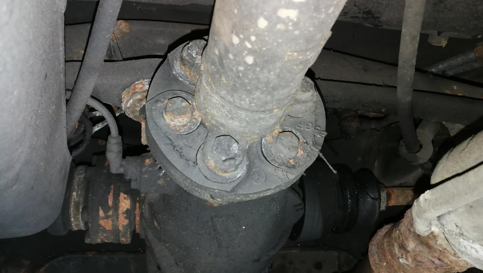

forddeliveryboy Posted January 18, 2019 Share Posted January 18, 2019 Has that fuel pipe been greased/oiled up or is it leaking fuel? Seems odd someone would grease just the one. Those dry SLS and fuel pipes would enjoy a bit of grease, they might live to see another few winters. Link to comment Share on other sites More sharing options...
320touring Posted January 18, 2019 Author Share Posted January 18, 2019 Has that fuel pipe been greased/oiled up or is it leaking fuel? Seems odd someone would grease just the one. Those dry SLS and fuel pipes would enjoy a bit of grease, they might live to see another few winters.I was confused by that. The damp line is on the driver's side of the car. I'd have thought fuel lines would have been on the LHS as that's the side the pump is on? It doesn't drop fuel, no obvious air ingress. The SLS suspension will likely get removed and standard dampers fitted if it gets to the MOT. previous owner said it just pissed SLS fluid out when he filled the reservoir.Unlikely I'll be interested in paying 1.5x cost of the car for 2x new rear levelling damper units. mrbenn and Jim Bell 2 Link to comment Share on other sites More sharing options...
