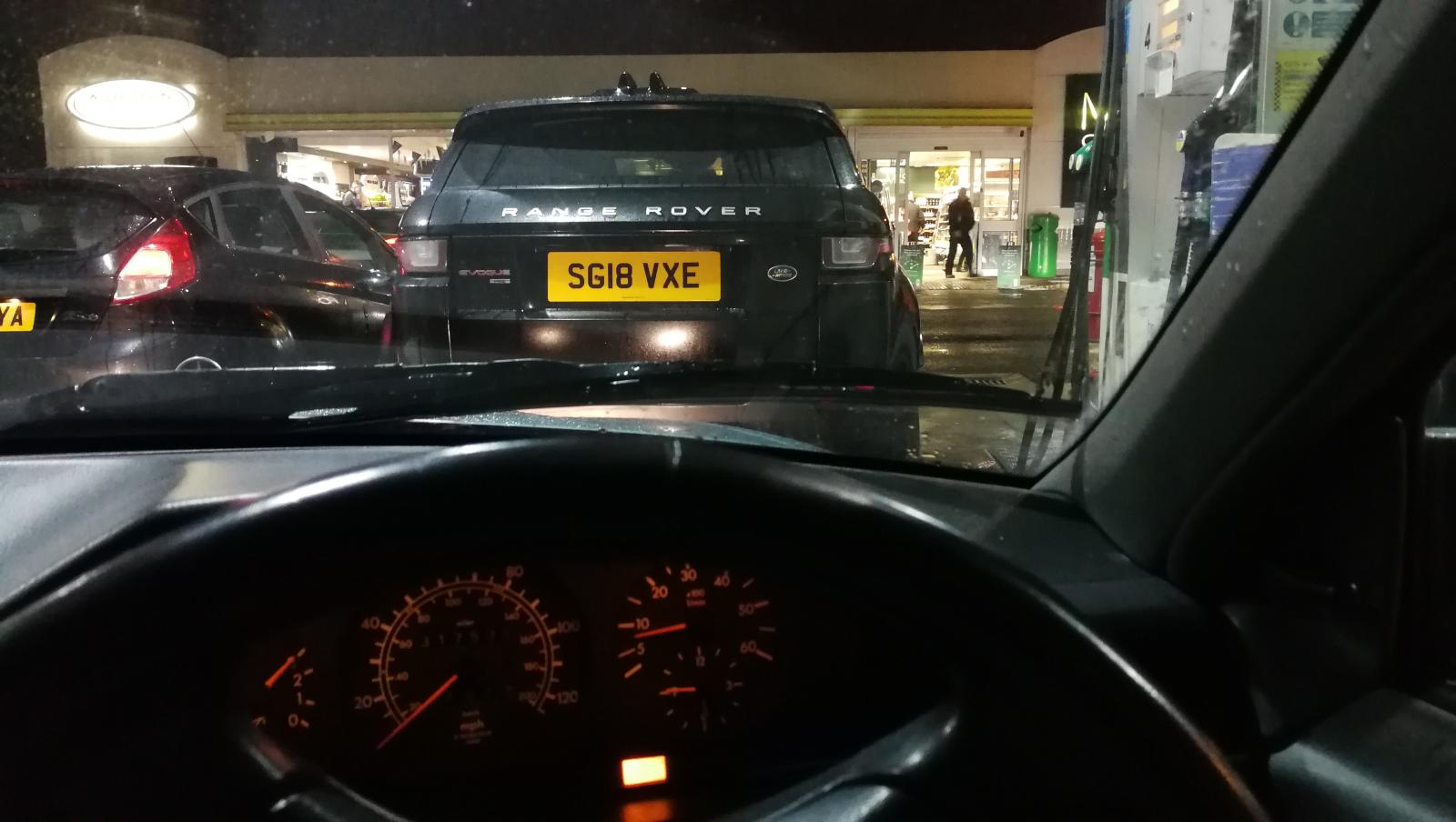

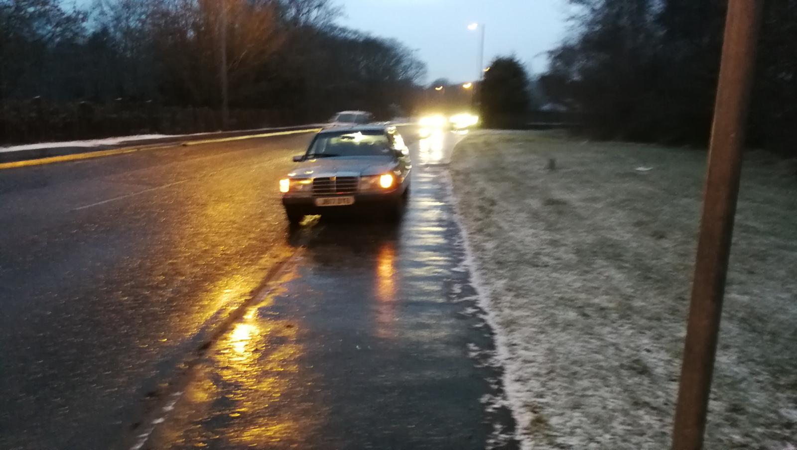

320touring Posted February 1, 2019 Author Share Posted February 1, 2019 In an exemplary display of "how not to use a car with a dodgy fuel gauge" I dun ran this out of fuel Despite it not making the 400miles I intended to fill up at. (Was on 385 when it conked out - about 25mpg!) I was on my way to Davehedgehog31's to stop up on vegetables. Luckily, young Mr hedge was able to bring a can, and diesel was procured. Thereafter another visit to the pumps mean she has only diesel (15L in her tank) I'll get her topped up in the morn, as better use the fuel I have to get the Burd from the station.. Cheers again Davehedgehog31! LightBulbFun, Scruffy Bodger, RobT and 11 others 14 Link to comment Share on other sites More sharing options...

320touring Posted February 3, 2019 Author Share Posted February 3, 2019 Another tank in.. 67L sees it filled. 29odd to the gallon. I think it ran out as was climbing a long hill. Next up likely an autobox fluid change.. Jim Bell 1 Link to comment Share on other sites More sharing options...
