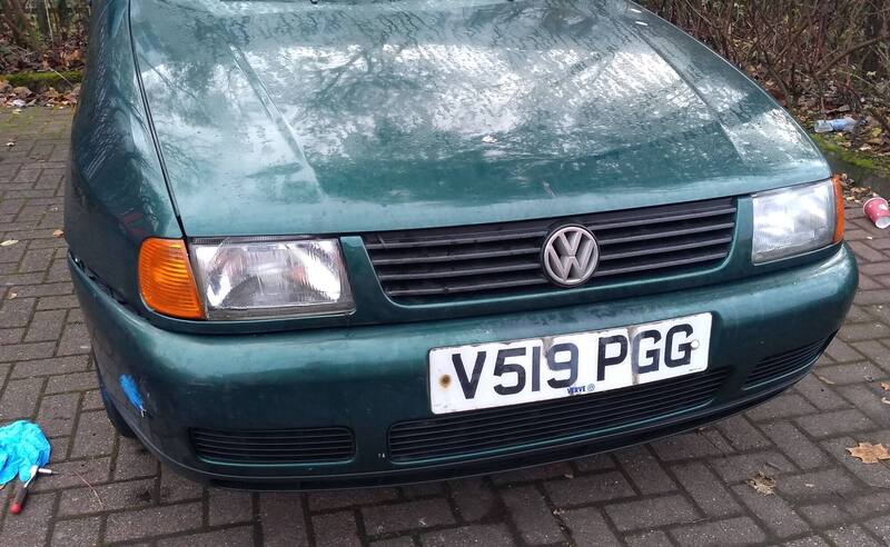

davehedgehog31 Posted November 16, 2019 Author Share Posted November 16, 2019 Effected some seamless bodywork repairs on the polo after its unfortunate interference episode. Headlamp now pointing in something resembling the correct direction. It had bent the wing front corner of the wing and the headlamp bracket, maneuvered it into almost the correct shape. Couldn't get the bumper back lined up properly because I'd need to drill out fasteners. Will do for now. Ladies, one at a time please. Split_Pin, michael t, Lacquer Peel and 5 others 8 Link to comment Share on other sites More sharing options...
Split_Pin Posted November 16, 2019 Share Posted November 16, 2019 That's tidied up well man. davehedgehog31 1 Link to comment Share on other sites More sharing options...

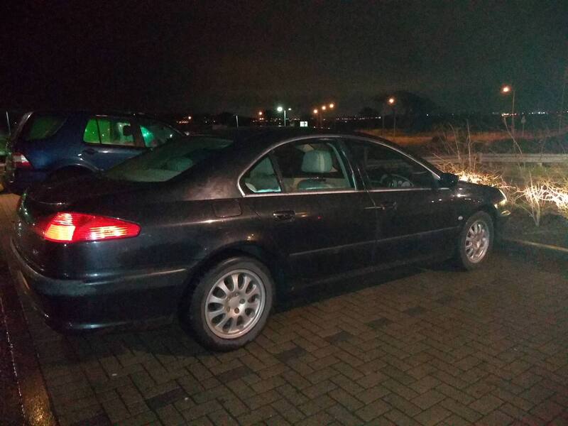

davehedgehog31 Posted November 29, 2019 Author Share Posted November 29, 2019 Acquired this slice of French luxury, only just getting round to writing up now after a hectic wee while. I got the train to Stirling to meet Mr @320touring after his work in the ML of much win. Was just thinking, reckon these trains have been in service a year and I've likely been on about 2853 collection capers on them. We arrived at the vendors house after about 45 minutes drive. The car was very cheap, but described as having a "hot start" issue. Upon arrival the seller eloquently informed us; "aye, the cunt'll no start at all wihoot the 'start ya bastard' spray. Ah'm fuckin sick a' the cunt, a just want the cunt away, it's a fucking heap a' shit" - He was that sick of the trouble it had caused him he replaced it with a V6 Diesel VW Touareg. We got it started and took it a short bimble just to make sure it shifted etc. It drove fine and I of course bought the cunt. It went straight to Scotoshite and drove ok, although I was severely nursing it. Large.... Full peeled cow... Electric roller blind.. VID_20191127_234441.mp4 Shots were taken of it, to quote @cms206, "thats fuckin awrite that" So it's a 2003 Peugeot 607 2.2 HDi SE. It has 135k on the clock and is tested until October 2020, N12 RMT for the reg pervs. On the plus side it has four newly refurbished wheels and 5 (five!!!) good tyres. All sorts of gadgets, bells and whistles. The interior is pretty tidy and will scrub up a treat. It actually drives really nicely with only the powerplant letting the side down. On the downside - the obvious starting issue. A short squirt of starting fluid and a few seconds cranking and it comes to life, will then run fine until switched off as far as I can tell. However, it's in some kind of reduced power state. The seller rhymed off a big list of parts that had been replaced. Fuel pump, starter, battery, fuel filter housing, fuel lines, one injector. My plan is to get it plugged into the Peugeot Planet software and get some better info on the error codes etc. If I were betting I'd probably guess injectors, but don't know really. Apologies for the shit pictures, I've not seen it in the daylight yet! Eddie Honda, wuvvum, michael t and 25 others 28 Link to comment Share on other sites More sharing options...

cort16 Posted November 30, 2019 Share Posted November 30, 2019 The crap running could be because the intake hose is loose after the maf so you can spray in the start ya bastard. That really needs to be secured or your generating more air in than the computer knows about. I think you need to drill a hole in the intake hose and stick a little rubber bung in you can take in and out. davehedgehog31 1 Link to comment Share on other sites More sharing options...
davehedgehog31 Posted November 30, 2019 Author Share Posted November 30, 2019 Dump from Peugeot Planet from last night. Was fucking baltic. Two main error codes: Eolys/DPF Camshaft position sensor error The error code is for cam/crank out of sync. To me this could be due to plum readings from cam, or crank. Or it's actually a tooth out or something. Video is of some live data when cranking, speed seems a bit slow to me and not sure what I should be seeing regards fuel pressure. VID_20191129_214507.mp4 The Moog and dome 2 Link to comment Share on other sites More sharing options...
