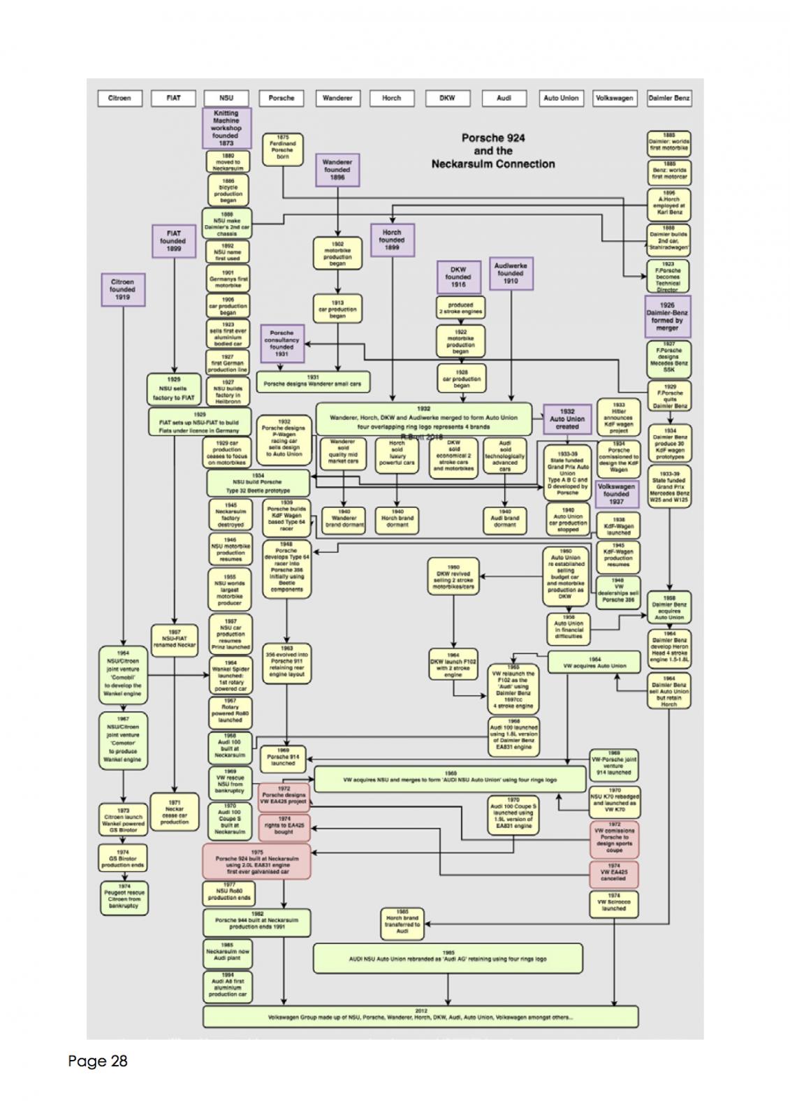

inconsistant Posted October 10, 2018 Author Share Posted October 10, 2018 Roobarb and catsinthewelder 2 Link to comment Share on other sites More sharing options...
inconsistant Posted October 10, 2018 Author Share Posted October 10, 2018 Comments and corrections eagerly anticipated! Datsuncog and Roobarb 1 1 Link to comment Share on other sites More sharing options...
