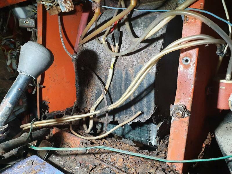

warninglight Posted July 11, 2018 Author Share Posted July 11, 2018 I've done a bit more stripping, and finding more rot and seized screws holding it all together... Body needs to come off, and I've been wishing I had one of these for ages, so here is last night's building job. It goes much higher and with a chain block on it will make a good job of getting the body onto my trailer and out of the way while I sort the chassis. Sigmund Fraud, loserone, Coprolalia and 2 others 5 Link to comment Share on other sites More sharing options...

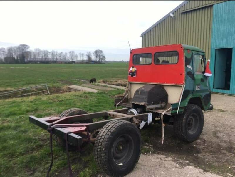

warninglight Posted November 25, 2020 Author Share Posted November 25, 2020 As said in the last post, I had just got started into this again, and I managed to break my thumb. That was 2 months ago now, so I'm just about back in action, with (I think) a fairly good idea of where I'm going with this. I had intended to keep the boxy body, and incorporate a pop top, maybe like this: There's a Dutch guy rebuilding one with the original steel roof panel working as a hinged pop top, I really like that design as it's invisible when down, so that would have been the preferred option. Unfortunately there's no getting away from the fact that the body is utterly knackered. All 5 doors need extensive work to the frames and skins, the floors are knackered throughout, the rear section of the roof is full of holes, and even stuff like the switchgear in the dash is rotten and seized. At this point it's worth remembering how I first saw it, in this photo, posted on here by Nigel Bickle. It was parked up around 1993, so I'm probably 20 years too late to be able to save it in an original guise. As bad as the body is, the chassis seems (so far) fairly sound, and I managed to score a spare set of axles, springs, gearbox, transfer box, steering box and even a B20A engine from a guy in Manchester who is building one with 300tdi Landy bits throughout. So I'm confident that I can build a driving chassis without too much trouble. One very handy thing is that I can reduce the amount of bodywork I have to contend with, as they also made a pickup version, and even an ambulance version which left the factory as a chassis cab. All I need to do is drill a few spot welds, and fabricate a flat panel to bolt onto existing holes behind the seats, and I can have something like this... Apart from the engine cover (and most of that is battery, which I will relocate to save space) that leaves me with a useful chassis to play with. I can get it roadworthy much like that, and then fabricate a flatbed body to suit, so it can be really useful. I'll have that so it can be lifted off with a few bolts, with the intention of, in time, building a lightweight insulated camper body to plop on as and when. If it's going to have double duty as a workhorse and a long distance travelling toy, then it really needs an engine to suit. My plan for that is to modify an M47 gearbox (the 5 speed version of the same family the original 4 speed M45 came from) to fit the original transfer box, giving me an overdrive gear, and, by sourcing that gearbox from a diesel 740, it'll bolt straight on to a VW TDI. I'm a bit short on space, and I'm not that keen on the 6 pot used in the 740s, but I love the 5 pot used in the 850s and V70s. It'll take some work to convert to mechanical injection, or to get it working with original ECU (my preferred option) but when it's done, it should be characterful, useable, and still have some Volvo heritage! Thanks @scdan4 for measuring his spare, I reckon it'll fit with a modern slim radiator. With all that in mind, stripdown work is continuing every spare hour I get... Hoping to have a chassis on the lift and the cab on a stand by Christmas! Then the hunt will be on for an 850/S70/V70 TDI donor... Volksy, Coprolalia, danthecapriman and 6 others 9 Link to comment Share on other sites More sharing options...
