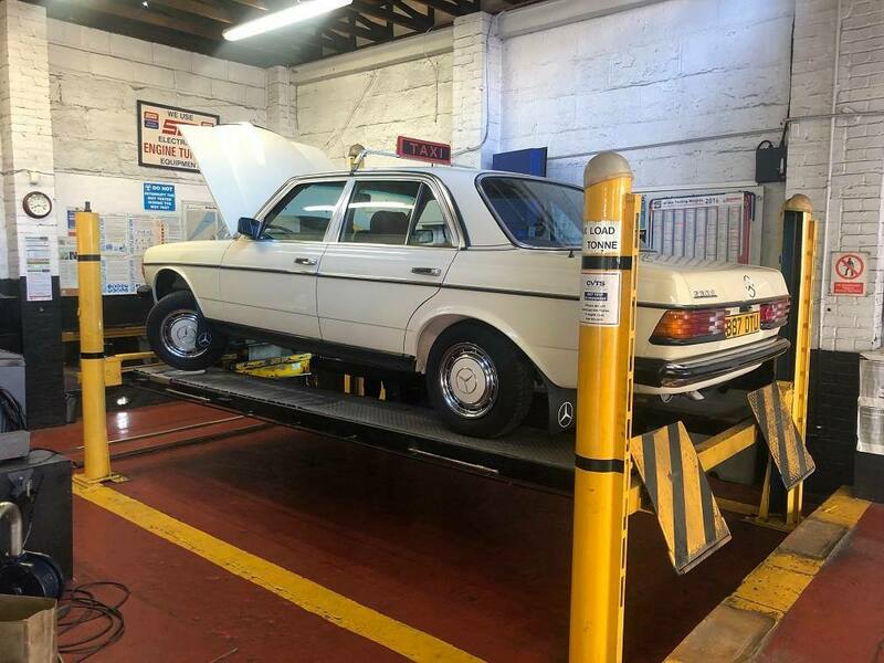

Peter C Posted July 20, 2021 Author Share Posted July 20, 2021 Buying and selling the Ford StreetKa and now acquisition of my R53 Cooper S has left me with less time to play with the old Mercs. Last week I took the 200E to Ace Cafe for the classic car night. It was well received. And this afternoon I dropped it off at a Mercedes specialist in Princess Risborough to have the front wishbones replaced. Depending on how easily the old ones come out, the 200E might even be ready for collection tomorrow. The 230E is going for an MoT tomorrow. In preparation, I got all four wheels off the ground. The brakes pulled a little to the left. I removed the offside front caliper, stripped it and gave it a good clean and grease up (copper grease). With the caliper reassembled and brakes bled, the brakes feel better. Let's see what happens tomorrow. The MoT tester is a nice chap but he is fussy about rusty springs. The 230E's springs didn't look great. Front. Rear. I gave them a clean and squirt of Hammerite. They look better and should keep the tester happy. Fingers crossed for tomorrow. Jim Bell, Shite Ron, Zelandeth and 10 others 13 Link to comment Share on other sites More sharing options...
Zelandeth Posted July 20, 2021 Share Posted July 20, 2021 Fingers crossed for a clean pass with no annoying niggling advisories. Having just fallen face first, unexpectedly into W123 ownership and being in the same general area as you hopefully you don't mind me asking who you'd recommend for parts and any specialist garages? I'm a bit old fashioned I guess these days in that I'd happily pay a few more quid to support a good specialist than just automatically buying bits from AutoDoc etc... Can absolutely see why these cars have such a following though! Link to comment Share on other sites More sharing options...
junkyarddog Posted July 20, 2021 Share Posted July 20, 2021 Driveshaft outer boot doesn't look too healthy. mercedade and Peter C 2 Link to comment Share on other sites More sharing options...

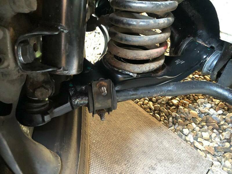

Peter C Posted July 21, 2021 Author Share Posted July 21, 2021 The 230E passed the MoT with flying colours. The tester didn't even notice the aged driveshaft boot! @junkyarddog And I got the 200E back with two new front wishbones fitted. It drives much better now, there's no knocking from the front end and the steering and suspension feel tighter. All being well I will take the 200E to London on Friday, a good run on the M40 will reveal whether the adverse reaction to road camber problem has been solved. Shite Ron, Six-cylinder, Isopon and 4 others 7 Link to comment Share on other sites More sharing options...

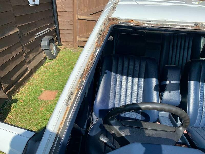

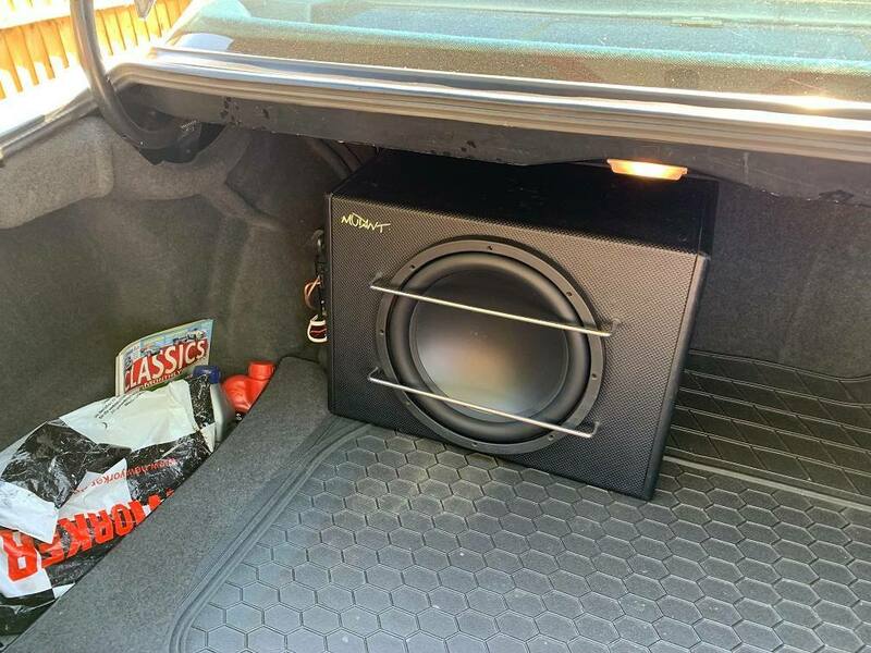

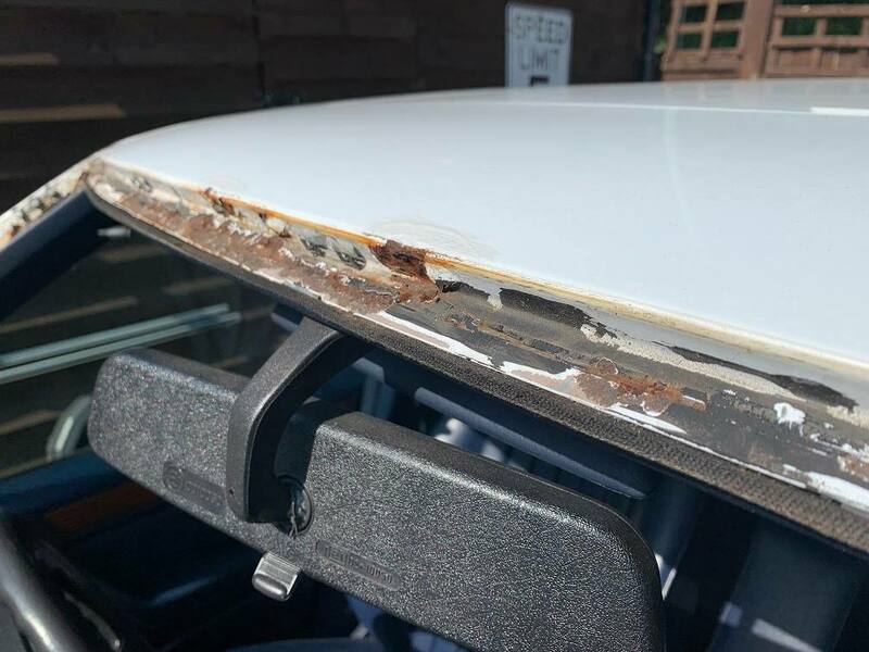

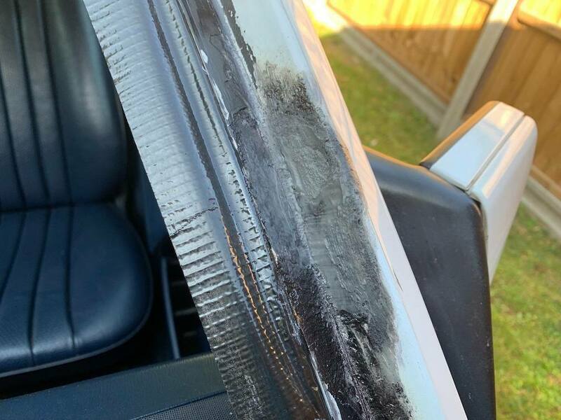

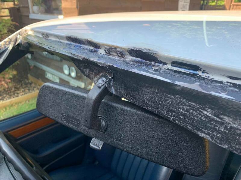

Peter C Posted September 7, 2021 Author Share Posted September 7, 2021 I haven't updated this post for a while simply because both Mercs have been behaving themselves and haven't needed any repairs or improvements. A few weeks ago, I removed the JBL subwoofer and Sony amp from the 200E and installed them in the back of my Mini Cooper. The plan was to install the Mutant sub and amp combo that Jim posted to me (guy who I bought the Cooper from) in the back of the Mini, however that went tits up when I discovered that the amp was knackered. The four (upgraded) speakers in the 200E were not enough to provide satisfactory quantities of bass, so I set about having the Mutant sub repaired. I ended up paying £45 to have some bits re-soldered and now it works. However, having installed it, it sounds crap and last weekend there was a guy at my local car boot sale selling the same combo, all in working order, for £25. Last week whilst driving the 200E along the M40, something hit the windscreen and caused a chip, right in the centre, which was very annoying. The AutoGlass man came out this afternoon and advised that the chip cannot be repaired because there are two small cracks too close to each other... The windscreen needs replacement. As it will take AutoGlass a week to source a new one, I asked matey to remove the existing windscreen today, to give me a chance to tidy up the metalwork around the frame. He obliged and I found this. It looks worse than it is. The majority of the rust is just on the surface and only one area on the nearside post is bad, where the rust had gone right through the metal. I got to work straightaway. I started by wire brushing off all the crud and corrosion. Then I applied three coats of Kurust to all corroded areas. And finally, I filled the large corroded hole with chemical metal. Tomorrow I will give the metalwork another clean up and paint it with white Hammerite. The paint should harden within a week, leaving the frame ready to receive a new screen. Whilst this may seem like bad news, I suspected that rust was hiding behind the screen and this is the cheapest and simplest way of sorting out the problem. A blessing in disguise. Rusty_Rocket, Agila, Coprolalia and 5 others 8 Link to comment Share on other sites More sharing options...
junkyarddog Posted September 7, 2021 Share Posted September 7, 2021 That needs welding,not filler. Magnificent Rustbucket, Split_Pin, Minimad5 and 5 others 7 1 Link to comment Share on other sites More sharing options...
Tadhg Tiogar Posted September 7, 2021 Share Posted September 7, 2021 3 hours ago, Peter C said: .... this is the cheapest and simplest way of sorting out the problem. A blessing in disguise. 2 hours ago, junkyarddog said: That needs welding,not filler. I suspect wob is cheaper. Link to comment Share on other sites More sharing options...

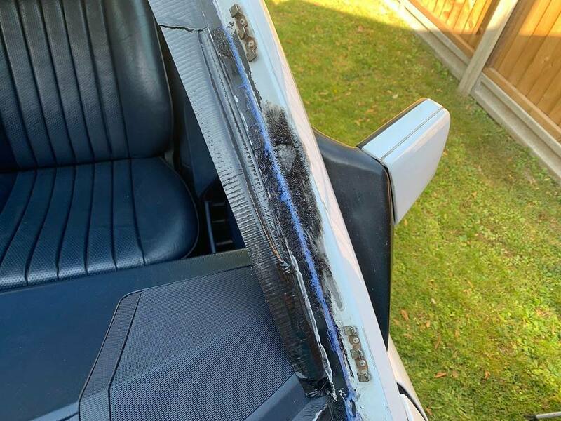

Peter C Posted September 8, 2021 Author Share Posted September 8, 2021 Can’t argue that welding is better, however: 1. I can’t weld. 2. I have wob. 3. Not welding up a small hole in a windscreen post is not the end of the world. 4. I have already spent too much money on this car, getting someone out to weld the hole will cost £££. 5. A wob + Hammerite repair will be good for as long as this car will live. 6. Welding will damage adjoining paintwork, wob will not. That’s enough, I’ve convinced myself that I’ve done the right thing. The Mighty Quinn 1 Link to comment Share on other sites More sharing options...
Fumbler Posted September 8, 2021 Share Posted September 8, 2021 I thought windscreen pillars were structural. The Mighty Quinn 1 Link to comment Share on other sites More sharing options...
Peter C Posted September 8, 2021 Author Share Posted September 8, 2021 28 minutes ago, Fumbler said: I thought windscreen pillars were structural. I’m sure they are but a 12mm rust hole filled with wob is not going to affect the structural integrity of the car. Shite Ron 1 Link to comment Share on other sites More sharing options...
Minimad5 Posted September 8, 2021 Share Posted September 8, 2021 No fellow member off here live close enough, in order to make a solid 'Welded' repair ? The rest of the car is in such great condition, be a shame to bodge this wee bit up. BUT obviously your car, so if its a repair you're happy with, then crack on sir 😎 ... but do post more Mercedes related pictures, as they're both bloody lovely looking things. Link to comment Share on other sites More sharing options...
Peter C Posted September 8, 2021 Author Share Posted September 8, 2021 23 minutes ago, Minimad5 said: No fellow member off here live close enough, in order to make a solid 'Welded' repair ? The rest of the car is in such great condition, be a shame to bodge this wee bit up. BUT obviously your car, so if its a repair you're happy with, then crack on sir 😎 ... but do post more Mercedes related pictures, as they're both bloody lovely looking things. Holes in bodywork = superleggera It’s a small bodge that I can live with. Until yesterday, I didn’t even know that the windscreen frame was that corroded. Bit of wob, Kurust and Hammerite and the old girl will be as good as new. If you look closely, the 200E is not that mint. It’s not bad but it’s far from perfect. Shite Ron 1 Link to comment Share on other sites More sharing options...

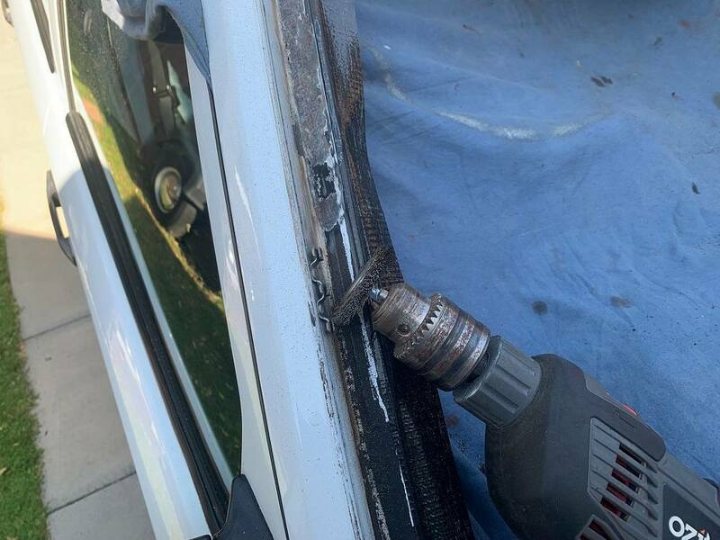

Peter C Posted September 9, 2021 Author Share Posted September 9, 2021 I've given the inside of the windscreen frame two coats of Hammerite. It now has five days to dry before the new windscreen is fitted. Unfortunately, surface rust has spread to paintwork that will not be concealed by the side trims. Never mind, a bit of exposed brush on paint makes for good patina. Shite Ron and Dyslexic Viking 2 Link to comment Share on other sites More sharing options...
