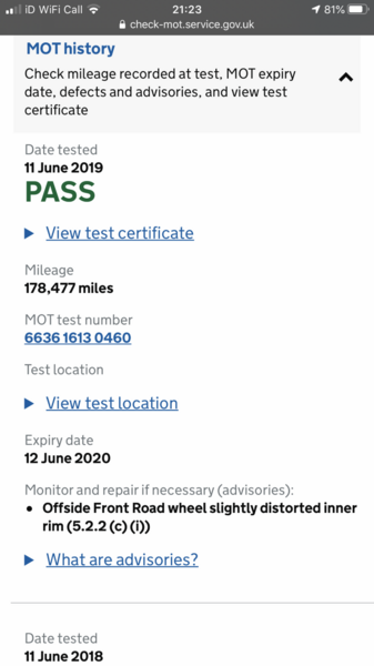

dozeydustman Posted May 11, 2020 Author Share Posted May 11, 2020 The last of the engine service items for this and the Suzuki have arrived this evening (thermostat & pollen filter for this car) so services should be carried out this week, along with giving anything perishable a check. Only advisory last year was a distortion on a wheel rim, but I don’t recall the drop links having been changed (which were and advisory from 2018), so I’ll have to rummage through the paperwork before I order a pair. I’m hoping the thermostat housing isn’t a sod to do, I doubt it’s ever been replaced and I cannot run the risk of madam not being able to get to work. Pretty sure it’s the stat as the car takes forever to warm up when it’s cool. LightBulbFun and St.Jude 2 Link to comment Share on other sites More sharing options...

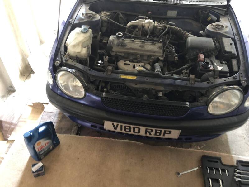

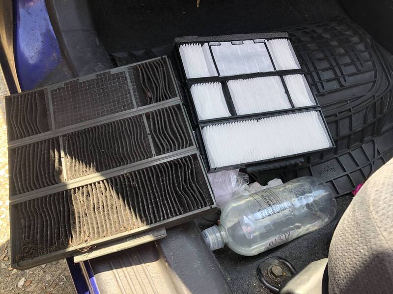

dozeydustman Posted June 2, 2020 Author Share Posted June 2, 2020 Oil change done today. Didn’t spill any. As I use a browser app called Honey it automatically applies discount coupons to the online shop, and ended up with 60% off Euro Crap parts. All Parts present and erect. Hence the Bosch filter and Shell oil. I have no idea when the Pollen filter was last changed. Replacement was a bastard to get in though as it needs rolling up and a precise aim because tight bit of footwell. Ventilation is a little better and much less smelly but sadly air con needs gassing up. Air filter didn’t get changed as 8 months old and still quite new looking. Later this week I hope to dump all the coolant, change the stat and water pump. Takes a very long time to hit the normal area of the temp gauge, especially on a colder day, but struggles to stay cool in traffic - no airlock and original 185k mile pump. Clutch pedal has no free play either so that will be done. Want to do a full on pre-MoT checkover as well, brakes, bushes, bearings etc as there’s a but of a rattle over certain road undulations which I have failed to replicate - Strut tops? Jim Bell, Dan302, Angrydicky and 1 other 4 Link to comment Share on other sites More sharing options...

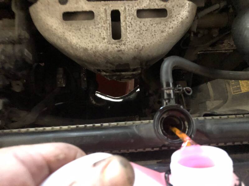

dozeydustman Posted June 19, 2020 Author Share Posted June 19, 2020 As you may have seen on the thread of grumps I started the coolant and thermostat change in the Toyota yesterday. A simple job that should take half an hour, maybe 45 mins? No. Draining the rad was simple enough. Nice tap and some rather brown coolant came out, likewise Draining the block. Getting this in there was a ballache and a half. I have huge hands and couldn’t get between exhaust manifold and oil filter. Manifold also prevented getting a ratchet on there and didn’t give a good line for an extension or UJ. I did this in the end to get the bung back in. Filter back on, turn attention to ‘stat housing. Came off with no problem. Stat is ever so slightly open and has a rubber ring around the spring; I would suspect it’s the original as installed by Toyota. New one installed. stud sheared on torque up, was nowhere near the click for correct tightety. Cue farce trying to order a stud extractor from Halfrauds. Workmate saw my plight on Faceb**k and popped over with a selection of tools. We got the broken stud and have swapped it temporarily for a 25mm machine screw with a smoll spacer (20mm too short, 25 too long!). Test drive. Photo taken by passenger* Car holds temperature lower than prior to dripping the coolant, and warms up a bit quicker than before due to new stat. I’ve only filled up with plain water as there is a lot of black and brown crap floating around this system, so going to run with just this for a few days and may pop a dishwasher tablet in the system to remove some major skank, flush out and refill with Toyota spec Pinky-red coolant. That will probably be early part of next week, along with a pre-MoT checkover and submitting for test. BL Bloke, Dan302, LightBulbFun and 2 others 5 Link to comment Share on other sites More sharing options...
dozeydustman Posted August 3, 2020 Author Share Posted August 3, 2020 When I left this car last time I had to bodge a bolt to the thermostat housing while I ordered some 6mm studs. Studs arrived ages ago but a certain teenager has been working and seeing her boyfriend since the restrictions were eased and hadn’t had a chance to do the coolant change. This was thermostat housing bodge bolt. Whipped it out and thankfully the housing remained firm thanks to a bit of assembly gloop I put one the mating surfaces. Bolt then went back in as I could not now find the studs. The flush got a bit more crap out but most of that came from the horrid block drain point. I must change that to a tap one day. It’s a ballache to get to and my fat hands mean I need to either remove the oil filter or the exhaust manifold. Filled up with Toyota original spec ready mixed coolant. Need to put a label on the rad to say what’s in it just in case a garage or someone else does a top up. 15 minutes idling to burp the system and then a good run plus some town traffic and the level didn’t go down when I got home so can only be a good thing. Aside from a stop/tail bulb changing It does need drop links for the MoT. It’s got its Boris extension but I’m rather reluctant to have 2 cars with tickets expiring within a couple weeks of each other. Can’t find much else wrong with it but I don’t have a ramp nor a decent jack at the moment, so have only found what I can with the car sitting on the deck. Here she is smiling in the sun. spartacus, GrumpiusMaximus, LightBulbFun and 3 others 6 Link to comment Share on other sites More sharing options...

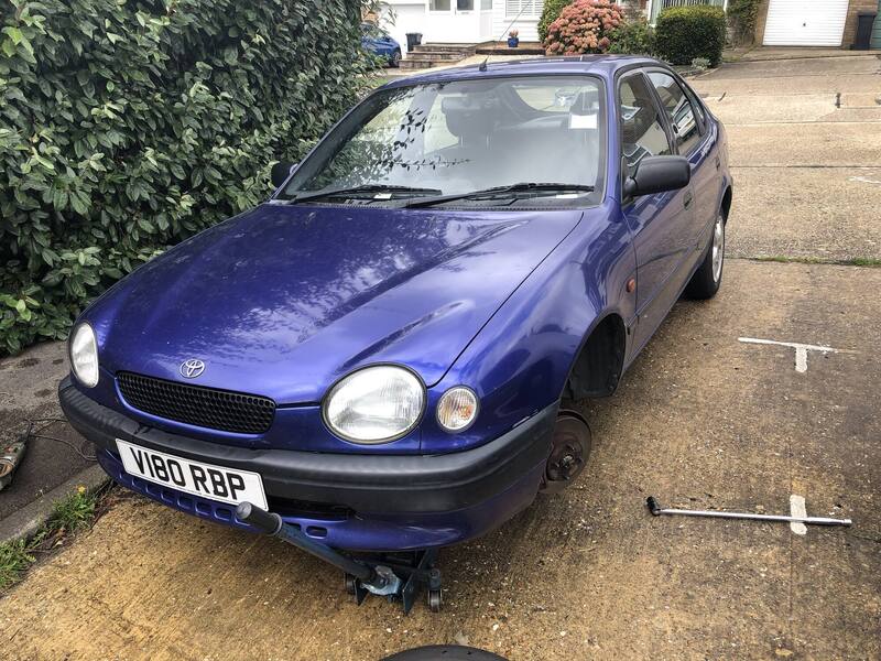

dozeydustman Posted August 23, 2020 Author Share Posted August 23, 2020 Bit of pre-mot work this lunchtime. Had to do on the road because no electrics in garage and needed the angry wheel of death. I got caught in a short sharp shower and abandoned for 10 mins. I think this drop link is bollocksed IMG_3100.MOV LightBulbFun, Jim Bell and Angrydicky 3 Link to comment Share on other sites More sharing options...
dozeydustman Posted August 23, 2020 Author Share Posted August 23, 2020 What’s nice about the replacement link Is the ball side of the thread has a spanner flat on it as well. Hopefully when these next need doing in 21 years they’ll be easier to remove. Repeated on O/S as well. Cuppa, lunch then adjust handbrake and I think all got for the MoT Jim Bell, Angrydicky and LightBulbFun 3 Link to comment Share on other sites More sharing options...
