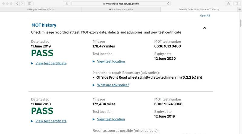

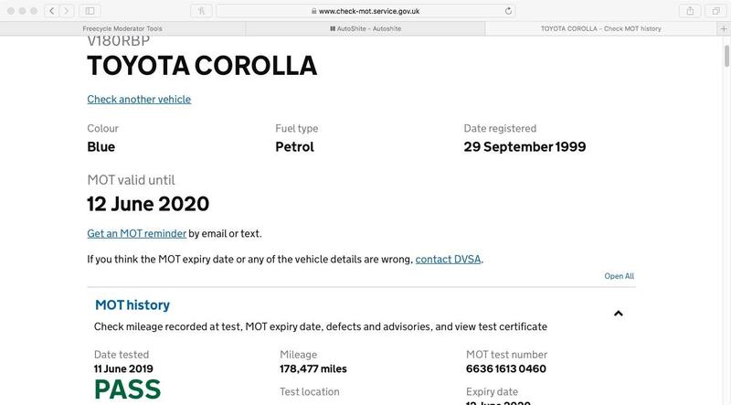

Many kinds of Joy!
One advisory, and the rim has been like that for as long as I have been with Mrs D. Garage spent yesterday afternoon and half of today removing the ball joints, even grinding off the top of the castle nut & split pin hole they put up a hell of a fight. Then again I don't think I'd move easily if I'd been installed in the same place for 20 years. Emissions at idle are 0.0% CO and fast idle 0.02% so she's still running really clean.
