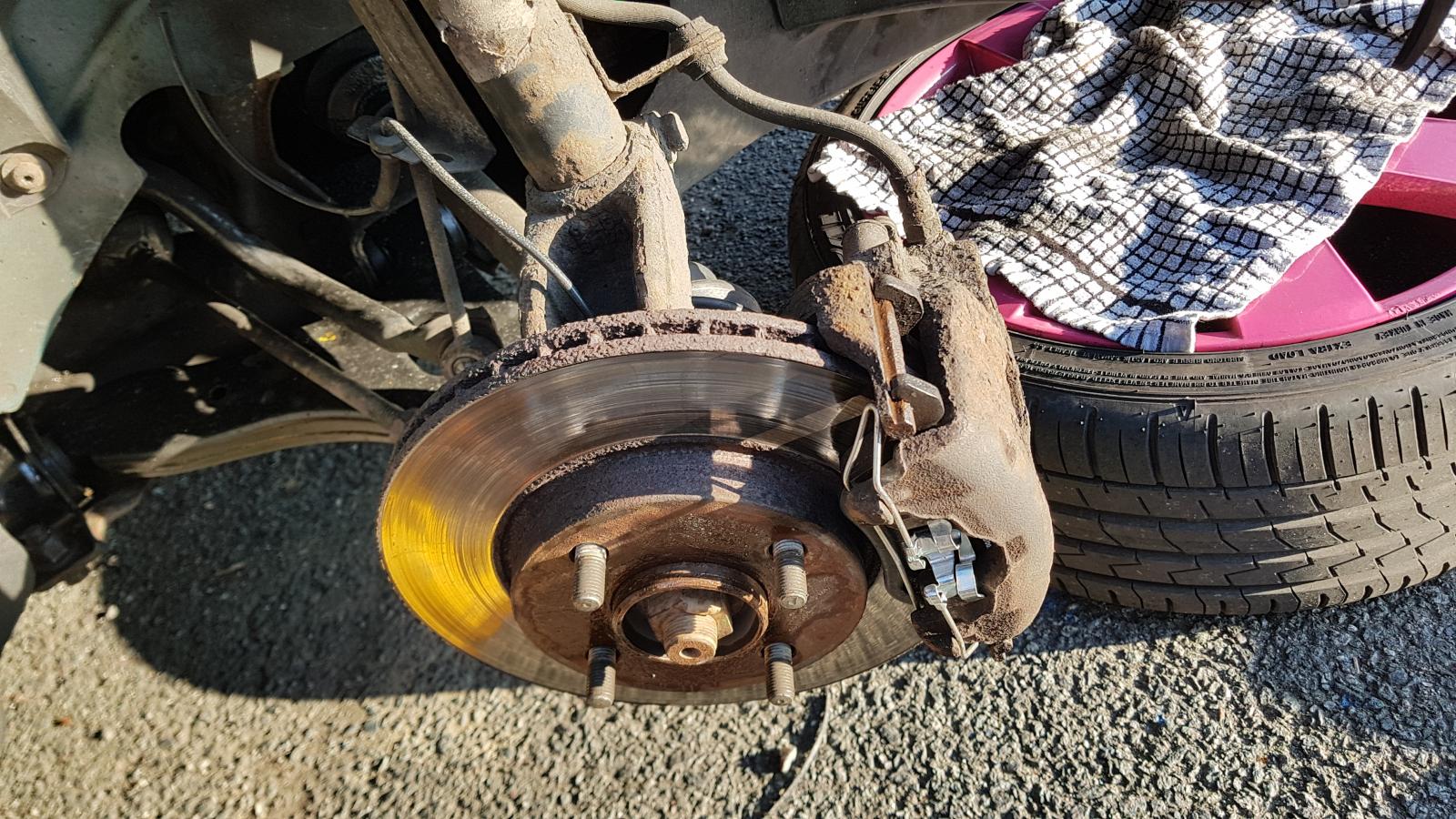

Decided id put new discs to go with the new pads i fitted last weekend.. time to christen the car park where misses moved too...
