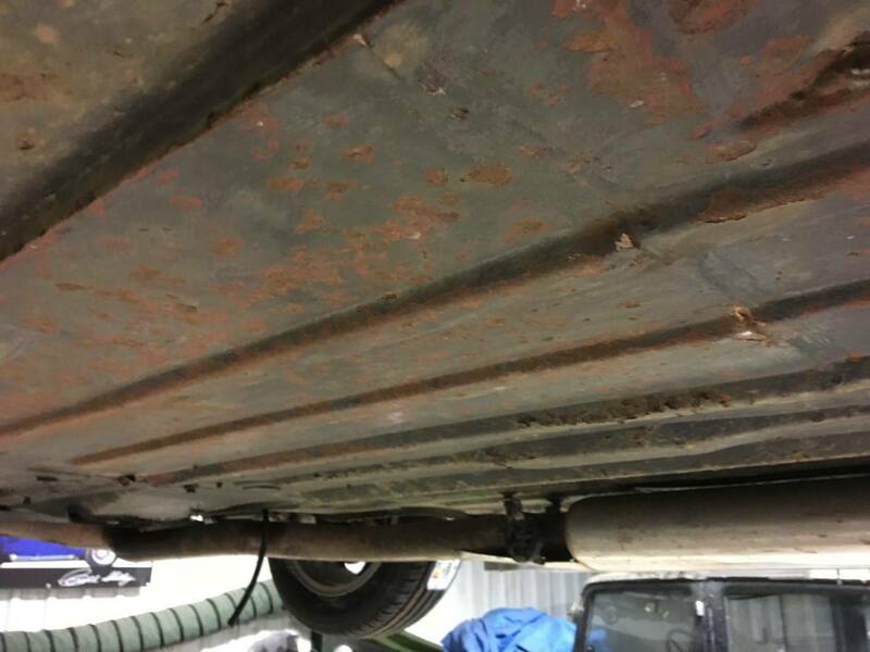

Saabnut Posted November 8, 2021 Author Share Posted November 8, 2021 Yesterday I was back in the shed and continued with the polishing. Basically everything below the waistline has now had a clean and a coat of polish. Once that was done, I lifted it higher to see just how good or otherwise the floorpan is. The previous owner to me said he had wire brushed and hammerited the lot when it was imported from the states, as it had never been welded and he wanted to keep it that way. I had no reason to dis-believe him, but as these are such a low car, it was hard to get a good look. The lift has solved that problem, and my faith in humanity* was rewarded when it was very obvious he had done as he said, although that was nearly 12 years ago! There were many areas of small rust blebs where the paint has suffered stone chips and surface rust has started. A going over with a wire brush in the angry grinder soon had the rust removed, although I only got 80% done before the battery died in the grinder Once the rust was gone, the entire floorpan was treated with Jenolite and left to dry An early night was required as I had an early start today. Up at 5am and away for 6am as I had to be near Lymm for just after lunch, and this was the transport of choice and necessity. 326 miles later, it ran beautifully and the run down was very pleasant indeed. It fully justified the small* amount of money I am spending on it this week. Currently in a travelodge (again), but at least the wifi is a bit quicker than at home! dome, anonymous user, Shite Ron and 13 others 16 Link to comment Share on other sites More sharing options...

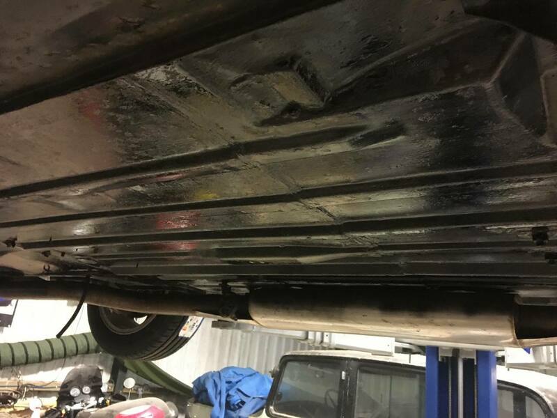

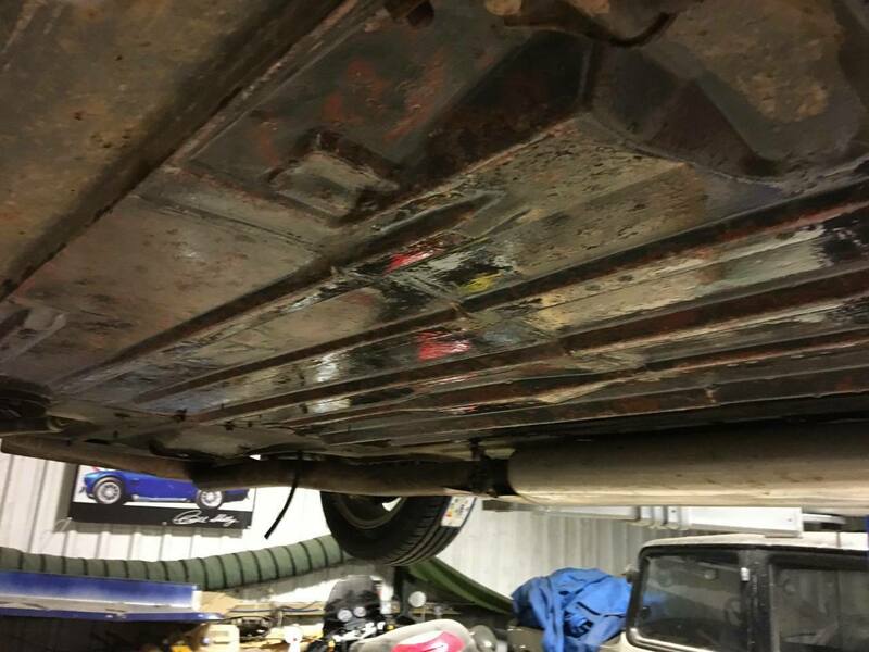

Saabnut Posted November 15, 2021 Author Share Posted November 15, 2021 Well, a dirty weekend, but sadly not that kind. Back to the Sonett, and the entire floorpan has been wire brushed, treated and painted. In addition, the underside of the bonnet has had so many coats of underseal (presumably as sound deadening) that it is over 1/16" thick (that is 1.6mm to the uneducated ). Unfortunately the last coat has reacted with those below so the last day and a bit have been spent scraping and wire brushing it off. I have left the sound areas as there is a risk of damaging the fibreglass, but it has created so much dust that even after a shower I still feel dirty. Some pictures of the floorpan to cheer myself up! stripped fred, Mally, EmperorPigeon and 13 others 16 Link to comment Share on other sites More sharing options...
