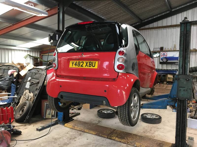

Saabnut Posted September 6, 2020 Author Share Posted September 6, 2020 There is now a waiting list for MOTs up my way, and despite my mate being a tester, the first slot I could get is for next Friday, so have booked the Enema in for then. Today I thought I had better check it over. The rear fog light was not working but a scientific thump sorted that. The nearside dipped headlight was also out and a thump did nowt, so opened the bonnet to change the bulb. As soon as I touched the connector the headlamp came back on and has remained working since. Clever things these Toyotas, self repairing. Sitting in the car, it appeared to be misty, as the windows were filthy both inside and out. I think the inside of the windows were the dirtiest of any car I have ever owned. Once cleaned a break was taken as @Supernaut and @17-Coffees arrived for some Saab fettling. This afternoon it was time to tackle the headlights which were yellowed and milky Out with the machine polisher and the cutting compound, and 10 minutes later, I reckon they will pass an MOT Midges came out so time to head indoors.... paulplom, egg, eddyramrod and 11 others 14 Link to comment Share on other sites More sharing options...
Saabnut Posted September 11, 2020 Author Share Posted September 11, 2020 Oh it is so nice to be back playing with the fleet. In the last few days, several things have happened and mostly good has been the result. First off, the last couple of times I have used the Smart car, the brakes have felt terrible and grindy noises came from the front. Obviously pads out, so ordered a set just before going off to work. So moved the Royce out of the shed to give access to the ramp and after a bit of fiddling managed to get it up (ooh missus) Removed the callipers to find one slider pin a bit sticky but otherwise all in good condition, including the pads which were less than a third worn. Bugger. Decided to fit the replacements anyway as I had them, buttoned it all up and took it for a test run. Completely cured the noises and the brakes feel much better. Put it down to the old pads being made of finest chinesium so in the scrap bin they went. Next job was to fix* the Disco 1. Getting the remote fob to operate has been getting more and more difficult, which mostly was not a bother as I don't lock it when at home, but its needed to turn off the immobiliser. When it took 5 minutes of pressing I decided to sort it before it left me stranded, so opened up the key fob to replace the battery. This made a big difference, now it will not work at all! Checked the battery I had just fitted and it said 2.7v instead of 3v so replace that with another new one, this one showing 3.1v which promptly made no difference whatsoever. Not being worried, I dug out the spare fob which continued the theme. Opening up that one, there was no battery at all. Fitting a (tested) new one made the full set when that one also failed to work. The PO said the spare was unreliable so I have come to the conclusion it was not the battery failing, but the buttons on the fob. My friend Simon is going to look at them for me, until then I have a new garden ornament. I hate moderns (it is a 1997 model, so modern!) Today this happened Yes, the Enema went in for an MOT to see how bad it was and if it was worth fixing. Having bought it unseen for 150 pictures of her maj, and since collecting it by trailor all I had done was thump a couple of lights to fix* them and clean the windows and driven it to the end of my track to see if the brakes worked, I was not expecting much. When towards the end of the test the tester called over the other tester to point out something underneath, I feared the worst. Turned out he was showing him how good it was underneath and the original brake pipes were still near perfect. Advisories for new wiper blades and a slightly rough wheel bearing and a new certificate was acquired. I will take that. Tomorrow my carpenter arrives, so I had better have a tidy up before he gets here! dome, bunglebus, catsinthewelder and 12 others 15 Link to comment Share on other sites More sharing options...

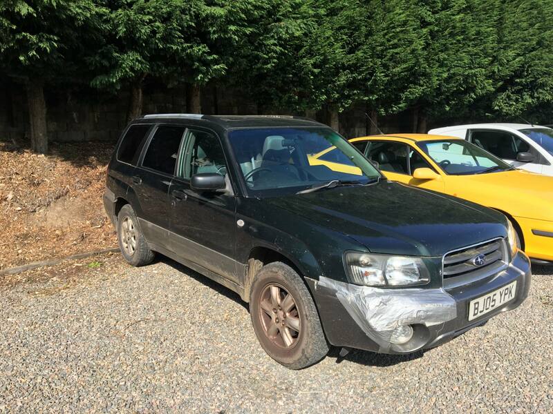

Saabnut Posted September 22, 2020 Author Share Posted September 22, 2020 Busy couple of days, but not a huge amount achieved, but meh. Firstly the Subaru was collected. Runs nice, exhaust is blowing but worst is the clutch is very much on its last legs. The car was bought with the intention of running until the MOT expired where it would become a donor for a future sensible* project. My mate says it is not a hard job to do a clutch on one of these, but I don't think I can be bothered at this stage. I might lash out a months tax at the start of next month and see if the clutch lasts a month, or it may go straight into the storeage section. We shall see. Next was to convert the Toyota Enema into a van so out with the middle row of seats (the rear row were just loose in the back). Simple job (4 screws and 4 bolts each) but my they are heavy! On removal I found out why they are so heavy, both the single seat and the dual seat are both "captain seat" type things, ie they swivel. This is a bonus as I am sure that some hipster building a Kamper van will want to buy them, so next evil bay selling deal day they will get listed. In the mean time the Subaru is making a good shed..... Next was to track down the reason the Modus has started to wander around on the road. I knew I had installed the ramp for something: Bottom ball joint on the drivers side is well beyond its sell by date so new suspension arm complete ordered for 35 quid. First expenditure on this car in nearly a year so not going to complain. Having found the fault, in for tea, where a friend phoned to see if I had scrapped the Yaris yet as he was repairing a friends Yaris and the front calliper mount had seized and the pin sheared. Nobody lists these nowadays, nothing on Ebay and none of the local scrappies could help. Fortunately he was in luck (sometimes being CBA does help) so he called over to remove the one from the Yaris before it heads to the bridge. Once again, the ramp came in useful: Fortunately the correct part in good condition. As the Yaris is out of its hidey hole, tomorrow I will definitely* get around to draining the fuel tank, removing the CD player, battery and wheels and load it for its final journey to the bridge. Maybe, beko1987, theshadow, Floatylight and 3 others 5 1 Link to comment Share on other sites More sharing options...

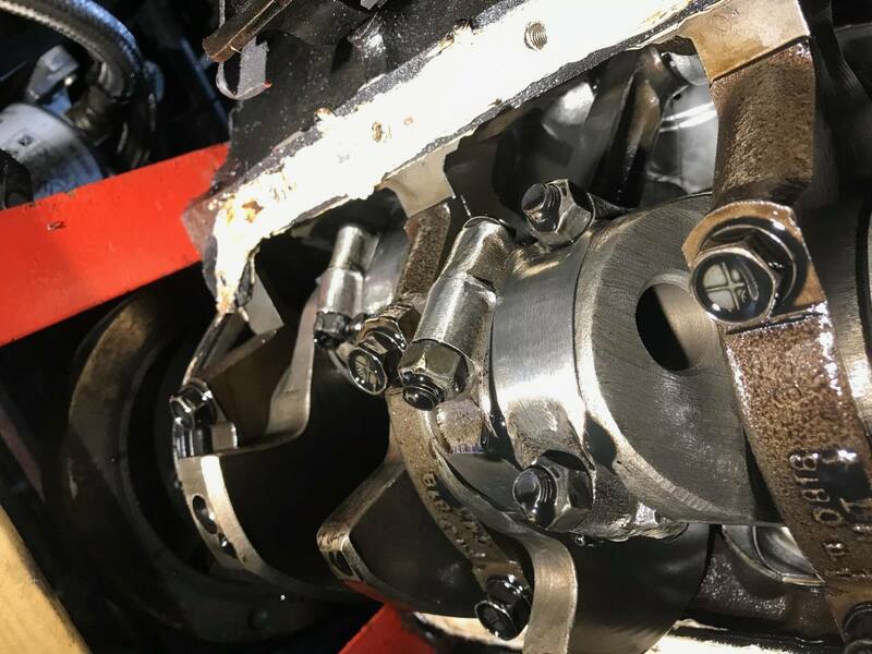

Saabnut Posted November 4, 2020 Author Share Posted November 4, 2020 Late as ever, but I eventually get around to it! First the engine needed lifting off the mounts by a couple of inches to allow the sump to be dropped, which entailed making a couple of brackets. All went smoothly and soon the sump was off Despite regular oil changes, due to a bodged breather system, the sump was full of tar. So, what do we have? Apart from the quality* gasket all appeared good from a first glance. The eagle eyed may have spotted the machining to the piston skirts and the bearing caps to ensure clearance, which was nice to have confirmed that it is a 400 smallblock Chevrolet that has been taken to maximum bore and a stroker crank fitted to take it to 427 Cu In as I was told when I bought it but was on trust as there was no documentation for the engine work done. First was to check one of the mains (randomly chosen - number 3) All good, no wear, no delamination so on to a random big end (number 7) Again, all good, and evidence of good quality workmanship, as can be seen that all the oilways have been tuliped to ensure higher oil flow. All bearings are at standard size indicating new components were used, as I was told. So new gaskets bought and sump cleaned ready for fitting Before the sump can go back on, the front timing cover has to come off for a new gasket to be fitted. This needs the front crank pulley/harmonic balancer to be removed, but a special tool is required to refit it which has been ordered. Cavcraft, puddlethumper, LightBulbFun and 9 others 12 Link to comment Share on other sites More sharing options...
