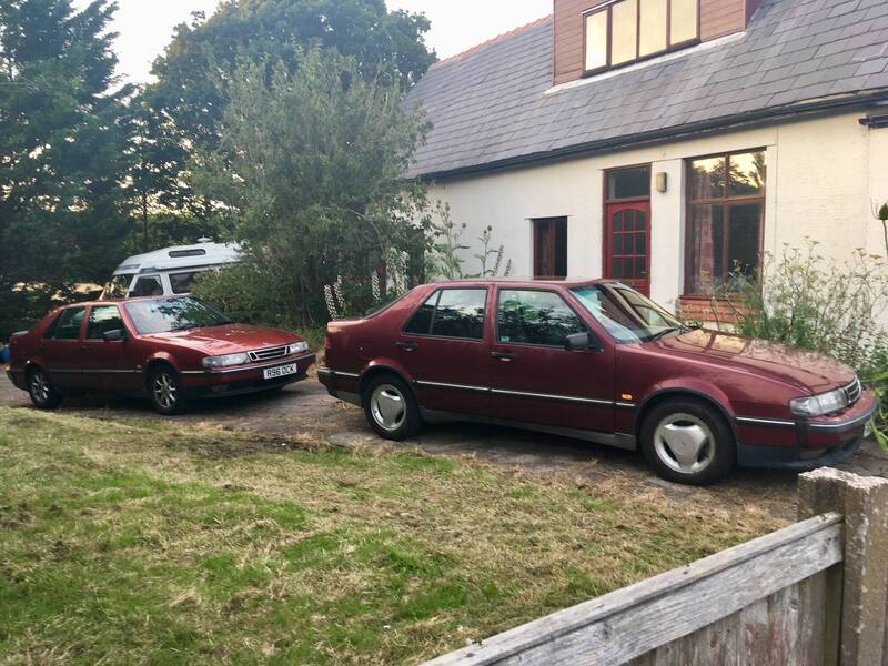

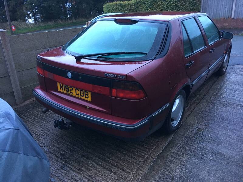

brownnova Posted July 23, 2019 Author Share Posted July 23, 2019 As alluded to in News24... I now have all 5 fleet members on the road! As a quick recap I bought my second 9000 off a driveway where it had languished for 2 years slowly festering. I’d spotted it for my spotting thread, and just couldn’t stop wondering if it was for sale. Turns out The old chap who used it had died, and it just sat unused. I bought either for parts for mine or to do up. Once I saw how good it seemed under all the lichen I couldn’t break it. I bunged it in for an MoT and the fail wasn’t too bad at all... so I set about gathering parts to do the jobs and... never got around to it. Fast forward to earlier this month where I bought a trailer. Only the Campervan has a tow bar and that’s heavy enough, so the only sensible suggestion was to put the Saab back on the road... Having languished with me for a further 9 months I decided to bung it to the Saab specialist who sorted my other 9000 for its MoT. I did a little prep work on the brakes and put new tyres on, and checked it over and gave it a jet wash. I guessed a new brake pipe would be needed and the exhaust I had bought would need fitting. Oh and the ABS light was on. Today I got it back, admittedly with a larger bill than expected (which I could’ve done without what with a wedding and a house to pay for!) and it was the expected items plus a pricey ABS sensor, fitted a new ‘flex pipe’ on the exhaust (bit in front of the cat) which cost 3 times what I’d paid for the whole rear exhaust, and serviced it (which I didn’t ask for, and he has charged me for... but hey ho saves me a job) and changed the ATF (which I did ask for and he didn’t charge me for...). Anywho the result is that I now have two 9000s on the road, this one (Bjornadette) has done 100,000 fewer miles, has leather seats and an auto box (oh and it’s technically @Mrsbrownnova‘s). It’s likely to be the tip run and towing car for now. The outside looks tatty, and the lacquer has more peel than a ginger who’s been in the sun. But it runs lovely and the drive is smooooth. It’s down on power compared to my one. I think the turbo might need a fettle. But it’ll do for now! Next steps will be to tidy the exterior, sort the few rust spots and re-lacquer a few bits. Here they are together at home! Skizzer, Six-cylinder, Lacquer Peel and 10 others 13 Link to comment Share on other sites More sharing options...
brownnova Posted July 25, 2019 Author Share Posted July 25, 2019 Hmmm.... day 2 of Bjornadette’s return to the road, and there’s somewhat of a rattle. It only occurs in D or R at idle and again at around 1600-1800 revs. Pop it in N at idle and it goes away, same if you rev up to 1600-1800 revs in N. Sounds like a vibration or something rattling against something else. New exhaust was fitted and the ATF changed. This is the first auto I’ve ever owned, I hope it’s not a bad sound... Will just have to keep driving it and see if it self heals. Link to comment Share on other sites More sharing options...
Ghosty Posted July 25, 2019 Share Posted July 25, 2019 Loose heat shield? brownnova 1 Link to comment Share on other sites More sharing options...
brownnova Posted July 25, 2019 Author Share Posted July 25, 2019 That’s what I’m hoping! No time to investigate tho... moving house today, getting married ion Saturday! Busy busy! Jim Bell 1 Link to comment Share on other sites More sharing options...
brownnova Posted August 8, 2019 Author Share Posted August 8, 2019 Two updates really.... I broke one and I bodged a fix on one. Firstly.... The ‘project’ Saab had been back on the road a week... but the rattling made it sound like a skeleton having a wank in a biscuit tin...I drove to pick something up from the house we’re about to return to the Landlord having bought one. The rattling was so horrific I thought I’d best see if I could work it out. So I put it in reverse so it would rattle (I didn’t want it to roll into the garage). It started to roll backwards (as it’s an automatic) which spooked me as I thought I’d put the handbrake on. I stabbed my foot at the brake, but caught the accelerator and sent the car flying backwards... the door was open and caught the fence post bending the door backwards... FUCK!!! Door dented to buggery. Thankfully I managed to bend it round and it still closes. But I’ve made a right mess of it. Doesnt look too bad... but wait... The fence post didn’t fare much better... Arsenuggets. So that’s a new door and a new fence post required! ? I’ve taken a hammer to it, to try and knock a few of the dents out, and it’s driveable now. You have to slam the door tho... So today I thought I’d sort the rattle. My first chance to use my pit!!! Turns out it was the heat shield on the exhaust. That’s supposed to be attached but both bolts appear to have sheared off. So I’ve bodged it with some exhaust paste for now as I just wanted a quick fix whilst I work out how to fix it properly. It’s stopped the noise, so job done! Now to source a decent door for not much cash... RobT, Jim Bell, Coprolalia and 1 other 3 1 Link to comment Share on other sites More sharing options...

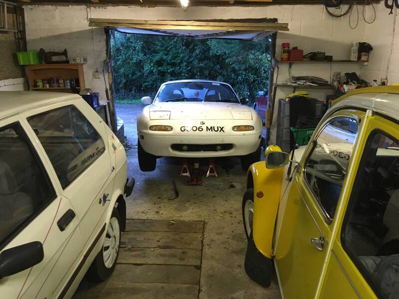

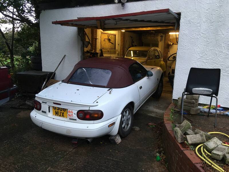

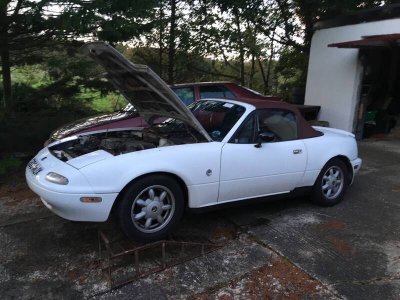

brownnova Posted October 13, 2019 Author Share Posted October 13, 2019 The Mazda has been out of regular action for a couple of months due to a leak on the PAS cooler pipe. The leak was due to corrosion abd a new pipe was £lots. Firstly I attempted to use pipe repair tape, but the worse pipe was the top one, and I disturbed it trying to repair and made the leak worse. The car was now unusable. So second fix was to bypass the pipe as per advice. Easy job of cutting the pipe and joining them. Except... I only had a hacksaw and I couldn’t get it into the gap. So fast forward to today. Plan was to do it on the drive as the garage is full of Yugo (not easy to move) and 2CV... but the rain meant that was unlikely, until Mrs brownnova suggested pulling it into the front of the garage and doing it there. I’d bought a dremel to cut the pipes and cut the two pipes, which is where human error kicked in as I cut the top pipe too short and at an angle making looping the rubber replacement pipe more challenging as the pipe went wider at that point. But a pipe widener whilst o ate my Sunday Roast helped with that. Not totally happy with it as I wanted more overlap between the pipes. I may get a slightly bigger and longer pipe and re-do it, but test drive complete and all the PAS fluid is where it should be! Fingers crossed it’s fixed!!! Just in time for Winter.... ? gm, paulplom, Fumbler and 5 others 8 Link to comment Share on other sites More sharing options...

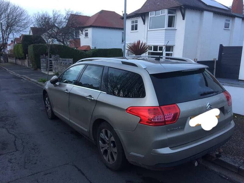

brownnova Posted January 20, 2020 Author Share Posted January 20, 2020 First arrival of 2020... don’t get too excited! With the impending addition to the family @Mrsbrownnova decided she wanted a more sensible family wagon. One which could carry prams and friends and their babies etc, I was mindful that I wanted something at least interesting enough so I wouldn’t feel like a total sellout to dull modern motoring. Yesterday we went to look at a local car for sale, and today we bought it the massive 8 miles home! The car...? A Citroen C5 2.0 HDi Exclusive! Oh yeah... top spec baby!! It’s dark so I’ve only got the sellers pictures at the moment. 97k, wafty suspension, panoramic roof, all of the leather, many many buttons and a huuuge boot! It does have a few little battle scars here and there, including big-ish one on the door, but it is just paint no more so should be easily remedied. Having only driven it a short distance it wafts along really nicely. Mrs_b is pleased (it’s her car really). Full report to follow when it’s light and I can take pictures. Skizzer, wuvvum, The Moog and 14 others 17 Link to comment Share on other sites More sharing options...
jumpingjehovahs Posted January 20, 2020 Share Posted January 20, 2020 That looks like a nice car, you don’t see many of them around but I think they always look great when you spot them out and about. Does it have the good suspension?!Sent from my iPhone using Tapatalk brownnova 1 Link to comment Share on other sites More sharing options...
loserone Posted January 20, 2020 Share Posted January 20, 2020 That looks painfully attractive. brownnova 1 Link to comment Share on other sites More sharing options...
