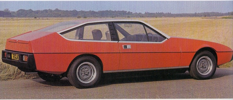

Skizzer Posted November 25, 2017 Posted November 25, 2017 Cracking job there Trigster, you have definitely become the master at this stuff. Wheels: how about just painting them grey and putting some shiny trim rings on? The early base model Lotus Eclat had those and they look great: (Don’t think anyone actually bought a base model Eclat, mind. If BorniteIdentity ever has a midlife crisis...) eddyramrod, RobT, Asimo and 6 others 9
