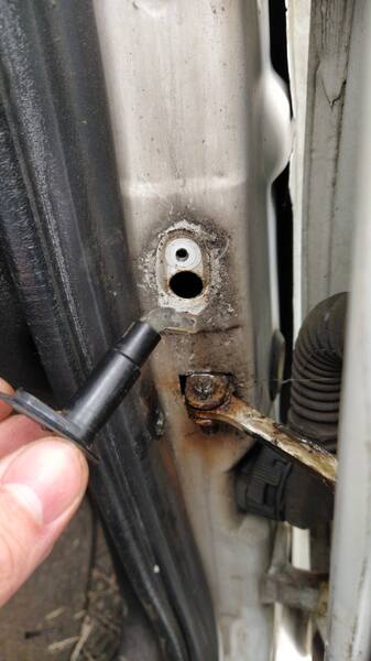

loserone Posted April 30, 2020 Author Share Posted April 30, 2020 Moar things arrived Take the knackered door switch out Fuck. How about WIN VID_20200430_132155.mp4 Lacquer Peel, The Moog, RobT and 5 others 8 Link to comment Share on other sites More sharing options...

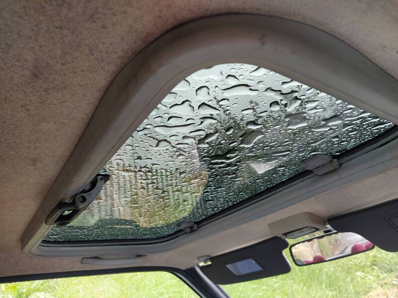

loserone Posted May 8, 2020 Author Share Posted May 8, 2020 On 4/30/2020 at 1:46 PM, loserone said: New* sunroof Where was I? Oh aye, I had been delivered a sunroof. This came with the car, so I thought it should be a nice straightforward swap to get rid of this silkaflex monstrosity So I opened up the package containing the sunroof. Looks like it's been literally cut out of the roof of the donor car Still, that's not such a worry. This is, though. Grey outer is the trim on the inside of the 205. The black and alu is the spare. This isn't going to work. Just to check, I ask if anyone recognises the sunroof or the roof on the 205 owners group on Facebook. FOAD pipes up: Great. Now what? Link to comment Share on other sites More sharing options...

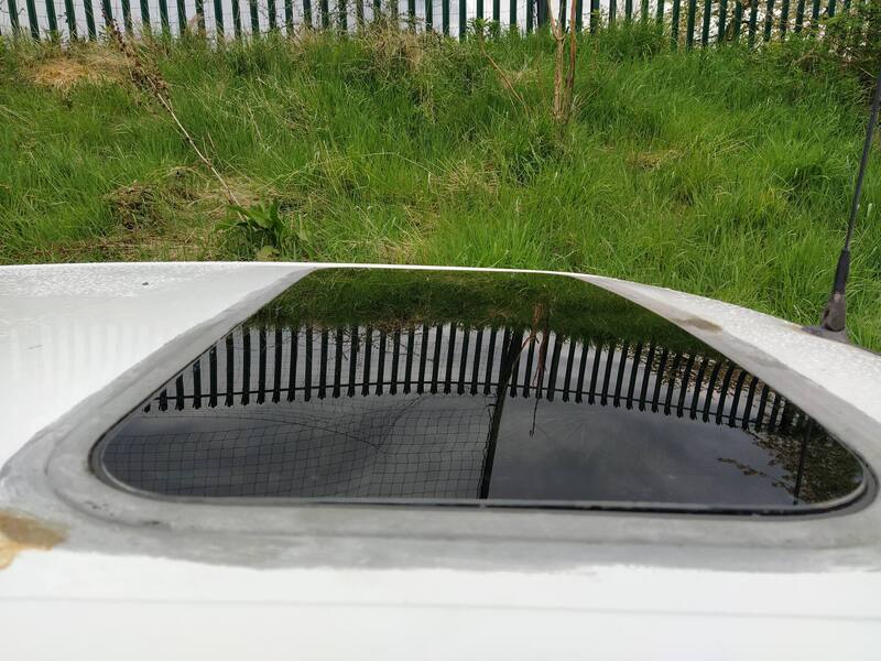

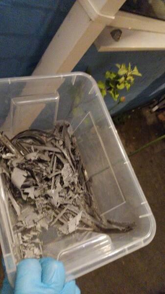

loserone Posted May 8, 2020 Author Share Posted May 8, 2020 First, pop the clag make a hole start scraping This is where the glass seals against the rubber seal. Can't see that doing much of a good job. Pull some shit out of the seal And then remove the silicon sealant, too. Better. The seal looks to be in really good nick. This is why it's not sealing. Sealant. Functionally done. Yuk. This isn't a car to be sorted cosmetically, so that's how it's staying. There is a bit of a leak into the car in bad rain; it comes in under the passenger side dashboard and runs down the rubber floor mats. I'll start digging into this next. Maybe. If whoever put this clag in here would like to own up, I'd like to post it back to them, wrapped in some argos catalogues. Lacquer Peel, paulplom, chaseracer and 2 others 2 3 Link to comment Share on other sites More sharing options...
Andyrew Posted May 8, 2020 Share Posted May 8, 2020 Does the sunroof leak now? Most of the time these can be salvaged by giving the rubber a good scrub and then a nice smear of silicone grease. If the rubbers gone too flat a bit of electrical cable can be tucked under the wire to plump up the seal a bit. Bending the little tabs that are the front hinges down helps aswell. Matty, loserone and spartacus 3 Link to comment Share on other sites More sharing options...
loserone Posted May 8, 2020 Author Share Posted May 8, 2020 I can't test it because it's dark, but I see no reason why it would. The seal is good all the way around Link to comment Share on other sites More sharing options...

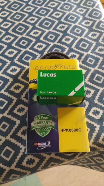

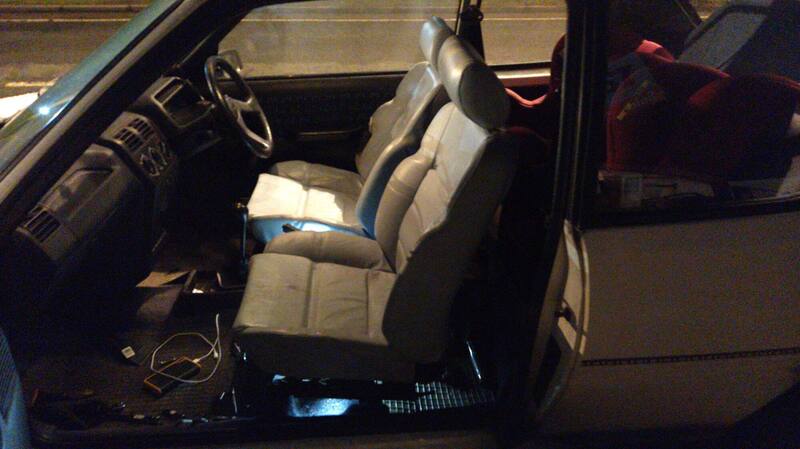

loserone Posted May 9, 2020 Author Share Posted May 9, 2020 Not leaking. Cleaner Dirtier Hoovered, wiped down, mats cleaned. Vactan primered. Aux belt tightened, no longer slipping. Could have done with an excuse to drive it today. paulplom, Lacquer Peel, The Moog and 2 others 5 Link to comment Share on other sites More sharing options...

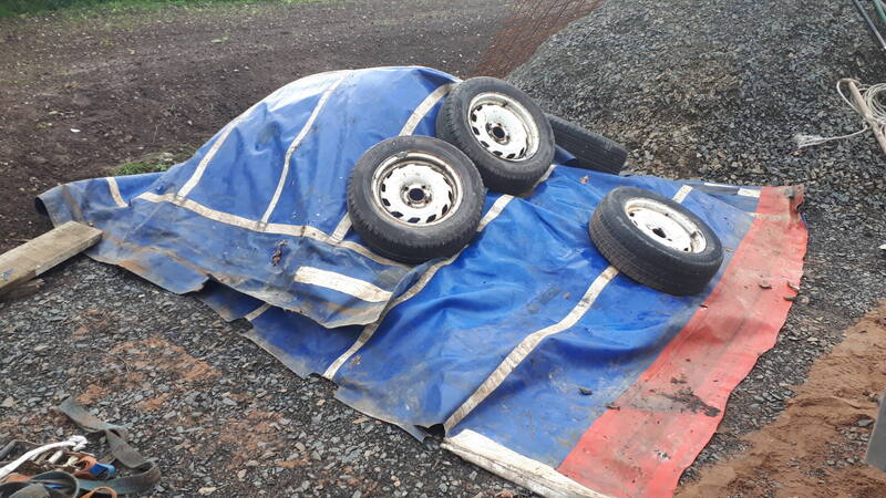

loserone Posted May 12, 2020 Author Share Posted May 12, 2020 Went for a walk Got back and couldn't get this one out of the car Visited a @gm Filled the boot 320touring, paulplom, Tickman and 3 others 6 Link to comment Share on other sites More sharing options...
Lacquer Peel Posted May 12, 2020 Share Posted May 12, 2020 Those wheels have done a fair bit of travelling. Link to comment Share on other sites More sharing options...
loserone Posted May 12, 2020 Author Share Posted May 12, 2020 Have they? Link to comment Share on other sites More sharing options...
Lacquer Peel Posted May 12, 2020 Share Posted May 12, 2020 Yes, from alcyonecorporation in the Fens, to FOAD's unit, to me in the Highlands, to garbaldy, to gm and then you. Link to comment Share on other sites More sharing options...

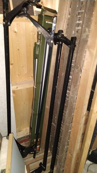

loserone Posted May 12, 2020 Author Share Posted May 12, 2020 Oh! Who do I blame for the shit tyres? Still haven't looked at them, but I have been collecting shit Roof bars And Stale fuel. Bonza. Link to comment Share on other sites More sharing options...
garbaldy Posted May 12, 2020 Share Posted May 12, 2020 47 minutes ago, Lacquer Peel said: Yes, from alcyonecorporation in the Fens, to FOAD's unit, to me in the Highlands, to garbaldy, to gm and then you. And all that mileage covered with absolutely no tyre wear at all. ? DSdriver and Lacquer Peel 2 Link to comment Share on other sites More sharing options...
DSdriver Posted May 12, 2020 Share Posted May 12, 2020 Excellent job with the sunroof. Some of my customers put the silicone mastic on the inside for reasons I fail to comprehend. Some sort of perverse logic about that's where the rain comes in I suppose. Link to comment Share on other sites More sharing options...

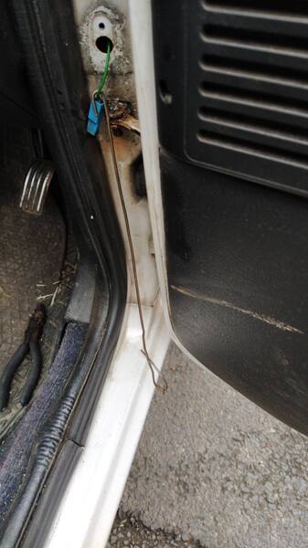

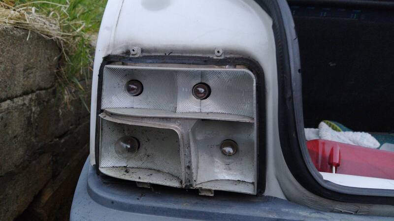

loserone Posted May 18, 2020 Author Share Posted May 18, 2020 Completely unnecessary update No rear position marker lights on one side. Some fiddling revealed this was because it has two blown bulbs. However, also no brake lights. These bulbs worked fine, so a quick test revealed Bypassing the switch makes them illuminate It's not stuck VID-20200518-WA0041.mp4 Deploying litter picker Spray some contact cleaner and work the switch a bit and I've ordered some more bulbs. BorniteIdentity, BL Bloke, Tickman and 3 others 6 Link to comment Share on other sites More sharing options...
