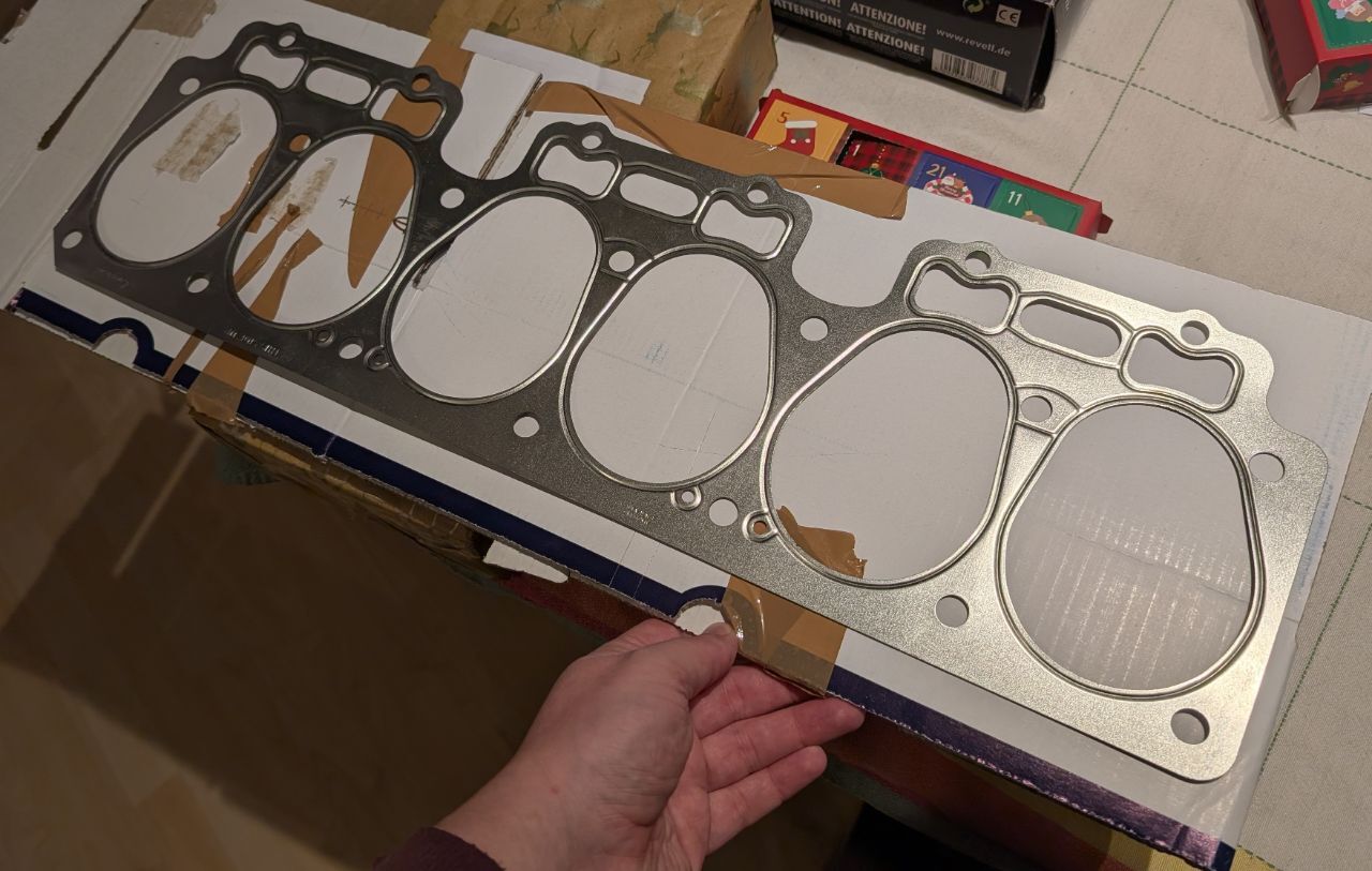

New gaskets have arrived now.
It's immediately obvious that they weigh about twice as much as the modern ones.  The quality of the stamping and the surface finish is far better as well.

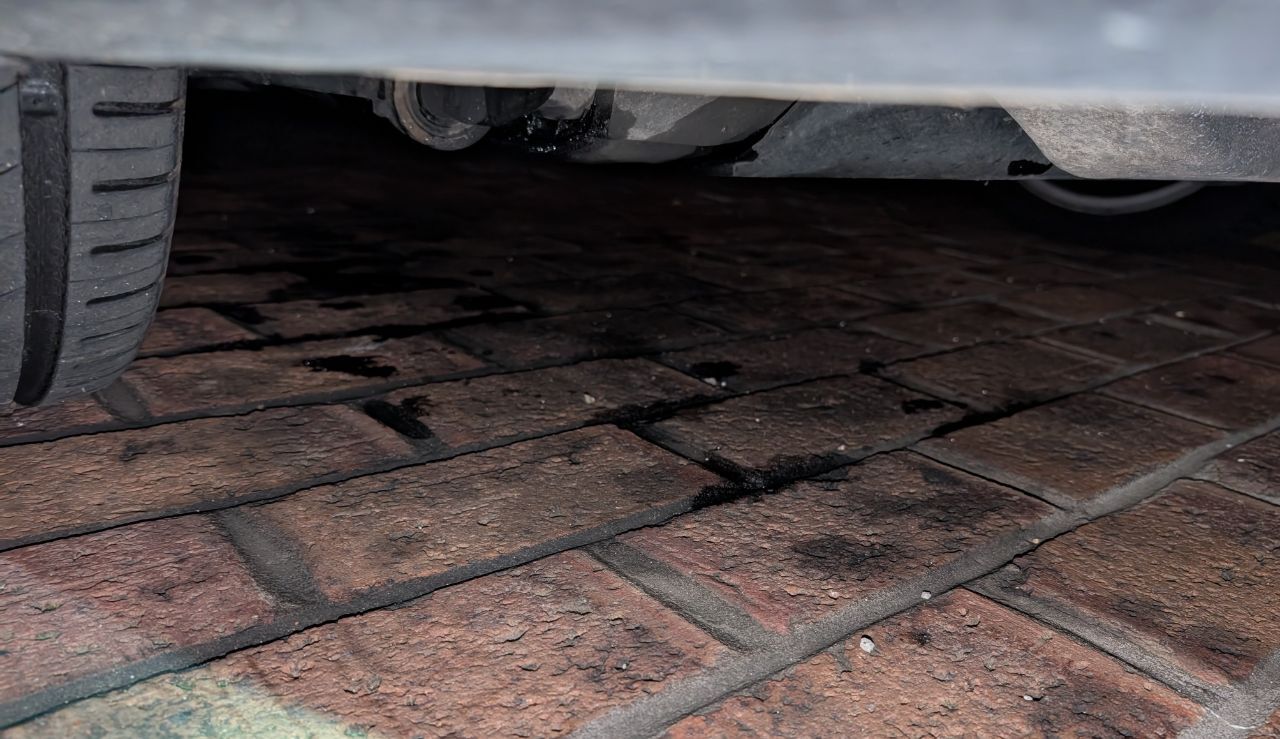

The Volvo has developed an oil leak.  It's not massive, but it is leaving a few drips where I park.  No idea where it's from as the underside is completely covered by the under tray and that's where the oil is dripping off.
Unless it's something *very* simple I won't be dealing with this.  It'll be a garage job as this car is too modern, too complicated and is well outside my comfort zone.

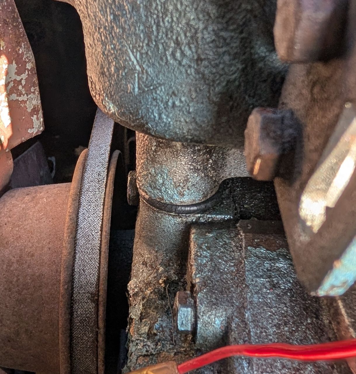

Not amused to see the state of this O-ring, which has been in place for like a month.
Okay, going to take the measurements from that and try to source a better quality, Viton one sourced.  Probably pay a visit to Pirtek and their petty cash tin for that.  This would be annoying in any setting, but for something that the head has to come off to change it's absolutely intolerable.
An hour later, head is off.
I'll get the inlet manifold separated (again), then it will be off to Headline MK to be checked out and if necessary have any repairs done.  Then it will simply be a matter of putting it back together (again), this time with the gasket the right bloody way up.  Then can start concentrating on some of the other major issues that need attending to.  Like the brake pedal that bites an inch from the floor and woefully wayward steering.
