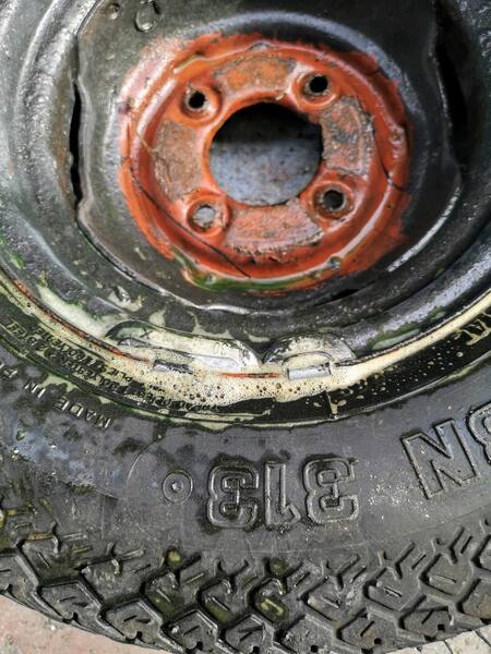

dozeydustman Posted August 28, 2019 Share Posted August 28, 2019 I think a light abrasive such as a scotch pad would do it without causing damage to the tyre. Could also try acetone nail polish remover - it's rubber safe. Even removing the wheels from TPA and giving them a good jet wash may remove the bulk of it. Link to comment Share on other sites More sharing options...
Noel Tidybeard Posted August 28, 2019 Share Posted August 28, 2019 8 minutes ago, RayMK said: If the paint on the tyres won't come off with reasonable abrasion, why not lightly spray them white for that stateside yo!? fify GrumpiusMaximus 1 Link to comment Share on other sites More sharing options...

Andyrew Posted August 30, 2019 Share Posted August 30, 2019 Regarding overspray. A stiff brush and scrub may take some off but I think there's just too much on there. A quick fix is black tyre paint Or just get the tyres popped off and rotated round Link to comment Share on other sites More sharing options...

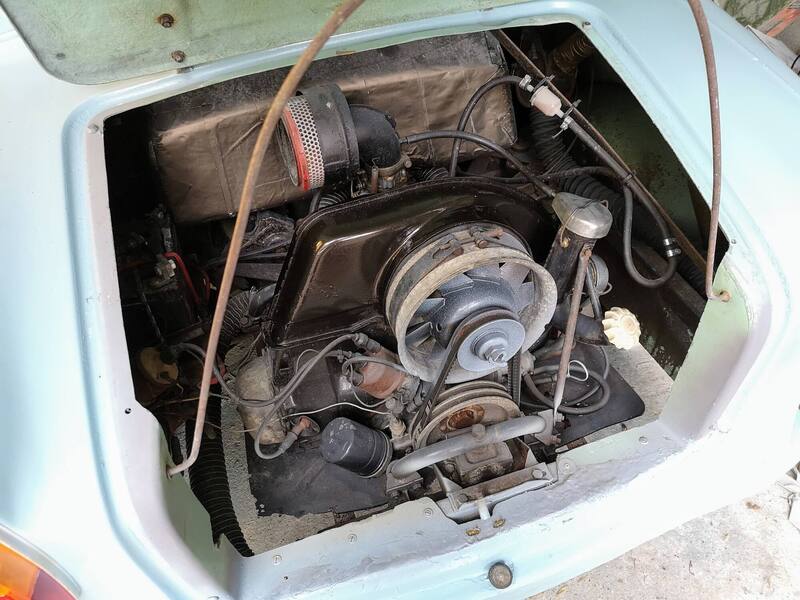

Zelandeth Posted August 30, 2019 Author Share Posted August 30, 2019 Speaking of paint overspray... Really should have masked off the engine bay or waited until after painting the car to do things like the fan or cooling fan shroud... Oops. At least there's not much work to be replicated. Top cowling has already been painted (again). Was out and about running more errands today and it would have been rude to take anything else wouldn't it Plus meant I was able to get a photo of TPA in slightly more period looking surroundings. Wouldn't take a huge amount of photo manipulation to turn the clock back 30 years here. Starting to actually get a better feel for the car now and can definitely vouch for it being at home darting around congested city streets, even though the initial launch is a little slower than most modern cars (actually very much like an old school automatic like my Saab which has a very long first gear) so requires you to plan just a little further ahead than in some cars if joining a busy roundabout or turning right out of junctions. Granted, being tiny does help there too so it's a bit of a swings and roundabouts situation. Have been a little more daring today, and can definitely vouch for this car having far more tenacious levels of grip than you'd thing when cornering. 500tops, RayMK, LightBulbFun and 4 others 7 Link to comment Share on other sites More sharing options...

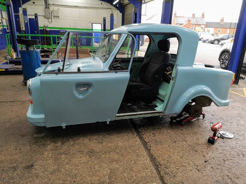

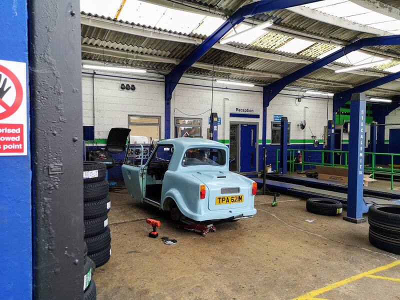

Zelandeth Posted September 2, 2019 Author Share Posted September 2, 2019 Had a spare hour this afternoon so figured it would be a good time to start tackling the snagging list on the Invacar. The repainted engine cowl was reunited with the engine. Being such a visible thing in the engine bay this immediately makes it look far less decrepit. I then turned my attention to the slow puncture on the nearside rear wheel. This has lost roughly 5psi per day ever since the tyres were fitted. As such my suspicion was always that there was a leak from the rim rather than in the tyre itself. Five minutes with the leak detector spray later, we have a winner. Bubbling merrily from the bead right behind the larger balance weight. There's another smaller leak I spotted just after taking this photo just out of frame. I've faffed around fitting tyres at home before and have deemed it to be considerably more trouble than it's worth (until such time as I inevitably pick up a tyre fitting machine) so decided to entrust sorting this to Formula 1 over in Newport Pagnell. My usual go-to for tyre stuff, only reason they didn't get the job of fitting these originally was that they literally wanted double the price for what were inferior tyres. Suffice to say this being in the workshop caused a few scratched heads. The gent who was working on the car for me couldn't have been more than 18 and was really enthusiastic which was nice to see. Once the tyre was off it was obvious that no effort had been made to clean the rim up beforehand...bit disappointing given the tyres were fitted by a specialist not Kwik-Fit. Five minutes with the wire wheel had things looking far healthier, and we flipped the tyre around (they're not sided) to hide my horrible overspray. Was all going great...right up until this happened. Gent doing the work was being careful and was doing everything by hand - that stud just decided it had had enough. They're happy to cover the cost of sourcing replacement and fitting no questions asked. So I'll have a dig later today (I still have the parts manual here waiting to be scanned because I'm bloody disorganised) to ascertain exactly what spec the studs are and will then get replacements ordered. Hopefully they're straight from the Mini as those will be plentifully and inexpensively available. I'll plan on replacing all of them as a matter of course now. If one has failed without being abused in my time with the car there's no reason to believe the rest are in any better shape. I had one fail on a car before (can't recall which one) and the very next time I had the wheel off I recall a second stud snapping...so they're all getting done. Once they're done they're done...one less thing to worry about. Just hope access isn't an issue... egg and Mrs6C 1 1 Link to comment Share on other sites More sharing options...
LightBulbFun Posted September 2, 2019 Share Posted September 2, 2019 love the shots of TPA in the workshop/garage it looks so "silly", shame there not some fancy modern or something in the next bay over as for the studs, looks like they might be mini items indeed as seen here I think https://autoshite.com/topic/33844-autoshites-official-for-salewanted-thread/page/86/?tab=comments#comment-1760174 (although the poster just says "studs for mini wheels" so the other end of the stud that doesn't go into the wheel might be different? ) I was wondering about the parts manual myself glad to hear that's not been forgotten (Im quite eager to have a read of that, I didn't even know the AC Acedes Mk14A was a thing until I saw it in the list of Invalid vehicles it covers, I knew of the Mk14 and Mk15 but not of the Mk14A) Link to comment Share on other sites More sharing options...
