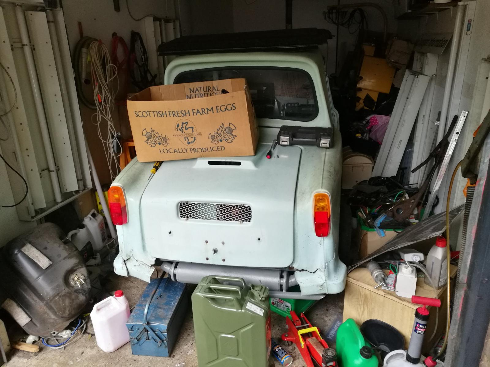

Zelandeth Posted April 28, 2018 Author Share Posted April 28, 2018 Figured that I really ought to leave these videos here for you guys from when I was doing the drive system tests on the Invacar... Firstly a general view looking forwards - not quite capturing the earth-shattering noise levels in the garage though! Secondly with the cover removed and looking at the belts as the movable cones do their CVT dance... Sorry I totally forgot to upload these at the time! AdgeCutler, Mrs6C, Lacquer Peel and 2 others 5 Link to comment Share on other sites More sharing options...
dollywobbler Posted April 28, 2018 Share Posted April 28, 2018 Gosh your engine (probably exhaust related) sounds much smoother and quieter! LightBulbFun 1 Link to comment Share on other sites More sharing options...
Zelandeth Posted April 28, 2018 Author Share Posted April 28, 2018 Gosh your engine (probably exhaust related) sounds much smoother and quieter!I have noted that this appears to be a different exhaust to the one you have (there's no turn at the tip), not sure whether this belies any internal difference in construction that might have an effect on noise levels. It does sound astonishingly happy mechanically speaking, and I have managed to lose a good few bits of time just listening to the thing burbling away at idle. Fair to say it sounds better than it looks! LightBulbFun, dollywobbler and egg 3 Link to comment Share on other sites More sharing options...
dollywobbler Posted April 28, 2018 Share Posted April 28, 2018 I can do that now! After clearing out the carb and turning the idle up a bit, it will actually smoothly idle for as long as I want it to. This is some novelty. LightBulbFun 1 Link to comment Share on other sites More sharing options...
Zelandeth Posted April 29, 2018 Author Share Posted April 29, 2018 I have to admit to having been astonished how much better my one ran once I turned the idle speed up a little bit as well. As mentioned, the exhaust on mine looks very slightly different to the one on DW's Invacar. Not sure whether this is purely external, or if the internal structure may be slightly different too. She's got a bit buried this week with me concentrating on sorting the Lada out! Hopefully normal service will be resumed soon there. Today however I mostly got the Lada finished off. Crawled around underneath and removed the wiring to my old fuel pump and rerouted it into the back of the cabin. Then spent a while playing detective while working out which terminal was what on the fuel pump/gauge plug. I'd failed to notice that this being a later part has a different socket to the Niva one I was used to. At this point my fancy digital multimeter decided to for reasons unknown, turn itself into a doorstop. This was unhelpful, especially as I couldn't find any of the dozen or so "cheap 'n' Nasty TM" yellow ones that I know are scattered around the house for moments such as this. So wound up hauling the old AVO 8 down to the driveway. I seem to keep ending up using this thing working on the cars... Everything connected up, and it seems to work. Oh...my...word...it is so quiet compared to the old one, which used to whine away in a really annoying way. No evidence of any fuel leaks, and the car seem to be running smoother. Hard to say if that's because the fuel pressure delivered is now what it's expecting, or if it's because I've poked and prodded a few things in the engine bay and sorted a couple of potential vacuum leaks (which are the bane of this injection setup, even the smallest of leaks can cause it to throw a major tantrum). Not really going to know for certain until we get it on the exhaust gas analyser, but fingers crossed it's running properly in closed loop mode and such. It seems to smell right at least. Just need to get a couple of last hoses changed in the engine bay (more in the interests of tidiness than anything), and try to sort out a better bracket arrangement for the throttle linkage to cable joint (cable ties are currently a critical component), then I'll call that side of things done for now I think. Hopefully get it booked in for an MOT in the next week or so... vulgalour, LightBulbFun, egg and 1 other 4 Link to comment Share on other sites More sharing options...
