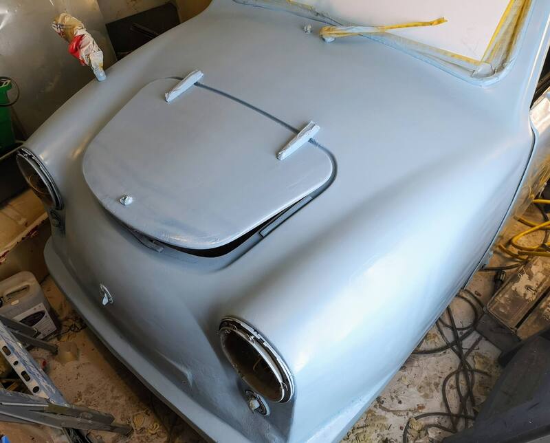

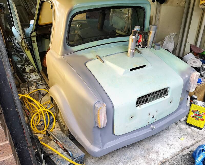

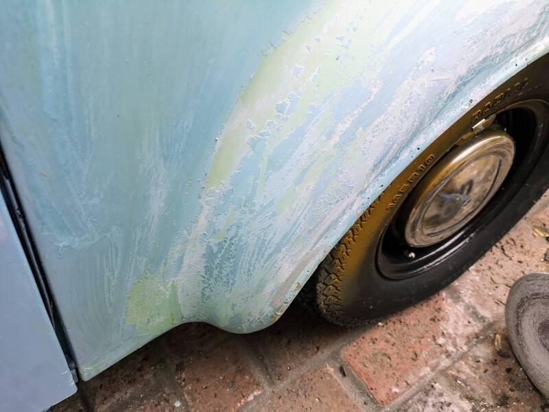

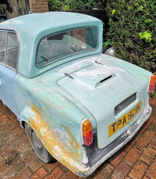

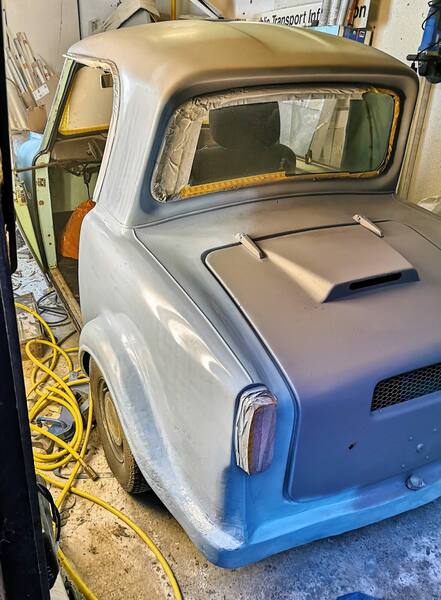

Zelandeth Posted July 17, 2019 Author Share Posted July 17, 2019 (edited) Have made an executive decision regarding the paintwork on TPA. Simply that I've had enough faffing about. I'm getting things into a vaguely flat state then throwing paint on it. I could spend weeks (or months) trying to get a mirror smooth surface, but I think that's a task for another time. The most important thing I need to do with the car at this point in time is simple: Drive it! Okay...step one. Remove all the residue from the soda blasting experiment. Just a bit left to deal with... Gave the van a quick wash too while I had the hose out as it was getting difficult to see through the windscreen again. The joys of brick wall aerodynamics. Have had another shot at clearing the fuel tank breather, I've tried several times so far but it's only in the last few weeks I've had access to compressed air, so could try zapping it with this. Will remain to be seen if it's actually made any difference. Back to the Invacar paintwork. Worst bit of the car was this wheel arch I think. I just went after it with the sander to get it vaguely smoothed out, then set about chucking some primer at things. Followed by some top coat. Still obviously needs a few more coats (and in fact covering the remainder of the car), but I think it will wind up looking better than it started out. Really do need to get hold of a spray gun for the compressor though...this is costing an absolute bloody fortune in rattle cans! Hopefully will get it to a state which would classify as "inoffensive from ten paces" in time for Saturday. Had a brief moment of worry when I was just packing up when I spotted this under the van. Despite the engine being a little oily, she never usually actually leaves anything behind so the leak definitely required investigation. The oily residue I think is mainly leftover from the leaky cam box cover. She doesn't seem to use a drop between services (granted, there are nearly eight litres of oil in there!)...and this didn't look to be oil. First thought was brake or clutch fluid...however there was no visible source in the engine bay, and hydraulic fluid was still sitting happily on the max mark. Eventually I tracked down the source - that vertical tube to the left of the alternator. Looks to be a drain from the heater intake box, so just a bit of water draining off from the earlier wash... nothing to worry about thankfully. Edited July 17, 2019 by Zelandeth Correcting autocorrect RayMK, egg, LightBulbFun and 3 others 6 Link to comment Share on other sites More sharing options...
plasticvandan Posted July 18, 2019 Share Posted July 18, 2019 aside from the madness of using expensive halfrauds aerosols.... get some high build primer,i guarantee that that piss thin grey halfords stuff will end up making the car look worse than it did before.If you can get a nice thick layer of primer on,you can then sand that down a bit and get a smooth base. Link to comment Share on other sites More sharing options...
Zelandeth Posted July 18, 2019 Author Share Posted July 18, 2019 I'm going to have to resort to the internet to source things in that case. There's only one other motor factor than Halfords in my immediate area I'm hazard of which carries a reasonable selection of paints, and they're even more expensive. It was their high build primer which resulted in me trying to strip a lot of the old paint off as it reacted with the original paint on the vehicle and dried all crinkly. I'd probably have taken a different route from square one if I'd correctly guessed how much paint I'd need - obviously I underestimated by a couple of orders of magnitude! Not sure if the cans have shrunk or it just doesn't cover as well as when I last really used them to cover any large area. Link to comment Share on other sites More sharing options...
Zelandeth Posted July 18, 2019 Author Share Posted July 18, 2019 Spray gun has now been sourced. Had it in my head that the entry level was way more expensive. I've been pointed to a local paint specialist as well so I'll drop by there tomorrow and see what they say. Hopefully they should be able to get me set up with some *decent* high build primer and a good chunk of paint. Tomorrow I absolutely need to throw the lights, number plates back on and remove the masking from the windows and go for a drive. She needs to drive 15 miles to and from FotU on Saturday, and has barely turned a wheel in the last month! So I reckon I need to do a thorough test tomorrow to make sure she's fit to make the journey. The new pulleys have only been round the block a couple of times so far...and they're kinda critical components! BlankFrank and egg 2 Link to comment Share on other sites More sharing options...
Mrs6C Posted July 18, 2019 Share Posted July 18, 2019 8 hours ago, Zelandeth said: I'm going to have to resort to the internet to source things in that case. There's only one other motor factor than Halfords in my immediate area I'm hazard of which carries a reasonable selection of paints, and they're even more expensive. It was their high build primer which resulted in me trying to strip a lot of the old paint off as it reacted with the original paint on the vehicle and dried all crinkly. I'd probably have taken a different route from square one if I'd correctly guessed how much paint I'd need - obviously I underestimated by a couple of orders of magnitude! Not sure if the cans have shrunk or it just doesn't cover as well as when I last really used them to cover any large area. If you aren't fixed on the cellulose route, you could do worse than use household exterior primer (around £11 for 2.5 litres from Wilko, comes in grey and white and is good stuff) and then top coat it with a decent brush and household exterior gloss (B&Q colour match). Not sure that Rylard boat paint (£18.95 from Willowbrideg Marina) comes in teh right colour blue, but that's good, tough gloss paint for outdoor surfaces. My GRP boat is being painted with WIlko primer and Rylard top coat; both are kind to fibreglass. Link to comment Share on other sites More sharing options...
Mrs6C Posted July 18, 2019 Share Posted July 18, 2019 4 minutes ago, Zelandeth said: Tomorrow I absolutely need to throw the lights, number plates back on and remove the masking from the windows and go for a drive. She needs to drive 15 miles to and from FotU on Saturday, and has barely turned a wheel in the last month! So I reckon I need to do a thorough test tomorrow to make sure she's fit to make the journey. The new pulleys have only been round the block a couple of times so far...and they're kinda critical components! You could take the back lanes if you want to avoid the main road... Link to comment Share on other sites More sharing options...
Zelandeth Posted July 18, 2019 Author Share Posted July 18, 2019 8 minutes ago, Mrs6C said: If you aren't fixed on the cellulose route, you could do worse than use household exterior primer (around £11 for 2.5 litres from Wilko, comes in grey and white and is good stuff) and then top coat it with a decent brush and household exterior gloss (B&Q colour match). Not sure that Rylard boat paint (£18.95 from Willowbrideg Marina) comes in teh right colour blue, but that's good, tough gloss paint for outdoor surfaces. My GRP boat is being painted with WIlko primer and Rylard top coat; both are kind to fibreglass. The thought of household primer hadn't even really occurred to me to be honest... Definitely worth a think about. Something brushable would be particularly useful for some of the really rough areas. Don't imagine there's any reason you couldn't spray with household gloss, though you'd probably have to let it down a bit to get it thin enough. It's cheap enough that it seems worth a shot...even if it all flakes off after a week it's not a huge gamble really. Link to comment Share on other sites More sharing options...

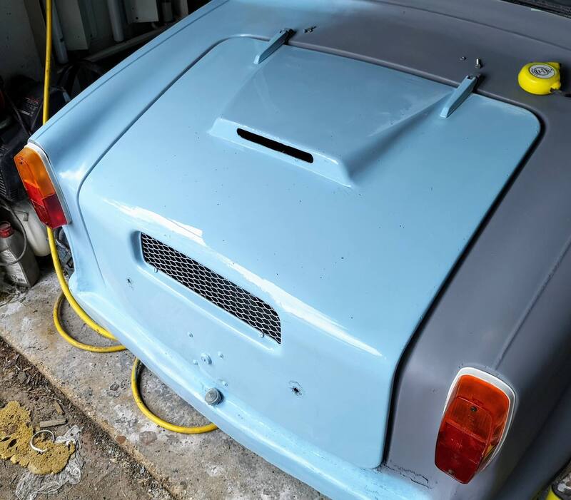

Zelandeth Posted July 19, 2019 Author Share Posted July 19, 2019 Spray gun: Acquired. Colour Matched Paint: Acquired. Time to even open the garage door so far today: Nope! Link to comment Share on other sites More sharing options...
LightBulbFun Posted July 19, 2019 Share Posted July 19, 2019 how does the paint look at least? (did you also get that primer you wanted?) Link to comment Share on other sites More sharing options...

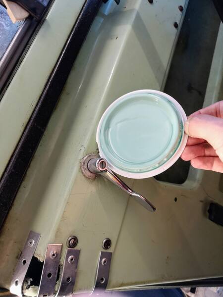

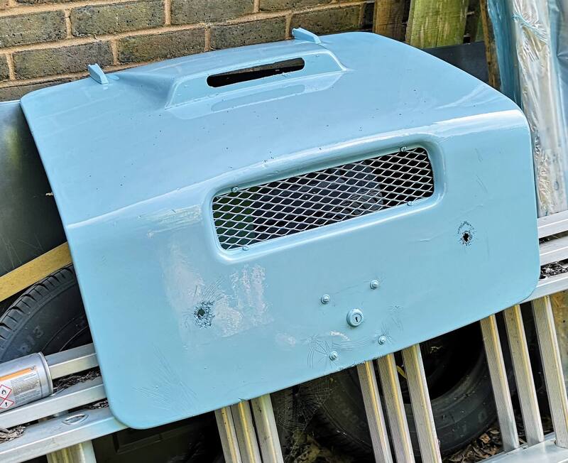

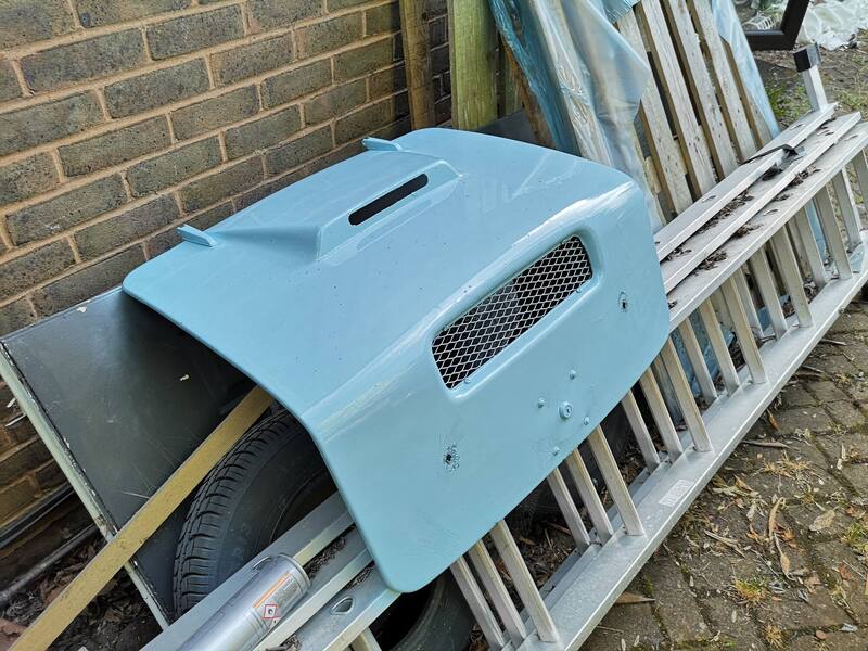

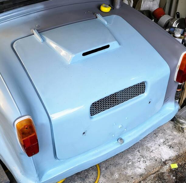

Zelandeth Posted July 19, 2019 Author Share Posted July 19, 2019 So I'd really hoped that I'd have time to give the Invacar a proper shakedown prior to the trip to FotU tomorrow. However I ended up with next to no time to do anything car related today. However I did pick up some paint. This actually looks a lot closer in person than the camera makes it look. It's also matched to the transmission cover which is slightly lighter than the doors. Couldn't resist splashing a bit onto the car in the interests of curiousity. Does show how far off the mark the blue I'd been using actually was. This was at like 2200 though...so no test drive. Tomorrow morning will be the first real test, heading over to Buckingham. If things go well, you'll see her at the Festival of the Unexceptional. If things don't go well, I'll probably be there with a scruffy Mercedes camper instead. loserone, LightBulbFun, Amishtat and 1 other 4 Link to comment Share on other sites More sharing options...

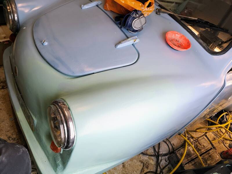

LightBulbFun Posted July 24, 2019 Share Posted July 24, 2019 Like for Model 70 TLC not Like for wrong shade of blue, if you hear my grumbling under my breath next time I see TPA you know why its going to bug the crap out of me like it does with TJN352R LOL perhaps when you take her to get some professional body work done, maybe find a place with a good paint shop and see if they can match/make the original colour a bit better then currently and have that thrown on? (LOL at fluffy little pancake ) Link to comment Share on other sites More sharing options...
Zelandeth Posted July 24, 2019 Author Share Posted July 24, 2019 It's a tricky one...the colour DOES match what was already on the car in several places - including where there was only one layer (door frames immediately spring to mind), so it was definitely used by the manufacturer at some point. Okay, it's very slightly off, but only enough that you'd notice if you had two right next to each other. I'm pretty sure the almost peppermint green colour I had paint matched to (which dried horribly) can't be right...so I do wonder if the blue pigment has faded more quickly through they years, leaving the car looking greener than when it left the factory. Most of the photos in colour seem to show car bluer than the paint I got looks...so I'm not sure what's right! As it is though I like the blue...so I'm sticking with it. At least you shouldn't have as much of that to worry about with REV. LightBulbFun 1 Link to comment Share on other sites More sharing options...
LightBulbFun Posted July 25, 2019 Share Posted July 25, 2019 tricky indeed I think the reason your colour choice makes me grumble so much is because its just that touch too blue without any green to it my baseline for what colour should a Model 70 is, is the colour of GPG721K as GPG721K was withdrawn from Service in 1978 (or well has been untaxed since then) so I doubt has been painted over in 50 shades of blue (and to some degree ATW722L as that one was painted according to the official colour sheet that stuart has) in regards to fading, I find generally its actually the green pigment that fades first leaving the cars looking bluer overtime, hence why the inside is greener than the outside as the inside is less exposed, (the insides also being painted less often I imagine) although not always the green fading first, I noticed for example RRE20L (a private Model 70 last taxed since 1981 so again probably not been painted a million times) is still quite green despite clearly being open to the elements for many years another one of the problems is, it is a turquoise colour, so from one angle/lighting condition it can look quite blue and from one other it can look quite green I will agree that yeah the paint you got from that paint shop was quite poor quality, although closer to what id like to see then the ford stuff, I dont think its meant to be its own 50 shades of turquoise! its exactly what your trying to avoid/fix here I recommend checking out my Surivours list https://autoshite.com/topic/32723-invacar-model-70-acquired-and-general-ramble-thread-index-on-page-1-multi-person-multi-day-multi-invacar-multi-collection-caper/?do=findComment&comment=1753903 it contains 41 different Model 70's all their own shade of turquoise/blue might help you figure something out in the end its of course your car I just wanted to mention it, as seeing a Model 70 painted the wrong shade of blue is one of those things that Irks me and I wanted to get it off my chest LOL and I still look forward to seeing TPA in one uniform shiny coat of paint Link to comment Share on other sites More sharing options...
