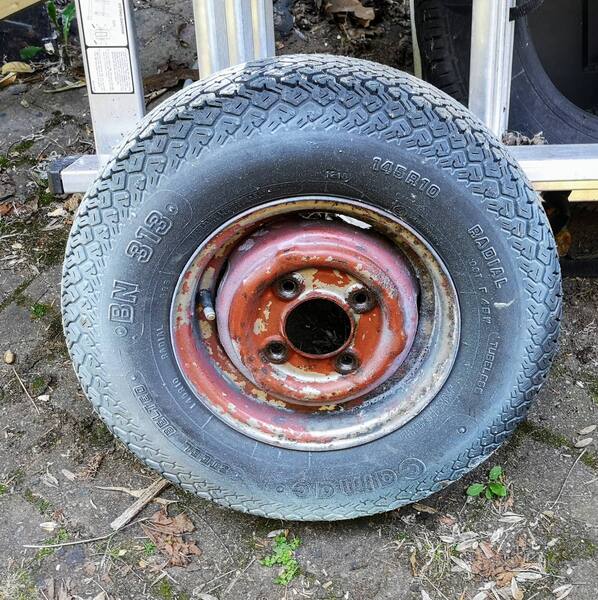

[] Two tyres definitely as they're worn out - ideally a full set of four based on age.  So probably £250 based on a ten second check on Mytyres.

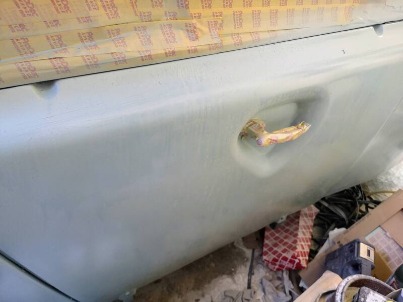

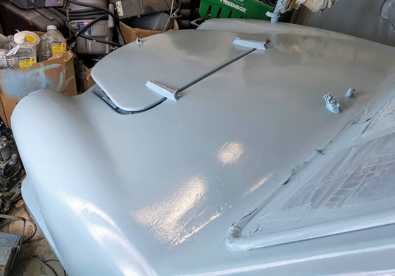

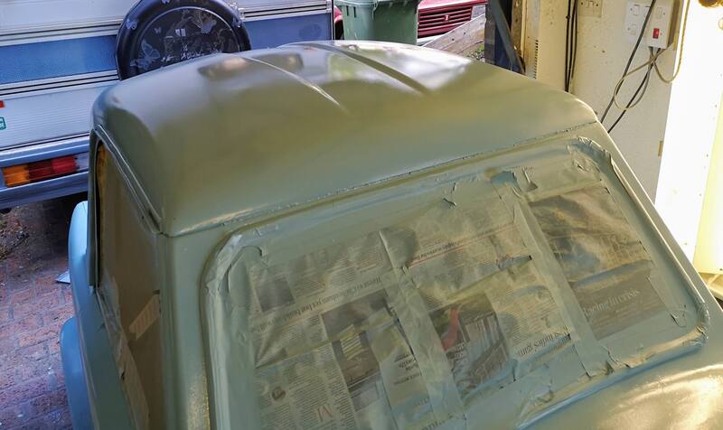

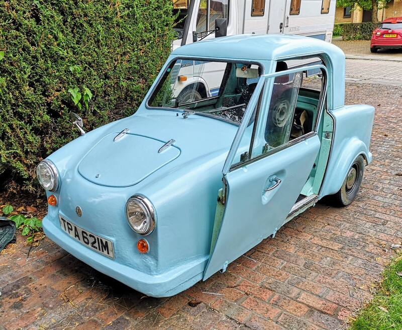

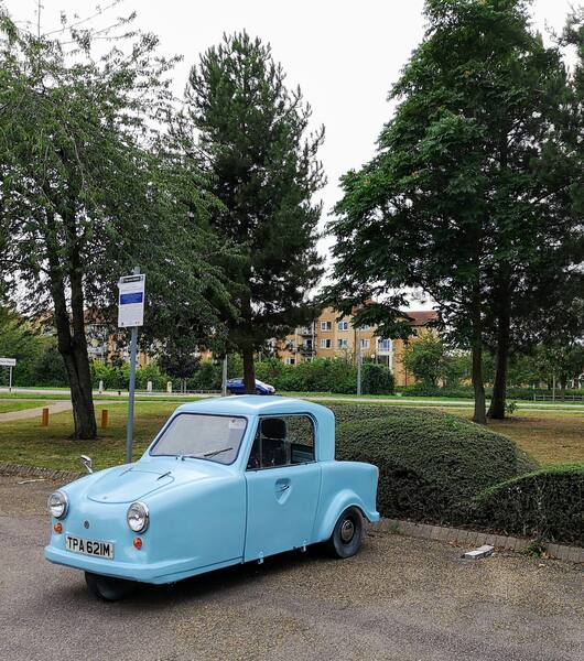

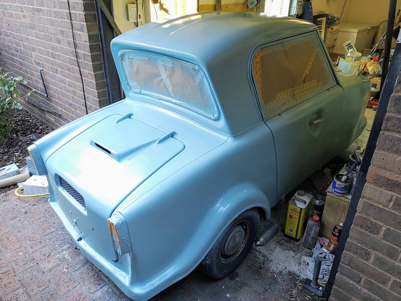

Today was very much a game of two halves.  Also can be read as "discovering the pitfalls you need to watch for when painting."
Picked up the new paint, got the gun ready, loaded up with an actually carefully measured 5:1 mix and did a quick test panel.  All looked good.  Regulator settings still seem well off the mark, but the spray looks good so I'm going with the "if it ain't broke don't fix it" approach there.  Let's not make myself work.
Things were actually going well up until about the 80% mark.  Though dear fluffing hell I need to tidy my garage up.  Trying to move around a car covered in wet paint in there is damned near impossible just now.
At that point something odd happened... suddenly the volume of paint I got out of the gun increased by a factor of about ten it felt like.  It was very visible when that happened from the cloud and the change in sound.
Best guess I have (also pointed to from the visible evidence) is that I'd not done a good enough job of mixing the thinners in and I pulled in a pocket that was very thinners rich.  Sadly this resulted in it looking like I'd dumped a bottle of thinners over the roof and offside door.
Am I disgruntled?  Not really.  It's a learning experience and I'd far rather make these mistakes on a car that's this cosmetically challenged with relatively cheap paint rather than respraying the Xantia or something like that where the final finish is far more critical.
So I'll definitely need to give some areas another coat, but we're looking close to a point where I'm going to feel I can call it good enough for now on some areas now.
Pictures hopefully speak a thousand words...
The target here is to get to a state which you'd not immediately think looked scruffy if you saw me driving past...and it feels like we're starting to get there.

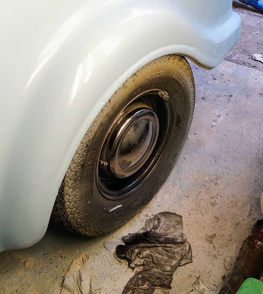

Here's the two shots where there's evidence of my "paint flow anomaly" which I'll need to resolve.
Nothing a quick rub down to smooth out the resulting runs and a recoat can't sort though.  Will have done a decent job of sealing the surface at least.
I don't think I'm being too forward in saying that I think TPA is looking a heck of a lot better than she did a couple of weeks ago.  Just a shame I didn't get this done before the FotU!
I've not bothered masking the indicator surrounds up front as they're badly perished and will be replaced shortly.  Likewise the lock on the engine cover - it's seized beyond all redemption so will be getting changed.
I'll be getting a small brush out and doing a few details by hand.  The edges of the door frames you can't see with the doors closed (I can't be bothered taking the doors off or masking the whole interior off!) for one, and applying some "steel wheel silver" to the engine cover hinges and the air intake grill.  Wheels will be getting hammered metallic black (one is already done) as well.
Then next up will be sorting a few items on the snagging list I think.  High on that list is to get the dash out to sort some wiring "repairs" I've seen which I don't like.  The screw terminal strip which is carrying the full primary circuit current (including battery charge I believe - so theoretically up to 35A) which I really don't like.  The ignition switch gets quite warm too, so I'd really like to get some relays fitted to take the strain off it.
...Or I've been spending too much time working on PSA vehicles with their self destructing ignition switch contacts and it's made me paranoid!
That's obviously the ideal time to get the switch for my heater blower fan wired up as the dash will be out and I'll have the soldering iron and heat shrink out.
Feels like I've made more steps forward today than in a while though.

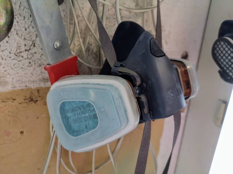

Oh...and yes, I'm very glad I bought the proper mask.
Much prefer that blue paint being in the filters than in me.

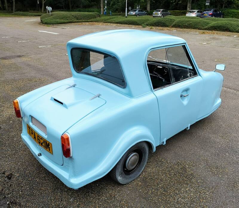

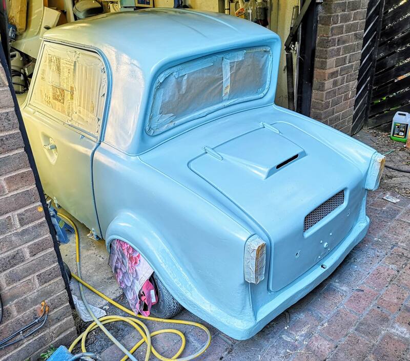

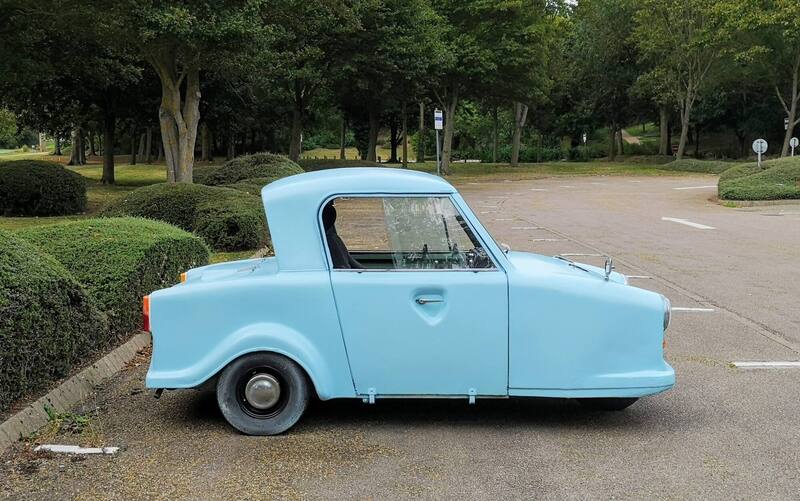

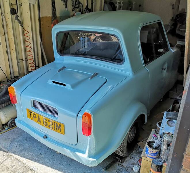

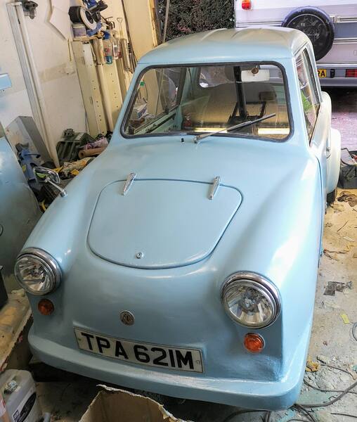

Definitely feel I'm somewhat getting the feel of this now.  Got the spray gun working nicely within a few minutes today, and it behaved perfectly throughout the whole loading of paint.
I think we're pretty much at the stage now where I'm happy to more or less to call the paintwork "good enough for now."
The aim has always been to get the car into a state where it looked like a somewhat scruffy but well loved creaky old classic car rather than something which looked like it had literally just been driven out of a scrap yard.  That's a state which we're getting towards now I think.
The bodywork will be seeing professional attention at some point in the future - but it shouldn't be a barrier to the car actually being used in the real world now.
Here's a bit of before & after fun.
No, it's not fantastic...but it's a means to an end.  I want to use the car...and hopefully this should scream "there's no way this is road legal!" slightly less loudly at any passing traffic police having a bad day that might otherwise see me as a target.
The engine cover and doors might want another coat ideally as they're still a bit patchy.  Realistically I'll get a better finish on the doors if I lay them flat for the last coat anyway.  The rest of it I'm calling done for now - at the very most I might throw one more coat on.
Tomorrow's task will be to pull all the masking tape off and put stuff back together.  The interior is still half full of blasting soda too, so an interior clean will also be on the cards.  Keeping fingers very much crossed that the paint hasn't found its way in through too many gaps as I'd rather not have to go over everything with the thinners!  I did throw a sheet over the seat at least though...so hopefully that will still be black.

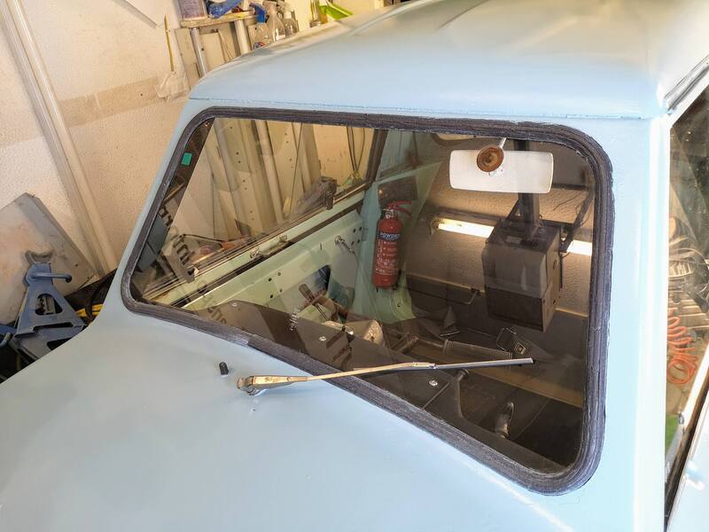

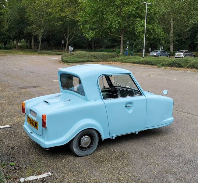

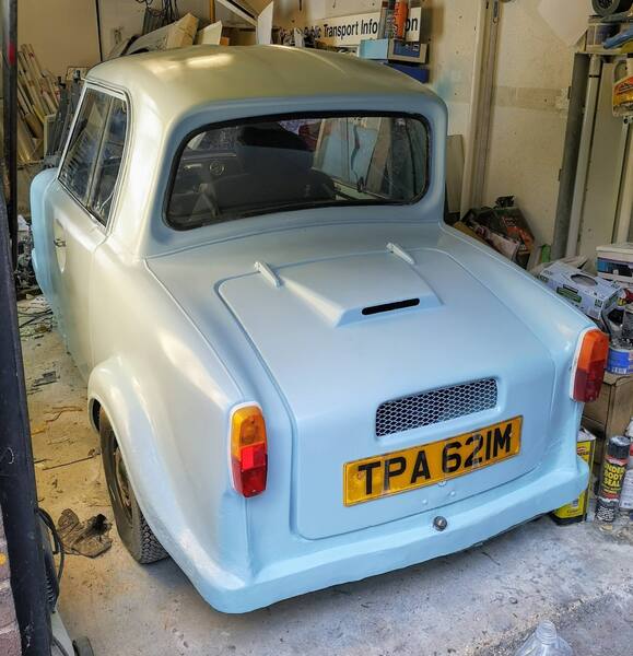

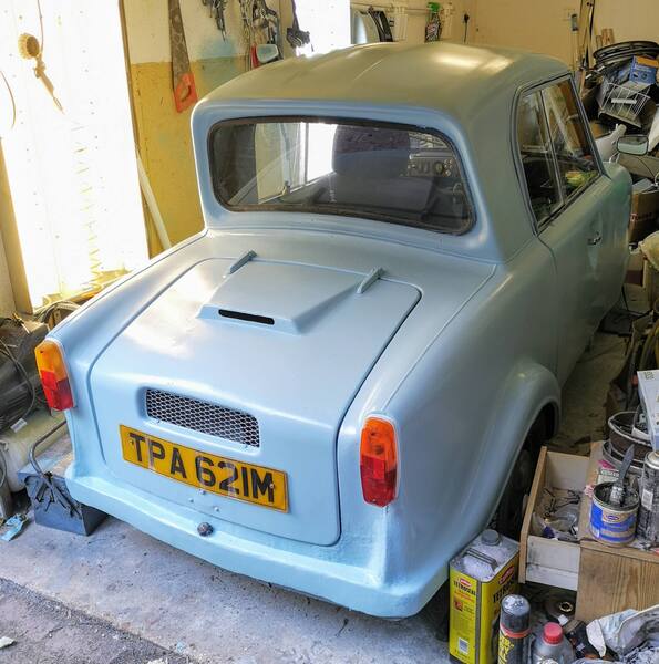

Starting to look a bit more like a car again.
Got a bit of overspray to remove from the rear tyres.  I did initially mask these off, but having to move the car back and forth during painting made that awkward.
The little "nick" by the offside tail light (bit of masking tape had peeled away creating a paint shadow) has been touched in by hand now.
Annoyingly, when I spilled a bit of paint (actually the jar of thinners I'd been using to clean the spray gun) early on in the process I managed to spill that *in* to the offside headlight.  So that will need to be changed at some point...as I don't rate my chances of getting a paint run off the reflector without wrecking the silvering.  On the plus side, the lights were dirt cheap.

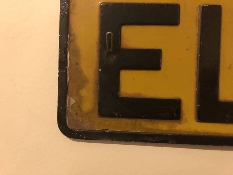

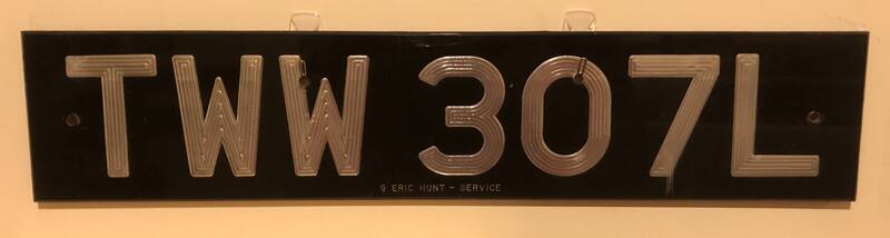

Wouldn't surprise me at all if these are the original plates.  They're matched to each other and are extremely weathered...hence now being transparent.
I'm not kidding...they are honestly transparent!
Don't think I've seen a plate do this before.
The front one I've sprayed the back of with white paint so the blue doesn't show through so much.  The rear has delaminated enough though I dare not do that.  They're really fit for nothing but scrap though (well no... they'll go on the wall in the garage obviously).
Given the fact that acrylic plates are so much cheaper I imagine they would have made use of them whenever stock allowed.  As AC were producing things other than the Model 70 it wouldn't surprise me if they switched over while Invacar might have continued using up their existing stock of older style plates for longer.
Will probably just go with another generic plate as was originally fitted, though I would by lying if I said the pressed ally style like REV has didn't have some appeal too.  They're fluffing expensive though as I recall.
Either way I'll need to order them in as that's the only option for getting the correct typeface...and I'll be damned if I'm putting post-2001 typeface plates on!

Acrylic number plates first came in the late 60s in the form of etched letters on a black background with an aluminium backing (pictured below)
Moving into the mid 70s, the decal letter plates start appearing, but these had sharp corners (as with the above picture) and sometimes an aluminium backing depending on manufacturer (Cpt.70s Acclaim is a good example of this). These plates are made of a rigid acrylic.
The 80s brings on the rounded corners and more flexible acrylic. This leads me to believe that TPA’s plates are probably from the 80s or 90s. Judging by the LBF Model 70 pictorial archive, the originals were probably of the pressed variety which have a habit of loosing the reflective coating with age (pictured below) which is potentially the reason they were replaced.
This could also be complete bollocks and they are original, what does the text on the bottom of the plates say? There could be a clue there.

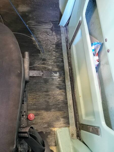

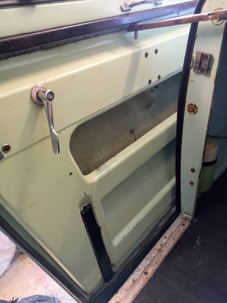

With the paint stripping, sanding, soda blasting and painting that has been going on over the last couple of months, TPA's interior was in a right royal state.
Now I'm not always that fussy about the state of the outside of a car, but a grubby interior will drive me spare in no time flat.
I'm honestly embarrassed to have had to display the car at the Festival of the Unexceptional with the interior in this state, but I just didn't have time to deal with it before that event.
We've some time now though, so let's sort it out.
You think rubber floor mats, you think "easy to clean."
Like hell they are...the ribbed texture does a fantastic job of capturing every bit of grime and even with a brush attachment on the vacuum cleaner (I know we have one collector of vacuum cleaners on here...so for them, it's a horribly abused early 90s Goblin Rio 1200...which despite having been to hell and back still works immeasurably better than the new fangled nonsense in the house) it takes ridiculous amounts of scrubbing to get clean.
I've not discounted the idea of carpeting the floor in future.  Nothing showy, would just be a dark neutral coloured cord carpet, same as I'll probably line the roof and transmission cover with to cut down on noise.  Now we've got several of these cars, mostly in better shape that mine, among us I'm a bit less reticent to make small improvements like that.  Especially keeping in mind a possible long trip next year.

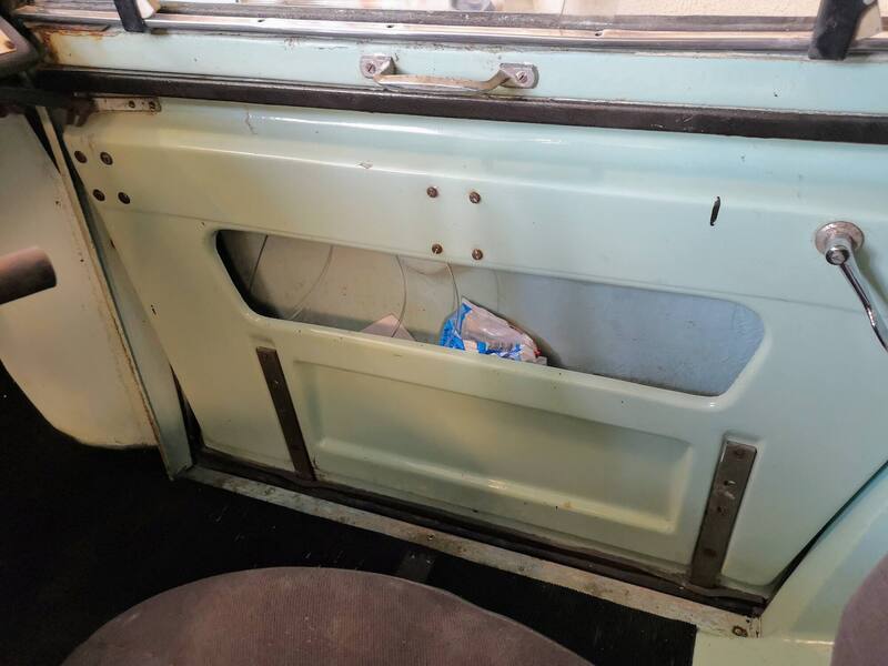

After a couple of hours scrubbing the interior was looking a little more presentable.
I don't think the doors had ever had a proper scrub down of the inside surfaces judging from how grubby they were.  Not sure how that managed to dodge my initial cleaning!
Better now.
The area inside the "door pocket" is another area which might get the carpet treatment in the future - not least to reduce the tendency for me to find up with glass fibres embedded in my knuckles when putting stuff in there.  Any reduction in drumming would be a coincidental bonus.
I really wish I had a wet and dry vacuum cleaner as the driver's seat could really do with the attention of one.  Though given how warm it's forecast to be over the next week I'm considering just taking it out and hitting it with the pressure washer and leaving it in the sun for a few days to dry.
A couple of the cushions in the van lack removable covers too, so it would be really helpful for cleaning those.  Oh, and the velour door cards, the driver's one is a bit grey at knee height.
While I had the cleaning supplies out I took the opportunity to give all the glass a good polish to help get rid of any remaining overspray (it got under the paper in a few locations).
This windscreen wiper blade does look much more in keeping with the stylistic period of the car.

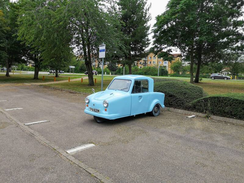

She's reasonably weather proof now.  Though living in a garage it's less critical than in some cases.
Not too bothered about pre-made trim panels when a bit of carpet will do just fine.  Happy enough for those to be left for folks who are more worried about keeping things perfectly correct in the car.  Plus if I do get carpet lining going I'll want everything to match.

Managed about half an hour outside before retreating inside due to passing out becoming an increasingly real hazard.
Offside rear wheel was target number one.  This had lost a lot of paint while on KPL due to a leaking brake wheel cylinder.
Painted and back on the car.  Sorry, forgot to get a photo at the intermediary stage.

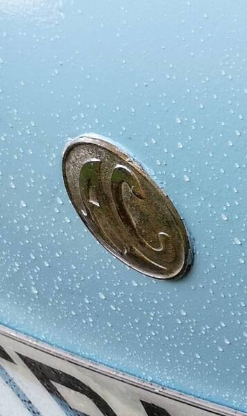

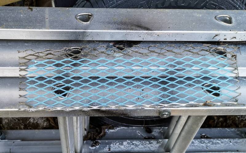

Next up was the grill covering the engine cooling fan air intake.  This was originally bare aluminium, and if I'd realised how easy it was to remove I'd have just taken it off before painting the engine cover...every day's a school day!
It was a bit tarnished anyway so a quick blast of alloy wheel silver wouldn't have gone amiss anyhow.  While I had the silver paint out I used a small brush to touch in the hinges on the engine cover silver too.  Small details, but they all add up.
That photo does a good job of showing how knackered the rear plate is.
I may switch those hinges out for chromed ones at some point for no reason other than because I can...and so they would match what is on the front.
One thing I cannot seem to find for love nor money is the little metal cap for the number plate light...I know it's in the garage.  Somewhere.  That is the extent of my knowledge!

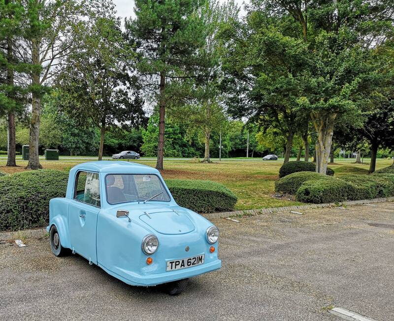

Looking good :)
TPA is looking very smart now :)
I also have to say the colour your painting her is much better then what you had from the spray can :)
(or at least it looks that way from the photos!)

The colour is pretty much identical to what was in the cans, think it just looks better as the whole car is the same colour now.
She doesn't look bad from a distance, still scruffy as all hell close up.  You have really lucked out in that regard with your one.
Thinking I'll probably give the gutters the silver treatment as well, should just help break up the otherwise unending wall of blue.  Not sure if they were originally painted or not - mine were, but I know there's been damage repair carried out on the roof so reckon it was done then.  More masking to do, but at least it's just straight lines for the most part so not too fiddly.

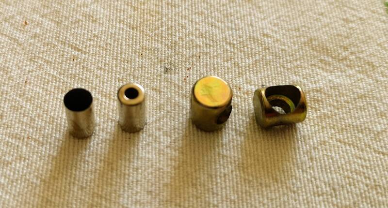

Throttle cable refitting was an utter fail.
Turned out that having now soldered my end onto the cable it wouldn't fit in the twist grip any more.  De-soldering it to adjust then made the previously crimped on end fall off.
I then managed to drop the back part of the twist grip and watch it disappear down behind a pile of stuff in the garage.  Retrieval of this took about half an hour.
I decided to call time at this point before I made things any worse!

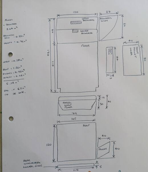

 Took some measurements today for future reference if I decide to go down the route of adding carpet of trimming any areas.  Roof is the obvious one along with the shelf on the transmission cover.  The purpose there is twofold in that it would both help with sound deadening and help stop stuff sliding around so much.   Lining the roof should do a lot to help dampen the general echoes in the cabin.
Front bulkhead is probably quite bad for drumming too as it's one huge flat surface.
Would probably make sense to do the floor and front bulkhead in one section.
Not putting too much thought and time into this right now as there are way higher priority tasks...just interesting to plan for what might be future improvements.  Most carpet rolls are 4m wide I believe so need to factor in any wastage to the calculations for how much would need to be bought.  That's why I'd not consider anything with a graphical pattern on as matching it so everything was pointing the right way would probably be hazardous to my sanity.
I imagine a 2m strip from a 4m wide roll should do the job and give you plenty of room to play with even if everything was done.  Just a shame there are some very rusty fasteners holding the roof on as that would be so much easier with it in the ground.
