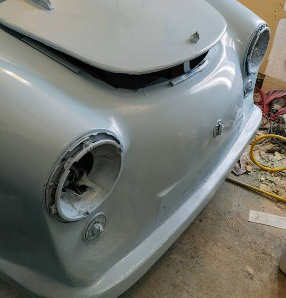

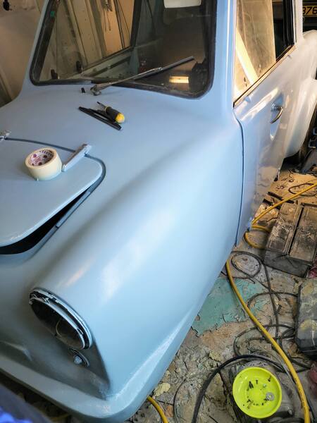

Zelandeth Posted August 16, 2019 Author Share Posted August 16, 2019 Some progress. First off was getting everything masked off so I didn't need to worry about overspray on stuff I didn't want painted. Bit more experimental spraying was done. No question that it's a thousand times better than where we started. If you ever wondered if it's worth wearing a mask...well here's what the particulate filters look like now after about an hour and a half. They were white when we started, and this has produced about a quarter of the amount of garage fog that the rattle cans do...so yes, make sure you're wearing the correct PPE. It's somehow reassuring to actually see evidence of the filters doing their job. The only issue I seem to be having is actually getting enough paint onto the car. Think I'll need to experiment with a bit more thinners than the instructions actually recommend to see what happens. Will do a bit more experimentation with paint mix over the weekend and see if I can get a thicker layer put down. Feels like we're heading in the right direction, even though there's a fair way to go yet. Skizzer, LightBulbFun, egg and 3 others 6 Link to comment Share on other sites More sharing options...
Zelandeth Posted August 17, 2019 Author Share Posted August 17, 2019 Definitely struggling with the spray gun a bit. I don't seem to be able to get any sort of a wet edge laid down no matter what I've done with the settings and the paint doesn't seem to be atomising all that well, hence the pebbly texture we seem to be getting most of the time. When covering other colours (like the grey primer on the roof front edge) it was immediately apparent how thinly the paint was going on too. I did a little experimentation with thinners and found that I could get a decently "wet" spray - but at such a point that the paint was watered down to the extent I wound up with odd effects where the pigment had run...so not really a solution. I think the £18 spray gun may need to be eyed as a possible contributor to these issues...I don't think air supply is an issue as I've verified I've got suitable pressure at the delivery point (not just shown on the regulator). Every now and then it will sputter for a second then give me a few seconds of actually decent spray...so there are some spots where things are actually glossy. Bit frustrating to be honest as so far I've not come close to matching the finish I was getting from rattle cans (admittedly at about ten times the price) beforehand. As demonstrated by the engine cover below, where it caught the rain a little yesterday evening when the back end was sticking out the garage door a bit. We'll get there I'm sure...just going to take some time and experimentation I think. Broadsword, richardthestag, LightBulbFun and 5 others 8 Link to comment Share on other sites More sharing options...

Zelandeth Posted August 17, 2019 Author Share Posted August 17, 2019 Not being able to get a good layer of paint down has three main drawbacks. [] The obvious inability to get a gloss finish without significant work with the cutting paste later on and/or clearcoat. [] Difficulty in getting a properly even finish on any of the larger flat areas as there's not enough paint to get a proper can pattern. The offside quarter looks very patchy because of this. [] Inability to build the paint up over imperfections. This paint has pretty good properties from the perspective of being self levelling...but not if you're doing the equivalent of spattering it on the surface by flicking it off a toothbrush. It's definitely a step forward, no question there...just want to make sure I'm not missing anything obvious before I accept where we stand with regards to the finish. Matt or gloss, if I can get it all looking even I'll be happy enough for now. RayMK, LightBulbFun and The Moog 3 Link to comment Share on other sites More sharing options...
Zelandeth Posted August 18, 2019 Author Share Posted August 18, 2019 Nothing massively meaningful to report from today. Have had a brief chat with a friend who does a fair bit of paint on commercial vehicles, and he has suggested that working with this type of paint, a 1mm nozzle in the spray gun is probably smaller than ideal for full panel spraying. This seems to tie in with my experimental results, where I managed to get a lovely finish on the little box I was using as my test subject - yet it felt like I was blowing paint through a drinking straw again when I turned back to the car. He has suggested given the surface isn't great and we're using PU 1K paint, it would be worth trying painting it with a small roller. That's four people who have suggested that now...so I'll give that a shot tomorrow. Should make a good deal less mess anyway...and should be pretty quick. Hopefully my throttle cable will arrive shortly... I've not discounted the National Microcar Rally yet, but I'd really need to get a few days of solid testing done... Amishtat, LightBulbFun and Mrs6C 3 Link to comment Share on other sites More sharing options...

Zelandeth Posted August 19, 2019 Author Share Posted August 19, 2019 Just realised on looking closer that the spray gun I have comes with both a 1mm nozzle (which I have) or 1.5mm one. I didn't spot this when I bought it. The 1.5mm one looks to be far more suited to this sort of paint. Hmm... methinks I may be grabbing the larger one tomorrow. It also has a far larger paint container which wouldn't be a bad thing. This one I currently have only holds 100ml to the brim (so realistically 80ml or so usable), so refills are a frequent occurrence. That's what I get for not doing my homework. LightBulbFun 1 Link to comment Share on other sites More sharing options...

Zelandeth Posted August 19, 2019 Author Share Posted August 19, 2019 That me getting snapped on people's dash cam footage again? Unless I'm hallucinating, it looks like we might actually be making progress now. Ten points to everyone who suggested that a 1mm nozzle was smaller than ideal for this paint and application. 1.5mm is working far better. It feels like far more of the paint is now actually ending up on the panel now than just floating around in the garage. I had about 250ml left of the original litre...and it felt like it went way further than two refills of the original spray gun would have. There's probably room to open it up a bit more yet to be fair too. Will get an additional two litres picked up tomorrow, get the last few bits of car masked up, then have another bash at it. It's behaving far closer to what I was expecting with this spray gun though, and is giving a finish which it's actually worth flatting back for the next coat, rather than a finish that is rougher than the abrasive I'd plan to flat it with. Time will tell if it's a false start...but this feels like progress. dozeydustman, Skizzer, egg and 4 others 7 Link to comment Share on other sites More sharing options...

Ben_O Posted August 19, 2019 Share Posted August 19, 2019 What pressure are you spraying at? If you have a pressure gauge on the gun, then you should read the pressure with the gun trigger half on so the air is flowing but not the paint. I would recommend about 2bar. Also, make sure that the flow adjuster is wound out enough Too higher air pressure will cause the paint to atomise too much and you won't be able to get it on wet enough. If you don't have a pressure gauge, pop some thinners on the cup, hold the gun sideways in front of you and pull the trigger. You should see a nice full fan of spray. If the pressure is too high, it will be a broken fan with spray at the top and bottom but not so much in the middle. It's amazing the difference you will see when using the correct pressure. Coming on leaps and bounds though. Cheers Ben Mrs6C, Tickman, Skizzer and 1 other 4 Link to comment Share on other sites More sharing options...

Zelandeth Posted August 19, 2019 Author Share Posted August 19, 2019 Pressure wise I'm not entirely sure just now. This gun is calling for around 60psi if I remember rightly, but is a lot hungrier on air than the previous one. The new gun doesn't have an air flow control, relying on the regulator for that. I didn't have much paint today to play with, so when things behaved reasonably well on the first shot (which was just with the reg wound wide open albeit at the end of a pretty long hose) I just ran with it with the bit of paint I had. That trick using thinners and a visual check of the fan is one I'd been told before but had totally forgotten. I'll give that a try tomorrow. It actually seemed to be going on pretty well today despite the random settings, so I reckon with a bit of fine tuning we'll have things spraying nicely. One thing I'm definitely doing tomorrow is sorting the blasted hose out first. I spent half of today tripping over the damned thing and trying to keep it off the panels I'd just painted. I think a wall mounted drum to store it on is something I need to invest in. Having a 25 metre hose is well and good, but it's a bloody pain to wrangle inside a small garage. It's about the right size to let me get to the far side of the driveway, but there's no proper storage currently. Have been having a bit of a think about long term fleet plans today. Much as I love the Activa she persistently loses points for being expensive. She's going to be wanting a decent chunk of money spent soon too. [] Two tyres definitely as they're worn out - ideally a full set of four based on age. So probably £250 based on a ten second check on Mytyres. [] Rear silencer - probably middle section as well based on prior experience sayi& it'll disintegrate when I separate it from the tailpipe. I'm not doing this myself and my usual garage have made it quite clear that they really don't want to mess about with exhausts any more than I do. So it'll be Formula One for a stock system...but the rear box alone is £98 plus the VAT...so I'm probably not going to get much change from £300 I reckon. At that price I may as well just pay a bit more and get a cat back system in stainless. At least the cat is a decent distance back on this so it should save me a few quid. [] Front suspension re-bushing. To be fair I should have done this a while back. I've got most of the bushes involved in stock, so at some point shortly I'll probably throw the car at Two Wrestlers Garage with the instruction "stop the front end rattling please." Bit of a shot in the dark...but call it £200. The paint really could do with attention as well as she's getting really quite scruffy now. Granted...once this lot is done it should mean the to do list will be pretty small for a good while hopefully. This would be a far easier pill to swallow if I could sell the Lada. Which is now out of MOT... I've been kind of ignoring it for the last few weeks. At some point I'll need to get it a new test. That will want a front brake overhaul and a new exhaust. Blarg. Don't suppose anyone wants to sell a GSA do they? Really finding myself fancying one...had forgotten them for a while. Been forever since I borrowed a friend's one...one of the few cars to get an honest WTF moment out of me when I first sat in the driver's seat...though I remember that the bonkers dash and controls actually worked really well after a few miles, but above that was the almost sublime levels of comfort provided and a glorious soundtrack. Skizzer and richardthestag 2 Link to comment Share on other sites More sharing options...
