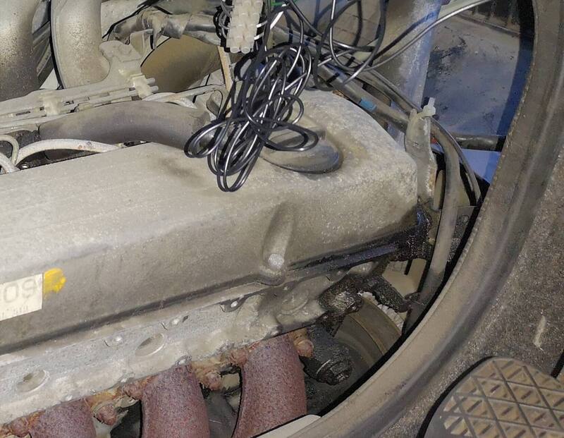

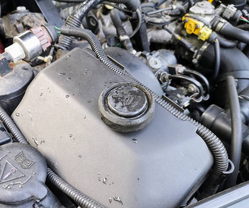

Zelandeth Posted June 15, 2019 Author Share Posted June 15, 2019 Finally back in action after an absolute stinker of a cold. Been ages since I've been knocked for six like that. So...the Xantia decided that it would progress the clutch issue from "annoying" to "dead" day before yesterday. Finally getting the lid off revealed no fluid present. No huge surprise there given the behaviour. Topping it off and liberal pumping of the pedal returned something resembling a working clutch. Bleeding it will obviously be needed, though given the lack of any provision for that will make that job "interesting." This is the point things got downright annoying. Having returned the car to a usable if imperfect state, I decided to call it a day and put the lid back on the reservoir...and promptly dropped it straight down the back of the engine. Did it drop all the way out the bottom? Of course not...Can I reach it? Heck...I can't even *see* the thing...Balls! Will get it on the ramps at the weekend and see if I'm really lucky and it's sitting somewhere accessible from underneath. Not holding my breath...might need to find a new one...though I do have a spare Lada one which I'm really, really tempted to install somewhere actually sensible Inthe engine bay. The current arrangement is just downright idiotic. Have a sneaking suspicion that the original lid will be buried down there for ever more. I'm just praying there's nothing wrong with the master cylinder...as I don't even want to think about the degree to which I'd need to dismantle the car to get that out. The squeaking from the fan belt on the van had got to the point that it was driving me mad...so figured it was time to change it...picked up a new belt back with the £350 batch of bits from Merc before the MOT. One of the main reasons for using a main marque specific dealer is that they have all the fancy parts lookup systems...therefore it's easy for them to track down exactly what you need. Especially useful when there are a zillion different variants of the vehicle. You should wind up with the correct parts...right? Oh. Annoyingly it's well outside the return window. Anyone need a decent quality 6PK2000 belt? Guess I'll be hunting down a replacement tomorrow. So the van is still squeaking. The Citroen is immobilised because I've dropped the clutch fluid reservoir lid down the back of the engine, and the offside front brake caliper on the Lada is weeping again...time for a new one. Think the Invacar needs to come out this weekend so something can go awry, then I can go for a full house of cars with issues! Link to comment Share on other sites More sharing options...

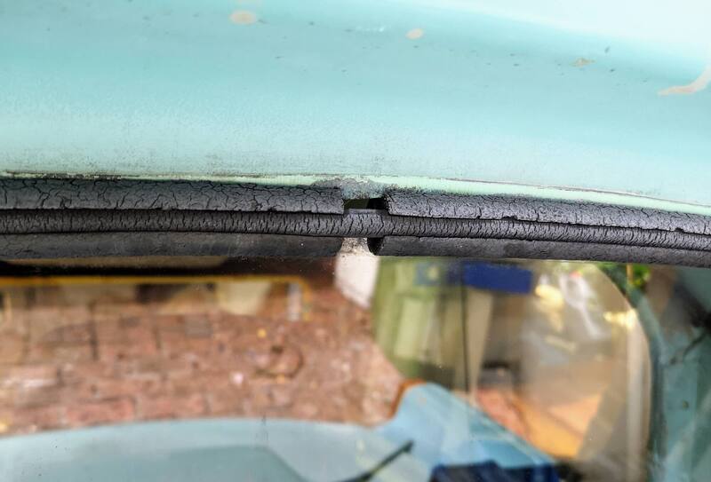

LightBulbFun Posted June 15, 2019 Share Posted June 15, 2019 ahh, I imagine having a husky turbo boost would do that to your brakes happy to see some more work being done to improve the Invacar, hopefully the seals are just standardised items that can be cut to the required length but the better question is, what happened to the defuser on that Popular pack and if its staying missing, it needs a proper T12 tube fitted (T8 tubes in T12 sockets like that always looked quite naff to me) Link to comment Share on other sites More sharing options...

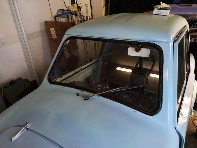

Zelandeth Posted June 15, 2019 Author Share Posted June 15, 2019 Tape is now off the Invacar. Looks like I've got enough overlap on the edge of the glass to ensure it's actually sealed to the seal. This is where most of the water around the windscreen had been historically getting in. Can easy enough increase the overlap a bit of needed. Top tip: panel preparation wipes (intended for use immediately before applying paint) will easily remove any PU sealant like this which hasn't fully set. Handy to deal with the inevitable finger print or two. ...Plus one very black finger because I apparently nicked the glove I was wearing so one of the fingers wound up entirely full of the goop! Thankfully it wiped off me as easily as the panel...will use sturdier gloves next time! LightBulbFun, RayMK and egg 3 Link to comment Share on other sites More sharing options...

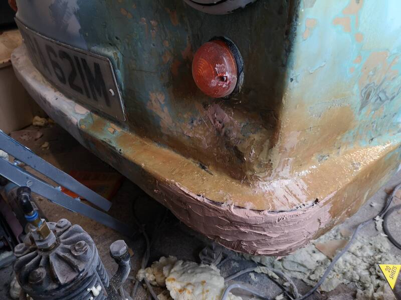

Zelandeth Posted June 17, 2019 Author Share Posted June 17, 2019 Having done a bit of testing it does appear that both front and rear windscreens are now waterproof. Haven't actually subjected it to sustained rain yet, so we'll just have to see how it goes. Finally had a chance to do a bit more bodywork reconstruction this afternoon. The foam based corner now looks like this. Obviously some serious sanding action needed, but definitely heading in the right direction now. Reckon I'll need to take a bit off the outer radius of the bumper, but I've kind of done that deliberately as it's far easier to take a bit extra off than to add extra material. This stuff is *way* nicer to work with than what I was using before. Will see how it sands, but in terms of application it's streets ahead of the stuff I've been used before...it actually holds its shape when upside down which was really handy when forming the lip along the bottom of the body. This is definitely getting bought again in larger quantities as I get a feeling it's going to be a useful addition to the toolbox. Have given the underneath of the service cover a skim over as well, hoping that will help strengthen it a little as it's suffered from being quite bendy so far due to the old damage. Mrs6C, vulgalour, LightBulbFun and 3 others 6 Link to comment Share on other sites More sharing options...

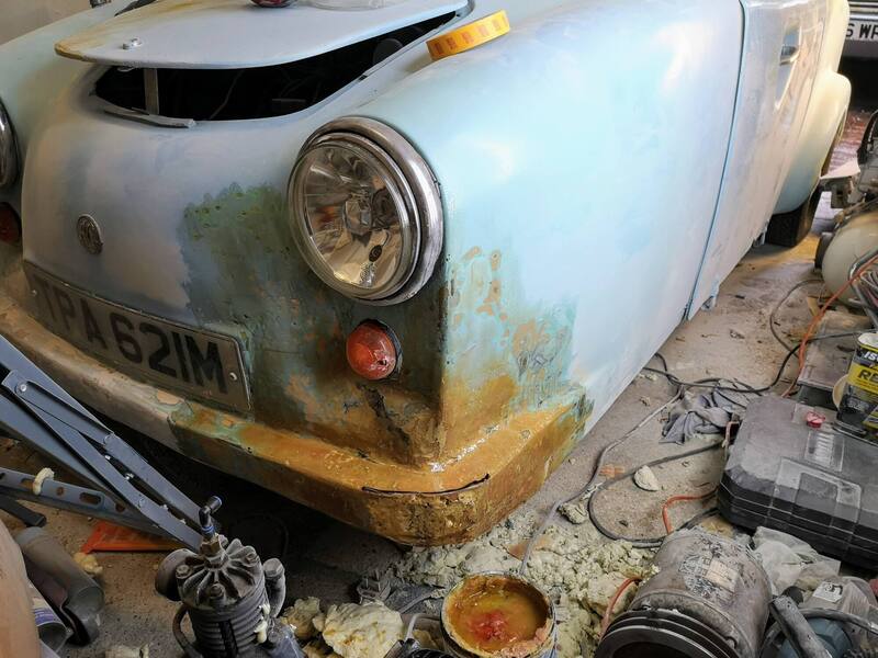

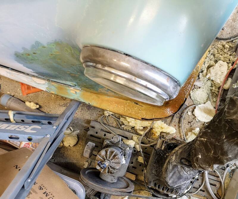

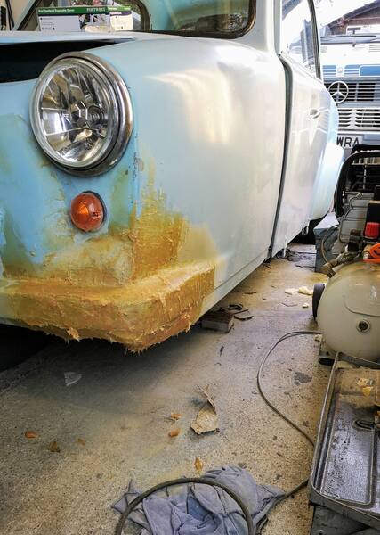

Zelandeth Posted June 17, 2019 Author Share Posted June 17, 2019 It seems that each time I do a bit of work on the body of TPA it comes out a bit better. As of this afternoon it feels like we're actually getting pretty close to the offside front corner being built up to a suitable standard to be ready for finishing. The work from yesterday was extensively sanded back (I'll be finding dust for years) to help define the profile before laying down another layer of paste over it. The swadge line is still a little wobbly, and I've got a plan to tidy that up when doing the next stage of sanding. Once that's done it will probably be a few coats of resin to toughen it up before throwing some paint at it. It's not perfect by any means, but I think will qualify as "passable" once finished up and painted with a bit of care. I still hope that at some point in the future I might be able to get a mould cast off a car with sound bodywork here to match the profile more precisely. I've also started to build up the lower edge of the offside corner too. It doesn't need anywhere near as much work to get it to a usable state thankfully. Really wish I'd discovered this glass fibre loaded paste sooner as it's so much easier to use than the old school separate Matt and resin approach. Having done a bit of anecdotal testing shows it to be more than strong enough for this job. Hopefully I'll get time to get it finished tomorrow and start throwing some paint at it. Mrs6C, egg, Amishtat and 3 others 6 Link to comment Share on other sites More sharing options...
LightBulbFun Posted June 17, 2019 Share Posted June 17, 2019 very nice work my only comment on it if you dont mind me saying, is I think the corner is meant to have a wider radius (is that the right word?) the other corner is not actually that far off here's a couple pictures to hopefully give you a good idea on the shape of things Mrs6C 1 Link to comment Share on other sites More sharing options...
Zelandeth Posted June 17, 2019 Author Share Posted June 17, 2019 Yeah, getting that radius correct seems to be the tricky bit. It's one of those things that you only really notice once you look at the photos. It's just foam under the fibreglass skin there so shouldn't be too hard to grind it back to the right profile. I'm not too bothered about getting it millimetre perfect so long as it doesn't look a mile off. Still kinda peeved that eBay fouled up the bidding on those NOS body panels the first time round! LightBulbFun 1 Link to comment Share on other sites More sharing options...
LightBulbFun Posted June 17, 2019 Share Posted June 17, 2019 aye its something I had noticed for a while now, but seeing how you have been continuously restructuring that corner I was a bit reluctant to point it out, especially given the amount of effort you have put into rebuilding that corner, I dont want to come off as down putting or anything! indeed the whole body situation annoys me as well, from ebay glitching out the first time it showed up, to the person who won it, literally selling his Model 70 chassis before hand, and then complaining he does not have a chassis for his body, tbh at this point I feel sorry for KPL twice now that poor Model 70 has been deprived of a body the rest of this rant is probably best saved for next time I visit or something LOL (at least I got a bunch of neat photographs from the second ebay listing, its very interesting to see how the body sections where constructed ) Link to comment Share on other sites More sharing options...
Zelandeth Posted June 18, 2019 Author Share Posted June 18, 2019 The radius of that corner being quite a ways off was bugging me...so out with the grinder again. At close of play today this is where we were. Now we're getting somewhere. Still not perfect, but is close enough now that I think I can call it "good enough" given I started out with this. I am going to be finding dust for months. LightBulbFun, egg, GrumpiusMaximus and 3 others 6 Link to comment Share on other sites More sharing options...
LightBulbFun Posted June 18, 2019 Share Posted June 18, 2019 32 minutes ago, Zelandeth said: The radius of that corner being quite a ways off was bugging me ah goody glad I was not alone very nice work its look much better then before and is very impressive given how you had none of the original corner to work with! I wonder if it would be worth it in the absence of another Model 70 to make moulds from, for Dollywobbler to take a sheet of paper and make a 2D template of the radius of corner on TWC, and then scan it in for you to print out so you can then offer it up to the corner and sand according to it? Link to comment Share on other sites More sharing options...
Zelandeth Posted June 18, 2019 Author Share Posted June 18, 2019 I've got a sneaky plan for next time I'm in the same physical location as TWC, and it involves two of those self-inflating foam packing kits. Basically take two of them and use those to make a rough mould for both sides of the panel. It won't give me a mould that's perfect enough to stick a gel coat straight into, but it will give me something that's dimensionally accurate to work with. As there's no direct contact between the foam itself and the surface it means that the poor state of TWC's paintwork (which is mainly what's precluded making a mould the usual way) isn't an issue. LightBulbFun 1 Link to comment Share on other sites More sharing options...
