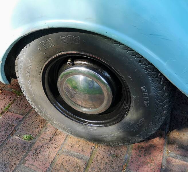

captain_70s Posted May 21, 2019 Share Posted May 21, 2019 1 hour ago, LightBulbFun said: Reminds me of the wheels on @captain_70s dolomite I brush painted mine with Hammerite Smooth Black rather than Hammered Black. LightBulbFun 1 Link to comment Share on other sites More sharing options...

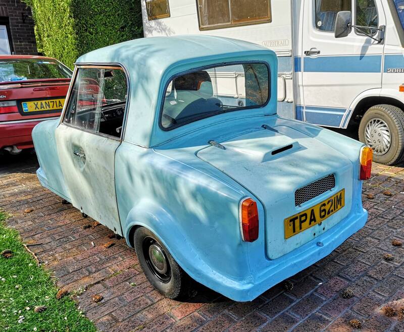

Zelandeth Posted May 22, 2019 Author Share Posted May 22, 2019 TPA has been pretty busy today. By the end of the day we'd covered 26 miles. Glad to report that despite a good mix of low speed residential and high speed dual carriageway work that the gremlin count has remained at zero. Here's a better picture of the freshly painted wheel in actual sunlight. The drive system still isn't exactly happy, sounds like the belt is flapping around at speed (probably because of the remaining imperfections in the pulley surfaces) but it's vastly better than it was. If time permits tomorrow I will pull the access cover to see how the belt is looking. It was obvious before I did the work on the pulleys that it was getting utterly shredded after less than ten miles...so this seems a decent opportunity to check it. Speaking about checking things, figured I would take a look at the plugs now I've had a couple of decent higher speed runs. Originally I was having issues with the offside one fouling up, but they look healthy enough to me now. Offside: Nearside: The plugs staying clean ties in with the oil consumption having essentially dropped to zero now a few miles on the road having been driven. Wouldn't have surprised me if there was a sticky piston ring or two prior to that. Actually really enjoyed the drive out today. She's surprisingly happy at 50mph, and the ride is far better than it really has any right to be in such a tiny lightweight car. Even if the way a three wheeler behaves over some types of road surface does take a bit of getting used to! It's refreshing to find how much of a liability she isn't on the main roads. One thing I hadn't clocked until today was how familiar the soundtrack from the drive is when you lift off the throttle...it totally sounds like the retarder on most late 90s era ZF (Ecomat?) gearboxes usually found in buses and coaches...figures my brain would have decided to make a bus connection... Quite nice to have got a test run done - especially given it was a pretty strenuous one - without anything going awry or falling off. Given I will be wanting to drive her over to Stoney Stratford in a couple of weeks for a show, it's nice to have made a good start. dollywobbler, LightBulbFun, egg and 3 others 6 Link to comment Share on other sites More sharing options...
LightBulbFun Posted May 22, 2019 Share Posted May 22, 2019 very Awesome stuff! very happy to see continued running without any issues BTW I tell a lie on this being the first time iv seen 10 inch black wheels on a Model 70, I was look at some photos again, when I realised XEV95S is pictured in service on 10 inch black wheels but regardless of that, they are looking very nice RayMK and Fumbler 2 Link to comment Share on other sites More sharing options...

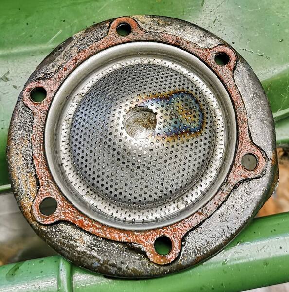

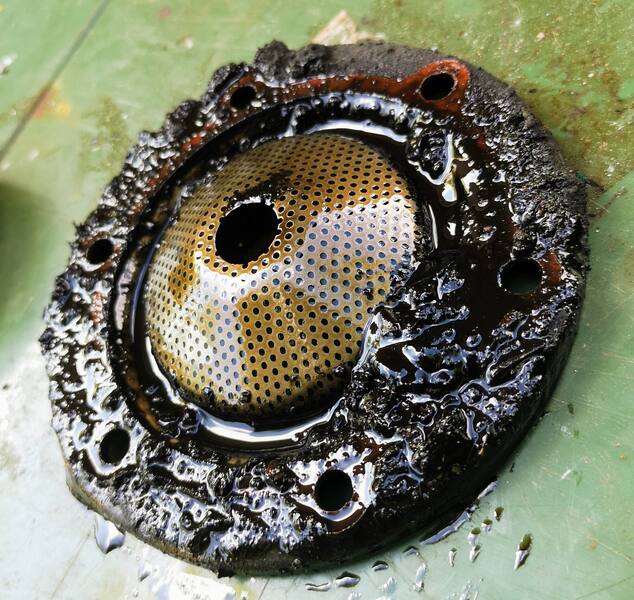

Zelandeth Posted May 24, 2019 Author Share Posted May 24, 2019 Had another cross city trip today in the Invacar, nothing to report aside from befuddled looking pedestrians and other drivers. With 50 or so miles of actual driving done I decided that it was time for another change of the oil & oil filter. In addition I wanted to drop the oil pickup strainer as I was expecting it to be full of slime again. I wasn't disappointed. That's just nasty. It's not actually immediately obvious there, but there is a lot of gunk inside the strainer itself too. Looks far healthier now. Hopefully on the eighth attempt that image has actually been inserted where I told it to. Definitely goes to show that when an engine has been forgotten about for a couple of decades that a carb rebuild and a couple of oil changes just aren't enough, there can still be a load of crud floating around in the engine. I will probably pull this again in another fifty miles to check again - basically repeating until it stops accumulating slime between checks egg, Scruffy Bodger, RayMK and 4 others 7 Link to comment Share on other sites More sharing options...
LightBulbFun Posted May 24, 2019 Share Posted May 24, 2019 im curious what do those lumps consist of exactly I wonder if its a case of just the oil strainer having never been serviced in the engines life time until now so things have built up over the past 40 years because if an engine has been sitting for 15 years, its obviously not been doing anything for those 15 years, so I do wonder how those lumps and bits of crud would form over those 15 years or so? (my current best guess is, would it be things that where in suspension in the oil when it was in use then slowly settling out of the oil over the 15 years of diss use and lumping together at some point?) Link to comment Share on other sites More sharing options...
dollywobbler Posted May 24, 2019 Share Posted May 24, 2019 Ok, now I'm feeling bad. I know I dropped the strainer on one of my engines. Did I do it on both? Er, no idea... Link to comment Share on other sites More sharing options...
Fumbler Posted May 24, 2019 Share Posted May 24, 2019 From my knowledge of hydrocarbons and other organic chemisty, the oil will just gel up into slugs of solid bitumen etc. because it's been left to settle for so long. This stuff is really sticky and likes to lift up right when you think it's all gone! LightBulbFun 1 Link to comment Share on other sites More sharing options...
captain_70s Posted May 24, 2019 Share Posted May 24, 2019 On 5/22/2019 at 10:21 PM, LightBulbFun said: very Awesome stuff! very happy to see continued running without any issues BTW I tell a lie on this being the first time iv seen 10 inch black wheels on a Model 70, I was look at some photos again, when I realised XEV95S is pictured in service on 10 inch black wheels Looks like Glasgow/Paisley... LightBulbFun 1 Link to comment Share on other sites More sharing options...
LightBulbFun Posted May 24, 2019 Share Posted May 24, 2019 30 minutes ago, captain_70s said: Looks like Glasgow/Paisley... indeed it is IIRC, sadly flicker is down atm so i cant check exactly where (IIRC the guy who uploaded/took the photo did say where it was snapped) curiously enough VES108S/XEV88S was also deployed to scotland, or at least it ended up there in its finally days in service, hence when it sadly lost its original plate in 1998 or so, it gained a scottish local reg (I wonder if all the XEV-S cars where built for scotland or something?) Link to comment Share on other sites More sharing options...
Zelandeth Posted May 24, 2019 Author Share Posted May 24, 2019 1 hour ago, dollywobbler said: Ok, now I'm feeling bad. I know I dropped the strainer on one of my engines. Did I do it on both? Er, no idea... Pretty sure it was your current engine given you first be oil pressure issues after your first hill climbing tests, and as I recall TWC was never driven on the road before the engine was swapped was she? 2 hours ago, LightBulbFun said: im curious what do those lumps consist of exactly I wonder if its a case of just the oil strainer having never been serviced in the engines life time until now so things have built up over the past 40 years They're basically just congealed oil. All oils will break down chemically over time (far more of an issue with older oils than the modern synthetic oils). Any moisture in there will also cause issues as it will cause emulsification of the oil. In addition to that there will be some carbon that winds up in the sump, which helps this stuff stick together too. All reasons you could change your oil regularly. I don't think the strainer would have been an issue in normal service. The problems we've seen here are due to a couple of decades of neglect...if the oil was changed every few months as per the service schedule I wouldn't expect any problems like this. LightBulbFun 1 Link to comment Share on other sites More sharing options...
LightBulbFun Posted May 24, 2019 Share Posted May 24, 2019 1 minute ago, Zelandeth said: Pretty sure it was your current engine given you first be oil pressure issues after your first hill climbing tests, and as I recall TWC was never driven on the road before the engine was swapped was she? They're basically just congealed oil. All oils will break down chemically over time (far more of an issue with older oils than the modern synthetic oils). Any moisture in there will also cause issues as it will cause emulsification of the oil. In addition to that there will be some carbon that winds up in the sump, which helps this stuff stick together too. All reasons you could change your oil regularly. I don't think the strainer would have been an issue in normal service. The problems we've seen here are due to a couple of decades of neglect...if the oil was changed every few months as per the service schedule I wouldn't expect any problems like this. 1 hour ago, Fumbler said: From my knowledge of hydrocarbons and other organic chemisty, the oil will just gel up into slugs of solid bitumen etc. because it's been left to settle for so long. This stuff is really sticky and likes to lift up right when you think it's all gone! ah cool, yeah makes sense (on DWs engine front, yeah thats what I recall too, also memorable as he set fire to his oil catch can trying to burn some of the oil and sludge out of the strainer IIRC!) Link to comment Share on other sites More sharing options...

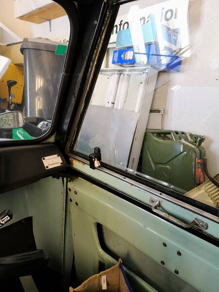

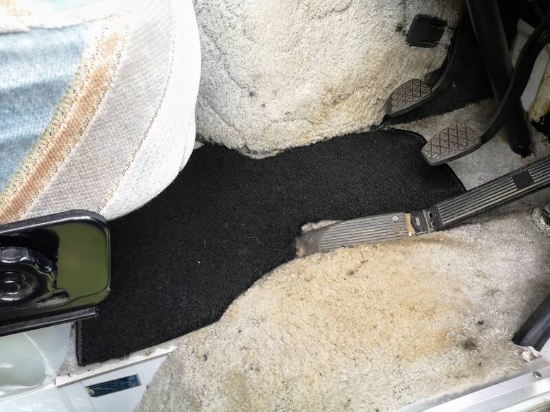

Zelandeth Posted May 25, 2019 Author Share Posted May 25, 2019 (edited) Running around all over hell today so nothing much to report...only thing I did was finally get around to mutilating a set of floor mats for the cab of the van. Suffice to say none of the generic ones ever fit because the footwells of the van are way different in shape to those in a car. Nearside one is relatively simple, just needs a little chunk removed for the space taken up by the engine cover. Offside one requires rather more hackery. Two reasons. Firstly is that the engine cover is not actually central in the cab - it's a good couple of inches nearer to the offside of the van. Secondly is that this van has a floor mounted throttle pedal with a huge heel rest, so you need to cut a slot out for it to sit in. The cab will be getting new carpet at some point (yes, in something more sensible than beige shag pile), so I really wanted some mats in there before that happened so as to keep things clean. Oh, and I had been repeatedly knocking this set of mats over in the garage for months and I wanted them out the way. Hopefully will get some actual garage time tomorrow so will have something more worthwhile to report on. Edited May 25, 2019 by Zelandeth Correcting autocorrect (as usual) mrbenn, LightBulbFun, RayMK and 1 other 4 Link to comment Share on other sites More sharing options...

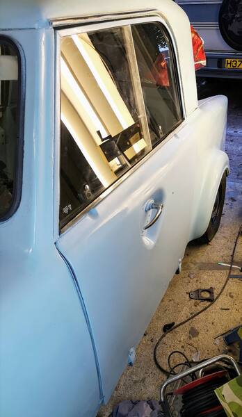

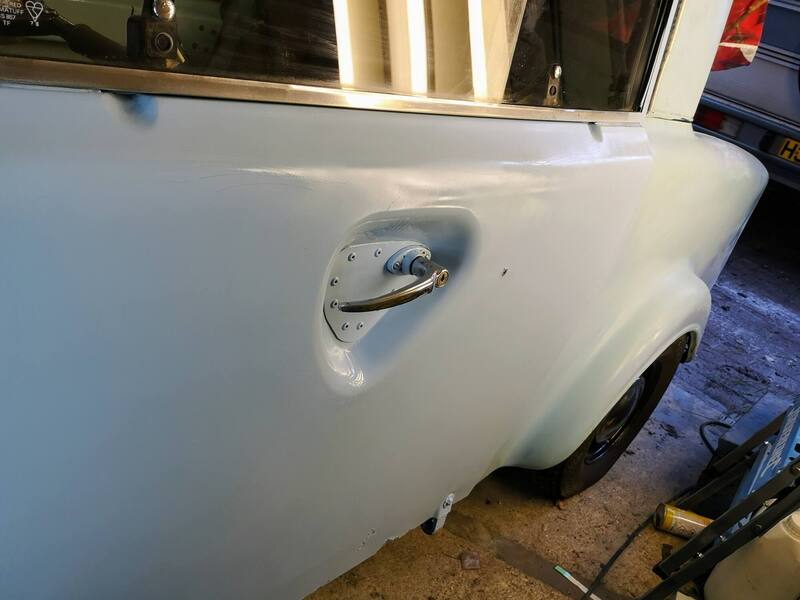

Zelandeth Posted May 27, 2019 Author Share Posted May 27, 2019 Aside from the scruffy corners, one thing which has been really obviously detracting from the bodywork on the Invacar is the fact that the doors are a totally different colour to the rest of the body. Today I threw a bit of paint at the nearside one to see if I could do anything to improve it. Mostly has taken really well, just one area directly above the door handle where something has reacted with the paint. So I'll need to get that area rubbed back and repainted before getting things ready for another coat. Definitely looks better than it did I think. Dick Longbridge, stonedagain, LightBulbFun and 5 others 8 Link to comment Share on other sites More sharing options...
LightBulbFun Posted May 27, 2019 Share Posted May 27, 2019 very cool stuff! it looks to be a pretty good match to the paint on the rest of TPA, is it the same blue you used to touch up past repairs? (I seem to recall the touch up paint being a deeper/more vibrant blue then the rest of the bodywork) speaking of paint, if you want to go the full 9 yards at some point heres official Invacar paint info im not 100% sure how to interpret it all, but it would be interesting to plug its values into a computer or something and see if it happens to match any known colour? mrbenn and BlankFrank 2 Link to comment Share on other sites More sharing options...
Zelandeth Posted May 28, 2019 Author Share Posted May 28, 2019 Not too worried about the exact colour at this point. When (if) in the future I decide to get the whole car resprayed professionally, that document may prove useful. For now however I'm going to stick with the Ford colour I've been going with so far. It perfectly matches one of the colours of paint that is on there...so it's not entirely inappropriate. Got everything wiped down today and have given it another few coats. Looking reasonable I think. Still needs another couple of coats I think, as the finish is a bit patchy yet, but we're getting there. It's forever since I've painted a larger panel so I've been playing the how-do-get-an-even-finish game. Especially in my cramped garage where I'm working in my own shadow the whole time. I may well just take the door off and outside to do the final coat or two. If this hadn't landed on top of us when I was doing the work today I'd maybe have done so today. Yes, the resulting rain was precisely as heavy as it looked like it would be. Have done another bit of tidying. Handlebars are no longer rusty and as rough as sandpaper. I've also made a personal choice with regards to interior decor. The inside of the door upper runner and the previously flaky windscreen pillar trims have also been painted black. No, it's not factory spec...but it's entirely reversible with naught but a paint brush, and it's my car. I think it looks better like this as it ties several parts of the interior together visually. Yes I'll touch in the little patch between the windscreen an dash top once I have a smaller brush to hand. Didn't want to get paint on the dashboard as it would be a pig to remove it from that finish. Personally I think having a bit of detailing breaking up what was otherwise an unending sea of solid blue is an improvement. NorthernMonkey, LightBulbFun, RayMK and 2 others 5 Link to comment Share on other sites More sharing options...
LightBulbFun Posted May 28, 2019 Share Posted May 28, 2019 33 minutes ago, Zelandeth said: Not too worried about the exact colour at this point. When (if) in the future I decide to get the whole car resprayed professionally, that document may prove useful. For now however I'm going to stick with the Ford colour I've been going with so far. It perfectly matches one of the colours of paint that is on there...so it's not entirely inappropriate. Got everything wiped down today and have given it another few coats. Looking reasonable I think. Still needs another couple of coats I think, as the finish is a bit patchy yet, but we're getting there. It's forever since I've painted a larger panel so I've been playing the how-do-get-an-even-finish game. Especially in my cramped garage where I'm working in my own shadow the whole time. I may well just take the door off and outside to do the final coat or two. If this hadn't landed on top of us when I was doing the work today I'd maybe have done so today. Yes, the resulting rain was precisely as heavy as it looked like it would be. Have done another bit of tidying. Handlebars are no longer rusty and as rough as sandpaper. I've also made a personal choice with regards to interior decor. The inside of the door upper runner and the previously flaky windscreen pillar trims have also been painted black. No, it's not factory spec...but it's entirely reversible with naught but a paint brush, and it's my car. I think it looks better like this as it ties several parts of the interior together visually. Yes I'll touch in the little patch between the windscreen an dash top once I have a smaller brush to hand. Didn't want to get paint on the dashboard as it would be a pig to remove it from that finish. Personally I think having a bit of detailing breaking up what was otherwise an unending sea of solid blue is an improvement. looks good to me! (then again my standards for "looks good" on invacars is, "are there less then 3 gaping holes in the body work, yes? then good it looks good to me" in stark contrast fraser said GPG721K was is in a sorry state just because of a broken tail light and spun door handles...) just dont get TOO carried away Link to comment Share on other sites More sharing options...

LightBulbFun Posted May 29, 2019 Share Posted May 29, 2019 21 minutes ago, SiC said: I think I've said it on your thread + videos at least three times alone. It really bugs me...! if the switch being the "wrong way round" bugs you so much Its probably best you dont see the Speedo on a AC Acedes Model 57/64! Link to comment Share on other sites More sharing options...
Zelandeth Posted May 29, 2019 Author Share Posted May 29, 2019 Getting there. Annoyingly I got slightly too heavy handed on the last pass and wound up with a couple of runs. Meh, it'll do for now. It looks a thousand times better than it did. Have also started to sort out the offside front corner which was my horrible first GRP fabrication effort. Out with the original effort... Difference is that this gives me a relatively regularly shaped hole to fill rather than a horrible ragged mess I originally had. The approach to build this up is going to be quite different. Instead I've thrown expanding foam in there, once that's set I'll sculpt the correct profile, then slap a skin of GRP over the top of that and then a bit of filler, and then paint. The bit I've been struggling with has been the profile of the underside of the edge, but this should be a doddle. I'm much more used to sculpting stuff from foam than GRP, so I reckon I've a better shot at getting the shape right. Mrs6C, Scruffy Bodger, Amishtat and 4 others 7 Link to comment Share on other sites More sharing options...
