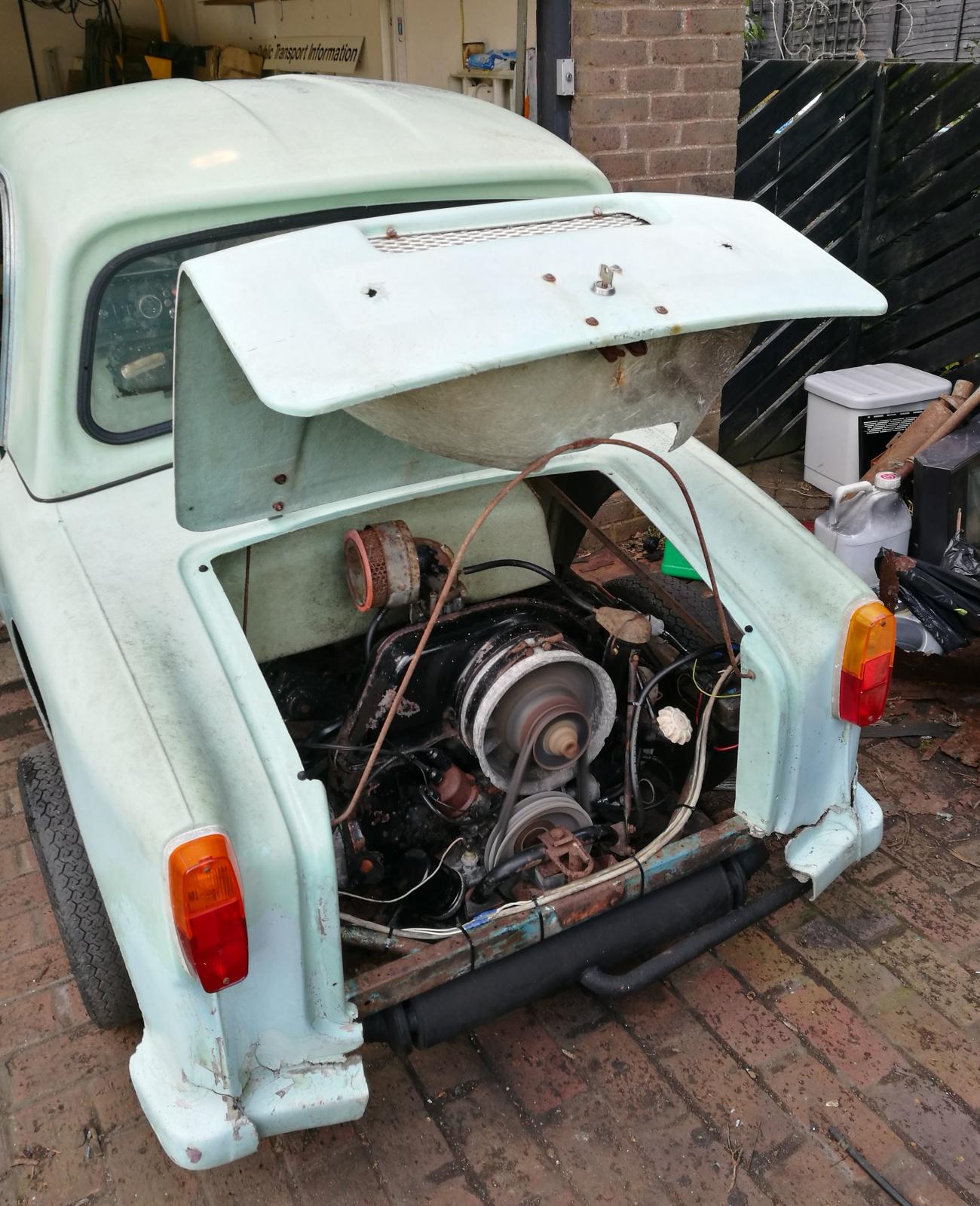

Zelandeth Posted April 10, 2018 Author Share Posted April 10, 2018 Just back from holiday, so was determined to get into the garage for five minutes. Invacar started first touch despite sitting for a fortnight. Have pulled the exhaust off to clean it up and paint to keep the elements off. Would have been rude not to see what it sounded like without it... basically think of any bike from the 60s with an engine of this sort of size...rather nice actually! Will hit it with the carbide mop tomorrow then give it a good coat of paint. Looking at it, it appears that it would originally have had a dark grey enamelled finish originally. LightBulbFun 1 Link to comment Share on other sites More sharing options...

Zelandeth Posted April 14, 2018 Author Share Posted April 14, 2018 Okay, tweaking the idle speed up a bit has totally transformed this thing where starting is concerned... It's now just a case of "flick the key, then wait five mins or so while it warms up." Useful given that the choke cable currently sticks - meaning I need to tank it with a pair of pliers to turn it off! Have finally got it up on the axle stands, however it was late enough that I didn't want to make a racket, so drive system meddling will have to wait until tomorrow. Link to comment Share on other sites More sharing options...
somewhatfoolish Posted April 15, 2018 Share Posted April 15, 2018 I also got fed up of tripping over the engine cover stay, which seems to have a talent for managing to get in the way irrespective of where I put it in the garage...so I solved this problem by reattaching it to the car. IMG_20180315_161845.jpg At least it keeps it out of the way. The air intake duct does make the engine cover annoyingly awkward to work around though, so I can see the cover being removed regularly if I have to spend any real time in the engine bay. Is there any way of inconspicuously making the cover quick release? That would appear best for access other than routine checks. Perhaps the hinge pins might be made removable?About this big. IMG_20180316_123725.jpg Pfft; I've tackled taller and (much) girthier(is that a word? If not I claim copyright). Let us know when you wish it to tragically 'fall over due to high winds/spindle weevils/needle dropsy/it was tired and needed a lie down'. No doubt professional tree surgeons will want a middling king's ransom to fell it and would insist on doing it in an entirely risk-free* manner. Link to comment Share on other sites More sharing options...
Zelandeth Posted April 15, 2018 Author Share Posted April 15, 2018 The engine cover could quite easily be made quick release - just stick one of those pins you can pull out through the hinges rather than the tapered rod that's meant to be a friction fit. For now it's got a nut and bolt in as I know it will want to come off again. The tree will just have to stay for now. Sadly now the council know we want rid of it, if anything unfortunate were to happen to it, they would point the finger firmly at us. Speaking to neighbours, it seems that in such an instance they can and will pursue the matter to the maximum extents possible by law. One neighbour pulled a far smaller tree down that they were totally unaware was covered by the same archaic legislation (that I still have to actually find in written form anywhere) - it wound up costing them several grand at the end of the day. Shame I can't send them the bill for sorting the drive...when I know they will send me the bill for sorting the footway and road! Link to comment Share on other sites More sharing options...

Zelandeth Posted April 15, 2018 Author Share Posted April 15, 2018 Few things done today. Main target though was to see if the variomatic system on the Invacar would work properly...I knew I had drive and that the clutch works fine, but whether the variomatic would vary as intended I had no idea. Given the drivetrain probably hasn't seen speeds north of walking pace this century, I figured it would make sense to check that the diff and gearbox had oil in. Level and filler plugs are easily accessible, so that was the work of about five minutes. Second task: investigate the horrible squeaking, scraping noise coming from the offside rear wheel. Turned out to be the return springs were on the wrong side of the shoes, they need to be on the back. This makes refitting them about a million percent more fiddly but still not impossible. Next up was to engage drive, and get the revs up to see what happened. Answer was me getting a face full of cobwebs, dust and rust as the variomatic system shrugged off a couple of decades of crud. Also this... Speed came up nicely, bit of resonant vibration from the belt at a few points (not unexpected as I know it's a little loose) but nothing untoward. Noticeable change in note from around 45mph upward when the system is meant to drop into a fixed ratio "overdrive" mode according to the manual. Briefly had 65mph shown, but chickened out shortly after that as the noise levels in my not huge garage were reaching biblical levels...and I really didn't want the car vibrating its way off the axle stands. Seems that I have a working variomatic system... I'll take that as a win. Rear brakes work too, even if they're not perfectly balanced yet. Feels like progress, even if it's just proving a system I've not actually done anything to is working... LightBulbFun, Saabnut, PhilA and 1 other 4 Link to comment Share on other sites More sharing options...
