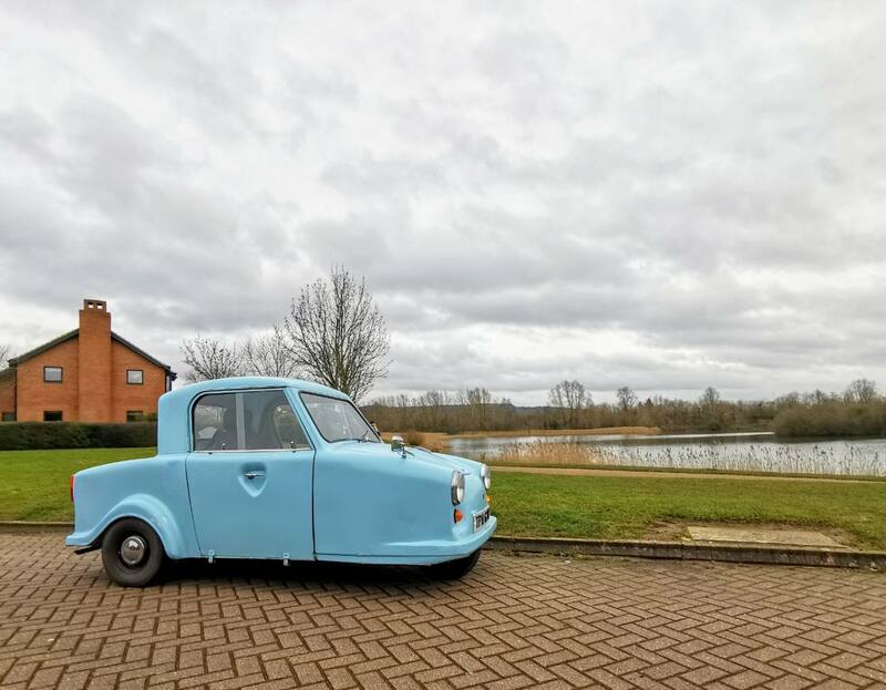

Zelandeth Posted February 16, 2021 Author Share Posted February 16, 2021 Before I could conduct a test drive I had a couple of minor jobs to finish. Reattaching the front mud guard and draining off a bit of brake fluid as the pressure bleeder as usual left the reservoir too full. Job done. Mud guard is still a bit scruffy but given the location I think it's absolutely fine. Also found an ideal stowage location for my cover prop! So on to the test drive. Well, after ten minutes of car Tetris anyway. Slightly concerned by whatever the heck this is under the Jag. Nothing has visibly dropped, though given the capacity of most of the fluids on this thing that doesn't mean much! Answers on a post card as to what that is? I have proven that there's ample room to park the BX behind the Xantia. If the Jag and Xantia can fit there, Xantia and a BX should have room to spare. We ended up with almost exactly 20 miles covered. Which I think gives the game away that the test was successful as otherwise I'd have turned around pretty much immediately and headed back to base. Instead we got all the errands run without incident. Observations: Really wish I'd done this sooner. The difference in braking performance really is night and day. Previously you had a degree of free travel followed by an inch or so of very firm travel where all braking effort took place. Now there's more travel - but delivering progressive braking throughout. It used to be just about possible to lock a wheel if you absolutely threw your weight on the bars, but it took a lot of effort. Now I'd say the effort required to deliver that amount of braking force is on par with any other car that doesn't have ABS. The overall feel of the brakes is *massively* more confidence inspiring. Regarding locking up the wheels that was something I was most concerned about, so one of the first things I did was find a deserted bit of industrial estate and do a bunch of 30mph emergency stop tests. She isn't any more prone to locking up than anything else without ABS, and there doesn't seem to be any tendency for the front to lock up overly easily. I think the forward weight shift under heavy braking helps there. I wasn't able to detect any tendency for control to be compromised at all. Limited to 50mph at the moment while the new belt is run in, but braking down from that sort of speed for a roundabout/junction is no more effort than in the Jag or van. The brakes honestly feel pretty decent now. Handbrake is fully applied seven clicks out it seems, and is quite capable of stopping the car, no slower than in any other car really. Obviously she's not been worked particularly hard given I've got to obey a 50mph speed limit for the first 50 miles of the life of the new belt, but I was pleased at the cylinder head temperatures we were seeing. Bumbling around at low speeds it sits pretty solidly at about 125C. Highest I saw on a long uphill stretch was 165C. Perfectly reasonable numbers, and it seems to be pretty stable. Interesting to see that - I'm assuming because it's bristling with cooling fins - that this engine doesn't seem to suffer the sort of heat soak issues I'm used to seeing with water cooled engines. The Xantia is particularly bad for that, the temperature on that if you come back to start it up after a brief stop can be quite alarming. This just seems to immediately start dropping in temperature from the moment the engine stops. Which being a thermocouple gauge you can actually see as it's self-powered, so doesn't shut off with the ignition. Speaking of confidence inspiring...I honestly had no idea how much the seat was moving around before! That actually staying put really does make the handling feel far less wayward, as I'm not subjected to an inch or two of what feels like oversteer every time I change direction. It was also apparently a source of several rattles. I can't say I noticed a huge difference in the steering, though it *might* be slightly more stable in a straight line. Hard to say how much of that is just placebo effect though. Brake fluid level reassuringly hasn't moved at all during the journey. Glad that fluid is staying where it belongs! On the subject of fluids, it looks like I might have also been successful in sorting the gearbox oil leak. Bit hard to tell because of historic deposits, but this area would normally be visibly wet after a run, rather than just "a bit oily." The upper part in particular you could usually see where it was running down from the top cover plate join. I will obviously monitor that to make sure the oil continues to stay where it belongs. While I'm still treating it gently at the moment I can't say I can tell any difference so far between the HP2020 belt and the NOS actual Invacar one which came off. Will keep you up to date on that. Here's a brief snippet from the first few minutes of the run out. This was done by attaching the phone to the rear view mirror with rubber bands...better than the actual proper phone mount, but still horribly shaky. Plus it meant the mirror wouldn't stay put. That was the main reason I called time on video and pulled over to stop it, I wanted my mirror to behave given I was going to be doing a lot of stops/starts for a few minutes. It's early days but the initial impressions are that these improvements have been precisely that. The braking performance improvement in particular and having a seat that stays put both make a *huge* difference in the overall driving experience. Can't say I notice any real difference in the noise levels having pulled the flashband off the service hatch. Definitely not worth the few kilograms of extra weight for all the difference it was making. Today also gave me the opportunity to do something I'd meant to for ages... actually get a photo of all of the cars together in one shot. They're all filthy...but better than nothing! Of course in two days this group will be out of date and I'll need to get an updated one! Given there's been quite a bit of work done there it feels quite good to actually have tangible improvements coming out of it. RayMK, spartacus, worldofceri and 13 others 16 Link to comment Share on other sites More sharing options...
LightBulbFun Posted February 16, 2021 Share Posted February 16, 2021 50 minutes ago, Zelandeth said: Before I could conduct a test drive I had a couple of minor jobs to finish. Reattaching the front mud guard and draining off a bit of brake fluid as the pressure bleeder as usual left the reservoir too full. Job done. Mud guard is still a bit scruffy but given the location I think it's absolutely fine. Also found an ideal stowage location for my cover prop! So on to the test drive. Well, after ten minutes of car Tetris anyway. Slightly concerned by whatever the heck this is under the Jag. Nothing has visibly dropped, though given the capacity of most of the fluids on this thing that doesn't mean much! Answers on a post card as to what that is? I have proven that there's ample room to park the BX behind the Xantia. If the Jag and Xantia can fit there, Xantia and a BX should have room to spare. We ended up with almost exactly 20 miles covered. Which I think gives the game away that the test was successful as otherwise I'd have turned around pretty much immediately and headed back to base. Instead we got all the errands run without incident. Observations: Really wish I'd done this sooner. The difference in braking performance really is night and day. Previously you had a degree of free travel followed by an inch or so of very firm travel where all braking effort took place. Now there's more travel - but delivering progressive braking throughout. It used to be just about possible to lock a wheel if you absolutely threw your weight on the bars, but it took a lot of effort. Now I'd say the effort required to deliver that amount of braking force is on par with any other car that doesn't have ABS. The overall feel of the brakes is *massively* more confidence inspiring. Regarding locking up the wheels that was something I was most concerned about, so one of the first things I did was find a deserted bit of industrial estate and do a bunch of 30mph emergency stop tests. She isn't any more prone to locking up than anything else without ABS, and there doesn't seem to be any tendency for the front to lock up overly easily. I think the forward weight shift under heavy braking helps there. I wasn't able to detect any tendency for control to be compromised at all. Limited to 50mph at the moment while the new belt is run in, but braking down from that sort of speed for a roundabout/junction is no more effort than in the Jag or van. The brakes honestly feel pretty decent now. Handbrake is fully applied seven clicks out it seems, and is quite capable of stopping the car, no slower than in any other car really. Obviously she's not been worked particularly hard given I've got to obey a 50mph speed limit for the first 50 miles of the life of the new belt, but I was pleased at the cylinder head temperatures we were seeing. Bumbling around at low speeds it sits pretty solidly at about 125C. Highest I saw on a long uphill stretch was 165C. Perfectly reasonable numbers, and it seems to be pretty stable. Interesting to see that - I'm assuming because it's bristling with cooling fins - that this engine doesn't seem to suffer the sort of heat soak issues I'm used to seeing with water cooled engines. The Xantia is particularly bad for that, the temperature on that if you come back to start it up after a brief stop can be quite alarming. This just seems to immediately start dropping in temperature from the moment the engine stops. Which being a thermocouple gauge you can actually see as it's self-powered, so doesn't shut off with the ignition. Speaking of confidence inspiring...I honestly had no idea how much the seat was moving around before! That actually staying put really does make the handling feel far less wayward, as I'm not subjected to an inch or two of what feels like oversteer every time I change direction. It was also apparently a source of several rattles. I can't say I noticed a huge difference in the steering, though it *might* be slightly more stable in a straight line. Hard to say how much of that is just placebo effect though. Brake fluid level reassuringly hasn't moved at all during the journey. Glad that fluid is staying where it belongs! On the subject of fluids, it looks like I might have also been successful in sorting the gearbox oil leak. Bit hard to tell because of historic deposits, but this area would normally be visibly wet after a run, rather than just "a bit oily." The upper part in particular you could usually see where it was running down from the top cover plate join. I will obviously monitor that to make sure the oil continues to stay where it belongs. While I'm still treating it gently at the moment I can't say I can tell any difference so far between the HP2020 belt and the NOS actual Invacar one which came off. Will keep you up to date on that. Here's a brief snippet from the first few minutes of the run out. This was done by attaching the phone to the rear view mirror with rubber bands...better than the actual proper phone mount, but still horribly shaky. Plus it meant the mirror wouldn't stay put. That was the main reason I called time on video and pulled over to stop it, I wanted my mirror to behave given I was going to be doing a lot of stops/starts for a few minutes. It's early days but the initial impressions are that these improvements have been precisely that. The braking performance improvement in particular and having a seat that stays put both make a *huge* difference in the overall driving experience. Can't say I notice any real difference in the noise levels having pulled the flashband off the service hatch. Definitely not worth the few kilograms of extra weight for all the difference it was making. Today also gave me the opportunity to do something I'd meant to for ages... actually get a photo of all of the cars together in one shot. They're all filthy...but better than nothing! Of course in two days this group will be out of date and I'll need to get an updated one! Given there's been quite a bit of work done there it feels quite good to actually have tangible improvements coming out of it. Oh yay! very happy to hear that not only does it all work, that theres also a noticeable improvement and that the HP2020 belt seems to be working well I do wonder what exactly is responsible for the most improvement, was it the De-glazing, or the upgrading of the brake master cylinder to a high quality one or the fact its a Dual circuit one (also have to wonder what caused the brake shoes to glaze over like that, did you do the front brake shoes as well?) but yeah very happy to hear it all works well, and glad to hear the front wheel locking up is not something to be worried about, it was something I wondered about as friends of mine had expressed such concerns to me in the past but I had a feeling the forward weight transfer during a harsh stop would help to mitigate that, glad to see I was on the right track! Link to comment Share on other sites More sharing options...
Zelandeth Posted February 17, 2021 Author Share Posted February 17, 2021 4 hours ago, LightBulbFun said: Oh yay! very happy to hear that not only does it all work, that theres also a noticeable improvement and that the HP2020 belt seems to be working well I do wonder what exactly is responsible for the most improvement, was it the De-glazing, or the upgrading of the brake master cylinder to a high quality one or the fact its a Dual circuit one (also have to wonder what caused the brake shoes to glaze over like that, did you do the front brake shoes as well?) but yeah very happy to hear it all works well, and glad to hear the front wheel locking up is not something to be worried about, it was something I wondered about as friends of mine had expressed such concerns to me in the past but I had a feeling the forward weight transfer during a harsh stop would help to mitigate that, glad to see I was on the right track! There in theory shouldn't be any particular bias towards either end as far as braking is concerned as the master cylinder applies the same *pressure* to each circuit, so the difference in volume shouldn't make a huge difference. You can get a lot of braking effort before locking up anyway - not least because the car is so light. As for the glazing? Not sure. Most likely candidate is contamination of the shoes. I did clean them before they were fitted, but as with a huge chunk of my spares they hadn't been stored well. It wouldn't hurt to just get a set of actually new shoes fitted. The front one wasn't too bad, though it's worth noting that the front brake had shoes in when I got TPA...so all I've done to that brake was replace the form flexible line, grease the pivots and adjust it. That one just behaved perfectly from the very start. It's hard to say what makes the biggest difference! Hypothetically being dual circuit shouldn't make any difference to braking performance. The new cylinder does have a slightly larger bore (17.8mm from memory), which should actually make the pedal heavier to operate (I'm just using the term pedal here as it saves confusion) - one of the reasons I chose to alter the operating yoke rather than trying to find a longer pushrod. As that should increase the mechanical advantage thanks to the laws of physics by moving the working point nearer to the fulcrum. I don't recall the brakes in TWC feeling that different to in TPA (though I always had a bit more dear travel) once I'd sorted them. When I actually did briefly drive TWC though I was still dealing with a sticky conical seal in my master cylinder so her brakes were decidedly sketchy at the time. Between me having cleaned and greased all the pivot points, adjusted clearance on all three wheels, cleaning all the shoes, *thoroughly* bleeding the system (remember I'd not been able to fully bleed the offside rear before), replacing the flexible lines, modifying the brake operation yoke AND fitting the new master cylinder... it's impossible to say for certain what did what. All I know is that it really has transformed the feel of the car. While she's always been fun to drive the brakes have just never really inspired huge confidence as they've always felt quite wooden. Now she's quite capable of standing on her nose if asked, that really does help reduce stress levels significantly. Combined with the seat actually holding you in place, she really does feel like a different car. Need to get another 30 miles under her wheels so I can drive normally again! It's astonishing how easy you need to take it to keep her under 50 on any open road. Plus it doesn't make you too popular with the locals. When TPA arrived here she was showing 11353 miles on the clock, so we're 31 miles from hitting the big 1K which feels like a decent milestone. Will be doing a change of all the oils, oil filter, drop and clean the oil pickup strainer, finally actually changing the distributor cap and rotor arm, checking and regapping the plugs if needed, going over all the grease points etc at that point. Do hope that I can get her to at least some form of show or event this year, even if it's just something where a bunch of classic enthusiasts get together and have a convoy, parade of something like that without leaving our cars. Feel bad for the Jag there too, have had her for over a year now but aside from one rained-off breakfast meet up haven't been able to get that to anything. LightBulbFun and egg 2 Link to comment Share on other sites More sharing options...

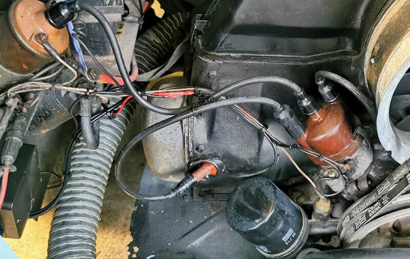

Zelandeth Posted February 17, 2021 Author Share Posted February 17, 2021 Ah yes...this would be why I didn't just replace the cap and rotor arm originally. They're sods to get. Only place I can find with a cap in stock want €20 to ship to the UK. Mister Auto show the rotor arm in stock...but their ordering system appears to be borked at the moment and it won't actually let me place an order. Time to get in touch with the Steyr-Haflinger guys directly again methinks, hopefully they'll have the service items like this in stock on the shelf. LightBulbFun 1 Link to comment Share on other sites More sharing options...
LightBulbFun Posted February 17, 2021 Share Posted February 17, 2021 6 hours ago, Zelandeth said: Ah yes...this would be why I didn't just replace the cap and rotor arm originally. They're sods to get. Only place I can find with a cap in stock want €20 to ship to the UK. Mister Auto show the rotor arm in stock...but their ordering system appears to be borked at the moment and it won't actually let me place an order. Time to get in touch with the Steyr-Haflinger guys directly again methinks, hopefully they'll have the service items like this in stock on the shelf. Dizzy cap is shared with the DAF33 if its any help! (not sure about the Rotor arm however) heres a handy cross reference of sorts of the the bosch part numbers they fly under as well https://www.autodoc.co.uk/bosch/1185296 (Bosh 1235522119 looks to be another thats not listed there) otherwise these are the guys are who you want for engine bits https://www.haflingertechnik.com/ and if you want go fast engine bits these are the guys (they do own a Model 70 so they should know what your on about!) https://prokschi.at/ Link to comment Share on other sites More sharing options...
Zelandeth Posted February 17, 2021 Author Share Posted February 17, 2021 That was easy...All the service items ordered in one hit from Prokschi. Haflinger Technik sadly lose points for not having any form of web shop sadly or I'd just as happily have used them and probably saved a packet on shipping. However I'm juggling enough things right now without needing to go back and forth over email to confirm availability, get prices etc. Let's see how many months this package takes to arrive... LightBulbFun 1 Link to comment Share on other sites More sharing options...

Zelandeth Posted February 17, 2021 Author Share Posted February 17, 2021 I imagine the clear ones would be made of acrylic rather than phenolic resin (bakelite) that they usually use. Tend to think that would be more prone to degrading over time in the rather harsh environment that is an engine bay. Just went with the black one as I'm not trying to introduce bling to the engine bay any more than I can avoid. LightBulbFun 1 Link to comment Share on other sites More sharing options...
LightBulbFun Posted February 17, 2021 Share Posted February 17, 2021 19 minutes ago, Zelandeth said: I imagine the clear ones would be made of acrylic rather than phenolic resin (bakelite) that they usually use. Tend to think that would be more prone to degrading over time in the rather harsh environment that is an engine bay. Just went with the black one as I'm not trying to introduce bling to the engine bay any more than I can avoid. Yeah that what I was wondering, hence my comment about if it was just made for testing/tuning/diagnostic purposes or not for me its not the bling factor, I just find it neat seeing transparent versions of normally opaque things/seeing into things you cant normally to see into (especially if they can seen still working/in operation), why do you think I own a half coated fluorescent tube mat_the_cat and CaptainBoom 2 Link to comment Share on other sites More sharing options...
Zelandeth Posted February 17, 2021 Author Share Posted February 17, 2021 There seem to be a few listings for them in clear form for the Steyr Puch engined Fiats, so might just be one of those oddities. Like the OEM ones for the Jag being violently bright blue so they look like something from the Halfords £1 bargain bin. Can't see from a tuning perspective anything useful they'd show you maybe other than being able to confirm if there was/not excessive sparking at the points... though that's nothing you can't do carefully with a screwdriver. LightBulbFun 1 Link to comment Share on other sites More sharing options...
