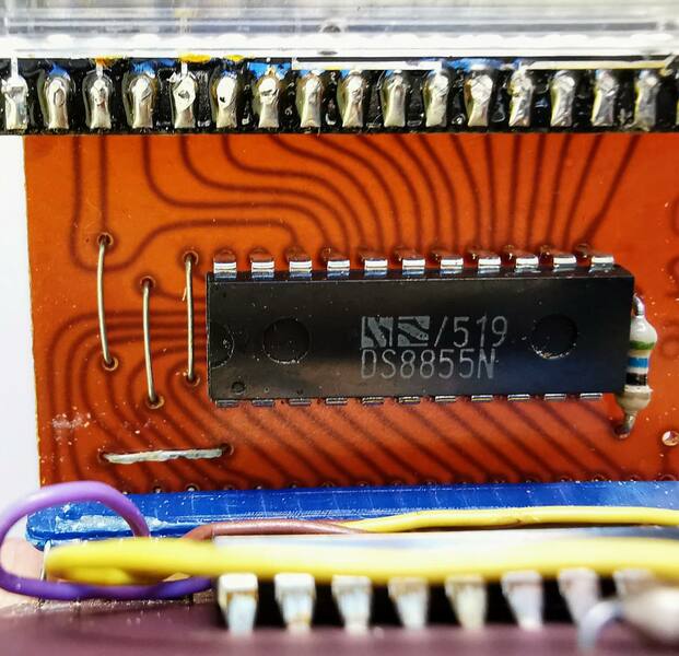

Had one little job earlier in the day on the electronics workbench.  Our patient was a Prinztronic Mini7 calculator I picked up about a week ago.
While it powered on there was no response from the keypad (aside from the number 2) and there was clearly an intermittent issue with the power supply.
This isn't a particularly high end calculator...in fact it's very much built down to a price.  No screws on the case, it all just clips together.
It is quite stylish though (especially in this two tone blue) and by the standards of the time was quite compact.
Took a while to figure out how to get it apart but we were in pretty quickly.
Here's the heart of the beast for those of you interested in this stuff...no surprises to see a TI TMS series IC.
TI helpfully date code things in a dead simple way too so we now have a solid date of mid 1975.  There is one other IC in here which I'm pretty sure is just a display driver given where it is in circuit.
Don't recognise that maker's logo.  Anyone know it?

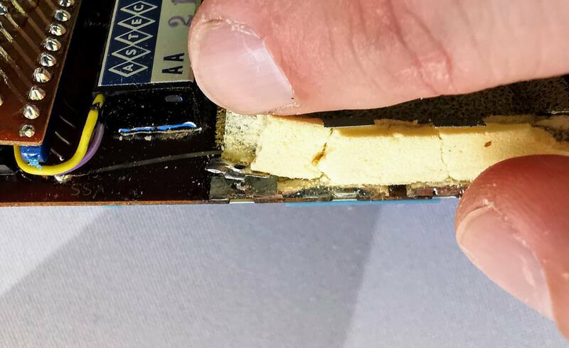

The reason for the intermittent power was a dead simple cracked solder joint between a battery post and the PCB.
Easy repair.
The issue with the keypad became self explanatory the moment I started to dismantle it as the metal domes from the keypad switches started to cascade over the desk like metallic confetti.
Those domes should all be stuck to this PCB!
Getting these all back where they were supposed to be was a bit like trying to herd a scurry of squirrels who are all hyped up on Red Bull, but we got there in the end.
I was quite interested to see how the keypad legends were printed...I had assumed the legends were screen printed on the back of the keys themselves.  Was quite surprised to find that it was actually just a printed sheet of paper behind the keypad.  There are little lenses moulded into the back of the keys which makes it look larger.
Quite clever actually.  Means they only needed to make one standard type of keycaps for the whole range, just printing a bit of paper to accommodate different layouts or features.

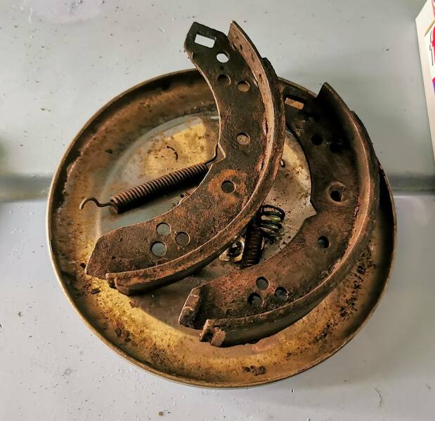

Perfect weather for crawling around on the ground working on cars...
That process I mentioned above for rebuilding the brakes?  Complete cobblers!
That's what happens when it's over a year since you last did a job and try to remember the exact sequence of operations without the hardware in front of you.  Here's the exact sequence I've found to be easiest - I only had to retrieve and refit a spring which made a bid for freedom once during this, and the whole process was less than half an hour.
Only thing that didn't look happy in there was that the brake shoes were quite glazed - though I think this was probably the case when they went in.  May well explain why  the brakes have always felt a little wooden.
I took these outside and wet them down, worked upwind and had a decent dust mask on, and gave them a gentle scrub up.  The abrasive paper while still wet was double sealed in two plastic bags before putting it in the bin.  I'm not losing too much sleep over a miniscule amount of potentially asbestos containing brake dust that's sealed in a very damp plastic bag.
Didn't go crazy, just wanted to get the worst of that glazing off.  I'll do the same on the other side when I have it apart.

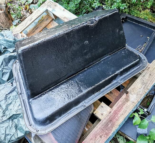

The last job for the day before I retreated inside to regain feeling in my extremities was to see what I could do with the mangled front mudguard.
After fifteen minutes or so bashing it with a 4 lb lump hammer, we had this.
Not pretty, but once it's buried under the body and in a matt, textured paint finish it'll look just fine.  Looks a mess while the paint is still wet though!
This will dry to a satin hammered finish, so should look just fine then.  The underside has been painted as well...I couldn't see any evidence of it having ever been painted from new underneath!

As expected, the nearside brake shoes were quite glazed so were given a scrub up just as the ones on the other side were.  My prediction that the adjustment was "drastically in need of attention" was indeed correct.  I think I got a full three turns on it before we got to the point where the shoes came anywhere close to touching the drum.  Beyond that it was just a case of "reassemble like yesterday" and to tweak the adjustment of the offside one so they felt even.
This has vastly improved things, there's far less dead travel in the brakes now - though it's still closer to my knees than I'd like because of the essentially lost travel as the bars are starting slightly depressed.

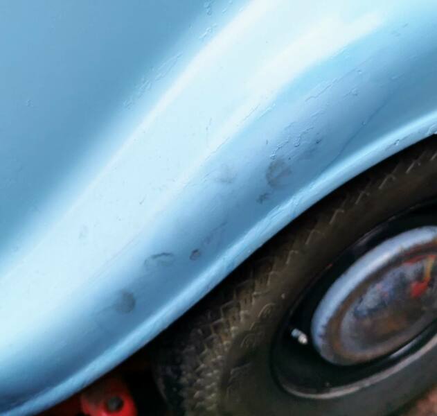

The paint on the mudguard has dried up pretty much as I'd hoped.
Once it's in place I think it will be perfectly presentable.

Edit: There we go, the webpage is now live on my website for the Prinztronic Mini 7 Calculator Over Here...
Smart looking little thing.

Having satisfied myself that the rear brake circuit is fluid-tight I buttoned back up the service hatch - finally got around to swapping out the 8mm nuts for wing nuts so I don't need tools to open it up any more.

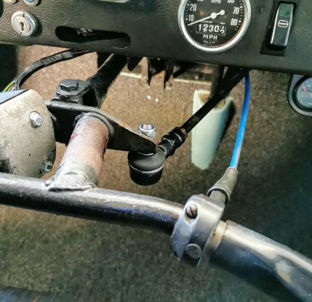

Last job was to try to change one of the ball joints.  Decided to go for the one on the handlebars as it's by far the easiest to get to.
Getting the locknut free did require a good belt from the big hammer but somewhat to my surprise everything came apart without much fuss at all.
Comparing it to the new ones does show a bit of a difference in the tapered section, though the length of the joint itself is identical.
I *think* this is the manufacturer cheating a little to get away with using the same part for a couple of different applications.  The top part of the taper is exactly the same size and profile as the existing one, so there will just be a bit more protruding below, with the body of the joint sitting a little lower.  Shouldn't be an issue in this application.
The only headache was the inevitable moment when the spindle started to rotate while trying to tighten up the nyloc nut.  Pair of pliers were able to provide enough friction though to get things tightened up.  Job done!
Here are the markings from the original one in case they're useful to anyone.
To be honest with a new clip for the boot and some fresh grease this one could probably do further service - though when they're so cheap you do have to wonder if it's worth it!

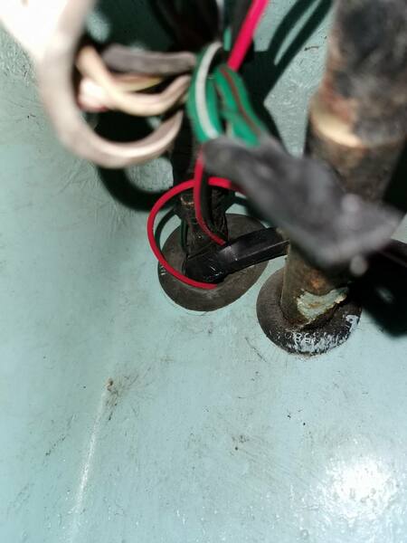

Fed it all through the car, then hooked up the engine end, routed it along the HT leads then jumped to the main loom that runs under the battery tray.
Then continues to follow the main front-to-rear loom down under the floor.
It is cable tied to the loom where it passes through grommets in the chassis braces under the floor, before popping back up following the handbrake cable and fuel lines as appropriate before rejoining the loom in this corner.  I'd have preferred to follow the main loom all the way up there, but that would have required removal of the fuel tank to get to...so we took the long way around.
Then into the cabin through the big grommet to the left of the handbrake cable.
Then behind the dash to the gauge itself.  Firing the engine up showed success first time.  I left the engine running at a fast idle for about 25 minutes while I was putting things back together and tidying up and this was where she settled.

No worries.  As I've said it's no workshop manual and your mileage may vary...that's just the sequence I've found easiest.  Still fiddly as all hell but that's true of any work on brakes I think.
Think I've generally been quite lucky with the brakes on TPA really.
Link to comment
Share on other sites
38 minutes ago, dollywobbler said:
I do now have some proper brake spring pliers, so it'll be interesting to see if they help.
They should make getting the top spring on an order of magnitude easier I'd think.
Getting that spring seated properly is quite important I think - as if it's not the tendency will be for it to try to pull the shoes together in a V shape (looking from above/below) rather than in a linear fashion.
