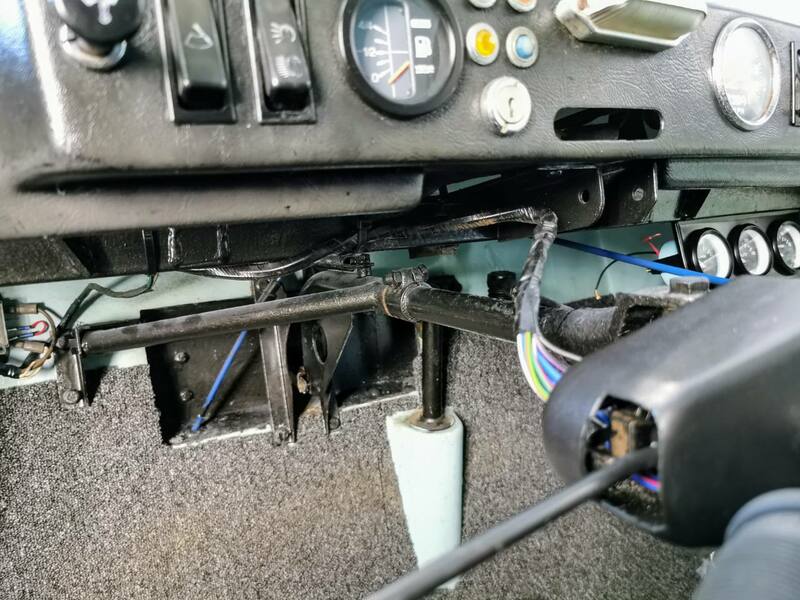

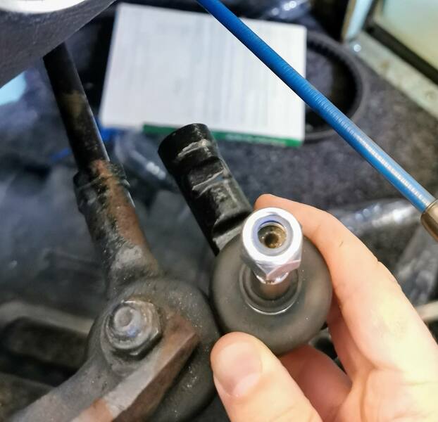

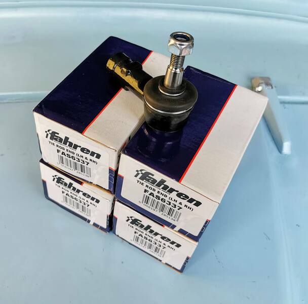

The box of track rod ends arrived this morning.
Doing a quick visual comparison they look to be correct - the length from the end of the casting to the centre of the nut looks to be the same (they're not quite lined up in the photo).
I'll try swapping that one out first as it's by far the easiest to get to.  That's a job for another day though.  I want to finish off the list of things I've already started first.

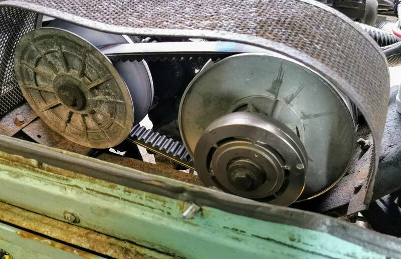

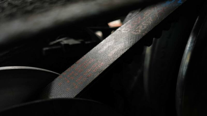

First up was a belt swap.  Figured it was time to put theory into practice and see if the Dayco HP2020 is indeed a suitable modern drop in replacement CVT belt for an Invacar.
Comparing it to the one I've had on there for the last 415 miles I cannot see any difference whatsoever...so I reckon it will be absolutely fine.
That belt by the way looks absolutely fine - so it seems that the current parts stash having been stored in far better conditions than my originals were has made all the difference.
No real signs of wear there at all or any issues like glazing that would suggest overheating, or the outer braiding failing - which given she has been blasting along at high speed a few times lately was something I wanted to check for.
New belt on.
The old one will be kept in the car as a spare.  I'm going to figure out some method to tether it either in the engine bay or under the front hatch so it's out the way.  Definitely worth having it in the car though, changing the belt only takes five minutes and requires nothing but a 17mm spanner (and 8mm in my case to open the service hatch), so it's definitely within the realms of viable roadside repair if one lets go in the future.
For reference, the arrows on the belt need to face towards the nearside.  Kind of hard to get a usable photo of that I'm afraid.
I'll report back on how it performs...I'm honestly expecting the answer to be "exactly the same as the one I just took off."

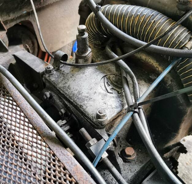

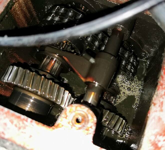

On the subject of the transmission, I wanted to address some of the leaks.  While TPA's engine is more or less oil tight, the gearbox not so much.  It weeps a bit, especially after fast runs.  I'm not entirely sure how many leaks there are - but I know that one source is from the top cover, where it then runs down over the offside of the gearbox casing.  I can't tell if there's also a leak from the driveshaft seal there until I've sorted the one from the top cover.
At least that's simple enough.  I don't have any gasket paper in stock at the moment, so just made do with a bead of instant gasket (which looks like what it was sealed with originally).
While I had the cover off I checked to make sure the oil level hadn't dropped - glad to see it's still level with the fill plug.  Though it looks to have been frothed up more by my spinning of the pulleys than I'd like, and the oil definitely looks more murky than I'd like.
She'll be getting an oil change in about 150 miles anyway, so I'll make sure the gearbox and diff oils are done along with that.  The one thing which does occur to me is that when I change the gearbox oil last time it was done stone cold when the car hadn't moved in a while...so it's quite possible there was some gunk at the bottom of the box that I didn't pick up when I drained it.
I'll see about making a paper gasket then too.  This will do for now though, and hopefully the oil will now stay put.

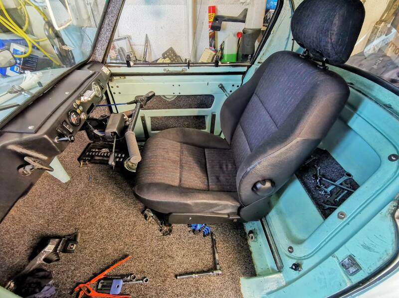

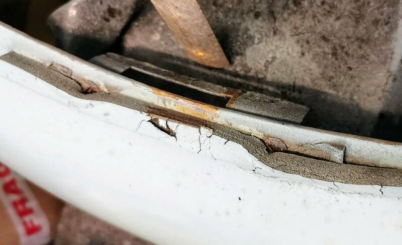

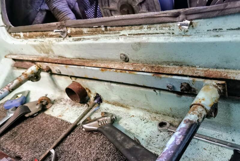

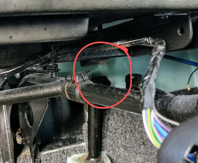

Something I'd planned to do last time I had things apart there was to improve the seat mounting arrangements a bit.  To allow the standard seat to slide left to right the rear sits on a pair of rollers in a channel.  One of the downsides of this is that because the seat is only secured laterally by a single catch at the front, it means that when you corner the back of the seat is able to shift an inch or so.  This is probably more of an issue for me as the seat I've got in TPA offers several orders of magnitude more lateral support than the standard one!
Even after a year this sensation is still downright unnerving.
My solution to this is extremely simple.
Two bolts through the rear seat frame and the backing of the runner.  This securely locks it in place so should do away with that really annoying shift whenever you turn into and then the opposite way when you leave a roundabout.  It's also entirely reversible if someone wants to get rid of it in the future.  I actually started this job ages ago before realising I didn't have any suitable bolts...I had ones that were either too short or waaaaaay too big.
Last job was to put the brake lines back in their clips (I'd removed them when fitting the new flexible lines to give more freedom of movement), then I was clear to reassemble the interior.
This should have been a ten minute job...however the seat decided to be an absolute pig and put up a fight (this happens about one in four times when you have it out), so it took about half an hour to get that bolted back in.  I'm glad to report that the difference now the rear of the frame can't shift is immediately apparent the moment you sit down, never mind while driving.  It's a tiny detail in the grand scheme of things, but I think should make a big difference to the feel of things when you're driving.
This is where I had to leave things today as I ran out of time (hence there still being tools scattered everywhere).  Feels like I got a few things ticked off though.  Things like the gearbox oil leak have been on the list for a while.

59 minutes ago, Zelandeth said:
Right...Let's try this again.  I wrote 90% of this up earlier on the phone when the editor glitched and ate it.
ah so THATS what I witnessed entering LEO earlier today...
happy to see continued TPA refinement and fettling going on, will be very interesting to see how the HP2020 belt does :)
the bolting of the seat in place was actually something done to some Model 70's in service so you could claim it as a period modification LOL, in fact @Mrs6C's Model 70 has its seat bolted in place, as it has nowhere to slide to due to, the floor mounted handbrake on the nearside and a wooden slide-over box is on the offside (I suspect as the normal tip up slide over seat was only made for the nearside)
(I think they thought it was best to bolt it in place so it could not ever accidentally get unlatched and accidentally slid into something, you would not want to trap your fingers between it and the slide over box for example LOL)

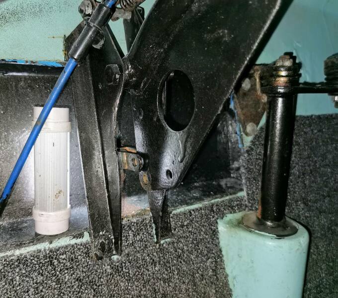

I've managed to crush my fingers between the seat base and the gear selector a couple of times when I've managed to unwittingly unlatch it while working on things in the cabin.  Now I've locked the back in place I'll probably see if there's an easy way to lock the latch release lever in place.  There is a temptation to remove it entirely if it was possible as it does jut out into the cabin and I regularly snag myself on it.  Wonder if it might be possible to bend it back on itself to tuck it away under the front of the seat better...
The seat will need to come out once more though at some point as I do want to paint the frame.  As the interior is getting tidied up bit-by-bit it's bugging me progressively more.
Link to comment
Share on other sites
In the interests of not damaging something that isn't easily replaceable, how about doing a long-term-but-not-necessarily-permanent swap for the seat release lever in Dolly? The handles on Dolly's seat release lever have been cut short  so you can't actually grab anything easily to effect a seat release. With the seat being at present bolted into place in its runner as @LightBulbFun says, I guess this was to stop the user from trying to move the seat. The extra seating box has been removed for the moment (it will be restored and go back in for general originality and display purposes eventually but in a more easily removeable way) so I'd like to be able to slide the seat around in its limited space rather than not.
Swapping the seat release levers, if it's possible to do so without it being a major exercise, could be a useful non-permanent modification for both vehicles.
Link to comment
If memory serves the fasteners involved on TPA are sufficiently crusty that they're unlikely to be removed in any way that's not going to be at least somewhat destructive.  That's the only reason I didn't take the seat base out when I did the carpet (which would have made my life WAY easier).
I'll take a closer look next time I'm in the garage to see if the latch can be removed separately.
EDIT:
Had a look, and as far as I can see the latch assembly is essentially an integral part of the seat base.  Looks like the eyes it passes through are slipped over the actual latch/handle assembly before they are then welded onto the frame.  So removal of any of that is impossible without pretty major surgery I think.

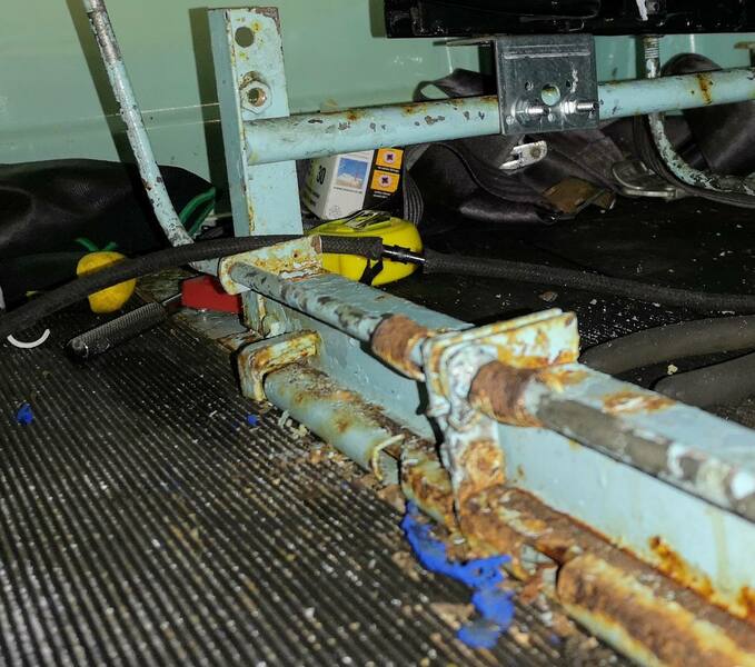

Photo from way back in the archives from before TPA was on the road.

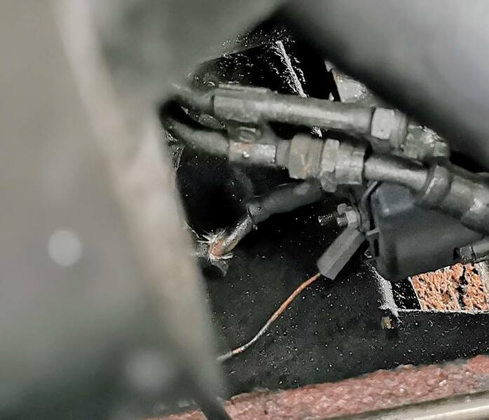

Just noticed something when flipping through the photos I took when looking at the alternator on the Jag.
Is it just me, or does that output lead look like the terminal has been getting rather toasty?
If I can get to it, that's getting trimmed back and re-terminated... I'm not honestly expecting it to make the slightest difference.  However it's £1-200 cheaper than an alternator so definitely getting tried first.  The behaviour initially seemed to suggest a high impedance issue somewhere...
EDIT:
there must be some sort of way to get it apart relatively easily as the individual components are listed as parts in the DHSS parts manual I think?
(unless handle assembly means something else? also have to wonder what Zip fast means in this context because all im getting is fire starters! unless the DHSS was ahead of the Japanese in including destress flares LOL)
Link to comment
I'll need to take a closer look next time I'm in the garage but the handle etc certainly looked like one piece and the mountings it runs through looked like they were welded in place.  Further investigation needed!

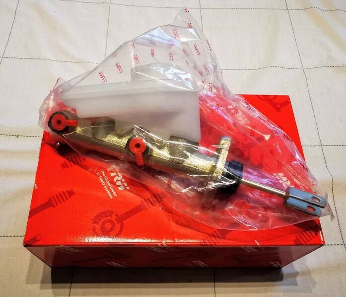

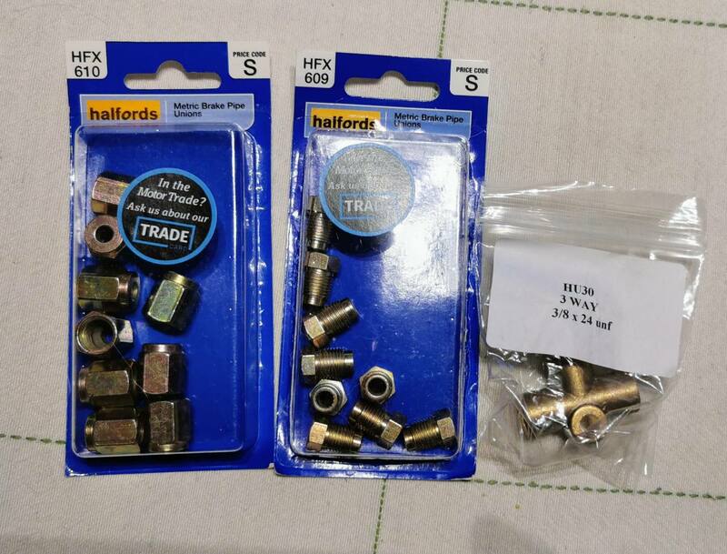

This just arrived in the post.
Let's see if I have an opportunity to get it installed this afternoon.  Currently looking like a solid maybe.

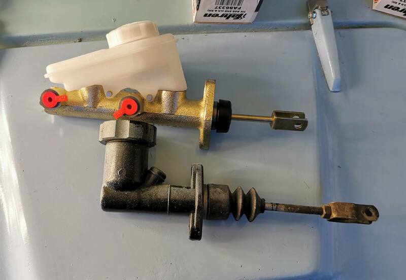

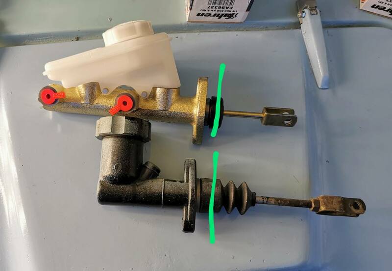

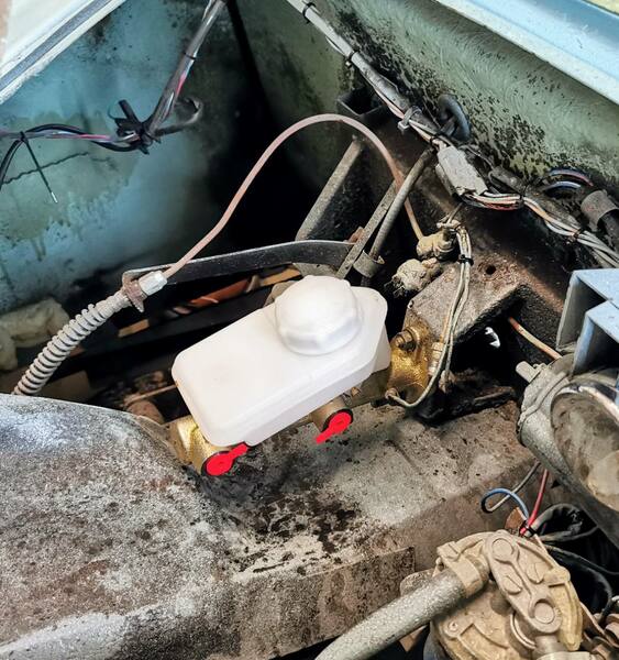

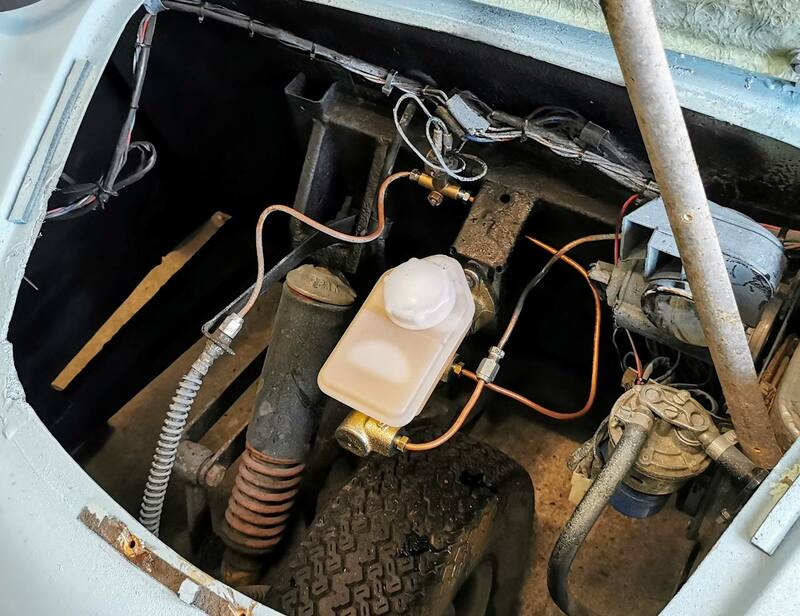

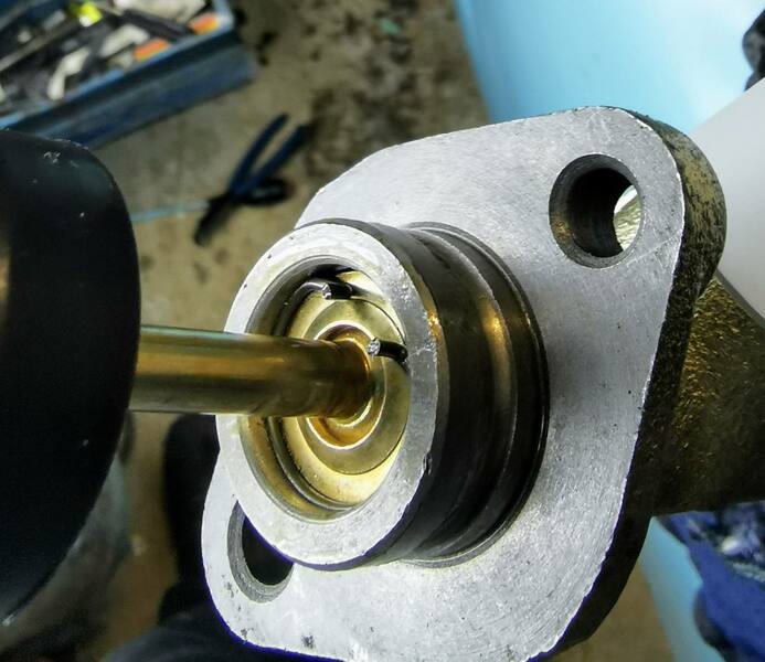

At that point I was able to escape to the garage for an hour to start getting the brake upgrade on the Invacar installed.
There's just a *bit* of a difference in size between them!
The mounting points are identical though as we hoped, though I obviously needed to swap the pushrod over, was expecting that though.  Is a simple enough job, it's just held in place by a circlip...the removal of which was made slightly more awkward as this happened to my circlip pliers the moment I tried to use them.

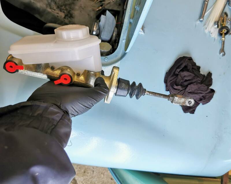

Yep... it's one of *those* days.  After about 15 minutes of swearing at it I eventually managed to ping it off my forehead into the footwell.

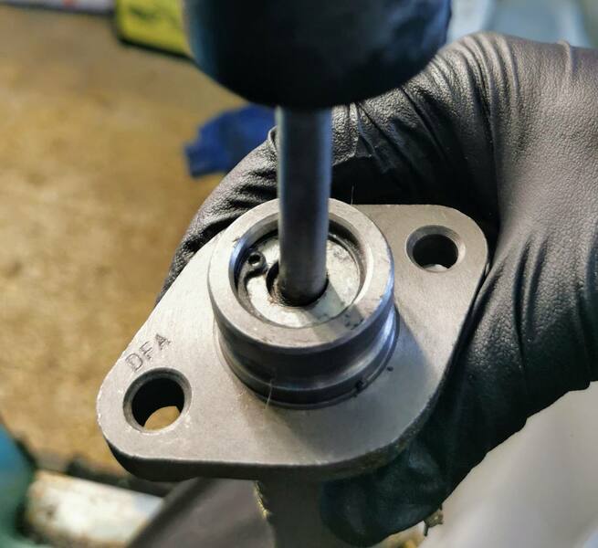

The new cylinder has a spring clip, so was easy enough to remove with a normal pair of pliers.
My *plan* had been to transfer this clip over as it would be far easier to manhandle into the groove...however I then discovered that the spring clip was too small to hold the washers of the old cylinder in...so I ended up having to wrangle the original flat circlip in.
Got there in the end.  One assembled cylinder ready to go on the car.
Having learned my lesson before, I made sure that the "fork" of the pushrod was around the handlebar home rather than off to one side.  It's a real faff to get this into place if the cylinder is already bolted in place if the pushrod isn't centralised properly.
Getting the roll pin back in is a pig of a job just because it's fiddly.  That's on the docket for tomorrow hopefully.

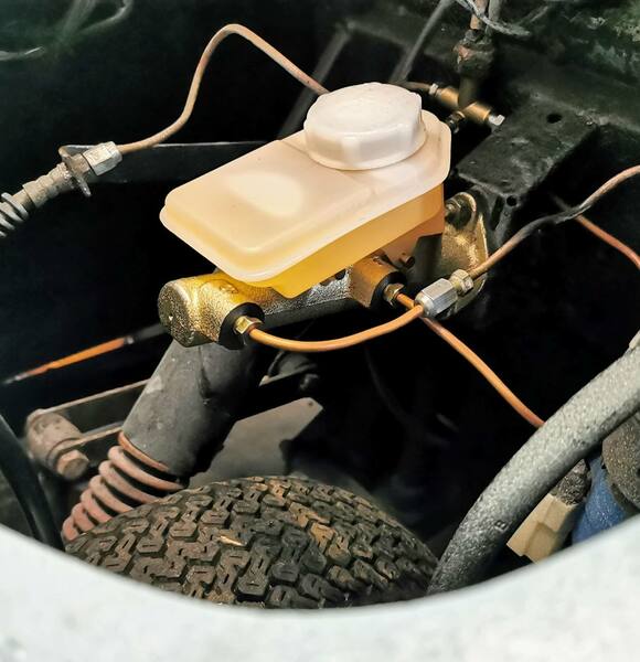

The cylinder is actually in place now though.
I can't actually finish the installation yet because I completely failed to realise I needed to buy one additional part in.  The current setup has the line from the master cylinder coming straight into a 4-way splitter block.  From there it splits the hydraulic line to the front and rear of the car, with the brake light switch screwed into the fourth port.  Of course there will be one less line there because there's a separate port on the master cylinder for each circuit.
I should have realised that before I even ordered the cylinder...bit annoying as I'll need to wait for that to arrive.  Sadly I'm pretty sure I don't have one in stock given the lengths I went to to save the rear axle T on TPA.  I'd not have spent hours salvaging that if I had a spare!  Annoying.
The reservoir is meant to be at a slightly steeper angle than it is on this car but that won't be a problem at all in use as the cap is at the highest point and it's only a very slight tilt.
In the meantime I will get the rest of the plumbing done and will take the opportunity to pull the mud guard out and attack it with a large hammer to beat it back into something resembling the right shape.  I suspect I may need to attack the bolts with the grinder as they're pretty crusty.  While in the area I'll get the foam finally installed under the fuel tank upper strap and get rid of the folded up Amazon box which has been in there for a year.

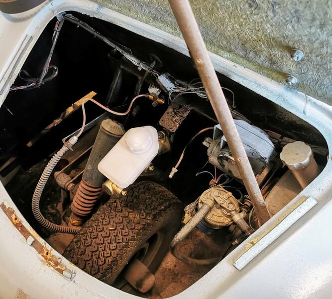

Speaking of minor things I need to sort up front...can someone provide a photo of how the bonnet stay is actually meant to be set up?  I'm sure I can fabricate something without needing to raid the spares stash there, just need to know how it's meant to be set up to start with.  Propping the thing open with your shoulder while refuelling is really awkward!
here you go :)
the rod then goes up and locates into a right angle bracket with a hole in it in thats attached to the front bonnet itself  (I know I have better photos but ill have to check for those when im on the main desktop)
we think it might of originally rested in front latch, but it obviously cannot do so with the later larger plastic brake fluid container so the one in REV has for the past 20+ years, merrily been wearing a divot/hole for itself in the fibreglass lip that it rests in when its put off to one side to clear the brake fluid container
one thing to note is that the front bonnet stay and its associated gubbins are only mentioned in reference to Model 70 Mark B's so I dont think the Model 70 Mark A ever had a front bonnet stay to start with hence the lack of one on TPA (I dont see the hole for it in TPA's chassis which backs that up)

Regarding the bonnet stay - I should have been clearer.  It's a detail of how it props the cover up that I'm after.  The base of the stay in my case is located in the hole at the top of the brake master cylinder bracket, basically because I couldn't see anywhere else for it to live.
I figured there must be a bracket of some description attached to one of the bonnet hinges given there's no other hardware attached to it!
ah whoops here you go
looks like it does attach via the bonnet hinge as you say
26863473_147860635918139_889450545469718528_n.thumb.jpg.9b56935415e9c4ba32caa5ce2680554b.jpg
and here is how it rests in most cars due to the plastic brake reservoir but we think it may have gone straight ahead originally

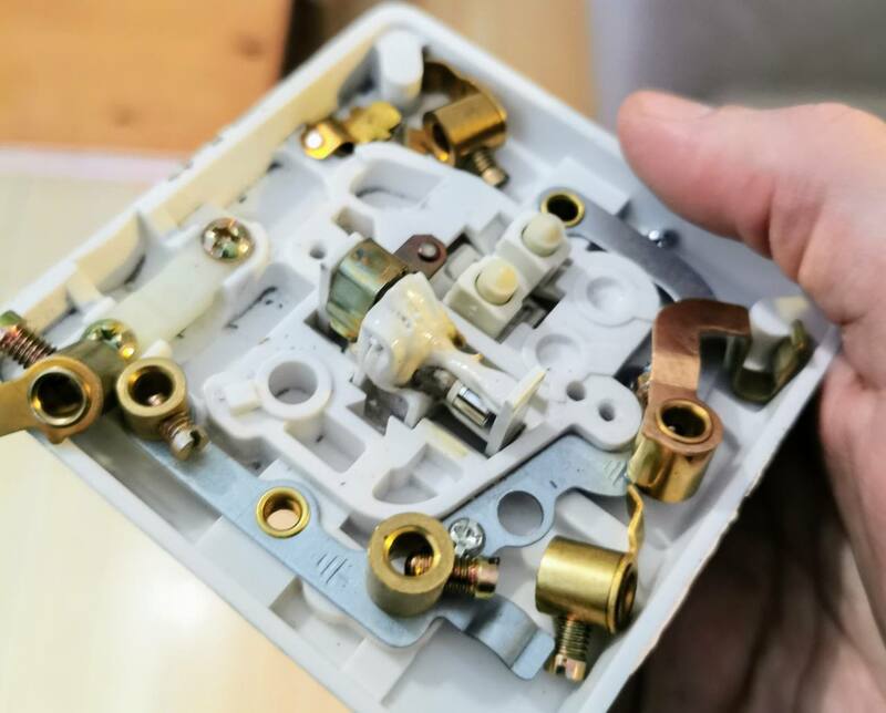

Very little time today for the cars thanks to getting a call from a friend right as I was about to step into the garage saying they'd lost all power to their garage (which contains their washer and drier) but the breaker hadn't tripped.  We are their support bubble so at least I can go there without fear of repercussions.
Didn't take long to track down the issue.  After exiting the fuse box, the feed to the garage enters a junction box where one line disappears to serve a single socket in their hallway, then via a fused switch to the garage.  This is what was left of the fuse holder in said switch.
Six years of running at close to the rated load when both the washer and drier are on has resulted in it overheating.  They are planning on having the whole house refurbished this year, which will include the wiring being completely gutted and replaced properly as this was just the latest in a line of *many* electrical issues or oddities they're dealing with.  Couldn't find anything else amiss so reckon as the fuse or holder has aged there has just been a poor connection resulting in a hot spot which eventually resulted in it self destructing.  Switch replaced like-for-like (albeit with a decent one rather than that which didn't have a maker's mark...or any markings for that matter anywhere) and they have been advised to avoid running both appliances together if possible.  The advise has also been left that they really need to get the cable replaced with one of a known quantity and that switch to be deleted.

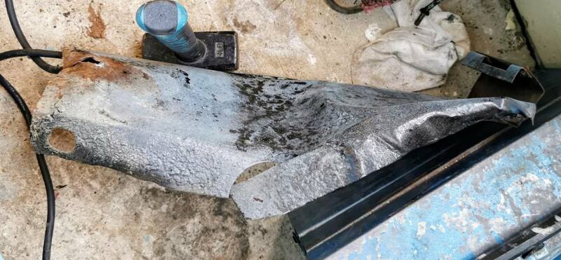

This only left me with half an hour really once I got home to spend in the garage.  Task I figured I could get done in that time was to get the front mudguard off TPA.

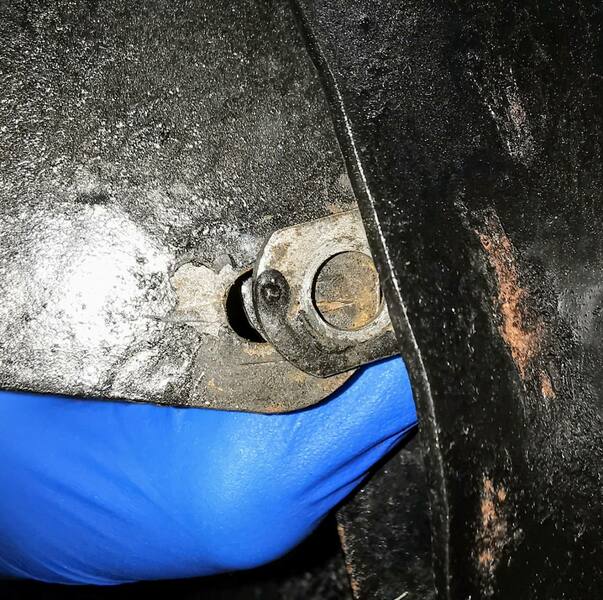

As expected all three fixings were utterly knackered.  The front two are through the nose of the car so some care needs to be used with power tools...
There was no way these were coming off, both the heads and the nuts were mangled.  The angle grinder really isn't suitable for this job... it's just too much of a blunt instrument.
Step forward the multi-tool.  This is a scalpel compared to the angle grinder.
This allowed me to buzz the heads off both bolts without any trauma to the surrounding bodywork.
The bolt under the brake master cylinder bracket was a bit more of a pain but we got there in the end.  I did actually end up tearing a bit of metal out from around the bolt, but it'll be a simple repair.
This thing needs some help...
It *should* be a straight U shaped channel!
I reckon a bit of attention with a large hammer and a big block of wood as a former should get it back into a shape more reminiscent of what it should be.  Doesn't need to be perfect.
Looks like the bed liner I've got will cover well, consistency seems very similar to the original coating on some areas of the chassis.
Will pull the cylinder out again so I can get the bracket without having to faff around masking stuff off.  The wiring has already been painted once so I'm not losing sleep over that!

In my case it was a laptop with a no power issue we were looking for.  I was going to check there was power at the kettle lead, having forgotten the lead was still in the 20A socket.
Cue loud bang, bright purple plasma flash...and the house plunging into darkness.
Oops.
The HRC fuse in the meter survived.  The 5A fuse in the plug survived.  The *flex itself* did not!  Both live and neutral conductors went open!  The meter probes are somewhat scarred though.

Finally got hold of the last couple of bits I'd been waiting on to allow me to proceed with the brake system upgrade on the Invacar.

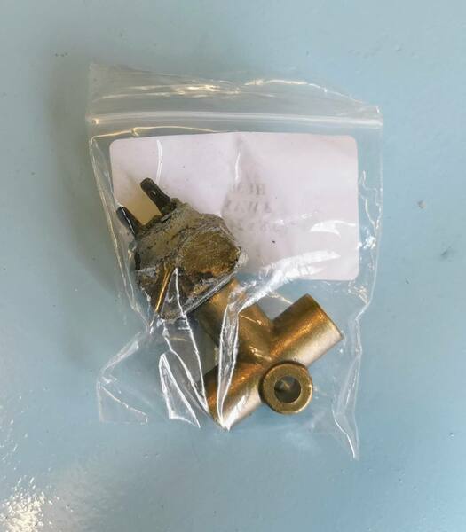

Metric unions are needed because the master cylinder is metric, and the T is a replacement so I can replace the 4-way one the brake light switch is currently fitted to.
The switch was removed from the car and stored safely in the bag with the union it will be living in from now on while I removed the old T piece.
That's now been loosely refitted to the stud the T-piece lives on.
This has then allowed me to have a think about how I'll be routing the lines, shouldn't require too much plumbing.  The line to the rear will be getting extended the couple of inches needed to reach the cylinder.  I did think about remaking the whole line to avoid the need for a join...but the run is a single piece all the way to the T at the rear axle and routing it would require me to remove the fuel tank.  It's getting extended!
Shouldn't take long to get things in here hooked up.

Now we're getting somewhere.
Front circuit is bled through, rear will have to wait till tomorrow.  Everything seems fluid tight though.
Have encountered one slight snag though.  I may need to source a longer pushrod for the master cylinder.
The handlebars are resting essentially depressed by a couple of inches.  There is a bit of adjustment in the pushrod, but I doubt enough to fix this.  We'll see tomorrow once I've got everything bled, nipped up all the joints a bit more and see how much I can extend it by.
Should have spotted that when I had the two cylinders next to each other.  The Invacar one has the base of the cylinder recessed further beyond the mounting bracket than the Spitfire one...so the rest position of the piston is about 3/4" further forward.
Hopefully that's not too much of a headache to figure out.
Edit: Thought occurs to me that I may be able to get myself a bit of extra room to play with by drilling an additional hole in the yoke - there are already three or four (I assume for different setups) so one more won't make any difference... between that and the adjustment on the pushrod I *might* be able to make this work.

Hope the pipe to the front brake from the light switch union is not too tight a bend, mine was (pic on RR) and it leaked slightly and had to have it replaced with a longer pipe with a larger radius bend. With yours, I would have taken the pipe behind the speedo cable to make a larger bend.  (Actually, it turned out the through bolt was the wrong size as well, previous owner again!)
Link to comment
I wonder if Zel has it curved/S bent like that on purpose to take up thermal expansion and contraction?
Link to comment

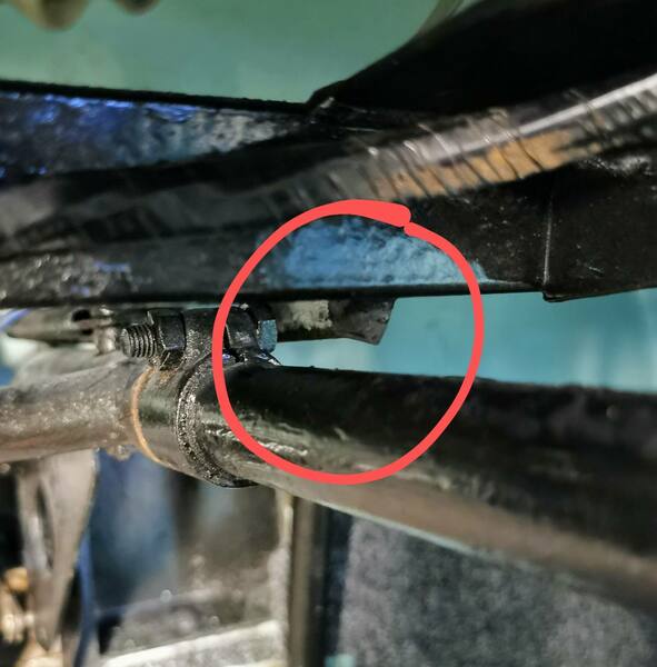

Thinking about it, I'd rather shorten that front line anyway.  That way I could clip it to the support and reduce the odds of it vibrating.
Few steps forward today.
Had a closer look to see how far out we were on the pushrod clearance issue.  Not very much is the answer.  This also really highlights the mechanical advantage in the handlebar setup.  This equates to a little over 3" of travel at the bars.
With the adjuster backed as far off as I can without worrying about the nut backing off and coming loose (which would be bad), I was able to reduce the offset to this.  The thing I've circled is the little rubber stop the handlebars usually rest on.
For reference, here's the same clearance at the same spot yesterday.
The loss of that bit of travel probably isn't the end of the world (keep in mind this cylinder has a slightly larger bore, so will require slightly less travel but be heavier to operate).  That's plan C at this point.  I don't like the fact that the return spring tension on the 'bars is resting on the pushrod, as that means any failure of the adjuster locknut or the pushrod retaining circlip on the master cylinder will result in the pushrod ejecting itself from the braking mechanism.  This Would Be Bad.
Plan A is to pull the yoke out and drill a new pivot hole slightly above and forward of the existing one.  Couple of reasons I prefer this.
[] Firstly is that it removes the aforementioned situation where it's not entirely beyond the realms of possibility that the master cylinder could spontaneously disassemble itself at 70mph on the sliproad coming off the A5.  The resting position of the handlebars will keep everything under (light) compression.  If the adjuster backs itself off you'll notice the brakes feeling sloppy and hear it rattling long before anything comes apart.
[] Secondly, shifting the pivot point slightly higher thanks to the geometry of the linkage will increase the mechanical advantage provided, so make the brakes lighter - providing an offset for the slightly larger bore cylinder.  I'll be taking some careful measurements beforehand to make sure I've still got enough clearance to get a full usable stroke and that the pushrod isn't going to get pushed at too much of an angle.  Stroke measurement is something I need to be particularly careful of too given that my knees are closer to the bars than in a standard car due to the upgraded seat.  No, there's no way in hell I'm changing that back...I like being comfy!
I'm going to do some testing with the setup as it is now though.  Given that this is all very experimental it's entirely possible that I'll find that this cylinder just doesn't work...I wind up with impossibly grabby brakes, or it's like trying to brake a 1920s bus with cable brakes because they're so heavy.  Might need to mess around with an adjustable bias valve to prevent the front wheel locking up...I just don't know at this point.  I'd rather know the system is fundamentally sound before I go modifying things permanently.  Plus I know that getting the handlebars out is going to be an absolute pig of a job.

Just remembered something else too.  On another forum someone had mentioned that it looked like there was a worrying lack of clearance between the front wheel and the brake master cylinder.  They're right, in a lot of photos it does look quite close.  That's more down to a bit of an optical illusion though just how things line up.  Trying to get a photo from a lower angle (tricky with the body in the way!) shows there's a decent gap.
Really shouldn't be any worries of these making contact.  Especially given how little weight there is on the front, even under heavy braking the nose doesn't dive much.  Glad they asked the question though as it's the sort of thing which could well have been an issue with the new cylinder being so much longer.
Glad someone else thought this, was going to say, and then felt it might be a stupid question.
Enjoying the ongoing re-engineering project that's going on here.
My opinion is that there's no such thing as a stupid question.  Especially where the answer may affect something that's safety critical.
There are a LOT of questions which I've asked during my first year of ownership that I'm sure a lot of people on the marque specific forums for the Jag would have said were stupid based on the experiences of my old flatmate with his XJ6s.  That's one of the reasons I prefer this place...folks will generally give you a reasonable answer - even if the answer needs to be nothing more than a photograph from a different angle.  Being condescending never helped anyone...one of the reasons my time on a couple of VW forums when I had my T25 was very brief!
