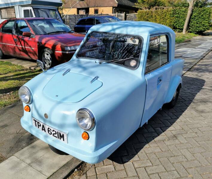

Zelandeth Posted April 1, 2021 Author Share Posted April 1, 2021 1 minute ago, R1152 said: And hasn't TPA progressed well from being a "spares car" - putting TWC to shame. Wouldn't go that far! Luck has played a huge part. I've had a pretty smooth road mechanically so far. Only major headache I had was the wheel stud fiasco, so far anyway. Don't overestimate my bodywork...the photos flatter it greatly! Link to comment Share on other sites More sharing options...
R1152 Posted April 1, 2021 Share Posted April 1, 2021 10 minutes ago, Zelandeth said: Wouldn't go that far! Luck has played a huge part. I've had a pretty smooth road mechanically so far. Only major headache I had was the wheel stud fiasco, so far anyway. Don't overestimate my bodywork...the photos flatter it greatly! As I remember it though, the engine cover was in two halves and there was much breakage of the aprons, which you seem to have sorted out. The fact you're talking about taking moulds off other cars for these suggests you want to improve TPA even further. I looked at TWC the other day when DW took the 2CV's bonnet off it (😧) and the paint on TWC really does look poor. I have to say here in AudiLexusBMW Street, I'd love one of these but they do seem to have become very fashionable, and with that, expensive. In some ways, I wish I'd bought that battery Argson but truth is, I'm broke - nine months in the last twelve with no work and being self-employed does that to you, but at least the accounts will be a piece of piss to prepare this year. CaptainBoom 1 Link to comment Share on other sites More sharing options...

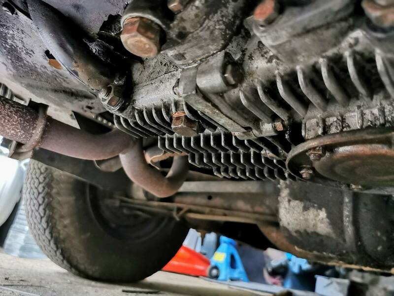

Zelandeth Posted April 2, 2021 Author Share Posted April 2, 2021 Out and about today. No photos sadly as I was running late and had to just about double the route length due to me having not realised things were closed (the fact this is Good Friday had completely passed me by, as my brain still thinks it's March 374th 2020. Glad to report that the sump plug does indeed now appear to be oil tight. Though we definitely do have a weep from the diff on the offside, so I'll need to look into changing the driveshaft seal at some point. It doesn't seem to be enough to show on the level, just enough to make a horrible mess. Level has never visibly dropped between checks. But it doesn't take much to make a huge mess. Given the state of the outside of the diff casing I'm guessing it's probably been like this for decades! timolloyd, RichardK, LightBulbFun and 1 other 4 Link to comment Share on other sites More sharing options...

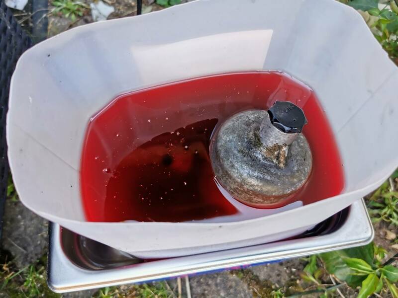

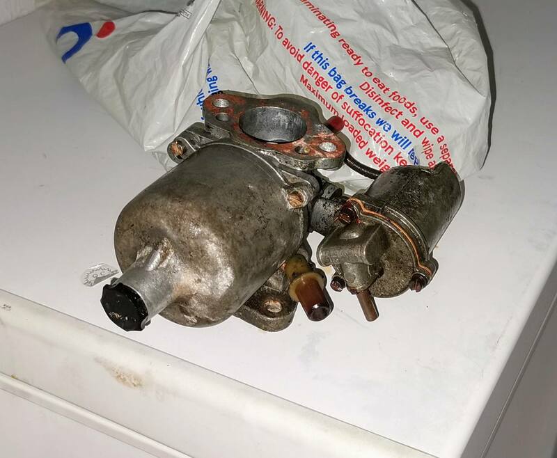

Zelandeth Posted April 4, 2021 Author Share Posted April 4, 2021 First job for today was finally get the carb that was dropped off by @Six-cylinder FAR too long ago into the ultrasonic cleaner. Biggest headache I'd had here was that the room it lives in is currently being used as an office for just about every waking moment, and it was sufficiently buried that it took a bit of time to excavate - so I had to wait until I had access to the room when there weren't confidential meetings in progress. I'm actually quite surprised how disgusting that the inside of this carb doesn't look given the state of the outside, though there was *some* debris in the float chamber. I can't get the top off the dashpot - someone has already had a good shot at rounding off the heads of the screws and I could feel the screwdriver trying to slip when I was trying to undo them, so I just decided to leave that well alone. Peering in there with a torch it doesn't look bad. Last thing I wanted to do was totally wreck the screws. At least I was able to dismantle it far enough to be able to blow through everywhere relevant as well, so it should be serviceable once it's out of the cleaner. Not actually much to one of these compared to a downdraught carb. Still think they're a clever design. Next job of the day was changing the oil filter on the Jag which I was unable to get off when it got an oil change a few days ago. Quite HOW I managed to get it removed last time before buying one of these I have absolutely no idea. The issue you have is that you only have access to the bottom few millimetres of the filter casing - for a start you can't even see it. Secondly you're hard up against the nearside exhaust on one side, and it sits about 1/2" away from the side of the gearbox bell housing on the other so you really can't get your hand on it, and there's no room to get a strap wrench in. Thinking the rear silencers may well go back on the Jag. It's the front ones which probably need altered to really release the full V12 bowl - whereas the deletion of the rear ones (which are just deresonators) does sound nice at high RPM and low idle - the boominess at 1100-1500rpm can get tiresome. Especially in 30mph zones. Last thing I did today was to address some remedial bodywork on the rear of TPA. I'd had issues with a crack appearing to the left of the engine cover, which was basically because I'd done an appalling job of getting the new glass fibre I had laid down to adhere to the underlying bodywork. Hopefully I've done a better job this time. I've also managed to get a lot smoother finish than I did last time - basically because I decided to ditch the applicator and form it by hand (wearing gloves obviously). This was WAY easier. I also used the excess left over to smooth over some of the horribly rough bits on the other side (this is where I started out rebuilding the rear apron so is where the fabrication was at its roughest). Chuck a bit of paint on there after I've hit it with some sandpaper to knock off any high spots and it should look better I think. Still rough as the North Sea in a hurricane, but better than it was. Mrs6C, Six-cylinder, Floatylight and 1 other 4 Link to comment Share on other sites More sharing options...

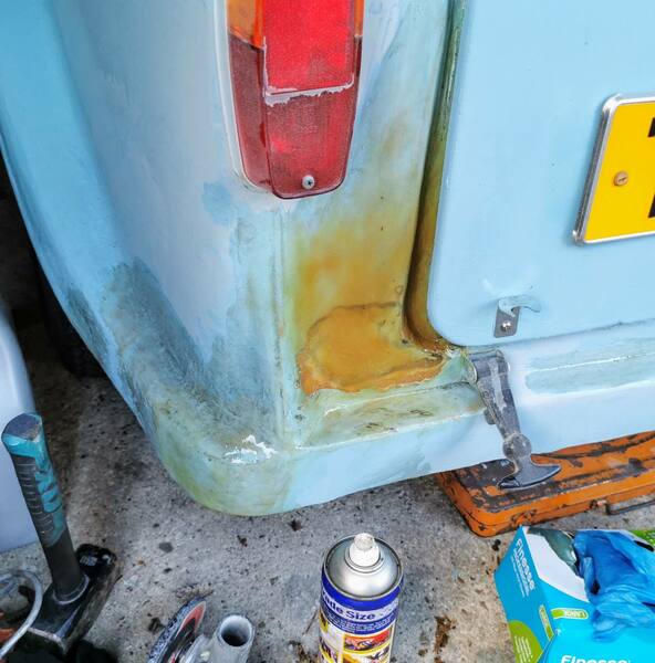

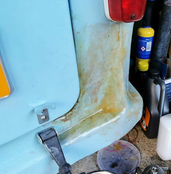

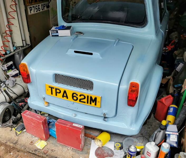

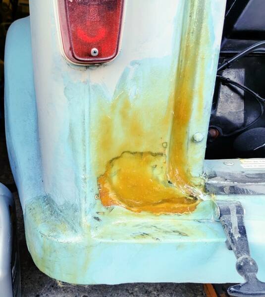

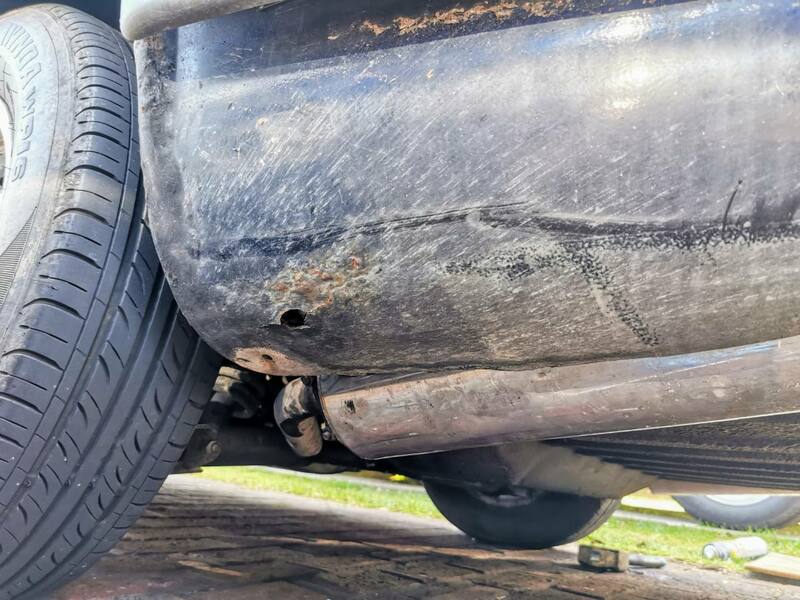

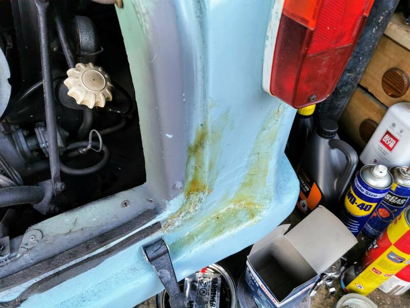

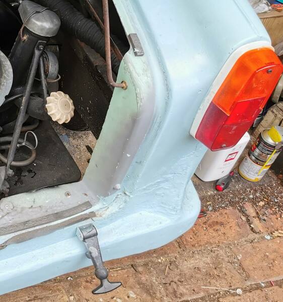

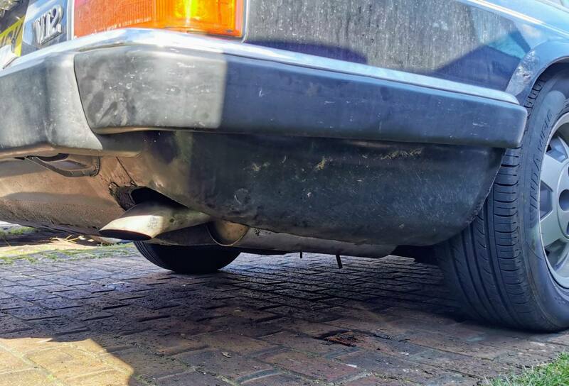

Zelandeth Posted April 5, 2021 Author Share Posted April 5, 2021 Some additional fibreglass and several coats of resin applied to the back of TPA. Bit of sanding obviously needed and it's never going to be (even close to) perfect, but should definitely be an improvement. Did a bit of work on the Jag too. See the difference? Yep, rear silencers are back on. Definitely preferable...I must be getting older! Would prefer a bit more of an exhaust note, but for now I'll take refinement as a win. I just had to poke this rust scab didn't I? Guess I'll be getting the welder out soon then. I'll probably cut out more than I really need to, as hiding the seam under the bumper will be far easier than trying to flat my welds back to the point they're invisible! Plus this colour will be a pig to match. Mrs6C, Broadsword, BlankFrank and 1 other 4 Link to comment Share on other sites More sharing options...

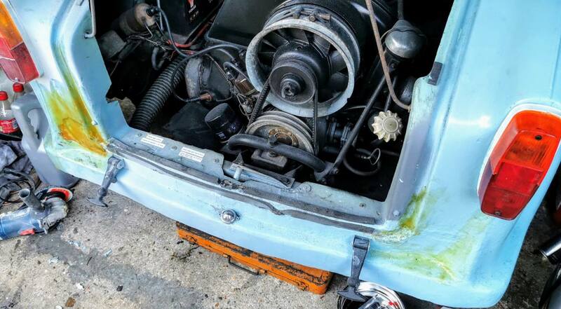

R1152 Posted April 5, 2021 Share Posted April 5, 2021 Any particular reason you have those engine cover catches on TPA rather than the traditional keyed one? Link to comment Share on other sites More sharing options...
LightBulbFun Posted April 5, 2021 Share Posted April 5, 2021 11 minutes ago, Zelandeth said: and it's never going to be (even close to) perfect dont worry there will always be far worse Model 70 rear ends out there! At least yours is Made of fibreglass and is blue! Link to comment Share on other sites More sharing options...
PhilA Posted April 5, 2021 Share Posted April 5, 2021 The phrase "good enough for government work" springs to mind. LightBulbFun and Talbot 1 1 Link to comment Share on other sites More sharing options...
R1152 Posted April 5, 2021 Share Posted April 5, 2021 1 hour ago, LightBulbFun said: dont worry there will always be far worse Model 70 rear ends out there! At least yours is Made of fibreglass and is blue! What's going on there? Link to comment Share on other sites More sharing options...
LightBulbFun Posted April 5, 2021 Share Posted April 5, 2021 2 minutes ago, R1152 said: What's going on there? I have no idea LOL I can ask the owner if you want me to Link to comment Share on other sites More sharing options...
Zelandeth Posted April 5, 2021 Author Share Posted April 5, 2021 1 hour ago, R1152 said: Any particular reason you have those engine cover catches on TPA rather than the traditional keyed one? The original lock mechanism is a solid block of rust and all the fasteners holding it in are hopelessly rounded off/corroded in place. Link to comment Share on other sites More sharing options...
R1152 Posted April 5, 2021 Share Posted April 5, 2021 5 minutes ago, Zelandeth said: The original lock mechanism is a solid block of rust and all the fasteners holding it in are hopelessly rounded off/corroded in place. Yes, I can see how that might be a problem. Link to comment Share on other sites More sharing options...
Zelandeth Posted April 7, 2021 Author Share Posted April 7, 2021 Did a bit of sanding back today...and after about half an hour remembered precisely how little patience I have for that sort of thing and how much my back (which I'd already hacked off during the tip run earlier) hates it. So quickly got to a stage of "Sod it, that's good enough, throw some paint on it." Which I didn't realise quite how much had actually improved things until I looked at a couple of older photos. Particularly under the offside tail light. It'll do for now! Car has been in the garage without moving for long enough now. Plus I'm still planning somewhere down the line to A: Hopefully get some actual moulds made for the rear apron and B: Chuck it at a body shop to have a few things sorted out more professionally. So I'm not spending too long on this - dealing with the crack I'd had issues with on the nearside and keeping the car presentable from 30 paces is good enough for me. mk2_craig, LightBulbFun, egg and 6 others 9 Link to comment Share on other sites More sharing options...

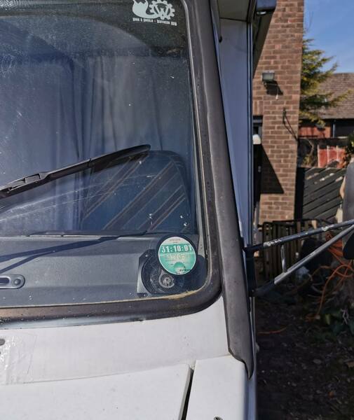

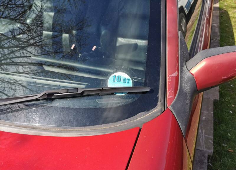

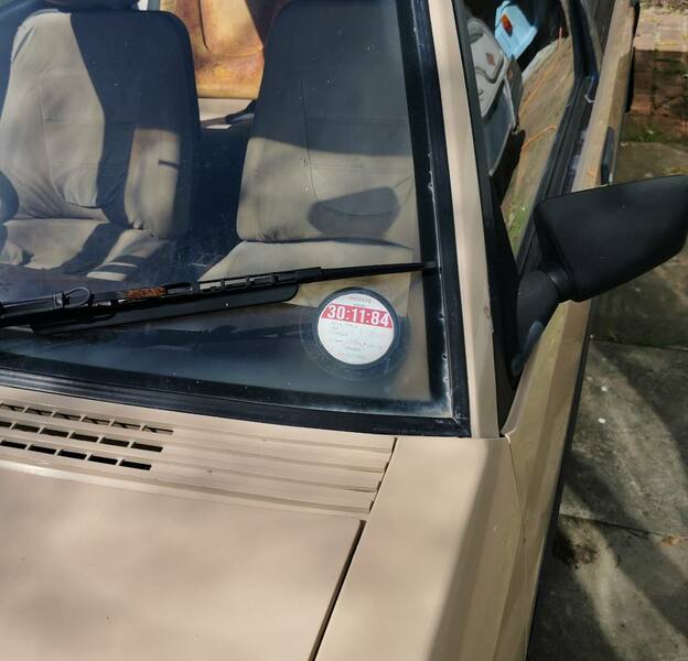

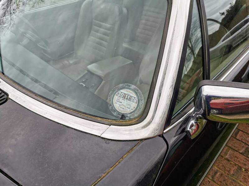

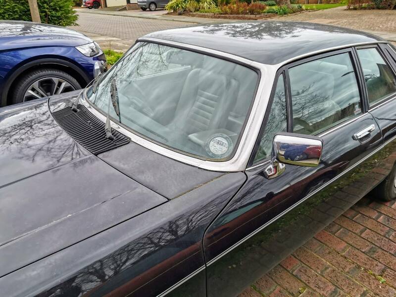

Zelandeth Posted April 14, 2021 Author Share Posted April 14, 2021 Someone was out and about again today. Now proudly displaying her replica tax disc. Ended up doing something I haven't in years. After I was done with the errands I had to run, I just picked a road and decided to see where it went. Was probably out for a couple of hours. That says a lot I think about how I've started to build some proper confidence in this car - and enjoying driving her. Observations: 10" wheels and quite firm suspension aren't great with the condition a lot of roads round here are in. The fact there are quite so many crashes and rattles from the bodywork and doors I think makes it seem worse than it is because of the noise. It's not actually too jarring and the seat helps provide a decent amount of isolation too. Really want to move on getting the roof lined as I think that will help with the racket. She's far more at home on A roads than B roads funnily enough. A roads tend to have more sweeping curves with better sight lines so it's easier to carry speed through corners. B roads don't afford the same opportunities (at least the one I was on today...doubly as it's not a road I know) so I was finding myself wishing I had a couple of BHP more on a couple of occasions, and did pull in to let the queue behind me pass at a couple of points. Activa is the car for roads like that. Still won't impact me driving the car though, and is useful experience to gain. Was a really good workout for the brakes too...so I can now say that brake fade doesn't seem to be an issue, as I was working them pretty hard at a few points! We're still leaking a bit of oil though I spotted when I came to put her back into the garage a few hours later. Not a huge amount, just two single drips it looks like. However that's two drips too many for my liking. I need to do a bit more detective work first but it looks like the culprit is the crankshaft oil seal. Which would suck as I'm pretty certain changing that will be an engine out job as I think the whole rear engine mount assembly will have to come off to get an impact driver onto it. I'll get a set of seals ordered anyway so they're in stock whenever I need them. If I do end up doing that I'll basically just replace every oil seal on the outside of the engine while it's out. I'm not *too* worried about it at this point...I just want to keep an eye on it. With so little oil in the sump leaks are something not to be taken lightly though. If it is just a couple of drips when we stop I'm not going to panic though. Apparently it's catching too... Problem is there's an under tray in the way there...so it could be engine oil or LHM. Don't think it's coolant. I'll need to investigate it. There definitely is an oil leak we need to deal with though as the sump in general looks quite wet. In addition to the replica tax disc in TPA, the rest of the fleet now have them too, courtesy of Cort16 over here. Nice touch I think, and the sort of detail I've found that at shows can help as a conversation starter for folks who might be a bit self conscious about asking questions and such. Plus it just looks odd to me not having a disc in the window! I do enjoy the ridiculous variety I see looking out of the south facing upstairs bedroom windows. beko1987, mercedade, egg and 7 others 10 Link to comment Share on other sites More sharing options...

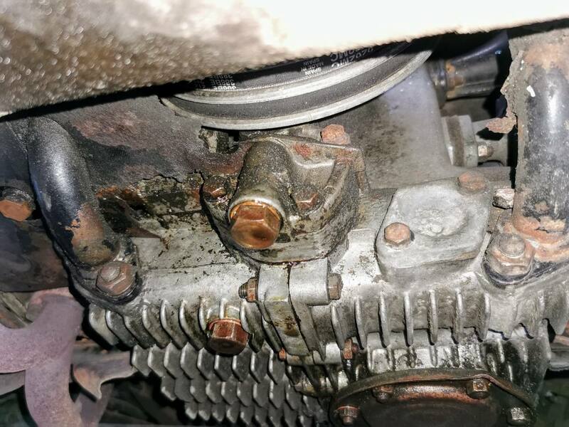

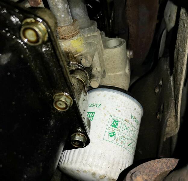

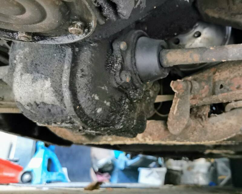

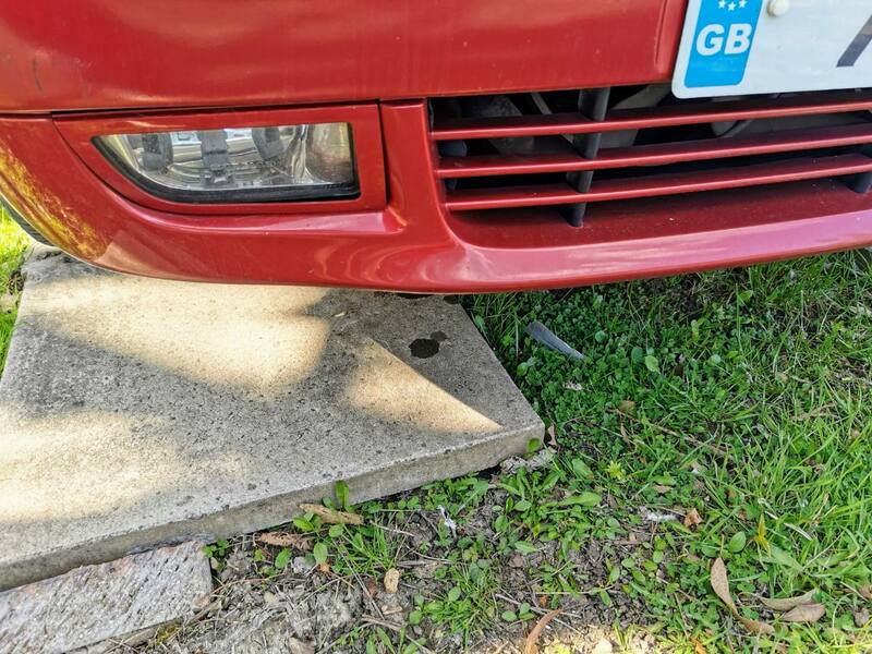

Zelandeth Posted April 14, 2021 Author Share Posted April 14, 2021 Well let's monitor the Invacar oil leak now I've resolved this. Dumb mechanic error. Guessing I forgot to thread the dipstick in to take the reading. Let's see if this has sorted it next time we're out. Only real car job was to finish sorting the wipers on the Jag. When I sorted out the intermittent motor back last year I never really put any effort into getting the wiper alignment right and had broken the non return valve for the windscreen washers. Both of these issues were resolved today, so the wipers now park in the correct spot again, so only a quarter of the way rather than halfway up the windscreen. Replaced the wiper blades too as the ones on there looked horrible. They went rusty pretty much the day they were fitted. Last job was to realign the washer jets as the driver's side one washed the scuttle and the passenger side one was pointing skywards. Much better. Granted that's one item of about 700 on the to do list ticked off...but it's something at least! Broadsword, LightBulbFun, PhilA and 4 others 7 Link to comment Share on other sites More sharing options...

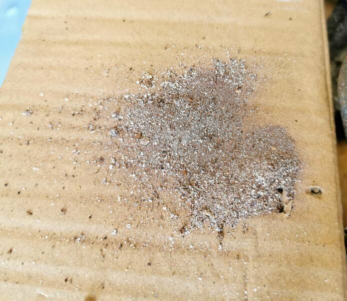

Zelandeth Posted April 16, 2021 Author Share Posted April 16, 2021 Finally got back to round 2 of cleaning the carb which has been with me for far too long. Internally it wasn't really too bad save for a bunch of scale in the float bowl. Inlet manifold is now getting the same treatment then should be able to get it returned to its home. Weather forecast is looking dry for more than five minutes, so dropped the carpets back in the Jag, which makes the car a thousand times more pleasant to travel in. Thankfully my usual motor factors have finally reopened their retail counter so I was able to pick up a bunch of brake cleaner (I go through it like water so just get 12 can boxes from them) and the oil and filter for the Xantia which is quite overdue an oil change. Speaking of the Xantia, a friend dropped these off yesterday afternoon which I'll hopefully get fitted at the weekend. That's a pair of NOS spheres. Will be nice to have more than an inch of rear suspension travel again. Broadsword, Mrs6C, LightBulbFun and 1 other 4 Link to comment Share on other sites More sharing options...
