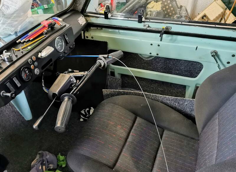

MT606 Posted March 10, 2021 Share Posted March 10, 2021 aye, I know the rubber grips are slightly different sizes but I meant with regards to the bar ends like in the photos. Link to comment Share on other sites More sharing options...
Zelandeth Posted March 10, 2021 Author Share Posted March 10, 2021 I think the outer end of the grip is *slightly* proud of the end of the bar, as the position is dictated by the bend towards the centre, as obviously I need the whole thing fitted on the straight portion of the bar. Never really looked to be honest and with the rubber sleeve on it's hard to tell now really. MT606 1 Link to comment Share on other sites More sharing options...
Zelandeth Posted March 10, 2021 Author Share Posted March 10, 2021 (edited) Package arrived this morning to allow me to finally hopefully properly sort the throttle cable on TPA. I know I probably still have a load of cable somewhere in the garage...but this was all of £0.88 a metre so I wasn't going to lose sleep over trying to find it. The important bit is the cable end being the right size to fit the twist grip. Which is one of these. I fed the cable through from the cabin end as I've always found it behaves better doing it that way. Then trimmed the cable once it was attached to the cable end. Then basically just put things back together before securing it and trimming the excess at the carb end. For the first time I have a throttle which is bodge free and has a nice smooth action through the full range. Nice. While I was in the garage I tackled something else I'd been meaning to do for a while - finding somewhere out of the way to stash a spare CVT belt. That will do nicely. Despite what it looks like in the photo it's sitting clear of the brake lines to frame right, it's resting on top of the master cylinder at the rear. I'll be finding a spare 17mm spanner shortly and leaving that attached to the belt, meaning I'll have everything I need to change a belt at the side of the road if I ever have one fail out of the blue again. Not really expecting it as I'm sure that was down to me using an ancient belt that had been poorly stored, but it's an easy eventuality to prepare for so just seems smart. Edited March 10, 2021 by Zelandeth Corrected Autocorrect LightBulbFun, egg, mercedade and 13 others 16 Link to comment Share on other sites More sharing options...

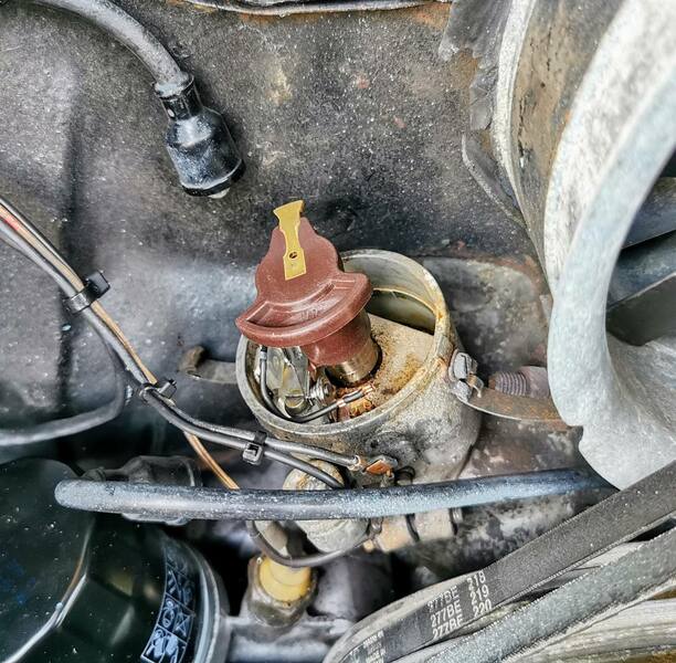

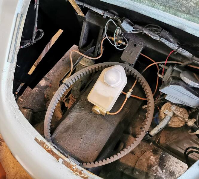

Zelandeth Posted March 11, 2021 Author Share Posted March 11, 2021 Had a chance to throw some more of the service items onto TPA today. New set of points fitted. These and the rotor arm were still the parts fitted when KPL was originally dragged out of the field goodness only knows how many years ago! As the ignition system just worked when I first got KPL I just left the system alone at the time. The contact pads on the old points looked like this: New rotor arm fitted. This is a bit taller than the original one, which judging from the wear pattern was only contacting the very lower edge of the contacts in the distributor cap. New distributor cap (the correct one did eventually escape customs!) and air filter were also fitted. The air filter has only done a thousand miles but has been on the car through all the painting etc so I figured could probably do with changing. Only the best OEM parts of course! I haven't had a chance to go out for a drive anywhere yet, but it's definitely noticeable how much smoother the idle is. Really do need to adjust the fan/dynastart belt tension though - just need to figure out where in my disaster area of a garage the impact gun has got to as everything else I've tried to get the nut on the cooling fan free has failed. Think the next project in that engine bay though will sorting out a proper battery clamp. The bungee and zip-tie solution was fine when TPA was primarily held together by duct tape and hope, but those days are past us now and it's seriously bugging me now! BlankFrank, GrumpiusMaximus, Six-cylinder and 8 others 11 Link to comment Share on other sites More sharing options...

R1152 Posted March 11, 2021 Share Posted March 11, 2021 Where do you get your condensers from, Zel? I ask because a mate of mine seems to have perpetual trouble with his Minor pickup eating the things. Of course, we're not entirely convinced that somehow he's put a 6V coil on it, but... Link to comment Share on other sites More sharing options...
Zelandeth Posted March 11, 2021 Author Share Posted March 11, 2021 12 minutes ago, R1152 said: Where do you get your condensers from, Zel? I ask because a mate of mine seems to have perpetual trouble with his Minor pickup eating the things. Of course, we're not entirely convinced that somehow he's put a 6V coil on it, but... I've given up on automotive ones. I've fitted proper 1000V rated polypropylene film ones here - too big to fit on the distributor itself, so they're now in a remote enclosure mounted over by the coil. I didn't have any 0.22uF caps in stock so just paired up two 0.1uF ones...as I had figured out I was mounting them remotely by that point the size wasn't an issue. Inside the enclosure I used (I took the opportunity as I had room to spare to add a remote engine start switch as it's sometimes handy). The caps themselves are from RS Components - I use these a bunch in vintage tech restoration as the high voltage rating makes them an ideal replacement for the old wax-paper caps in valve radios, TVs etc. 31 minutes ago, barrett said: Hey @Zelandeth I am currently working on organising a Very Special Present for one of your cars. Where abouts in the country are you based?? I am intrigued...Based in Milton Keynes. R1152, LightBulbFun, Spurious and 1 other 4 Link to comment Share on other sites More sharing options...

GeorgeB Posted March 11, 2021 Share Posted March 11, 2021 4 hours ago, Zelandeth said: Really do need to adjust the fan/dynastart belt tension though - just need to figure out where in my disaster area of a garage the impact gun has got to as everything else I've tried to get the nut on the cooling fan free has failed. It's not a left hand thread is it? Link to comment Share on other sites More sharing options...
R1152 Posted March 11, 2021 Share Posted March 11, 2021 34 minutes ago, Zelandeth said: I've given up on automotive ones. I've fitted proper 1000V rated polypropylene film ones here - too big to fit on the distributor itself, so they're now in a remote enclosure mounted over by the coil. I didn't have any 0.22uF caps in stock so just paired up two 0.1uF ones...as I had figured out I was mounting them remotely by that point the size wasn't an issue. Inside the enclosure I used (I took the opportunity as I had room to spare to add a remote engine start switch as it's sometimes handy). The caps themselves are from RS Components - I use these a bunch in vintage tech restoration as the high voltage rating makes them an ideal replacement for the old wax-paper caps in valve radios, TVs etc. Yes, I recognised them - and polypropylene dielectric is ideal for the steep rate of change (dV/dT) that they'll experience in an ignition system. I only use use them across output transformers and as tone controls from anode to earth in valve sets for that reason - polyester's fine for just ordinary coupling and decoupling purposes. Thing is, I got him some 0.22uF @ 1000V (and again, PP dielectric) for that Minor... and still he managed to kill them! LightBulbFun 1 Link to comment Share on other sites More sharing options...
Zelandeth Posted March 11, 2021 Author Share Posted March 11, 2021 29 minutes ago, GeorgeB said: It's not a left hand thread is it? Honestly can't remember! I did check that at the time though! KPL spent a long time without an engine cover on so things like that were quite badly rusted up. Which is another reason I *really* should get it apart so I can properly clean the pulleys themselves. My inner HVAC tech hates me for what that's probably doing to the belts. I'd never have been able to show my face again if I'd left a blower assembly running with pulleys in that state... 28 minutes ago, R1152 said: Yes, I recognised them - and polypropylene dielectric is ideal for the steep rate of change (dV/dT) that they'll experience in an ignition system. I only use use them across output transformers and as tone controls from anode to earth in valve sets for that reason - polyester's fine for just ordinary coupling and decoupling purposes. Thing is, I got him some 0.22uF @ 1000V (and again, PP dielectric) for that Minor... and still he managed to kill them! Goodness, managing to kill these caps takes some doing! Yeah, I'd think something must be far wrong there then. Should be easy enough to check if it's the wrong coil by checking the primary resistance - most (non-ballasted) 12V coils I've seen have been around an ohm or more...anything less than that I'd think would point to it either being a 6V or ballast type coil. I'm not an expert though! They're probably overkill for a lot of the applications I've used them in before, but I have to admit to slight component-stockage-laziness! Means I only need to have one and a half rows of capacitor drawers in the component shelf rather than a plethora of them...Plus they're about the same size as wax-paper caps so don't look too out of place (well, aside from being near neon yellow anyway). I really do need to do a restock though, getting low on them. Not that I've touched anything on the properly vintage tech side of things in a few years now... 1 hour ago, barrett said: Okay, leave it with me. It's something you will really, really appreciate (I hope)! I am very curious! Sure I will be exceedingly appreciative whenever whatever it is turns up... LightBulbFun and R1152 2 Link to comment Share on other sites More sharing options...

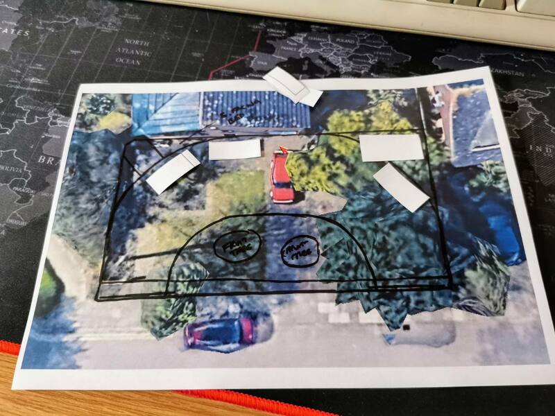

Zelandeth Posted March 17, 2021 Author Share Posted March 17, 2021 Was meant to be sorting the shed roof today...right up to the point where I wasted nearly two hours trying (and failing) to find a smegging claw hammer to remove the old nails with. There are two in this house, couldn't find either of them. Eventually gave in and ordered another one from Amazon. Fine, that's tomorrow's job. So turned back to the Beige Wonder to have a quick look to see if I could actually definitely see where the LHM leak was coming from. Step 1. Remove wheel. Yeah...that took about half an hour and eventually required a six foot breaker bar to crack off the wheel bolts. I'd hoped that I'd be able to clearly see where the leak was coming from, sadly not it seems. All I can see is a finely atomised LHM bouncing off the floor roughly directly above here. It's proven pretty much for certain it's on the axle to caliper line though rather than on the chassis side of things which was what I really wanted to know. Access to replace it is going to be fun, though hopefully the other end isn't too horrendous to get to. At least it gave me an opportunity to confirm that the back of the sill and boot floor over the wheel arch doesn't look bad. Previously has had welding done here, but it looks perfectly serviceable. Good clean and thorough dousing with Dinitrol should keep that fine for a good while. So not a big update yet. Next steps will be to get either a pre-made replacement line in or pipe and fittings to make one (not sure how doable that is with the fancy Citroen fittings), and find which boot I need for the steering rack. Once the brakes are sorted and that boot is changed I'll probably get her booked in for an MOT and see what we find. I know there's one small welding repair needed on the nearside sill but I'd rather confirm we don't need any other sparkly stick action so I can either get it all done in one hit, or farm it out depending on how things look. I'm no expert welder so if anything involved is needed I'll probably be looking to get someone else involved on that side of things. Also been looking at possible new driveway/front garden layouts. If we can make something like this work I'd be over the moon as I'd be able to get TPA out of the garage without needing to move a minimum of two cars, one of which has to be left on-street while shuffling is underway. Especially as the van goes on SORN over winter. Fact is that the path needs totally gutting and re-laid, the area where the trees to the right will need to be bulldozed to level it, and half the driveway is wrecked...so we may as well take the opportunity to sort things and improve them at the same time. The drainage is a mess at the moment too as it pools in front of the garage. bobdisk, R1152, Six-cylinder and 1 other 4 Link to comment Share on other sites More sharing options...
adw1977 Posted March 17, 2021 Share Posted March 17, 2021 Bear in mind that if you need two new dropped herbs your local council will want £££. Link to comment Share on other sites More sharing options...
Zelandeth Posted March 17, 2021 Author Share Posted March 17, 2021 56 minutes ago, adw1977 said: Bear in mind that if you need two new dropped herbs your local council will want £££. Hopefully that won't be an issue as the whole street is dropped here - as are all of the streets in this neighbourhood. Would be worth it at the end of the day anyway - it's probably going to be a five figure job I reckon anyway. -- -- -- A nice little package arrived today from a user on another forum which should hopefully be a step towards getting decent onboard video. No, not the Sony Mavica FD85 in the background... Will need to do a bit of experimentation, being older I've got a choice of 1080p at 30fps, or 720p at 50fps. I imagine the higher framerate will be worth the loss of definition. I don't have the full attachment kit with it, but the Akaso bits and pieces seem like they'll do the job. If I still have wobble issues I'll look at getting a proper good quality window mount for it - but hopefully this camera should have a better inbuilt mic than the cheapy Akaso. I really can't complain too much about the Akaso though. The video quality from it is far better than it's got any right to be for the £30 or so I paid for it (especially given the plethora of accessories it came with), it's just the microphone that lets it down. LightBulbFun 1 Link to comment Share on other sites More sharing options...
