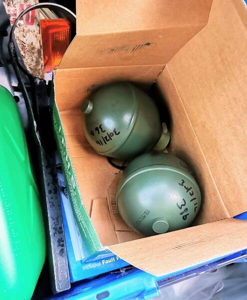

Zelandeth Posted March 7, 2021 Author Share Posted March 7, 2021 Hey look what was dropped off for the BX today... These are actually rear spheres for a non-hydractive Xantia rather than BX ones, but they're pretty close spec wise. Will be absolutely fine for the purposes of getting the car into a driveable state. Once she's got an MOT and is driving reliably I'll look at getting the exact correct ones. So tomorrow (if time permits) the battle to change the rear spheres will begin. I've been regularly dousing them in PlusGas since the car arrived and I've been loaned the right tool for the job but I'm still expecting this to be a royal battle. Mrs6C, somewhatfoolish, mk2_craig and 8 others 11 Link to comment Share on other sites More sharing options...
Zelandeth Posted March 8, 2021 Author Share Posted March 8, 2021 Well I didn't see that coming! I was expecting a battle of biblical proportions to get these off. Nope...They just unscrewed absolutely fine. No huge explosion of LHM when they came off either so the diaphragms are probably still intact. New spheres went on without any issue, even though the nearside one is a little obscured by the rear silencer. She has rear suspension again now! Huge step forward. Unfortunately now being in a position where I was giving serious scrutiny to the rear end of the car I did spot an issue. We do have an LHM leak. Initially I thought this was coming from the seal on the sphere I'd just changed - but fluid only appears here when the brake pedal is pressed, at which point it appears in quite significant quantities. Looks like we've got a failed brake line then. Not sure if the BX has the same little spiral of brake pipe behind the caliper that the Xantia has - if it does, that's got to be the prime suspect as I've seen that rust out on several Xantias where the lines were otherwise spotless. Wonder if this might be the fault which originally took the car off the road? Whatever took her off the road, she's got a step closer back to it today. MorrisItalSLX, LightBulbFun, Tepper and 23 others 26 Link to comment Share on other sites More sharing options...
LightBulbFun Posted March 8, 2021 Share Posted March 8, 2021 5 minutes ago, Zelandeth said: Well I didn't see that coming! I was expecting a battle of biblical proportions to get these off. Nope...They just unscrewed absolutely fine. No huge explosion of LHM when they came off either so the diaphragms are probably still intact. New spheres went on without any issue, even though the nearside one is a little obscured by the rear silencer. She has rear suspension again now! Huge step forward. Unfortunately now being in a position where I was giving serious scrutiny to the rear end of the car I did spot an issue. We do have an LHM leak. Initially I thought this was coming from the seal on the sphere I'd just changed - but fluid only appears here when the brake pedal is pressed, at which point it appears in quite significant quantities. Looks like we've got a failed brake line then. Not sure if the BX has the same little spiral of brake pipe behind the caliper that the Xantia has - if it does, that's got to be the prime suspect as I've seen that rust out on several Xantias where the lines were otherwise spotless. Wonder if this might be the fault which originally took the car off the road? Whatever took her off the road, she's got a step closer back to it today. I wonder given how pretty much everything on a car like this is powered/operated by LHM is there an LHM schematic/circuit diagram for lack of a better word somewhere? would be interesting to see it if there is one im curious to see how everything is connected together exactly Link to comment Share on other sites More sharing options...

vulgalour Posted March 8, 2021 Share Posted March 8, 2021 From one BX fettler to another, regarding those rear spheres... spartacus, CaptainBoom, LightBulbFun and 1 other 4 Link to comment Share on other sites More sharing options...
Zelandeth Posted March 9, 2021 Author Share Posted March 9, 2021 2 hours ago, vulgalour said: From one BX fettler to another, regarding those rear spheres... Oh the Xantia was one of our bread and butter cars at the dealer I worked at so I've done probably dozens of them... that's why I was so utterly gobsmacked they came off without having to hire a jack hammer or resorting to getting thermite involved... R1152 and LightBulbFun 2 Link to comment Share on other sites More sharing options...
