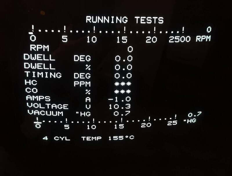

mat_the_cat Posted November 21, 2019 Share Posted November 21, 2019 20 hours ago, Zelandeth said: [] Temperature probe reading nonsense (see 160C reading above). I can't help with the threads, but I should be able to with the temperature probe seeing as I've worked in that industry for years. Do you know what type it is? I.e. thermocouple (voltage) or a resistance type. The former is generally more robust, but involves a more complex measurement circuit. You would be able to tell by shorting out the probe terminals - a thermocouple system will read ambient temperature (assuming working correctly) but a resistance system will read either full scale high or low depending on whether NTC or PTC. I'm finding this fascinating, even more than the vehicles! Ben_O and LightBulbFun 2 Link to comment Share on other sites More sharing options...
Zelandeth Posted November 21, 2019 Author Share Posted November 21, 2019 26 minutes ago, mat_the_cat said: I can't help with the threads, but I should be able to with the temperature probe seeing as I've worked in that industry for years. Do you know what type it is? I.e. thermocouple (voltage) or a resistance type. The former is generally more robust, but involves a more complex measurement circuit. You would be able to tell by shorting out the probe terminals - a thermocouple system will read ambient temperature (assuming working correctly) but a resistance system will read either full scale high or low depending on whether NTC or PTC. I'm finding this fascinating, even more than the vehicles! I haven't done too much investigation on that yet - disconnecting the probe for it drops the reported temperature down to around 80C. I have a sneaking feeling that there's a missing or way out of whack reference voltage rail somewhere which is probably what's throwing a whole load of the measurements off. I've not even looked at the analogue front end side of things yet. At least a couple of the boards are liberally scattered with tantalum decoupling capacitors as well...these are famously unreliable and could well be leaky and dragging one or more of the supply rails down. Given the record of these things I may well just replace these on sight in the interests of future proofing/long-term reliability. If it fixes any issues along the way it's a bonus. LightBulbFun and mat_the_cat 2 Link to comment Share on other sites More sharing options...

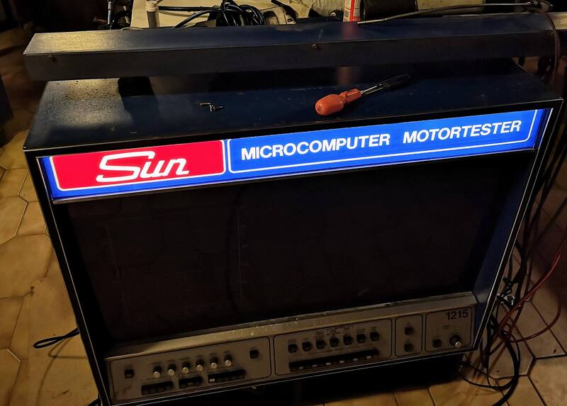

Zelandeth Posted November 22, 2019 Author Share Posted November 22, 2019 After what should have been an hour or two round trip taking nearly the whole afternoon because of sodding traffic, have a correct replacement part for the Sun 1215 and a spare for the future. Apparently the seller does indeed have about a thousand of them, so worth keeping an eye on their page LBF if they offer delivery. I never checked that as they were just 15 miles or so down the road. Will get that installed shortly. LightBulbFun, egg and mat_the_cat 3 Link to comment Share on other sites More sharing options...
LightBulbFun Posted November 22, 2019 Share Posted November 22, 2019 27 minutes ago, Zelandeth said: After what should have been an hour or two round trip taking nearly the whole afternoon because of sodding traffic, have a correct replacement part for the Sun 1215 and a spare for the future. Apparently the seller does indeed have about a thousand of them, so worth keeping an eye on their page LBF if they offer delivery. I never checked that as they were just 15 miles or so down the road. Will get that installed shortly. ah awesome that they were close enough to be picked up personally much reduced risk of them getting smashed! they do indeed offer delivery, or did for the 1 listing they had ill keep an eye out on their ebay page, maybe depending on if they are willing to do a bulk discount, I could see myself picking up an entire case of them at some point in time I wonder where they came from or what they were ordered for, as mentioned previously 30W T12s are very uncommon here and most people dont even know they existed its worth noting that they are very late GTE tubes, of a transitional design, they have the 1980s GTE etch, but later mid 1990s stepped end cap design, the date code comes back as Aug 1993 if im reading it correctly (by 1993 I think osram had already acquired GTEs lighting division in the US) it will be interesting to see if now with proper rapid start tubes, you get a proper rapid start fade in as the cathodes warm up to temperature and the striking voltage drops over a second or so (im not surprised the F30T8 started instantly as it would of been cold starting due to the lack of proper cathode heating) on that note, due to the low cathode heating voltage of 3.6V its important you make sure the socket contacts are clean and making good contact! mat_the_cat 1 Link to comment Share on other sites More sharing options...
Zelandeth Posted November 22, 2019 Author Share Posted November 22, 2019 Worth dropping the seller a question through eBay asking if they're planning on listing any more. New lamp was fitted without incident. Still instant starts... suspect this may be one of those ballasts which is a bit brutal about starting. Realised that one thing I didn't check last time I had this opened up was whether the back of the diffuser was clean...not really was the answer. Everything back together. Figured for those interested in the procedure in setting this thing up I'd run through it without missing a bunch of steps, as previously I'd very much abbreviated it. This isn't a full user guide...but is a quick run through of the real basics from what I remember of using the one a mate had about 20 years ago and what I've seen messing around with this one. Hopefully this will demystify all those buttons a bit. When first powered on the machine shows a message informing you that it has started its warmup phase and gives a countdown to when it will be ready to use. You can bypass this delay at any point by pressing #, but there's obviously a greater chance of the accuracy of the machine may drift as it warms up. The fifteen minute delay helps ensure that everything is stable before you put it into use. The # button basically functions as the "next page" control throughout. When the countdown runs out it waits for you to press # to continue before it will move on to the self test/calibration screen. This takes a minute or so to run through...and obviously has a few errors reported in the case of my machine... hopefully these will disappear as time goes on and I work through things. Next page is the program setup screen where things start to get a little more interesting. The "set ignition selector" relates to two modes that the ignition side of things can run in. There's a table in the operator's manual telling you which cars which setting should be used with. This is selected using this button. Shown above in mode 1, and below in mode 2. Yes, this is a bit of an excuse to show off the flipdot indicators...even if they are a bit grubby at this stage. "Set 2 or 4 cycle" is asking you to select whether the engine is a two or four stroke. There's a dedicated button for this, which like the ignition selector has an indicator built into the button itself. Self explanatory really...4 for a four stroke and 2 for a two stroke. The number of cylinders is then set using the left of the three buttons below. These have different functions in different program modes hence having several legends, it's less confusing than it initially looks. The selection starts at 0 by default, and pressing the button cycles through 2, 3, 4, 5, 6, 8, 10, 12 then loops back to 2. The last thing on this section is the timing offset. This is only needed I believe where the car uses a magnetic pickup to fire the ignition, this is usually offset a few degrees before or after TDC. You need to dial this in here. Pressing "number select" initially changes the sign to + or - to reflect whether the offset is before or after TDC, then "cursor advance" moves to the first digit, with "number select" used to advance the number. This process is repeated until you've dialled in the correct offset. The screen below is an example which would have been used on my old Saab from memory, you can see the cursor showing which digit is being entered. Once you have advanced to the last digit it will tell you to press # to the next page. It won't let you proceed if there are things you've missed. This then brings you up to the "Cranking/Pinpoint Tests" page. This gives you quite a bit of information on what's going on. However this is only half the information it can show you. An additional page is accessible using the "short" button on the control panel. This appears to indicate "short-cut" rather than that it shorts anything out to kill the ignition system or anything. Here it's shown pressed, hence the vivid orange indicator shown. All of the buttons - even those which are purely momentary - have the indicators in them. Utterly unnecessary, but a nice touch. This screen gives you some really quite clever diagnostic information. This shows you the difference in engine speed, starter motor current draw as the engine spins over each cylinder. This can be helpful in showing if one or more cylinders has a significantly lower compression ratio than the others. You might need to actually stop the engine from starting to get solid data from this test, and there's a control to disable the ignition system labelled as "engine kill." Pressing this toggles the kill, and when it's enabled a flashing "engine kill" warning is shown on the display to warn the user. Having this feature on hand is obviously useful from a safety perspective as well. The "Short" button latches, so pressing it again will drop you back to the Cranking/pinpoint Tests page. Once you're done with that, pressing # will advance you to the main running test page. This shows you pretty much everything you need to know. The displays look to update pretty rapidly, at least a few times a second. If wanted, you can pause the data on screen with the "Display Hold" button. This is directly below the # button. When this is enabled a "hold" message flashes at the upper right of the screen to warn the user that live data isn't being shown. A useful feature of this as well is that in the main screen above, when the display hold control is released, the original data is left in the screen with a new column being put up for the live data. This allows you two "old" readings to be shown along with the live data. This could be really useful if you're making small tweaks and wanting to double check what effect it's had. The below display shows a "full" page with two columns of held data shown. The live data is always shown on the leftmost column. That's as far into the running of this unit as I've gone...but it gives you a basic rundown of how the computer works. Shows how it does a pretty good job of guiding you through everything...which in the mid 80s really wasn't a given! Probably the most daunting looking controls relate to the scope...though I've never really done enough work with that to be able to talk through it from memory. The Short button being grouped here rather than with the computer controls is just to keep you on your toes. I'll try someday to write a bit of a how to for this too...I'll need to learn to drive it a bit better first though. Likewise some of the advanced features of the computer...there's a whole additional layer in there I think. For the sake of convenience there's a remote control which duplicates a number of buttons from the front panel to make life easier for the technician. #, Display Hold, Short and Engine Kill being those controls. The "Print" button would trigger the optional printer. No timestamps or anything, it would just literally print a copy of what's shown on the screen. Sadly I don't have the printer, though I do have the interface card (found in the base cabinet) should I ever come across one. Probably horribly tedious to most of you, but hopefully it's vaguely interesting to you if you're into old tech and want to see what would be happening when you're blindly mashing buttons to see what makes it tick. Any questions, let me know. somewhatfoolish, GrumpiusMaximus, rainagain and 9 others 12 Link to comment Share on other sites More sharing options...

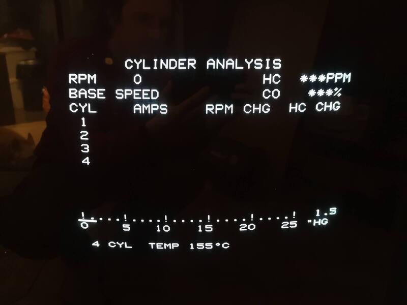

mat_the_cat Posted November 22, 2019 Share Posted November 22, 2019 7 minutes ago, Zelandeth said: Probably horribly tedious to most of you, but hopefully it's vaguely interesting to you if you're into old tech and want to see what would be happening when you're blindly mashing buttons to see what makes it tick. Tedious?! It's made my Friday night...beats the Graham Norton show or whatever is on the TV. Thanks for the photos and the detail LightBulbFun 1 Link to comment Share on other sites More sharing options...
LightBulbFun Posted November 22, 2019 Share Posted November 22, 2019 I enjoyed reading the detailed write up very much as well its interesting to hear it only goes down to 2 cylinders, Poor @egg cant have his Mk12 diagnosed/tested by it! unless that would be done using the "0" cylinder setting? also im curious how would/could a rotary engined car be hooked up to it? or what about a wasted spark ignition system like in a 2CV? Mrs6C and egg 2 Link to comment Share on other sites More sharing options...

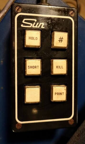

Zelandeth Posted November 24, 2019 Author Share Posted November 24, 2019 Because I'm me and find them far more interesting than I probably should, here are a couple of additional photos of the ridiculously overcomplicated status indicators built into the buttons. It surprises me that they went to the lengths of building them into even just the momentary controls. You never actually *see* this one as the control is actually latched on software...the orange announciator in the button is normally hidden by your finger. The actual indicator that this is active is a message that flashes at the lower right hand corner of the screen. There is apparently a volts/ohms measurement capacity in there somewhere (which I've yet to figure out how to access), which is switched between the two modes using this control. Here it is in volts mode... ...and ohms mode. Just surprises me this wasn't just done either on screen or using a status LED next to the control. I remember looking at this sort of control when I was building a power supply a few years back, and these things were *expensive* - even basic ones without legends like this. "We spared no expense" seems to be a running theme with this machine. I've got a slightly more sane (though still offset) temperature reading now I've actually got the thermocouple plugged into it rather than a hall effect sensor! I wanted to have a look at all the analogue cards to check for any additional socketed components, dirty contacts or dry joints. Started out with the volts/ohms board as I know there are issues with that subsystem. Had a brief "Ah ha!" moment when I spotted that toasty looking resistor...but checking it shows it to measure precisely the value that's stamped on the side of it. Nothing else obviously amiss. The next board is the trigger control board. This is quite important in that what it does is essentially listen for the ignition pulse firing on cylinder number 1, as that is the timing reference to which everything on the machine is slaved. Nothing amiss here that I can see. Unsurprisingly, the next board along from that is the main timing board - this basically keeps everything in sync with the signal tracked by the trigger control board. One of the more densely packed boards. I initially thought that the next board (labelled "AMP" on the card cage) was going to handle a lot of signal amplification...but it actually appears to be the signal processing for the amps and temperature sensors. This board does have a couple of dry joints that I'll give a tickle with the soldering iron tomorrow. "CAL" is the next one, which I'm assuming given the precense of several relays, physically connects loads of known values across the inputs to undertake the calibration self test. Again some of the soldering isn't great looking, but I couldn't actually see any dry joints...I may well reflow some of the heavier connections though as they could be better. The fact that the only systems which are consistently failing the self calibration are the HC and CO meters is one of the reasons I want to have a really good look at the wiring from the I/O backplane to the sockets at the end of the boom. Speaking of I/O, that's what the next board is tasked with dealing with. Nothing wrong with this one that I could see. Next up is the vertical pre-amplifier board, I believe this relates to the scope. Quite obvious from the lovely old school hand routed traces that this one and the trigger control board are quite a bit older in design to the majority, though the date codes show they were actually made at the same time as the others. "Logic Board No. 2" is next...though I don't recall seeing a number 1 anywhere! I'm guessing a bit, but based on the hardware present that this is just handling some low level buffering or such like they didn't have room for in the main computer cage. No signs of trouble anyway. Finally we have an identical pair of cards containing quite beefy deflection amplifiers to drive the CRT (one card handles horizontal, the other vertical). All of these boards could do with a good clean, as do the digital boards (which I'll grab proper photos of soon too) due to the close proximity of the cooling fan. Shame Sun didn't feel it worthwhile to fit a filter to it. So nothing nothing obviously amiss there, aside from one resistor which has got a bit warm at some point and one capacitor on the amp/temp board that's got dry joints. I really did want to get them all out for a proper check over though. No socketed ICs or anything like that (which was responsible for the original display issue) in need of attention, but it was worth checking. Looks like I might actually get a few hours free tomorrow afternoon, if so I'll hopefully get a bit more stuck into trying to work out what's going on with the faults. The biggest irritation there really is that there don't seem to be many labelled test points, which would make checking to see if all the power supply rails are present and correct (there are a load of them!) a lot easier. Obviously given the card based construction it's a bit tricky to probe a lot of the machine when it's running as the cards are quite tightly packed together. The other thing I wanted to check these cards for was whether they were hiding any more tantalum capacitors like I've seen on at least one or two of the digital boards, as once I've ascertained how many of them there are they will be getting replaced on mass. Wouldn't surprise me if that alone sorted a lot of the issues based on prior experience. egg, strangeangel, LightBulbFun and 4 others 7 Link to comment Share on other sites More sharing options...
LightBulbFun Posted November 24, 2019 Share Posted November 24, 2019 very neat stuff! id still be a bit weary of that toasty looking resistor, and would look at replacing it, it might measure fine when cold, but I could see its value drifting/changing as it warms up given how sad it looks (plus knowing my luck, id have everything working, and just as I get it all buttoned up that resistor would actually fail on me!) Link to comment Share on other sites More sharing options...

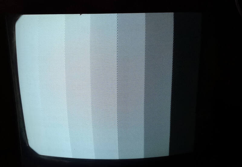

Zelandeth Posted November 26, 2019 Author Share Posted November 26, 2019 I believe this is the point where I should cue the mad scientist manic laughter... Actually an order of magnitude clearer in person...my camera (unsurprisingly) isn't fond of taking pictures of an interlaced CRT display. mat_the_cat, dave j, The Moog and 11 others 14 Link to comment Share on other sites More sharing options...
LightBulbFun Posted November 26, 2019 Share Posted November 26, 2019 17 minutes ago, Zelandeth said: I believe this is the point where I should cue the mad scientist manic laughter... Actually an order of magnitude clearer in person...my camera (unsurprisingly) isn't fond of taking pictures of an interlaced CRT display. haha awesome its like that little black and white TV you have setup, but on another scale entirely Link to comment Share on other sites More sharing options...

Zelandeth Posted November 26, 2019 Author Share Posted November 26, 2019 1 hour ago, LightBulbFun said: cool (I was wondering about the colour composite into a BW monitor/TV thing, I do remember you would get noise when doing that, but I could not recall if it was just with RF or also composite) I was wondering, is it possible to make it so you can have the monitor turned on without having to turn on the rest of the system? (for example if your working on something and you only just have to quickly pull up a PDF or something, it would save having to turn on the rest of the system unnecessarily) You will pretty much always get some "dot crawl" artifacts on a B&W display being fed a colour video signal unless there is specific circuitry in there to remove it. It's just down to how the chroma data is embedded in the signal. Most B&W televisions etc this is completely irrelevant as the display isn't usually sharp enough for the effect to be all that noticeable, especially from normal viewing distances. This display however is a *bit* sharper than your average TV. So the effect is quite visible - though more so here as you're looking at 100% saturation colour bars than in normal use. If you just feed in greyscale video, the issue is invisible. That above image though gives a better indication as the actual sharpness of the CRT (no idea what resolution that is - that's just what the HDMI to composite adapter outputs when it is powered up with no video input present). I could probably make it so that the monitor could be powered up independently, though it would involve a moderate amount of work. The power feed to it appears to be run from the computer itself rather than just a mains lead running obviously from the mains switch, so I'd need to do a moderate amount of work to chase that back to its source, so at the moment that's sort of listed under "stuff it might be nice to look into someday." LightBulbFun 1 Link to comment Share on other sites More sharing options...
LightBulbFun Posted November 26, 2019 Share Posted November 26, 2019 ah yes dot crawl that's the term i was looking for and I feared such on the monitor, reminds me of bringing up the CRT in AIO Macintoshes (iMac G3s eMacs etc) independently of the logic board so you could feed your own signal into them Link to comment Share on other sites More sharing options...
