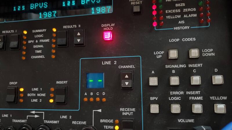

Zelandeth Posted February 12, 2020 Author Share Posted February 12, 2020 6 hours ago, PhilA said: You need to replace the trip computer with something a little more appropriate. Like this. See, same buttons. Phil I want to play with that...What is it? Echoes of a huge DMX processor I got to play with once... GrumpiusMaximus and stonedagain 2 Link to comment Share on other sites More sharing options...
SiC Posted February 12, 2020 Share Posted February 12, 2020 That looks like some sort of ISDN type or digital over POTS, etc like tester. PhilA 1 Link to comment Share on other sites More sharing options...
PhilA Posted February 12, 2020 Share Posted February 12, 2020 It's a TBerd 225 T1/E1 digital loop tester. https://www.atecorp.com/atecorp/media/pdfs/data-sheets/ttc-224_brochure.pdf Phil SiC and GrumpiusMaximus 2 Link to comment Share on other sites More sharing options...

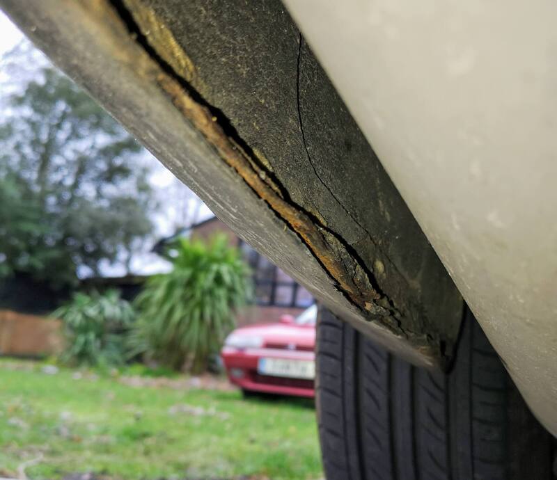

Zelandeth Posted February 14, 2020 Author Share Posted February 14, 2020 As mentioned previously elsewhere there was definite evidence of uneven tyre wear on the Jag. Offside front: Nearside front: Not as dramatic, but it's still definitely worn on the inner edge. Also evidence of chunking in a few spots...these tyres need to be binned now. Rears have plenty of tread left at least and there's no signs of any damage to the tread surface or perishing. Offside: Nearside: They still are only marginally more grippy in the wet than aerospace grade teflon however so aren't long for this world. The steering wheel being off straight (which made indicating right a perpetual fight with the auto cancelling mechanism) and the fact that the car tramlines horribly on uneven surfaces (especially under braking) further suggested to me that the wheel alignment needed help. Being a regular in the garage they were perfectly happy for me to have a wander around while they sorted the tracking. This was useful as it allowed me to confirm where the exhaust is touching the body. That silencer is the guilty party. It's about 1/8" away from the heat shield above it and any movement in the system makes it make contact. As the tailpipe on that side sits a good 1" higher than the other side I reckon the rear hanger needs a tweak to just drop that whole lot a little. I was also able to see that the rear gearbox mount looks almost brand new, so with a bit of luck I can not worry about changing that for a while. The end result: Front toe adjustment is all we're interested here (everything else involves swapping shims I believe anyway). Annoyingly I forgot to get a snap of the readings before we started. Straight ahead is now indeed straight ahead. The disconcerting fidgety sensation has now left us which is nice. It was particularly bad before when you went over the white line while changing lanes on the dual carriageway for example. Plus she now brakes in a straight line which is nice. That required nearly Lada levels of correction when braking from speed before. Hard to tell if it's just in my head, but it feels like it's now rolling more freely too...wonder if that will translate to any additional MPG...probably not! A small adjustment which took maybe 20 minutes, but it's made the car a lot more pleasant to drive. adw1977, LightBulbFun, strangeangel and 9 others 12 Link to comment Share on other sites More sharing options...

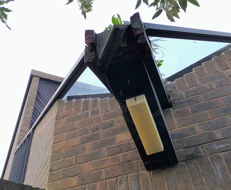

Zelandeth Posted February 21, 2020 Author Share Posted February 21, 2020 Hopefully I might actually be able to look at the cars next week now I've got the immediate house stuff out the way. Today was ticking off a few things relating to the rainwater drain from the conservatory roof. The roof drains into a central channel which then decants into a hidden drain above the front door. This regularly collects all manner of organic matter and needs clearing out at least three or four times a year. It was last done just before Halloween and we had plants about a foot tall growing out of it again. Plus the storms last week had managed to get under the flashing and pull it away. The previous owners never having cleaned it out I suspect has contributed to us now needing to also get the last foot or so of the beams there replaced. Thankfully that section isn't holding the weight of the roof, that's done several feet behind the wall. We're hoping to get that sorted this spring/summer along with some other work on the roof, having finally got a response from a scaffolding provider. Before: I've heard of green roofs, but this is ridiculous. Those flashes of orange by the way, that's the original colour of the framework...oh how I wish the previous owner hadn't painted it black...the vivid orange would look so much better! The panels above the roof are teak under that black stain as well. After: Just a little plant matter removed. Most of the greenery has actually landed in the planter to the right of the door so there's actually a bit more there than it looks like. Hopefully this will make it easier to get in and out of the house without getting drenched this week with the rain that's forecast. Just had our annual mortgage statement through too...depressing seeing it's still going to be 17 years before we own the place outright. Though I can see us moving again before then to be honest... we're struggling for space here a bit to be honest. For all this house had quite a decent amount of floor space in terms of total square footage it lacks decent storage options and that number is inflated a bit by the conservatory which is really only useful in spring and autumn. Plus the layout means quite a bit of space downstairs isn't actually useful. For instance the staircase manages to essentially render a 12' triangle of space wasted because you need space to walk around it. If they'd positioned it close to the wall on either side rather than smack in the middle it would have made way more sense. It *looks* cool making a feature out of it (I guess this makes sense given this house was intended as a show piece somewhat), but doesn't make much sense practically speaking. The gardens to be honest are a liability as well given that nobody in our family has even a passing interest in gardening... I'm happy to mow grass and trim hedges etc...but beyond that I have little patience. Plus we'd all like to be an order of magnitude further away from the school than we are as living virtually next door to it is an utter nuisance. Saabnut and mat_the_cat 2 Link to comment Share on other sites More sharing options...
