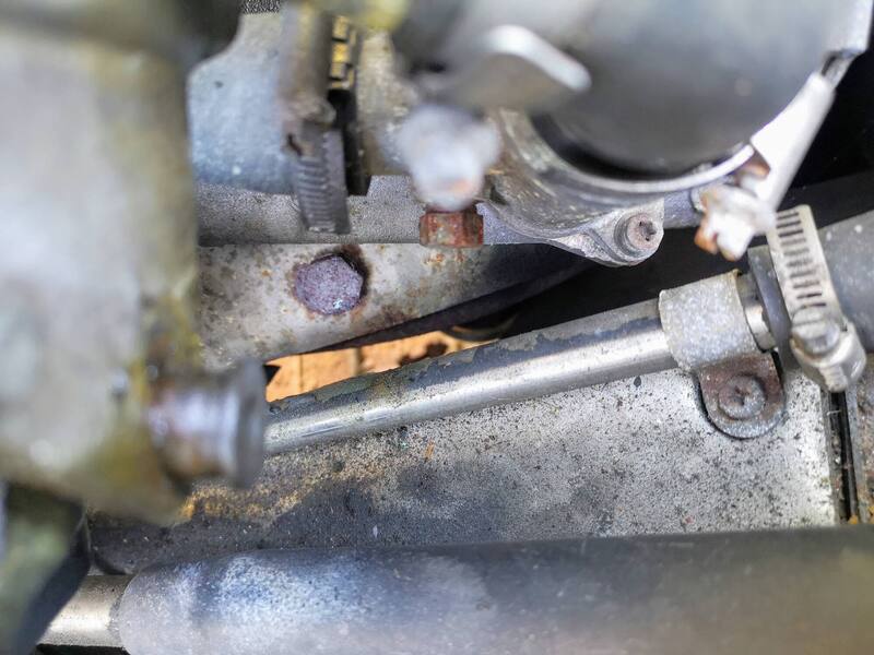

MorrisItalSLX Posted February 6, 2020 Share Posted February 6, 2020 4 hours ago, Zelandeth said: The oil filter is not the most inaccessible one I've ever encountered...but is close. It would be dead easy if the left hand exhaust down pipe wasn't directly underneath it. No access whatsoever from above! That circular thing you can just see through the gap is the top of the filter housing. I can smell the oil burning off that manifold from here. Excellent. Link to comment Share on other sites More sharing options...

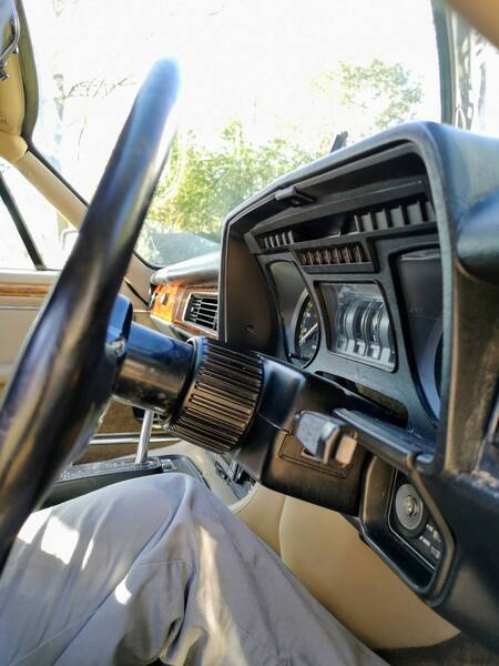

Zelandeth Posted February 6, 2020 Author Share Posted February 6, 2020 Oh, on reading the handbook I discovered that the steering wheel has a reach adjustment. Turning the knurled collar releases it and allows about 3" of adjustment. Doesn't sound like much but really makes a difference. That will make getting the instrument panel out next time about twenty times less hassle. Here's a photo of the black panel currently behind the switchgear in actual daylight. Doesn't look out of place I reckon. Just remembered something else I found today while doing the oil change. A question for the XJS experts...what the heck is the deal with the second ignition coil bolted to the crossmember in front of the radiator? The HT output terminal is capped off, but the LT connections disappear into the loom. LightBulbFun, rainagain and egg 3 Link to comment Share on other sites More sharing options...

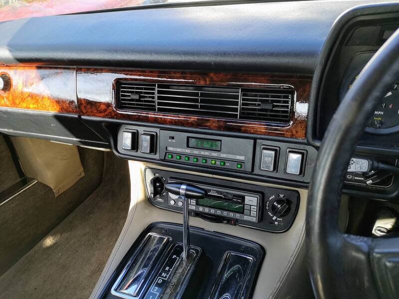

Daviemck2006 Posted February 6, 2020 Share Posted February 6, 2020 I think your dash looks great like that Zel, I would leave the panel behind the switches black.Sent from my SM-T585 using Tapatalk egg 1 Link to comment Share on other sites More sharing options...
Noel Tidybeard Posted February 6, 2020 Share Posted February 6, 2020 4 minutes ago, Daviemck2006 said: I think your dash looks great like that Zel, I would leave the panel behind the switches black. Sent from my SM-T585 using Tapatalk maybe some crackle finish like an mgmgmgmgmgbgt Link to comment Share on other sites More sharing options...

Zelandeth Posted February 6, 2020 Author Share Posted February 6, 2020 1 hour ago, Noel Tidybeard said: maybe some crackle finish like an mgmgmgmgmgbgt Someone on another forum just suggested a vinyl/leather effect to match the rest of the dash. Makes a lot of sense actually now it's been mentioned...I think I have some vinyl with that sort of finish buried somewhere in the garage. I'll have a dig around at the weekend. The more I've looked at it the more I actually prefer the look of it. The veneer there would make more sense if the car didn't have the trip computer, but with there being a big black slab in the middle of that panel it changes things a bit. Being black it blends into the trip computer casing better. 41 minutes ago, Heidel_Kakao said: The extra ignition coil apparently allows faster coil charging at higher RPM's. I can't claim to be an XJS expert but I am ok with Google I figured it would be something like that. Makes a lot of sense really, two standard coils from the BMC parts bin would inevitably been cheaper (and probably more reliable) than something more specialised. Don't really see the second coil as a problem or anything, was just curious as to the purpose for its existence. Link to comment Share on other sites More sharing options...

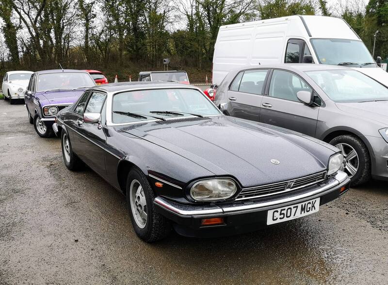

Zelandeth Posted February 8, 2020 Author Share Posted February 8, 2020 I believe there's a get together of car enthusiasts tomorrow morning. My intention at this point is to get along to it. In preparation for this I figured I'd at least blast the worst of the grime off the Jag. Plus side of me having waxed it to within an inch of its life a couple of weeks back was that it scrubbed up pretty easy. Still reckon this was one of the best bits of cleaning gear I bought in the last year. 50m hose which bundles up to fit in the washing bucket and is thus far 100% kink proof. Expensive for a hosepipe but the amount of aggravation it saves is well worth it I reckon. These expanding hoses are really strange but well clever. LightBulbFun, HarmonicCheeseburger, timolloyd and 7 others 10 Link to comment Share on other sites More sharing options...

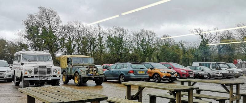

Zelandeth Posted February 9, 2020 Author Share Posted February 9, 2020 So despite the weather I decided to try to get to the breakfast meet up this morning. Despite a not insignificant amount of debris on the road there I got there without incident. 1700kgs of very low car is a pretty good formula for "doesn't care about side winds." I wasn't the only one mad enough to be there either! Sadly pretty much the moment I got done with breakfast the heavens opened. This was also about the point that I got the call telling me that the roof was about to blow off the shed, so I had to let it back to base. Despite the legendary hate that all British cars are apparently meant to have for rain, the Jag handled getting well.and truly drowned today without complaint. Though I do apparently have a point of water ingress I'll need to look into. Chasing that is a job for when there are less bits of tree getting blown around and inserted into my ear by the wind. To be fair though, she had been travelling at speed through absolutely torrential rain immediately before I spotted that so I don't really begrudge the car for letting a bit in. Hopefully next month I won't need to depart in a panicked powerslide because my house is flying to bits in the wind... LightBulbFun, GrumpiusMaximus, Doctormop and 3 others 6 Link to comment Share on other sites More sharing options...

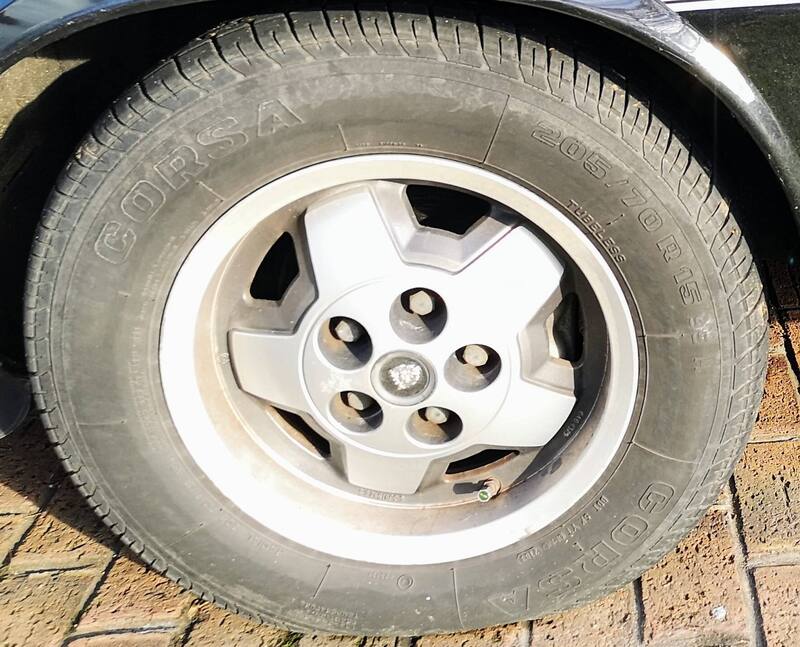

Zelandeth Posted February 11, 2020 Author Share Posted February 11, 2020 I seriously need to get tyres moved up the list. I've had this thing nearly sideways half a dozen times today using anything beyond 10% throttle moving away from junctions. The rears have roughly as much as grip as teflon when wet and the fronts aren't much better. Locking the brakes requires barely looking at the pedal. Will have a chat with my usual tyre place tomorrow see what they can get hold of. 215/70 R15 (probably why she currently has 205/70s on) is annoyingly almost invariably a van size these days which makes websites a royal pain to try to trawl through. egg 1 Link to comment Share on other sites More sharing options...
richardmorris Posted February 11, 2020 Share Posted February 11, 2020 14 minutes ago, Zelandeth said: I seriously need to get tyres moved up the list. I've had this thing nearly sideways half a dozen times today using anything beyond 10% throttle moving away from junctions. The rears have roughly as much as grip as teflon when wet and the fronts aren't much better. Locking the brakes requires barely looking at the pedal. Will have a chat with my usual tyre place tomorrow see what they can get hold of. 215/70 R15 (probably why she currently has 205/70s on) is annoyingly almost invariably a van size these days which makes websites a royal pain to try to trawl through. That will be £1325 to you sir! https://www.longstonetyres.co.uk/pneu/215-70-15/215-70-r-15-pirelli-cinturato-cn12.html Link to comment Share on other sites More sharing options...
LightBulbFun Posted February 11, 2020 Share Posted February 11, 2020 14 minutes ago, richardmorris said: That will be £1325 to you sir! https://www.longstonetyres.co.uk/pneu/215-70-15/215-70-r-15-pirelli-cinturato-cn12.html HFM! a set of tyres for my car is £162 for all 3! (LOL) https://www.vintagetyres.com/shop/camac-bn313-145r10-68s #PoloMints Link to comment Share on other sites More sharing options...

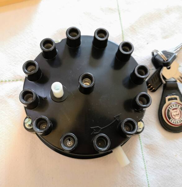

Dick Longbridge Posted February 11, 2020 Share Posted February 11, 2020 That dizzy cap is something else. Wow! LightBulbFun 1 Link to comment Share on other sites More sharing options...
LightBulbFun Posted February 11, 2020 Share Posted February 11, 2020 2 minutes ago, Dick Longbridge said: That dizzy cap is something else. Wow! Yeah! it would be neat to have a clear one made up or something so you can see inside while its all working! Link to comment Share on other sites More sharing options...
richardmorris Posted February 11, 2020 Share Posted February 11, 2020 6 minutes ago, LightBulbFun said: HFM! a set of tyres for my car is £162 for all 3! (LOL) https://www.vintagetyres.com/shop/camac-bn313-145r10-68s #PoloMints I missed the VAT so actually £1590!!!! plus delivery and fitting. LightBulbFun 1 Link to comment Share on other sites More sharing options...
Zelandeth Posted February 11, 2020 Author Share Posted February 11, 2020 Yeah, it's not going to be cheap. Though it's a heavy and powerful car and tyres are probably the single most safety critical component on the car...so no Chinese Death Rings will be used here. Will probably be a toss up between the Pirelli Cinturatos or Michelin XWX if I go for the "heritage" options, though I'm not married to that. If there's a current design which ticks the boxes I'm happy to consider that too. I'm not interested in concourse show points! I'm also quite aware that modern tyres tend to have much stiffer sidewalls, and that there aren't going to be a huge amount of choice...so this may well be what I wind up with. I knew full well that bills like this were to be expected when I picked up the keys to this car. If I wasn't seeing it as a keeper I'd leave them be and be careful...but it's a car I'm enjoying driving, so it just needs to be done. The fronts currently fitted are Corsas, which I'm pretty sure aren't particularly well regarded...even when not 17 years old! The rears are "Winda" branded, which I've never heard of. All I know is that they're comically slippery. rainagain, richardmorris, Broadsword and 3 others 6 Link to comment Share on other sites More sharing options...

GBJ Posted February 11, 2020 Share Posted February 11, 2020 26 minutes ago, Zelandeth said: Yeah, it's not going to be cheap. Though it's a heavy and powerful car and tyres are probably the single most safety critical component on the car...so no Chinese Death Rings will be used here. Will probably be a toss up between the Pirelli Cinturatos or Michelin XWX if I go for the "heritage" options, though I'm not married to that. If there's a current design which ticks the boxes I'm happy to consider that too. I'm not interested in concourse show points! I'm also quite aware that modern tyres tend to have much stiffer sidewalls, and that there aren't going to be a huge amount of choice...so this may well be what I wind up with. I knew full well that bills like this were to be expected when I picked up the keys to this car. If I wasn't seeing it as a keeper I'd leave them be and be careful...but it's a car I'm enjoying driving, so it just needs to be done. The fronts currently fitted are Corsas, which I'm pretty sure aren't particularly well regarded...even when not 17 years old! The rears are "Winda" branded, which I've never heard of. All I know is that they're comically slippery. https://www.oponeo.co.uk/tyre-finder/s=1/summer/t=1/van/p=9/bridgestone,continental,dunlop,goodyear,michelin,nokian,pirelli,vredestein,yokohama/r=1/205-70-r15 Link to comment Share on other sites More sharing options...

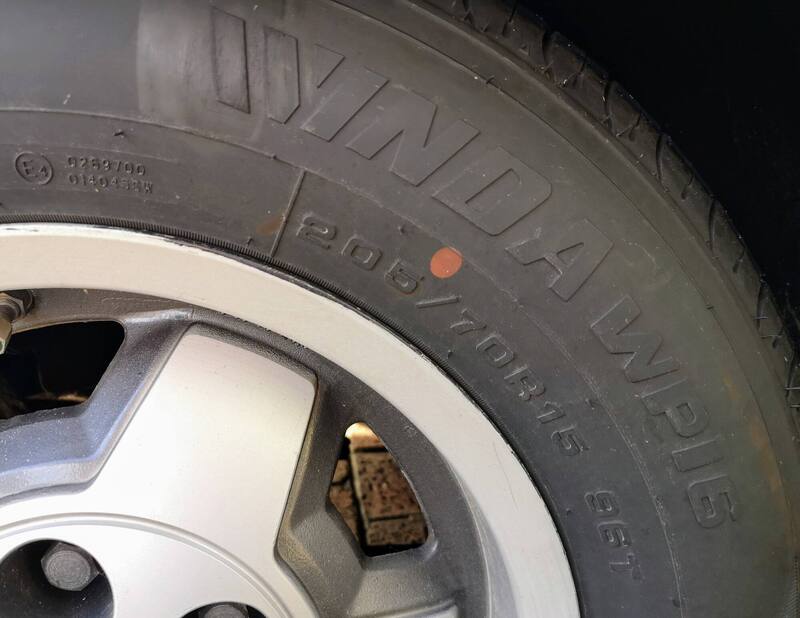

Six-cylinder Posted February 12, 2020 Share Posted February 12, 2020 Is a T rated tyre not 118 mph max speed? SiC and timolloyd 2 Link to comment Share on other sites More sharing options...
