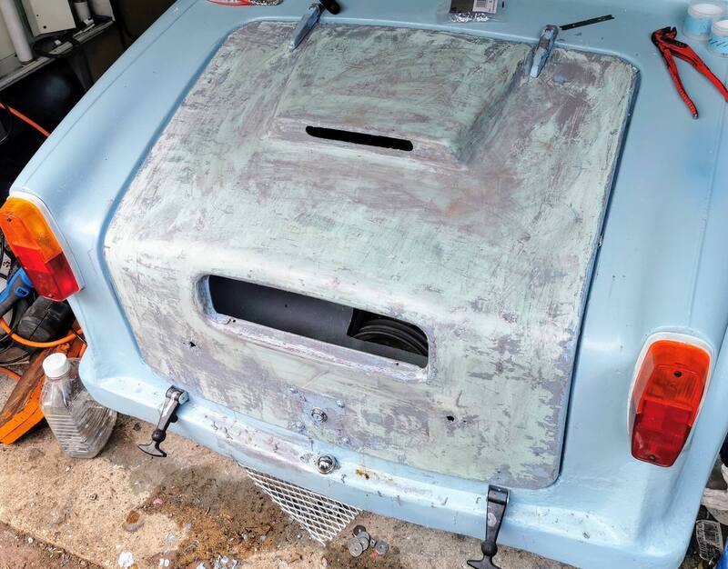

Zelandeth Posted August 28, 2020 Author Share Posted August 28, 2020 After three days of faffing around with it I've got the paint on the engine cover...looking not quite as good as it did before I started messing with it. I just really need to accept that bodywork isn't really my forte. It wasn't going to go well when after sanding things back and degreasing the panel, the primer proceeded to do this as it dried. The worst of that was flatted back but I had to admit to having lost patience with the job a bit by that point. During the long cold evenings in the winter we'll see about totally stripping the panel back...or getting a professional to do it. Trying to smarten this up was a daft idea and I should have left it alone. Will get everything put back together tomorrow and leave it the heck alone. In other news the Xantia has been getting some attention. My local garage has been snowed under lately and asked a local Citroen expert (in a strange twist of fate, the car's former keeper) to help out. So I've been lending a hand too. The issue we started out with was s failed lower control arm bush. Swapping this turned out to be slightly more of a headache than it might have been as the nut on the bottom balljoint refused to come off...so the whole wishbone had to come off complete with the hub still attached. Next couple of photos are courtesy of the gent who's been doing most of the work. She's also wanting new brake pads so those will be swapped while we're in there. Looks like the caliper has been touching the edge of the disc as well so that will be given a clean up. The car's been sitting since November so not surprised there's a little rust there. Turned out that both the bush mentioned by the MOT tester *and* the rear "P" bush were stuffed...so they're both getting changed. It was noted around the point the MOT was running out that the battery was struggling. It was still under warranty (fitted in December 2018), and Costco swapped it yesterday without any quibbles. Turned out there was a reason for this. The suspension on the Xantia wakes up when it detects a door or the boot opened, which can be detected if you know to look for it, by a quiet whining noise from the electrovalves. While he was working on the car it was noticed that the system wasn't always going to sleep as it should have. The culprit was (as is often the case apparently) the switch in the boot latch. This has now been defeated (unplugged!). Hopefully the battery will stop going flat now. I'm just waiting for a new lower ball joint to turn up then we can start getting things reassembled. beko1987, egg, LightBulbFun and 2 others 5 Link to comment Share on other sites More sharing options...
Zelandeth Posted August 29, 2020 Author Share Posted August 29, 2020 Ah, this game of paint reactions just keeps on giving. I walked into the garage earlier today to find what looked like something from a Salvador Dali painting. The paint appears to have reacted with either the base coat or the previous top coat and turned into a consistency akin to treacle. So, as much as could be manually scraped off was removed. Next step will be giving it a thorough scrub down with some thinners, sand whatever is left vaguely close to flat, and then lay down a coat of the least reaction prone base coat I can get my hands on from my local paint specialists. It may well wind up getting brush painted at this rate! Link to comment Share on other sites More sharing options...

Zelandeth Posted August 29, 2020 Author Share Posted August 29, 2020 The biggest problem I've had with sanding it at all is that the original primer I used has a strange rubbery texture and just clogs any sanding media pretty the moment you touch it. I've no idea what the deal with it was, but it's been a pain since the moment I started the cosmetic work. Link to comment Share on other sites More sharing options...
somewhatfoolish Posted August 29, 2020 Share Posted August 29, 2020 I'd have a cautious experiment with a heat gun if you have one, or paint stripper if you're feeling adventurous. Link to comment Share on other sites More sharing options...
Zelandeth Posted August 30, 2020 Author Share Posted August 30, 2020 4 hours ago, somewhatfoolish said: I'd have a cautious experiment with a heat gun if you have one, or paint stripper if you're feeling adventurous. A combination of those two will probably be next up. I know the paint stripper won't touch the original finish unless left on there for hours, if I can get back to where *I* started though I'll be happy. The finish on the engine cover save for some pitting wasn't too bad, the only reason it got painted was to match the colour to the rest of the car...should have just left it be with the first pass! My heat gun is thankfully a pretty decent one and has really good temperature control so I don't run too much risk of damaging things unless I'm careless. LightBulbFun 1 Link to comment Share on other sites More sharing options...
vulgalour Posted August 30, 2020 Share Posted August 30, 2020 After you've cleaned it back, you can build up a barrier coat by spraying very thin coats of paint on, no heavier than what you'd use as a guide coat for sanding profiles. With a bit of patience, you can build up enough layers for a uniform finish and it sometimes helps solve the reaction problem. It sounds like it's probably the primer you've used hasn't cured properly, it happens, and that's coming through the other layers. Spray painting (rattlecans are fine) should solve the problem better than brush painting, the thinner the layer of paint the less likely it is to react and the easier it is to remove if it does react.. usually. I'm not a pro, this is just street-bodging experience trying to work to a budget and what I've got to hand. LightBulbFun, PhilA and BlankFrank 3 Link to comment Share on other sites More sharing options...
Zelandeth Posted August 30, 2020 Author Share Posted August 30, 2020 Okay, where we started out, what could be peeled off or removed with a plastic scraper yesterday. On with the paint stripper. Modern rubbish but better than nothing. Left it for twenty minutes or so then went to town with the scraper. I'm not bothered about wrecking the paint immediately below the engine cover as it wants redoing anyway - is only the one layer there though at least! Repeat... ...and again. ...and where we left it today. Have I mentioned lately that I hate paintwork? Hoping tomorrow I can hit that with the sender and hopefully get a surface I can then start to work with again. BlankFrank, Mrs6C, LightBulbFun and 2 others 5 Link to comment Share on other sites More sharing options...

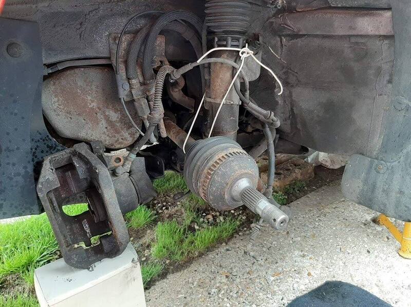

Zelandeth Posted September 1, 2020 Author Share Posted September 1, 2020 You have to be kidding...I went through my entire Citroen parts stash three times carefully to see if I had a lower ball joint in stock before ordering a replacement (which still hasn't arrived). What do I spot today? Sitting on the side of the pool table, about a foot away from the P bush which is waiting to be dropped off when the ball joint arrives? Seriously?!? I must have picked that up and moved it *twice* while I was going through stuff. I really do worry about the state of my brain sometimes. If the new ones arrive in the next 48 hours I'll hold off and use those though as I trust Lemförder parts rather further than Motaquip. If not, this will be used as I really could do with the car back in service. 500tops 1 Link to comment Share on other sites More sharing options...

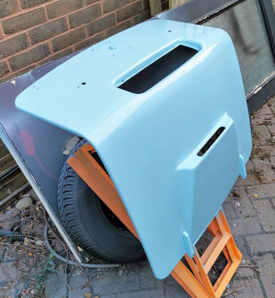

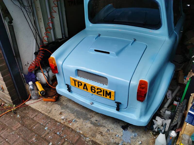

Zelandeth Posted September 1, 2020 Author Share Posted September 1, 2020 Calling it done with regards to the engine cover on TPA for now. Reassembled everything again this morning... ...Shortly after I had moved the block I use to set how far forward I park. I need to keep the car a lot further forward than it looks like I do or the latch on the garage door will take a chunk out of the car when I lock it. While I had the paint out I also gave the top engine cowl a quick sand back and spray over as the paint was flaking off that in several places. With the Jag taken out of service by yesterday's tyre shredding debacle she was then dragged out the garage ready for being the transport of choice for today's errands. Looking a bit better than the first time I took a photo of her in this car park. Which once I was done with puts me comfortably beyond the recommended break in period for the new belt. The packaging with the Dayco HP2020 belt instructs you not to exceed 50mph for the first 20 miles, and I've decided to treat the NOS one fitted the same. It's actually surprisingly difficult to keep this car below 50 on the open road! Just planning to get a few more miles covered in the next couple of days. The only thing I do want to do first though is to readjust the brakes as now the shoes have bedded in there's a bit too much dead travel for my liking. 500tops, egg, Broadsword and 4 others 7 Link to comment Share on other sites More sharing options...
LightBulbFun Posted September 1, 2020 Share Posted September 1, 2020 Happy to see TPA out and about as always, always makes me grin seeing an Invacar amongst all the moderns (on that note, I will admit it did tickle me how currently your only 2 working vehicles are a 30 year old coach built camper van and an Invacar, that is very Autoshite!, well and the Sinclair C5? ) Link to comment Share on other sites More sharing options...
