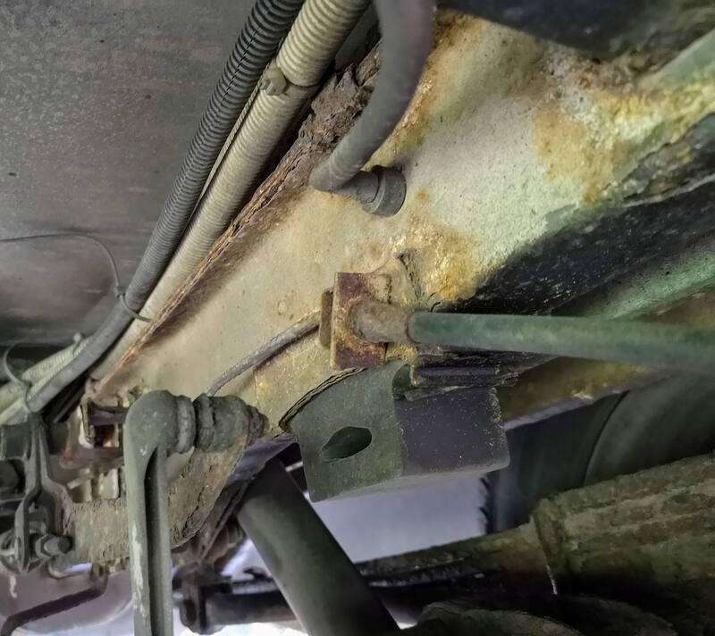

Zelandeth Posted June 17, 2020 Author Share Posted June 17, 2020 You remember me saying I wasn't planning to really do anything else with the van this week? Yeah...about that. Noticed something odd this afternoon. One of those horrible moments of "Wait...Where's that water coming from?" Time to stand on my head. Balls. The answer appears to be "somewhere under the shower tray." Which is essentially inaccessible as it's thoroughly siliconed in place. A bit of thinking however suggested that something was odd about this. There were only two pipes in this area, the suction line from the fresh water tank running to the pump (which lives pretty much directly above the wheel arch) and the pressure feed back to the kitchen (the bathroom one just goes straight through the wall from the service locker). I hadn't done any drilling or screwing of things anywhere vaguely near to this in the best part of a year and there are no connections there - it's all one continuous hose. I had a nose around in the base of the service locker under the wardrobe where the water pump lives, bone dry. The only other thing in this neighbourhood is the toilet. It's not been used in months, but worth investigating. Cue much surprise when I pulled the cassette out I found the whole area beneath it swimming and mouldy. It was bone dry and spotlessly clean a couple of months ago when I last cleaned the cassette tank out. A few moments later I spotted a drip. I was really hoping that the hose connection you can see would be responsible...however it's not. The water is dripping down out of the moulding up at the top. There's only two possible sources for a leak up there occurring when the unit hasn't been used...Either the hose connection onto the solenoid valve for the flush button or the solenoid valve itself. These both however are buried deep within the moulding so can't be checked in situ. I'll need to remove this from the van to investigate. This is...Sub optimal as it will require me to remove a metric ton of silicone, about three million screws and a bunch of tiling. I guess that's the chance you take when you reuse 30 year old equipment though. That's a job for another day. In the meantime I will cap this line off to stop the leak so I can still use the sink, which given I regularly use the van to take the dogs out it really useful so I can wash my hands before driving home. When I was looking for the source of this it did give me a good chance to look better at the drain line routing. I don't reckon it will be too difficult at all to get rigid lines run back all the way to the tank. There are a few awkward things I'll need to work around obviously and I'll probably take a different route to the original flexible lines, but I may well do this sooner than later as it would be nice to just have it ticked off. The original convolute still leaks in several places too despite me having patched a bunch of it up. While finding the drainage upgrade will be pretty easy, while I was crawling around under the back of the van I found something which really hacked me off. You may recall that when I put it into Egerton's Fleet Services last year for the MOT they found all manner of issues with the rear brakes and wound up me with a bill of close to £600 most of which related to the brakes. They failed the MOT initially for things so trivial as missing rear reflectors (which weren't missing...the tester was just blind - including missing the additional ones I fitted to satisfy them and sticking MORE on which wound up pulling the paint off when I removed them), and pulled up advisories for a very slightly frayed seatbelt and a tarnished headlight which I've since had apart and have been able to find absolutely nothing wrong with. The issues with the rear brakes apparently included ovalised drums on both sides, leaking wheel cylinders on both sides, poor handbrake performance and I seem to recall reports of a separated brake shoe lining. This came as something of a surprise as I'd noticed no issues with brake judder, the handbrake could stop the rotation of the planet, and it had never used a drop of brake fluid. I requested that all the old parts be provided...but they never materialised. Which did leave me wondering if they had indeed actually done all the work....they had definitely done something as the brake fluid was overfilled to the point of pissing all over the bulkhead and the brakes have never felt anywhere near as good as they did before they were worked on. Given how picky they were being you might have expected them to have at least *mentioned* the state of these brake hose ferrules wouldn't you? The top one there in particular really is quite crusty (there's no way my MOT tester back up north would have passed it)...I'm not thrilled by the state of the rigid line on it either in a couple of spots. The hoses are quite perished too. Suffice to say a set have been ordered. I've crawled over the front of the van quite a few times (especially investigating an erroneous brake pad wear warning indicator) and things are fine up there...I'd never really looked in that much detail at the rear end though beyond changing the oil in the diff...which was done on a day when it was pouring with rain so I was rather mission focused at the time. Absolutely a demonstration that an MOT should never be taken as a clear bill of health...you should always give your car a thorough check over yourself. While I was out there I realised that I still had to finish up sealing up the top of the gas locker, so that's now been done. It's not pretty, but it will do the job. I'll be installing some rubber floor matting and a proper gas bottle clamp in due course. I just want to leave the floor and the bottom of the rear wall open for the time being until I'm certain I've got to the bottom of a water ingress issue in that corner. For the time being I'm leaving it open so that any water that gets in can get back out again. I need to find a slightly smaller bracket for the waste pipe there too or pack it out a bit. There was a small gap at the top (because I can't measure for toffee), so this was sealed up and then taped for good measure. This foil tape sticks ridiculously well (it will remove your fingerprints if you're not careful) as it's basically intended for sealing joints on HVAC ductwork. It doesn't have much strength in terms of things poking through it, but it stick really well even to surfaces that aren't spotlessly clean - and can lay a really good foundation if you then layer something else over the top of it. I'll probably go over this lot with some good quality cloth tape just for belt and braces before throwing a bit of paint around in here. It's a bit "how ya doin" but it will do the job. It's a cupboard at the end of the day. You can also spy one other thing I did today. I had been struggling to get the hose running between the draining board and the sink drain itself to seal properly. No matter what I did I kept having issues with it weeping very slightly from the attachment stub at the sink end. I lost patience with this today, and remembered that I had a bit of 19mm heater hose floating around in a box somewhere which according to my version 1.0 eyeball looked a close fit...turned out it was indeed a pretty much perfect snug fit. Job done! It should actually be better anyway as the smooth hose shouldn't be prone to trapping water the same way the convolute was. I'm actually tempted to do the same in our kitchen as we have a really long overflow line due to the way the waste disposal unit is attached and it's always been prone to getting smelly, and having to take the whole lot to bits every quarter to clean it is really annoying. I might swap it for a smooth hose like this and see if that helps now I've realised it's the same size. What I actually had hoped to get done today was to get the inverter wired up. The more I thought about it the more it seemed daft to me to have gone to the lengths of fitting it and not wiring it up. As I am never planning the inverter to be used regularly I want it to be tucked away and not look like it's part of the main power system. As such it will have its own little control panel and I'll probably use a red socket faceplate. I had planned to get that done today, but with the above nonsense going on I never got any further than cobbling together the switch faceplate I'll use, tracking down a relay I'll use to switch the supply and find some wiring. I'll just use the original socket for now. The switch panel has two indicators on it. The green one is a standard 12V automotive one which will show when the DC supply to the inverter is on, and the red one is a mains voltage neon to give visual confirmation that it's actually running. Figured this was a good idea as it can be a bit touchy about starting if there's no load (which is why I'm going to use an unswitched socket and have the procedure be to "insert plug, turn power on" to hopefully prevent that being a problem. The frequency meter...well...it's been rattling around for several years and I want to actually use it for something! The mains cable to run to the socket is just a random skinny one from a random bag of cables. It will be absolutely fine for this job bearing in mind that this inverter is only rated to 150W max. Hopefully time will allow me to actually screw this lot together tomorrow...Then we can report back once the new brake hose set arrives. I've ordered a full set for both front and rear axles as they're inexpensive and while they're not so visibly degraded as the rear ones the front ones are obviously still quite old and given she's not exactly a light vehicle it just makes sense to me to the the lot. Yes, I have made sure that I have rigid brake pipe in stock and will make double sure that I know where the flaring kit is before I start! I also hate doing brake work...so tend to work on the basis of "I hate it, so let's get as much as possible done in one shot" when I do need to tackle it. Will be a good opportunity to either fix or disable the brake pad wear warning light too as that playing up is really annoying. An appointment with the most aggressive nozzle of my pressure washer, a few gallons of Vactan and the nation's entire stock of Dinitrol are also in the underbody's near future - though the underbody sealant isn't happening until AFTER I'm done crawling around under there sorting the brakes and routing plumbing lines. I did drown the underneath of the cab last year though as that was obviously in the most imminent danger of dissolving but the weather turned before I got to the rest of the chassis. GrumpiusMaximus, timolloyd, Saabnut and 3 others 6 Link to comment Share on other sites More sharing options...
LightBulbFun Posted June 17, 2020 Share Posted June 17, 2020 jeez given the fuckery you have gotten with the Xantia and the Van im half expecting if you took TPA there she would get failed on "brake imbalance across front axle" LOL Link to comment Share on other sites More sharing options...
Zelandeth Posted June 17, 2020 Author Share Posted June 17, 2020 1 hour ago, LightBulbFun said: jeez given the fuckery you have gotten with the Xantia and the Van im half expecting if you took TPA there she would get failed on "brake imbalance across front axle" LOL Xantia would never have been taken there (the issues there I had were with a supposed Citroen specialist) however given the size and weight of the van I don't have a huge amount of choice on where I can take it for MOT testing. My usual garage don't do class 3 MOTs either unfortunately, though I have no doubt they would happily give TPA a safety and sanity check, even if I'd not be able to get an MOT logged out of it. What's not worrying is that the garage I had all this messing around from, and drove away with overfilled brake fluid, a broken bonnet pull (which admittedly was slightly dodgy before it went in so I can't entirely blame them for that...aside from not telling me), and loose flipping wheel bolts...is where most of the HGV, PCV and ambulances around here seem to go...Which is one of the main reasons I picked the place. I kind of expected that sort of clientele to bring with it some degree of attention to detail. I guess next time we will in fact just use the Bletchley Kwik-Fit and see what happens! ...Though if they tell me I need work done on the rear brakes I may explode. LightBulbFun 1 Link to comment Share on other sites More sharing options...
