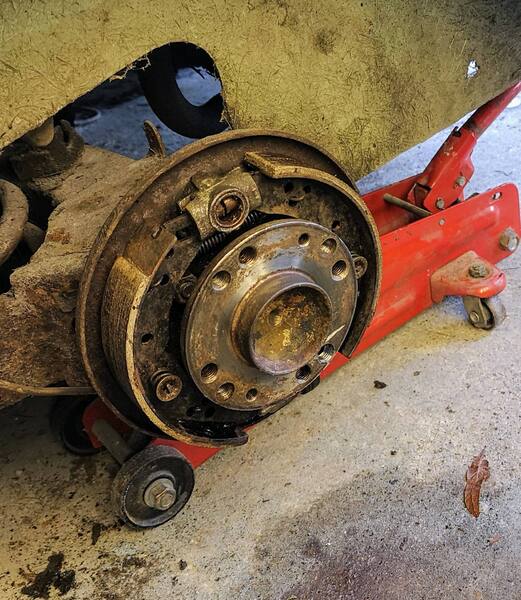

I had a look at something today.  The difference between the 4X100 PCD (used on the Invacar) and the original 4X98 that Fiat originally used.
The bolt holes in the brake drum are actually big enough that there's enough clearance for these holes to be used.  The only thing actually preventing them being used is about 1mm of metal on the wheel.
The question springs to mind of whether a specialist would be able to make that tiny modification.  It's a question I think I might ask of a couple of companies...seeing some of the mad banding mods and such it would seem a relatively easy job.  If it *was* doable that would eliminate the potential stud headaches once and for all.
Before folks ask, yes I have looked at the 12" Fiat wheels from the 500 - the offset is significantly different so the tyre would foul on the wheel arch (can't remember on which side off the top of my head).

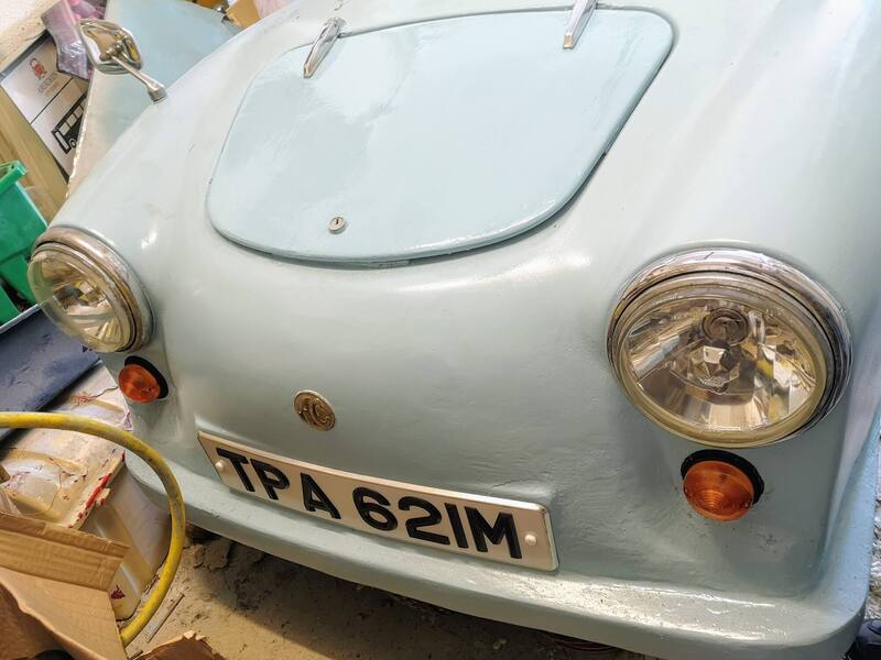

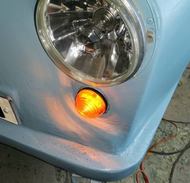

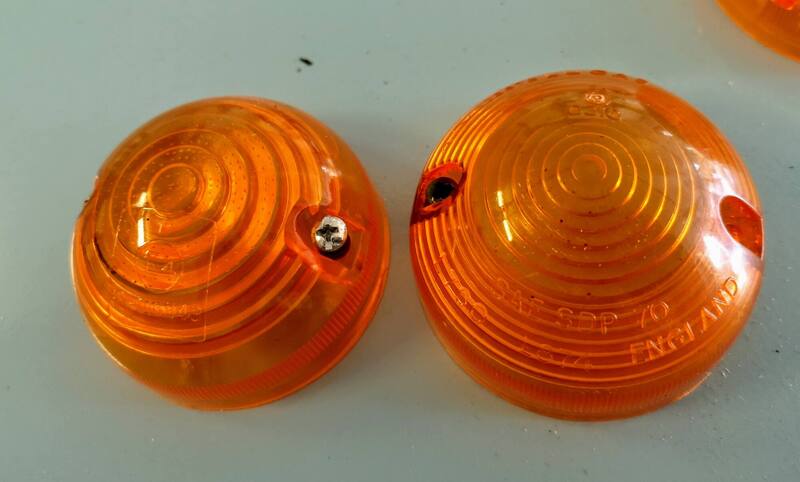

I've got one of the front indicators swapped out.  Just need to go back in with a brush to touch in the paint around where the old seal was removed, was fully expecting that to be needed as the construction of the new unit is slightly different.
I will see if I can get the old lenses cleaned up properly though as the moulding is of a far better quality.
The other one will be done when I next have the car out the garage as the offside front corner is really awkward to get at when it's all the way into the garage.

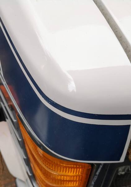

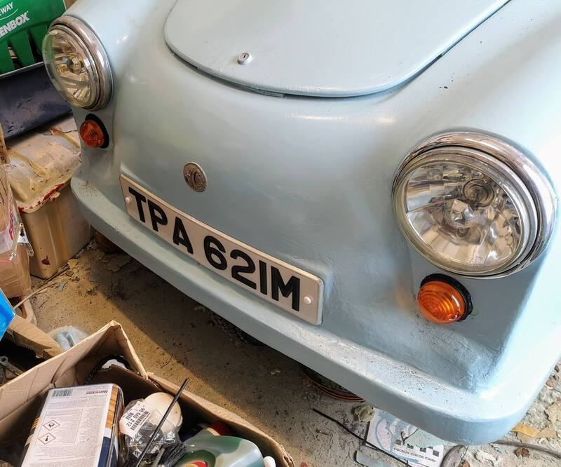

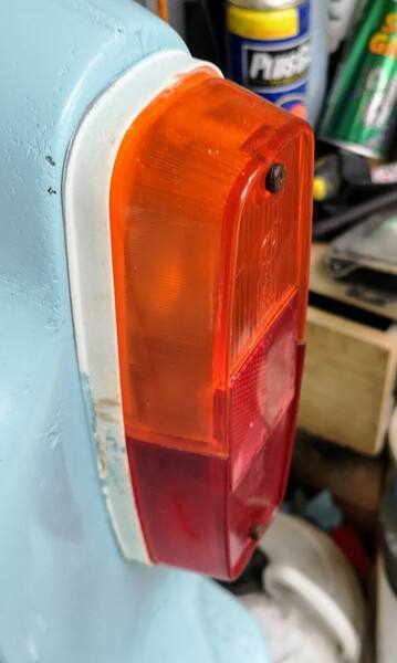

Not really much to report today.
The indicators looked odd without the gasket behind them, even though they're not really needed to form a seal with how the new units are constructed.  So I went out and set about removing as much of the paint from the old gaskets as I could then refitted everything.
Not totally sure why the one on the offside appears to have swollen up a bit (assuming it's reacted with the thinners in some way) but the other one hasn't...will have a dig through the boxes and see if there's a spare floating around in one of my boxes of assorted junk.

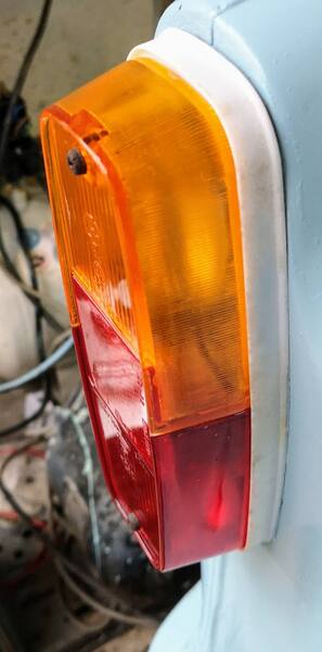

I assume there should be a gasket of some sort between the lens and the back plate, does anyone know if this is a flat gasket or just a tubular section rubber one?

6 hours ago, plasticvandan said:
The gaskets were a  white foam about 3-4mm thick,flat in section,should be easy to make.
That's really useful.  I've got some white foam weatherstrip that I usually use for replacing the foam tape pads in 8-track cartridges which sounds like it will do just fine then.  She's not likely to see much use in bad weather anyway but it would be nice to not encourage further corrosion to to the lamp contacts.

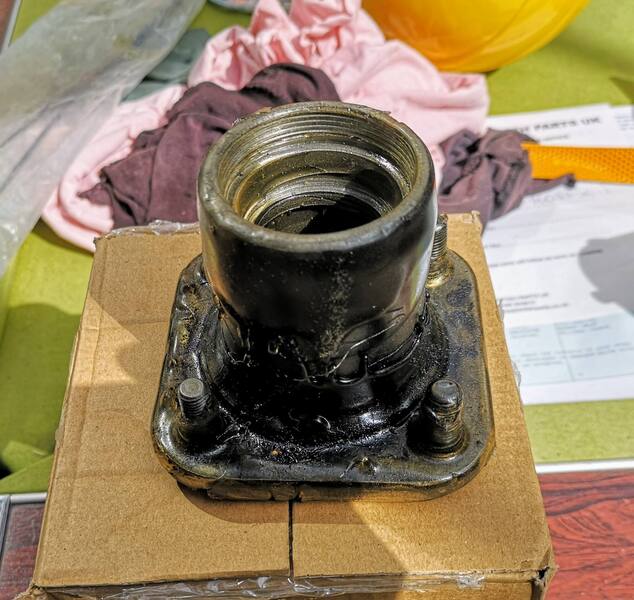

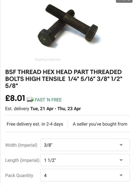

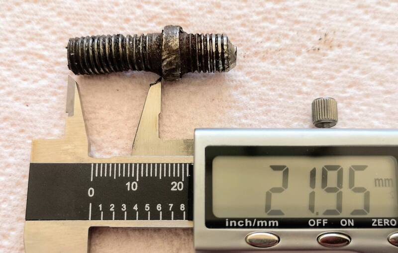

Oh FFS!
The one on the right (which fits the hub).
Ignore the slightly mangled thread at the end, the bolt is too long and fouls on the brake shoes which has caused that damage.
The one on the left.
Which I was 99.9999999% sure was 3/8" based on my research.  Apparently not.  This is a good bit larger.  1/4"?

5 minutes ago, Zelandeth said:
Front hub uses press fit studs.
interesting!
according to the spares manual the studs are Store number STY476, quantity per vehicle 12
so I sort of assumed they used the same studs all round!
theres also a hub on ebay still :)
https://www.ebay.co.uk/itm/133022516385
(which use studs that look a lot like the ones you pulled from TPA)
Link to comment
Share on other sites
Interesting.  I've not looked personally but was advised they were standard Mini etc ones ... somewhere.
I seem to have had so much conflicting information on what will and won't work on this from about ten different sources that it's made my head spin.
If the manual says 12 per vehicle though I'm inclined to believe it.
Given the original studs appeared to have been tacked in place I wouldn't want to be reliant on needing to extract them without damage though.
Edit: looking at the photos in that eBay listing, those aren't knock through studs...nor do they look to have been welded.

Well I've grabbed the one off eBay so we'll see what turns up.  Of course I'll need to get wheel nuts to go with the studs as well as the spares I had all went with KPL I think.  Yet *more* stuff I need to order and wait for.
Of course I do still need to figure out how to get the blasted things out of the hub...which is how a lot of this mess started!

If the studs are like Mini ones they have longitudinal splines around the back of the stud. They are removed by refitting the wheel nut and bashing them backwards with a hammer  They are installed by inserting them from the back of the hub flange, tapping them in until the hardened splines dig into the softer metal around the hole in the flange enough to stop them rotating, then putting the brake drum and wheel on and tightening the nuts up to pull them fully through the flange.
Many moons ago I remember buying a spacer kit for a Mini that had longer splined studs to replace the standard length ones. Unfortunately the metal that the studs were made of was not hardened and was softer than the material the hub flanges were made of. Hence instead of digging in and preventing the studs from rotating they just got flattened as they were pulled in. As a result when then trying to remove the wheel nuts the entire stud rotated. Since the brake drum and wheel were now fitted and could not be removed there was no access to grip the studs with anything. Even trying to drill out the studs resulted in them just spinning. Fortunately the stud material was soft enough to chisel through, but that did make rather a mess of a nice Dunlop alloy wheel.
Link to comment
1 hour ago, Slowsilver said:
If the studs are like Mini ones...
Nope.
Invacar studs are weird.
The outer section is the same as a normal Mini one.  The bit that goes into the hub though is threaded, 3/8" BSF.  So both bits are 3/8" but in different standards!  Figuring that out wasted me longer than it should have.
There's no clearance behind the hub to get splined ones in or out without pulling it entirely off the car.
...When I get to that stage, if getting the hub on/off turns out to be dead easy I will have some very special curses to say given that's the one thing I've been trying to avoid!

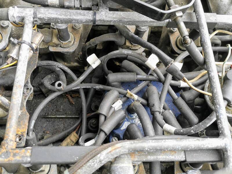

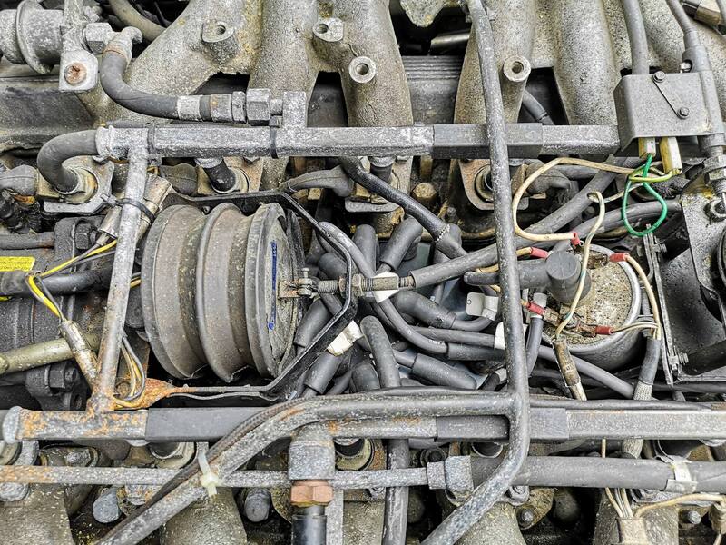

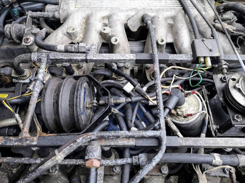

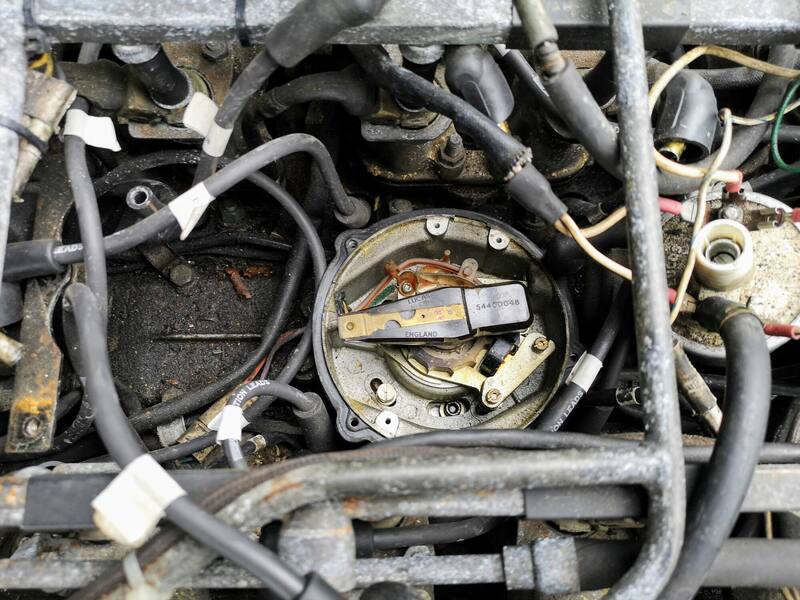

Today's target: Distributor examination & Replacement of the cap and rotor arm on the Jag.
No surprise it's a bit awkward to get at.
Not insurmountable to be honest, just a bit fiddly.  Removing the cruise control actuator (three easily accessible 11mm bolts and one vacuum hose) makes it entirely doable.
Helpfully the HT leads were all already labelled as that saved me having to do it!  The direction of rotation and the socket for the lead for cylinder 1A is helpfully marked on the outside of the distributor cap too and the firing order is noted in at least two locations in the engine bay, so you've really no excuse for getting too lost.
Having pulled half the HT leads off it started to become apparent how much of an issue being able to reach things was.  This wider angle shot shows just how far away from you the thing is...
Eventually I wound up climbing into the engine bay and kneeling on the left hand inlet manifold.  This would have been far less uncomfortable if those ridges weren't cast into the top of it and if that blasted fuel return line cooler wasn't in just the wrong place.

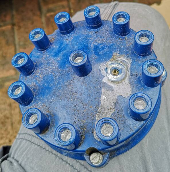

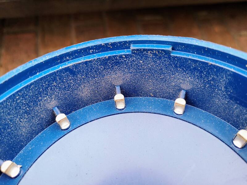

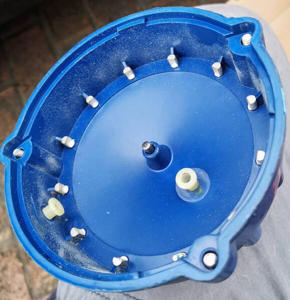

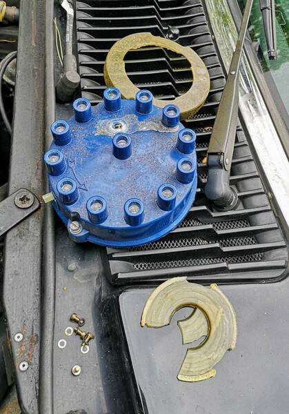

Once the cap was off...which took a not insignificant amount of force...it became immediately apparent that something wasn't quite right.
While it's not immediately visible in this photograph because of how things are sitting, the centre portion of the plastic cover below the rotor arm has completely detached from the outer part and has been spinning freely around with the rotor arm, there's also a big crack in the central portion currently hidden behind that HT lead.  This I suspect may have been the source of a rattling noise I'd been hearing on and off from this region of the engine bay.
One of the biggest issues I was aware of was that the distributor breather line had become detached from the outside of the cap.  Someone apparently has tried (unsuccessfully) to superglue it back on at some point in the past.
You can see the marker for plug lead 1A next to what's left of the breather line attachment, and the arrow at roughly 12 o'clock showing the direction that the rotor travels.

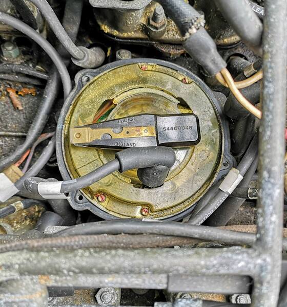

Underneath it's not looking too bad really.  Not much fouling at least really (the powder is bits of the plastic cover mentioned above which has been getting finely atomised and bits of which are everywhere).

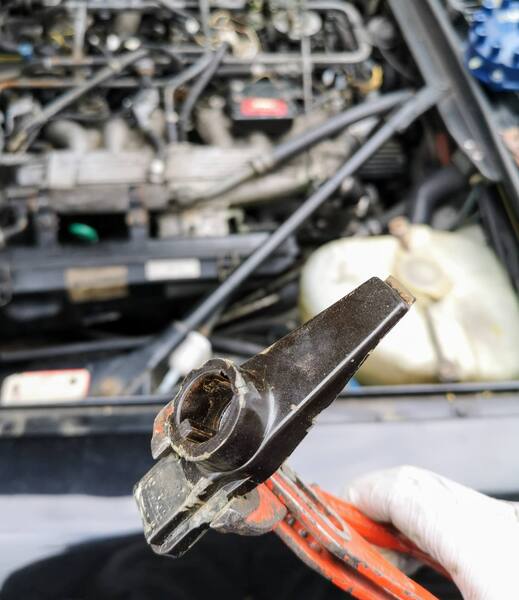

Looking closer however it looks as though the rotor arm has been sitting lower than it really should and has only just been making contact with the posts.
This however is where the fun and games really started.  Quite simply the rotor arm was completely and utterly disinterested in parting company with the distributor shaft.
The plastic cover being broken at this point was helpful as it meant I could just pull it off.  The outer section just lifted off once the four screws were removed, and I decided to just snap the inner bit given that it needs to be replaced anyway.
It appears that the advance mechanism surprisingly doesn't seem to be bound up, this was quite a surprise.  Vacuum one is definitely moving freely, I'll stick a timing light on it and double check that the centrifugal one is also moving.  I was originally planning to strip this all down to clean and lubricate that - but given I need to get things apart again to replace that plastic cover I can do that when I have the replacement for that in stock.
So started roughly an hour long fight with the rotor arm.  Somewhat awkward fighting as well as I obviously didn't want to pull up too hard on the whole distributor shaft as I know on some cars that can damage the drive (no idea if that includes the Jag, so I'm just going to assume "yes" unless told otherwise).
*Eventually* after a not insignificant amount of swearing...
There are several cracks in this arm...though it's impossible to say if they've been there for ages or are a result of the sheer amount of brute force that was needed to remove it.
Then as they say reassembly is simply the reverse of removal.
I gave the distributor post a bit of a clean up to remove the surface rust on there which was probably why it was such a pain to remove the rotor arm.  Then also very carefully made sure all the HT leads went back in the correct place.
Doesn't that look better than the bright blue thing?
Yes, I'll get some proper insulated spade connectors for the coil when I'm next in here, those are bugging me.
There's really no possible way I think to route the HT leads which doesn't result in them criss-crossing over themselves to at least some extent.
I discovered another potential issue at this point which might also have been responsible for the very slight intermittent idle misfire I've noticed...About half of the plug leads weren't actually clipped onto the spark plugs.  I discovered this when the one for 5B came off in my hand.  This is of course one of the ones buried under the throttle tower, so getting it back onto the plug took me about ten minutes of contortions.  Got there in the end.
Has this helped smooth things out at all?  She's always been a little lumpy at idle for the first couple of minutes, especially from the left bank (and the idle speed is a bit high sometimes - the IAC valve needs a thorough clean)...How's this for an improvement?
I'll take that.  It's hard to say which is most responsible...The new rotor arm & cap or actually having all 12 HT leads attached to their respective plugs properly.  Haven't had a good reason to go out today so haven't been able to leave the drive - but just blipping the throttle when stationary it *definitely* feels more responsive.  To the extent it's now making the exhaust rattle against the floor when you blip the throttle...That's never happened before, so I think is definitely a sign that we've got more urgency.  We'll have to wait until I've got a valid reason for going out to see if that translates into any perceptible difference on the road.
Now to update the maintenance log and get a replacement for the distributor internal cover/shield/whatever they call it in Jag lingo ordered.
Should have been a 45-min to 1 hour job...right up until the rotor arm decided to fight us!

A little package arrived for the Invacar this morning.
Looking like new despite sitting on a shelf for goodness knows how many years thanks to a thick wax coating.  Not much I can do with this until the new wheel nuts arrive though.  Hopefully they should be here tomorrow or Friday.
While digging around in the back of the garage though I did find a good old set of front indicator lenses, which look far better than the modern ones which came with the new lamp housings.  Modern one is on the left.
The older ones look far better on the car.
On the same note I do have a proper set of headlights on the way too.  These modern ones are bugging me enough that they have to go.  I will keep them around though as they actually work *really* well, so if/when I do the epic country-wide road trip I'll probably refit them for that.  It's just a five minute job to swap them.  These were floating around in the loft though and did just fine for testing.
Not really much else I can do here until we've got the new wheel nuts here though.

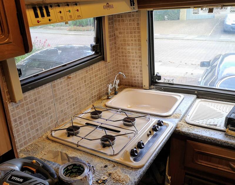

So I turned my attention to the van.  Today's target was the hob - not least because I'm sick of tripping over it.
It did need a good clean though before I was going to handle it any more than I had to.  The whole thing was sticky and just generally horrible.
Yes, I do have the missing knob, it's missing the spring clip which holds it on though so I've just left it in the box of random van parts for now.
After a good old scrub though it was looking much more presentable.
I've moved the missing knob to the grill position as I've yet to build the box below for it to sit in.  Though being honest I'm less bothered about that as it's not something we're really likely to use often.
After a bit of carpentry it was in place.
I've got a couple of metal plates which I'll install underneath as a heat shield.  Plus I've insulated everything even vaguely near to it with aluminium foil tape as well.
No it's not perfectly straight...but neither is the whole worktop relative to the wall of the van.  This whole worktop will be coming out and being rebuilt at some point in the future as it's an utterly unsuitable material for use in a van and really isn't fitted well (it does slope back towards the offside wall as much as it looks like it does in the photo).
The fact that the kitchen layout has been completely changed is obvious by virtue of the cover opening the "wrong" way.  Obviously the hob originally would have been recessed as well so this would have been flush with the rest of the work surface when closed.
Initially I thought that the hob might have originally been where the sink now is - but if that was the case the grill would have been totally inaccessible.  Hmm.
We'll figure out things like that somewhere down the road though - for now it can live where it is, it's ugly but having a working hob will be worth that when we're using the van.  Just having it functional again will be good enough for me for now.  Should have it up and running tomorrow, just need to hook it back up at the manifold end and obviously leak check etc.  Just ran out of daylight today.

ohh yay the hub got to you pretty sharpish, hopefully it will finally mean the end to your wheel hub woes and you can finally take TPA out on the road once more! :)
on the headlamp front when you say proper set of headlamps, do you mean an original type that takes 36W incandescent lamps, or a set that look original but take H4 halogen lamps?
Link to comment
Guess I should have said "original style" really.  Basically the standard H4 type that were used on the later Minis etc.  I'm sticking with H4 lamps at least, just seems daft not to given the difference in performance and with how unlikely you are to be able to find R2 lamps at most motor factors these days if you had one fail while out and about.
Yes the load is slightly higher which long term might cause issues for the headlight switches - though I've plans to install relays to both take the load off those and to help make sure that the lights are actually seeing as close to their rated voltage as possible.   See also "trying to ensure long-term reliability."
Link to comment
yeah im not one to complain here was just curious :) (especially as she needs new head lamps anyway, I very much plan to fit H4's to REV for exactly the reasons you state)

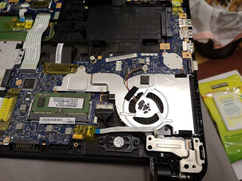

A month or so back one of the computers here packed in.  Despite a reasonable amount of faffing around with it revival appears to be off the cards.  As best we can tell it's either a component level fault on the motherboard itself or a badly corrupt BIOS.
It was a cheap and nasty piece of plastic anyway and no great loss.  It's never a good sign when the chassis doesn't contain any metal nor does the CPU heatsink even contain a heat pipe.
Nevertheless a few parts have been salvaged.  The memory has been transferred into another laptop, the hard drive has been added to the standby stash, but most usefully right now it had a spotless display.
