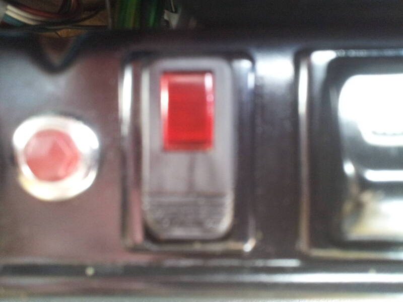

Slowsilver Posted May 4, 2020 Share Posted May 4, 2020 On 4/25/2020 at 11:23 PM, Zelandeth said: Intention being to use windscreen demister switch to switch the heater blower and the other to be wired in as a brake fluid level indicator. Figured this afternoon would be a good opportunity to get them actually installed. The general public agreement for placement was for it to go where I had suggested, to the right of the speedometer, mirroring the headlight/wiper switches on the other side of the dash. I wanted to align things such that I had room to install a total of three switches there for potential future upgrades (I've a half developed idea to get me working forced cool air ventilation in the cabin which would want an additional one). While the brake light/switch doesn't quite match visually it's the same width as the Invacar (etc!) ones so I can reuse the cutout for it in future. I know BMC had a thing for using switch-based brake fluid warning lights for many years, did they ever do one that used this type of footprint? I I think this is possibly the BMC switch-based brake fluid warning light you are thinking of: Warning light illuminates when bottom of switch pressed for bulb-test purposes: Fitted to Maxis with dual-circuit brakes from 1977. There is also a matching switch for the heated rear window, which has the same legend as yours but has a separate warning light (the green one directly next to it on the right): Unfortunately they are not the same size as the switches on the main dashboard. These are about 37 x 20 mm whereas the ones on the main dashboard are about 50 x 20mm, like your light switch. But if it is any use to you they are Lucas switches, the part number of the brake fluid warning light switch is 39454B and the HRW switch is 39602D. LightBulbFun 1 Link to comment Share on other sites More sharing options...
LightBulbFun Posted May 4, 2020 Share Posted May 4, 2020 that reminds me here is the DHSS's Model 70 bits you should buy from your local motor factors list and give full OEM part numbers as a result, and include a lot of electrical stuff like switch gear its interesting how all the other switches are listed as lucas which you would expect but the identical in style wiper switch is listed as being made by clear hooters ltd.... Link to comment Share on other sites More sharing options...
Zelandeth Posted May 4, 2020 Author Share Posted May 4, 2020 That brake warning switch isn't one I recall seeing before, will keep it in mind. Have spent very, very little time around Maxis so not a huge surprise. Not one I'd go specifically looking for I think as it looks more modern to the eye (even though it's not really!). Guess one other option would just be another red warning light and situating it somewhere else on the dash... though the modern reproduction versions of the WL14 indicators have a slightly different bezel which is annoying. Not that I need to worry about this at this stage given adding an actual fluid level sensor is still a ways down the to do list. LightBulbFun 1 Link to comment Share on other sites More sharing options...

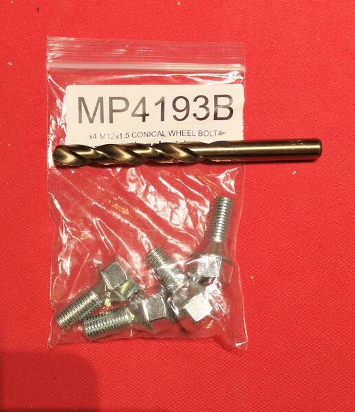

Zelandeth Posted May 6, 2020 Author Share Posted May 6, 2020 Sodding finally! Has only taken me eight months. Amwaiting on some early Morris Minor wheel bolts to arrive to eliminate my seriously shonky using-old-wheel-nuts-as-conical-washers bodge there...but the fourth bolt is now present and actually has tightened. I do need to remove and shorten the bolts slightly before I can actually drive though (and clean the award out of the brake drum) as they currently foul on the brake shoes... that's relatively easy though. The M12X1.5 bolt is way beefier than the original 3/8" stud/bolts. I'd rather wait for the proper bolts to arrive anyway as this arrangement just doesn't look robust to me...despite equal amounts of metal holding things together as with the original studs and nuts. Sure it would be fine...not wanting to tempt fate though! If the hub wasn't such an absolute pig to drill (even with a cobalt drill bit) I'd be tempted to just drill them all out to M12, but as it is such a pain and the existing threads seem fine in the other holes... getting appropriate wheel bolts in and calling it good! spartacus, LightBulbFun, timolloyd and 1 other 4 Link to comment Share on other sites More sharing options...
