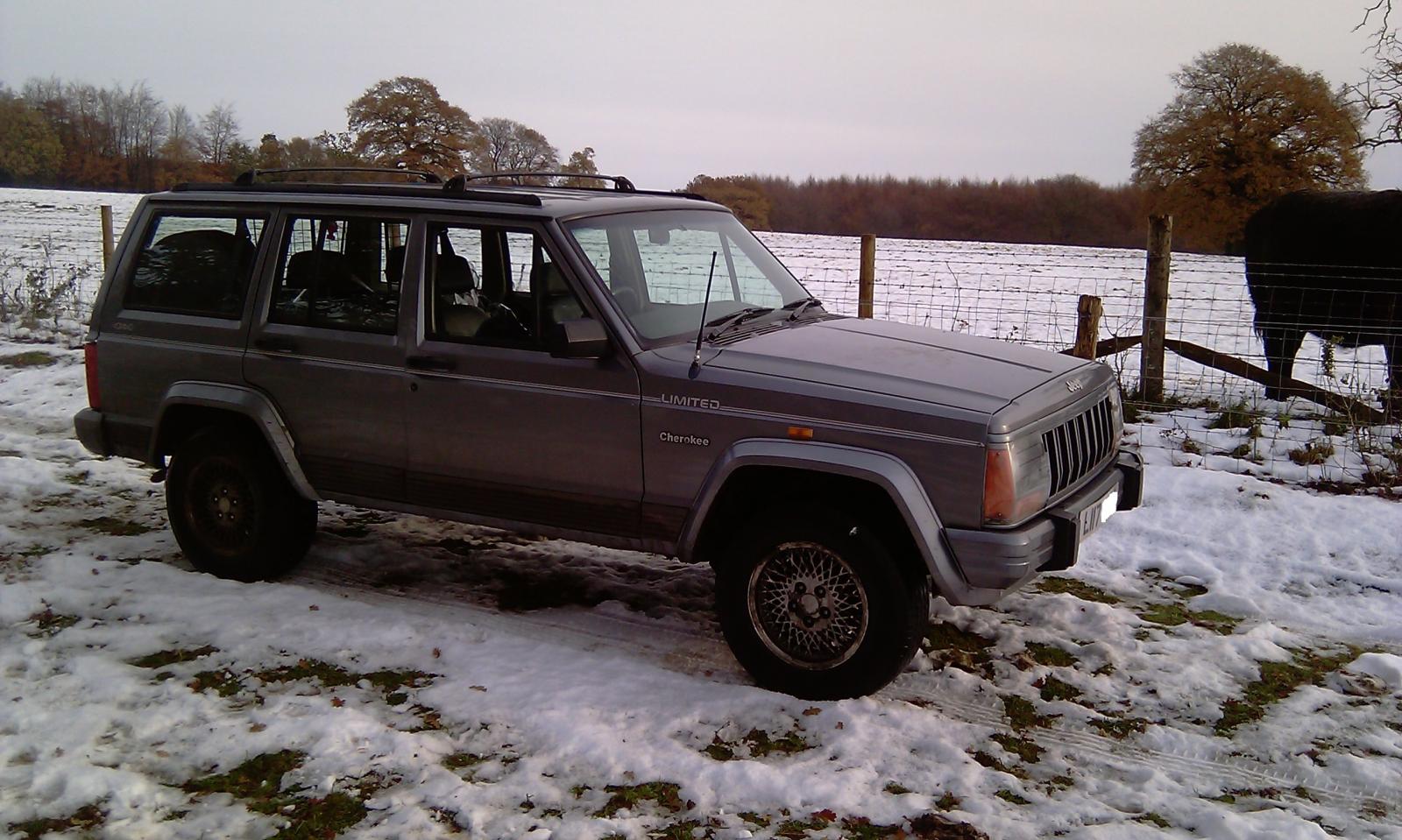

Steve79 Posted August 16, 2017 Share Posted August 16, 2017 Had a 93L 4-litre Limited SE for around 3-years and never had a moments trouble with it, bar the usual service items. Decent enough to drive and had plenty of grunt from its 190bhp. Mine had an LPG kit fitted and got around 20mpg on unleaded and 16mpg on LPG. The Cherokee XJ gives the impression of being a large vehicle but interior space isn't the best with legroom in the rear being particularly cramped. Boot space is just about ok, but the side mounted spare tyre in the boot doesn't help. Things you need to keep an eye out for: Rust - These can rot like any other 4x4 (maybe not as bad as a discovery!) and they can rot in unusual places. Favourite seems to be in the roof of all places, around the roof rails. Mine did this so just sanded back and wobbed with filler, didn't rust again! Check for wet carpets as floorpans like to rust as well.Rear Springs - Facelift (post '97) XJ's seem to suffer with sagging rear leaf springs that earlier models didn't seem to suffer with.Selec-Trac 4WD selector - Unless it's used regularly it can seize. When it does it's an absolute bastard to get it functioning correctly. DO NOT shift to Part Time on tarmac as handling will become 'interesting'. Shifting to and from 4wd and 2wd is best done on the move and can be done up to 56mph. Interestingly fuel economy was just as shite in 2wd as in 4wd. (Note: the 2.5 4cyl didn’t have full time 4wd, only part time)Differentials - Dana 30 in the front and Dana 35 in the rear. Usually very hard wearing but recommend oil changes every 30k to ensure longevity. LSD additive is absolutely essential for the rear diff. Knackered diffs will whine like crazy but will go on forever like this. Rear axle bearings can let go as well and requires the removal of the half shaft with the new bearing needing to be machine pressed on.Engines - Cooling system on 4-litre need to be kept on top of as they usually like to run hot at around 97 degrees. Take off viscous fan and install electric one for moar powaah!. The 2.5 Petrol only come with a manual box and engines feels a bit weak and doesn't really suit. The 2.5 VM Motori turbo diseasel pulls well enough but suffers with porous cylinder heads which seem to have polished most of them off.Ventilation – Pre ’97 cars suffered with poor ventilation akin to U11 Bluebirds and the aircon is crap. Post ’97 cars had a much better revised system. Despite the above, i loved mine and would have another in a heart beat (unless i found a nice grand cherokee zj) Nostalgic pic of mine below eddyramrod, Cleon-Fonte, Junkman and 2 others 5 Link to comment Share on other sites More sharing options...
