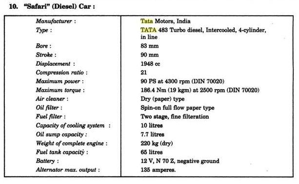

Lacquer Peel Posted July 18, 2017 Share Posted July 18, 2017 The block and head castings are the same. Machining is different, and the cam cover is a different shape, but in the same way a 1769cc XUD and a 2088cc XUD are not the same engine but are part of the same family, this is part of that same family of engines. Which does matter, as it means that things like starter motors, alternators, water pump, cam belt, tensioners and other ancilliary devices are interchangeable with other XUD series engines. Have you been deep inside the Tata engine to prove it? I'm only familiar with XUDs. I'm genuinely curious about this and would love to be proven wrong. Tata XUD Cross checking cambelts, water pumps and alternators, they don't even share these parts. Link to comment Share on other sites More sharing options...

Cleon-Fonte Posted July 18, 2017 Share Posted July 18, 2017 I'd always assumed the Tata diesel was nothing more than a reworked 1948cc Indenor XD88 block, but looking at the table above the bore/stroke are completely different (the Indenor is 88mmx80mm), the identical capacities being merely coincidental. The Tata shares its 83mm bore with the XUD9 (with a slightly longer stroke), giving some credence to the theory that it's XUD-based. But it weighs 80kg more than an XUD9TE which would suggest some serious beefing up has taken place, and that the blocks/heads are not identical castings. Lacquer Peel 1 Link to comment Share on other sites More sharing options...

somewhatfoolish Posted July 19, 2017 Share Posted July 19, 2017 The Tata shares its 83mm bore with the XUD9 (with a slightly longer stroke), giving some credence to the theory that it's XUD-based. But it weighs 80kg more than an XUD9TE which would suggest some serious beefing up has taken place, and that the blocks/heads are not identical castings.That would suggest the indians have substituted cast iron for alloy in at least one of the major castings. Link to comment Share on other sites More sharing options...
